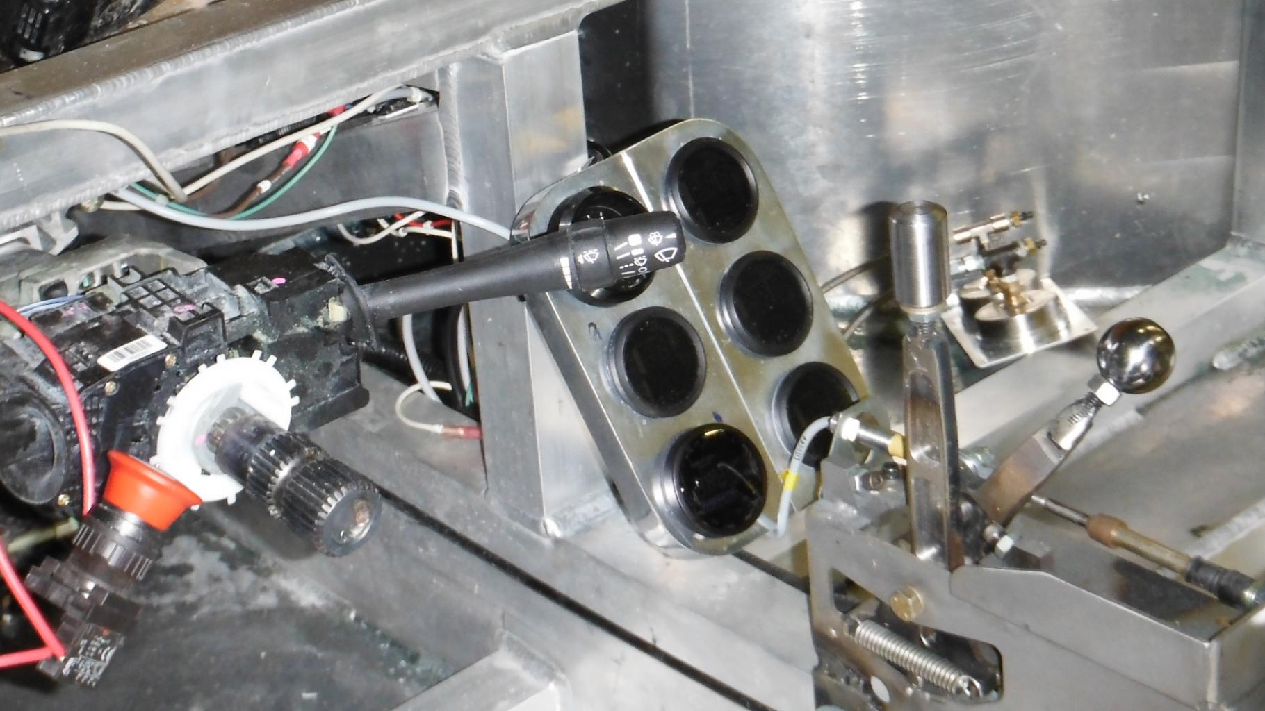

The IC pipes are nice and short....I like that!
There is another handle by the shifter...is that the e-brake?

The straight up and down shifter is 1-5 gears, the one on the side angel is reverse.
I have a Mendeola 5 speed sequential gear box, way cool, shifts like a motorcycle.

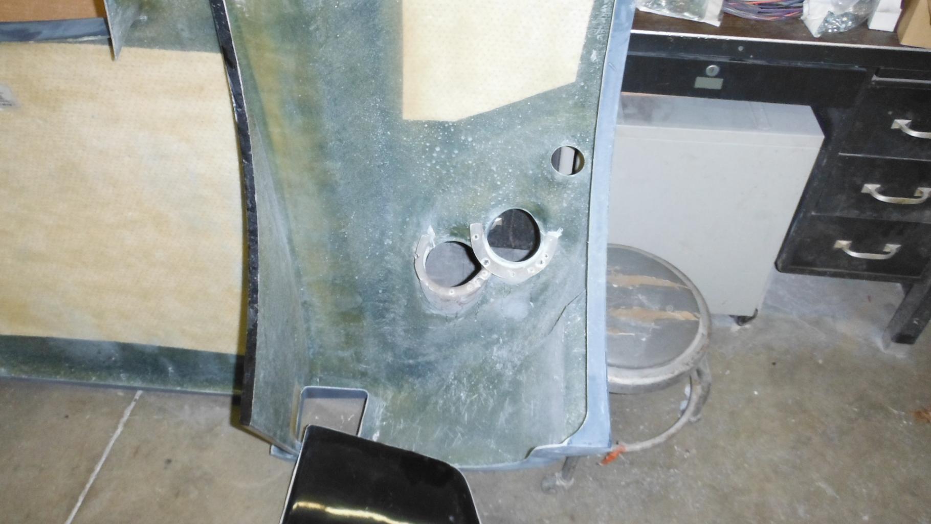

I am making my close out panels now, gas tank cover, then air scoops the the shield.

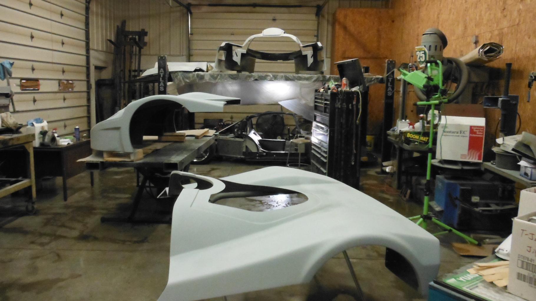

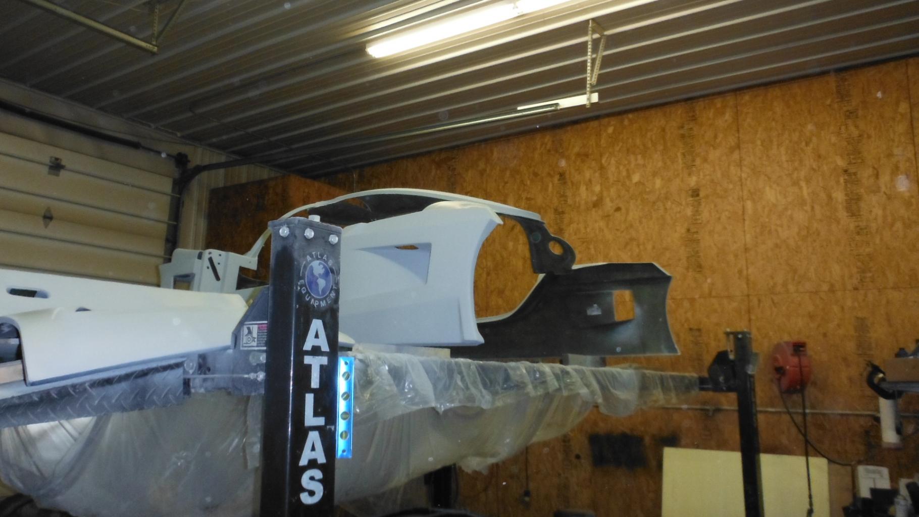

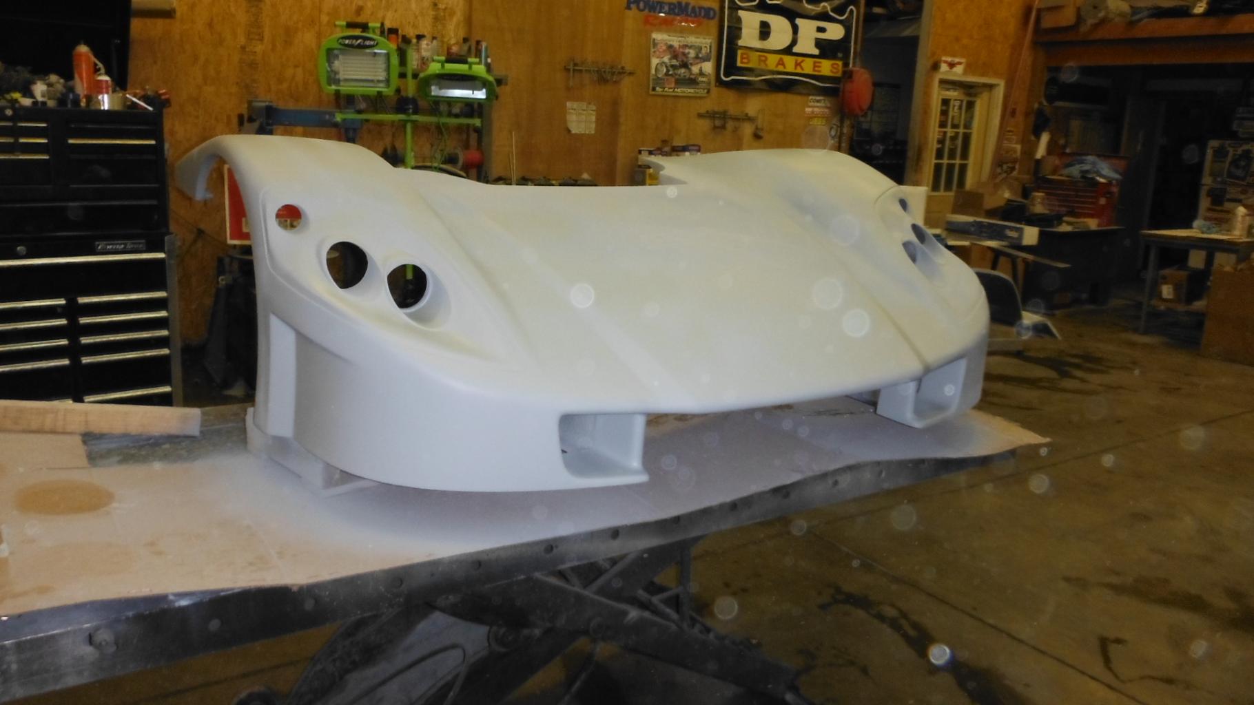

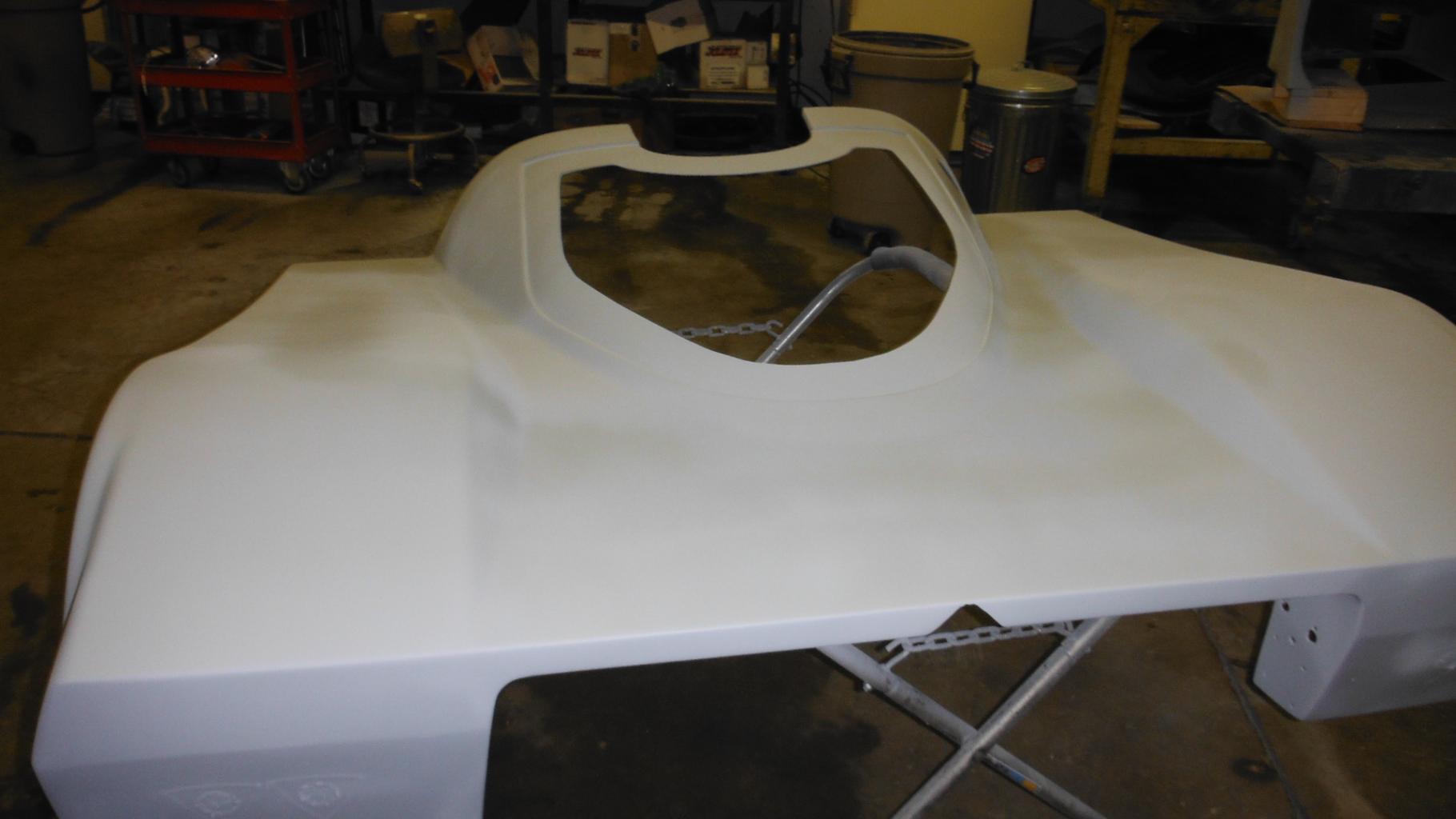

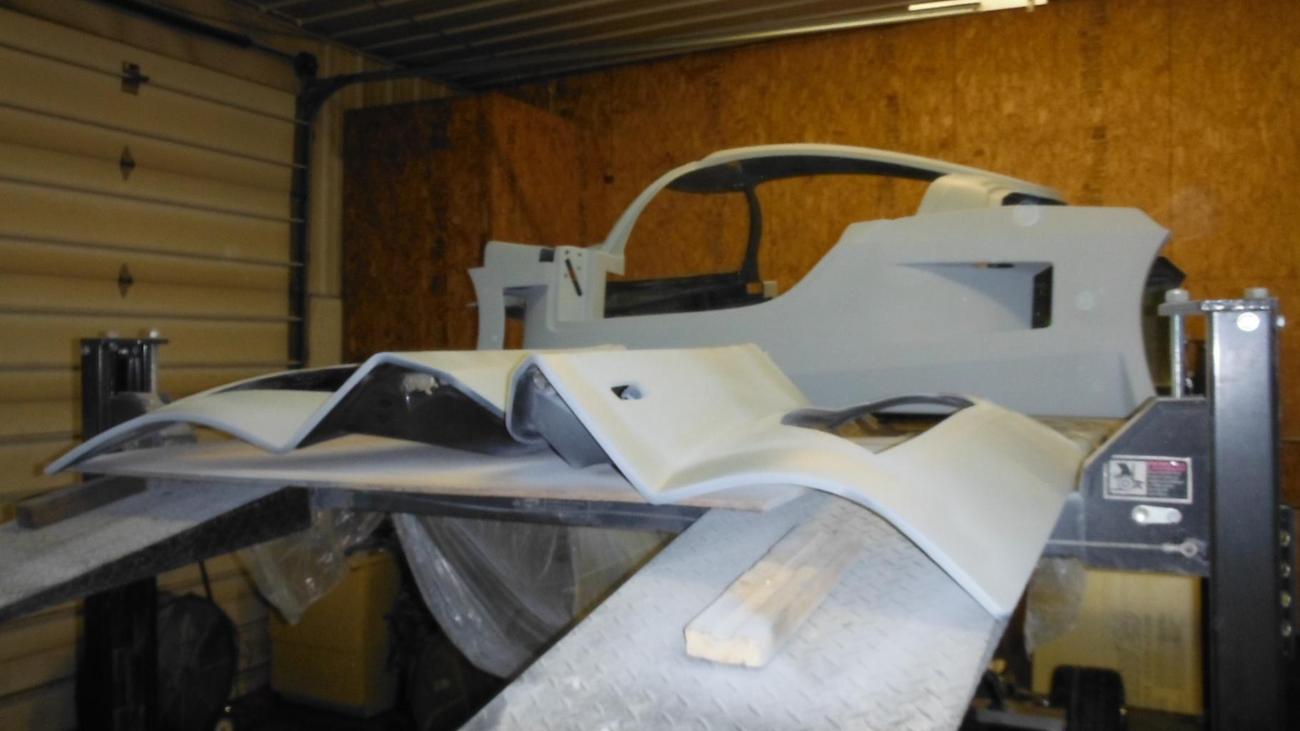

Just finished with the primer, will sand tomorrow, and next weekend ill paint. Made a mess in the shop, just finished washing everything down and wiping off tables, etc.
So tempted to run it up and down my driveway 70 degrees here tomorrow but will sand. Here are some pictures.

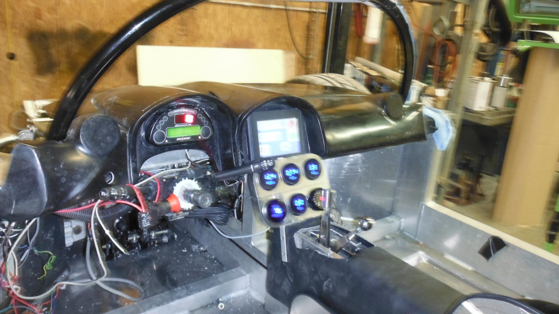

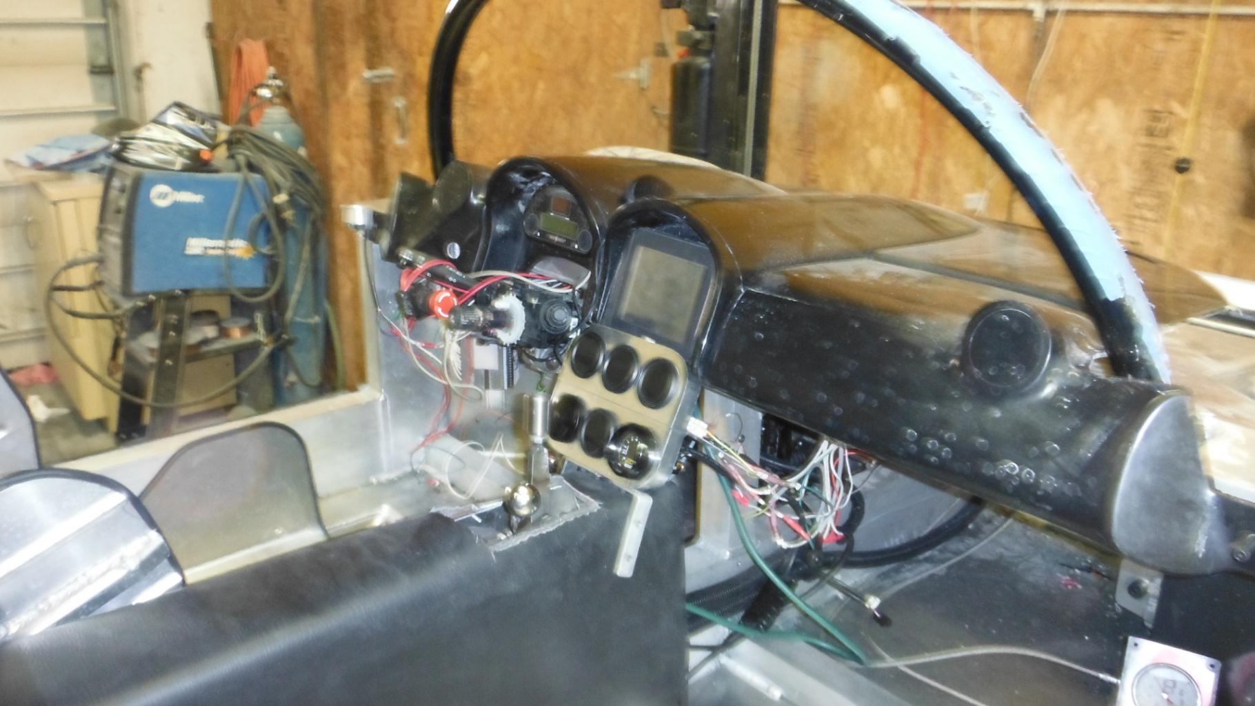

Changed the gauges around, made a console, insulated the back, etc.
Painting the first color, base coat grey Saturday, Sunday finish it up hopefully.

I have 2 PLC's, like little computers on the car, the center screen is a touch screen, which will start the car, turn on all the fans, coolers, charging, fuel pump etc. With this I can just turn over the motor without starting, manually turn on all the fans for the radiators, oil coolers, charging system, the manual starting motor is helpful to put it on the lift without starting the car, sometimes im out of umph to push it up the ramp on the lift at the end of the day. The seconds PLC I have the wiring from the steering column going to, so wipers, bright and dim lights, blinkers, horn, the horn is actually the light flash since I take the steering wheel off to get in run thru this plc, dont have to worry about led's blinker flashers stuff like that. The reverse lights go on from a proximity switch when the reverse shifter when moved forward, im just use to using this stuff so its not hard. The ISIS I would of used, but they dont give the programming software out, so you are at there mercy to have them program something different, plus I would need 3 of them, I am using 26 inputs from various circuits and 20 outputs, 16 relays and a couple starter solinoids.
I control how the brake lights are on, they flash 3 times then stay on, the blinkers on each side blink morse code letters different on each side is the easiest way to describe it, things like that I use them for.
The touch screen is also security if you want it, punch in a code, or you can have a finger print scanner, etc. But I really dont think anybody is going to steal it, maybe put it on flat bed to steal it, but its insured.

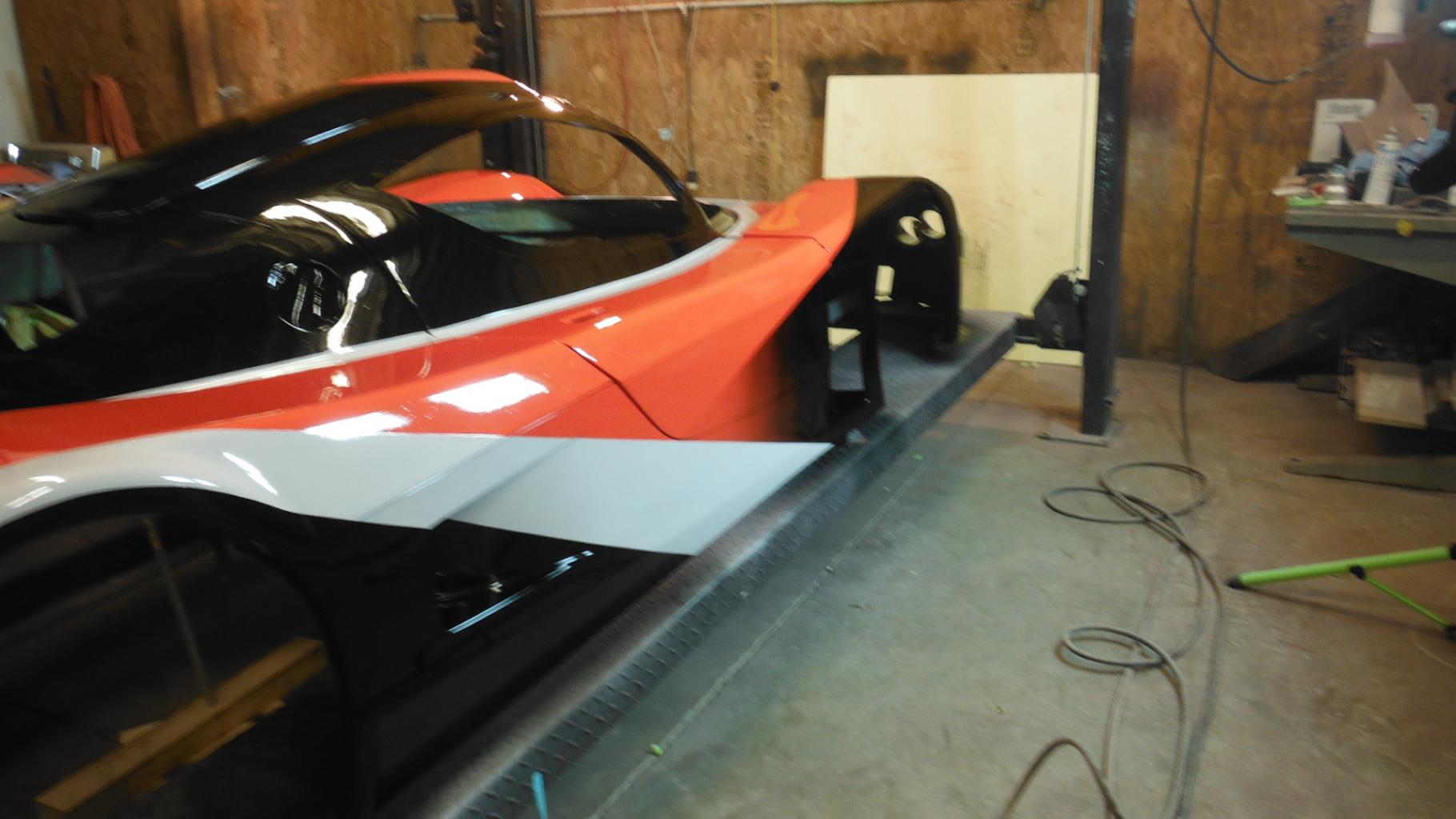

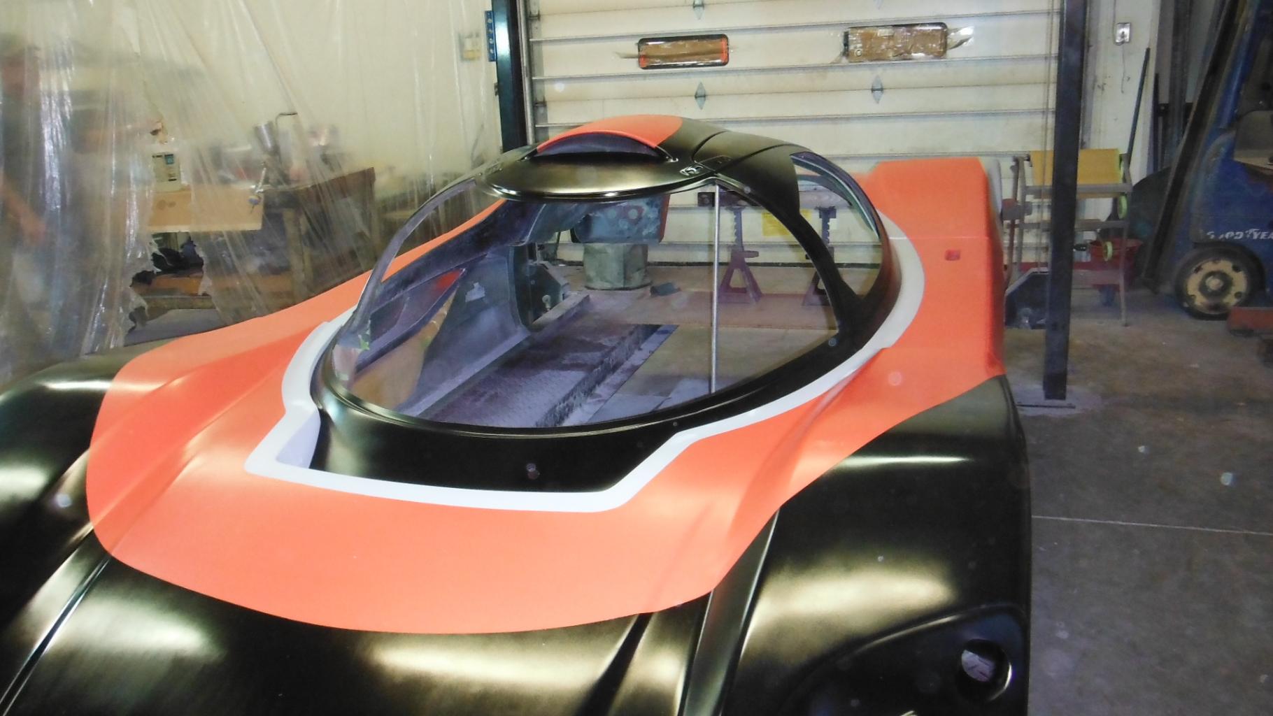

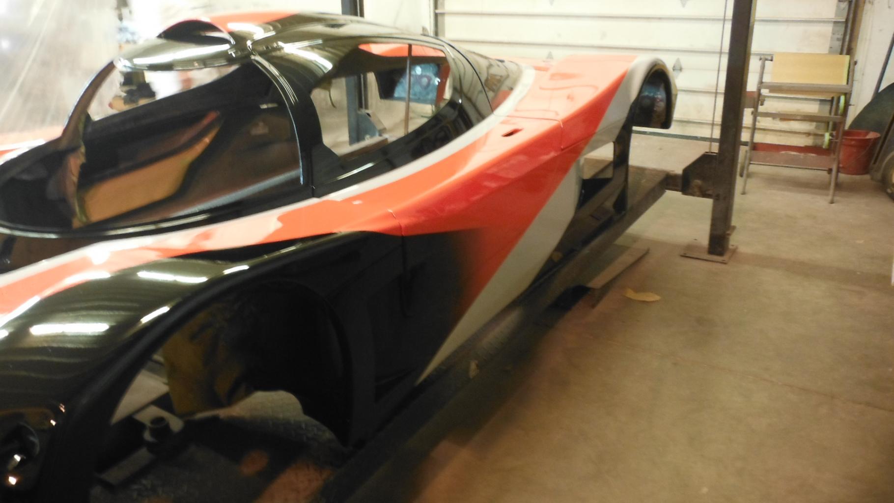

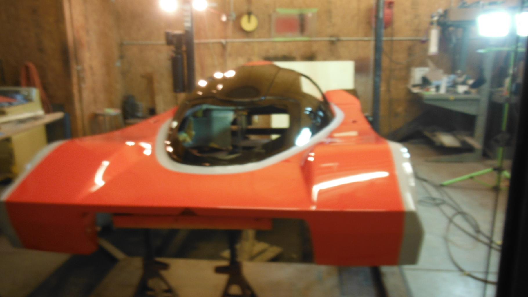

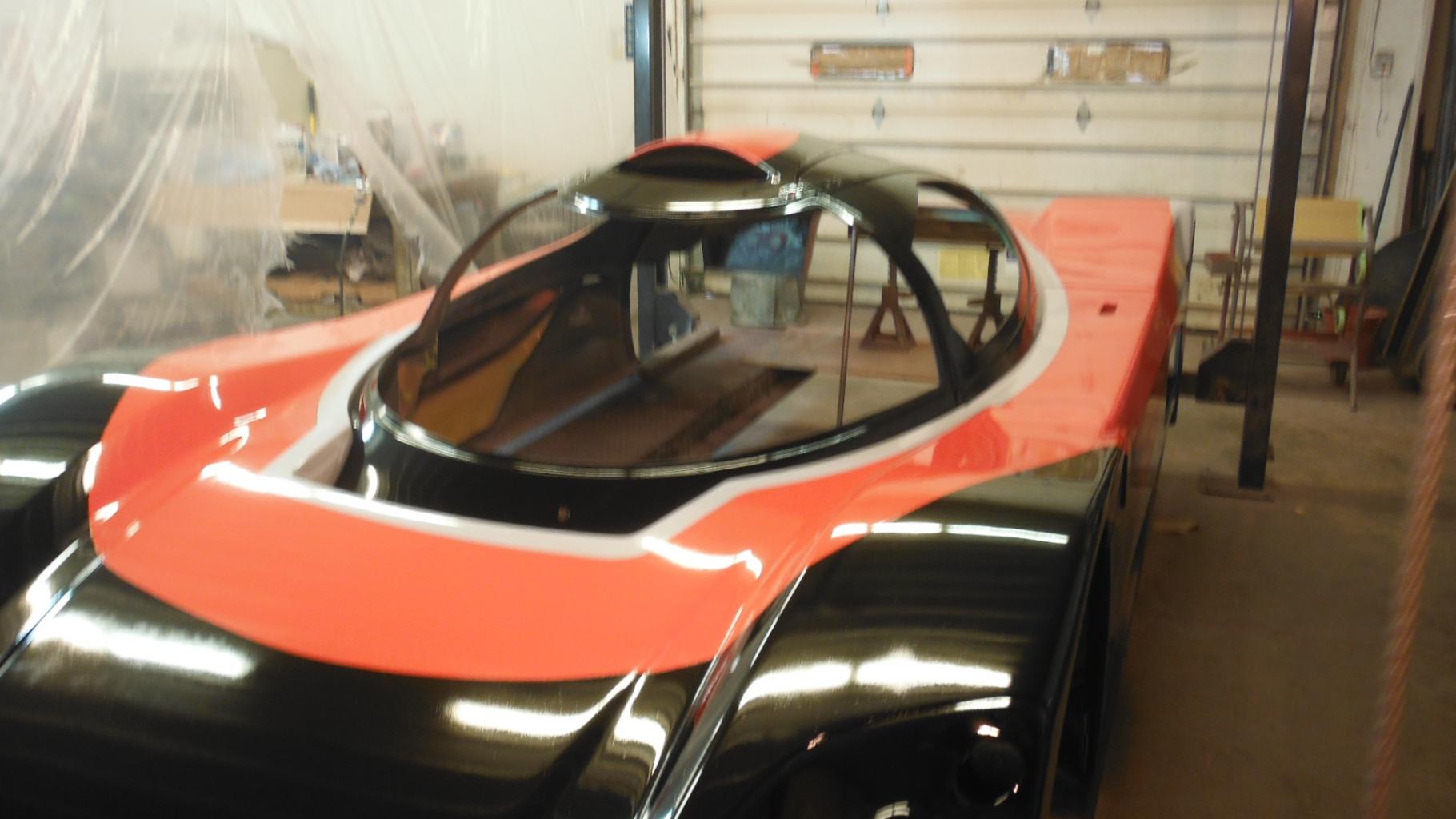

Just finished painting it. What a mess, but here are the pictures. 4 days I can start wet sanding it the on the car it goes.
Wow. That's gotta be the most elaborate paint job on an SLC I've seen so far. It will be fascinating to see the car when it is on the ground, with the wheels, detailing and so forth done.
+1 :thumbsup:
Are you planning to add any more details? Pinstripes where the colors meet? Decals?
Either way...it's gonna be a very cool car.
