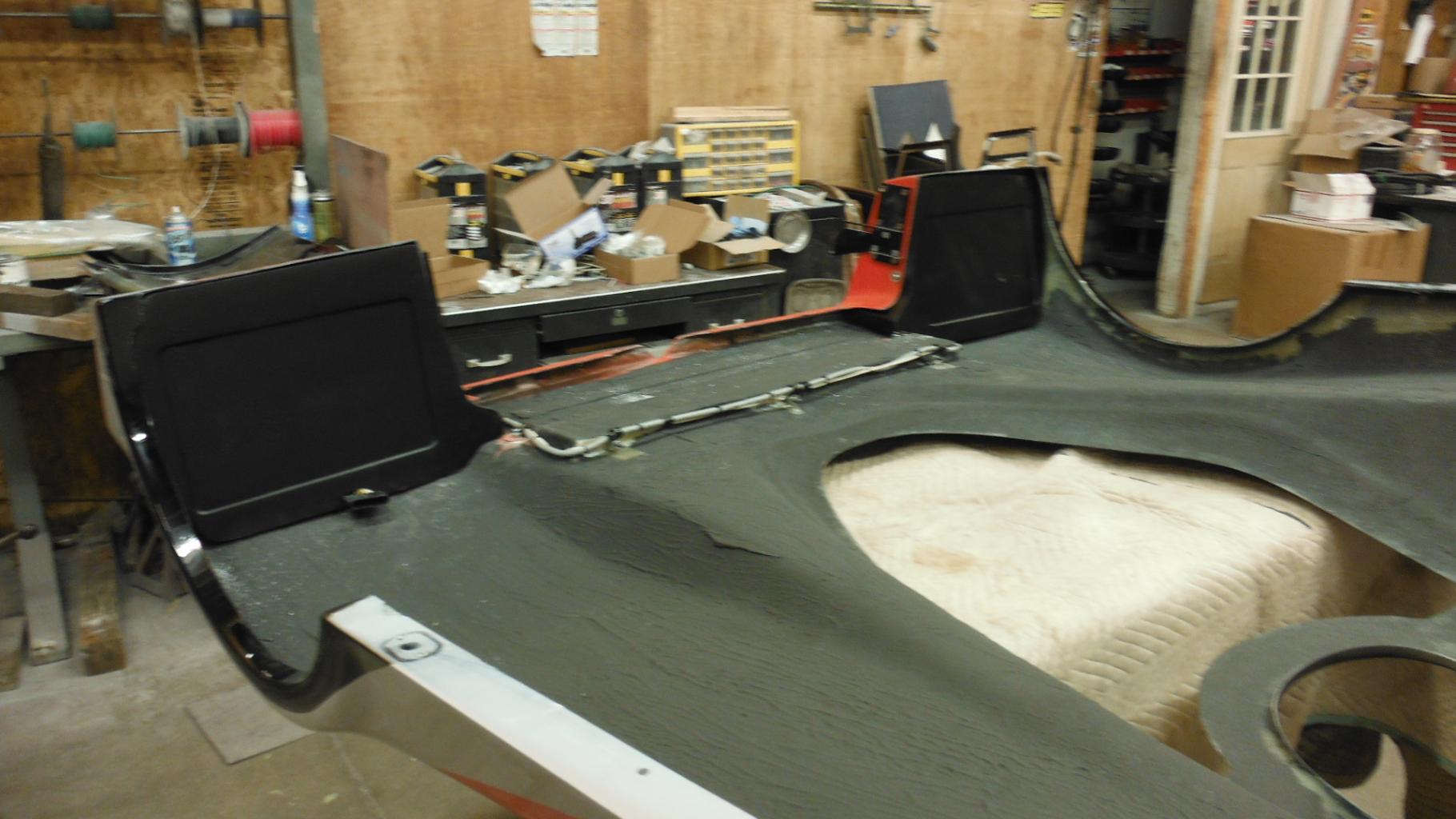

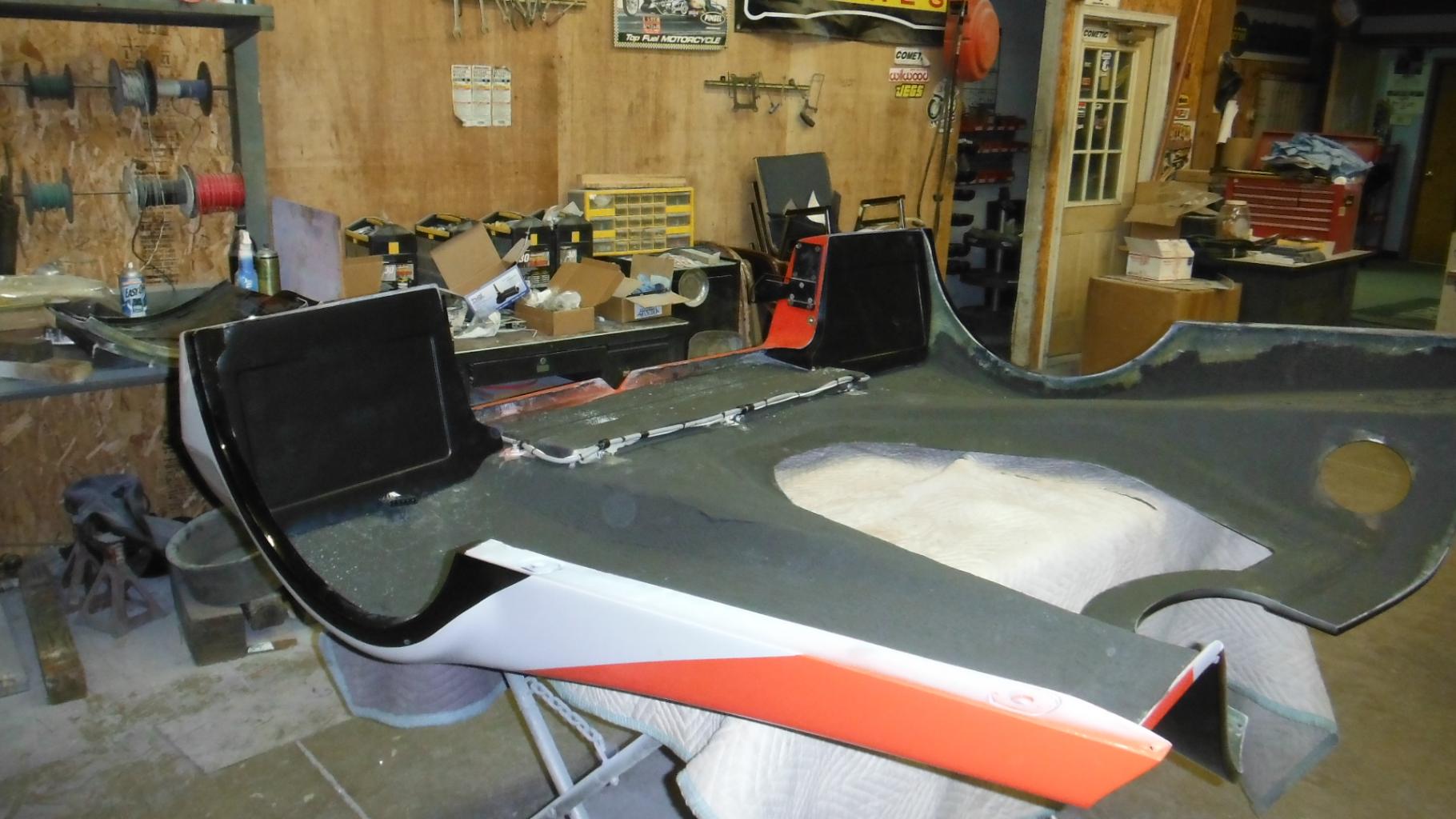

Took 10 hours to paint this yesterday the colors, 7 hours on Saturday for the inner parts of the car, 7 rolls of masking tape, roll of 12" paper, quart of prowler red, grey, black, PPG paint, gallon of clear.

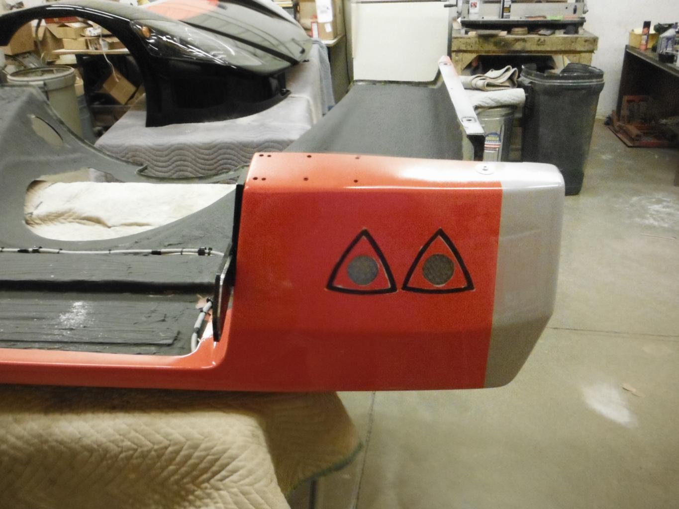

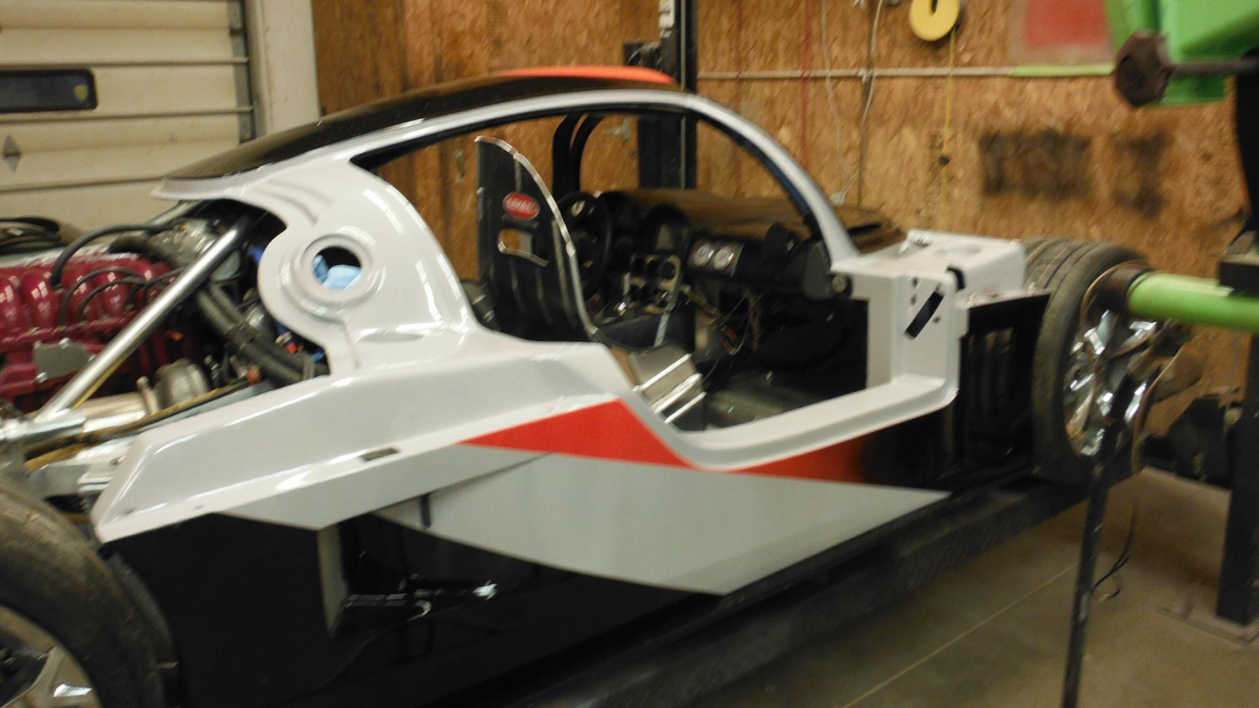

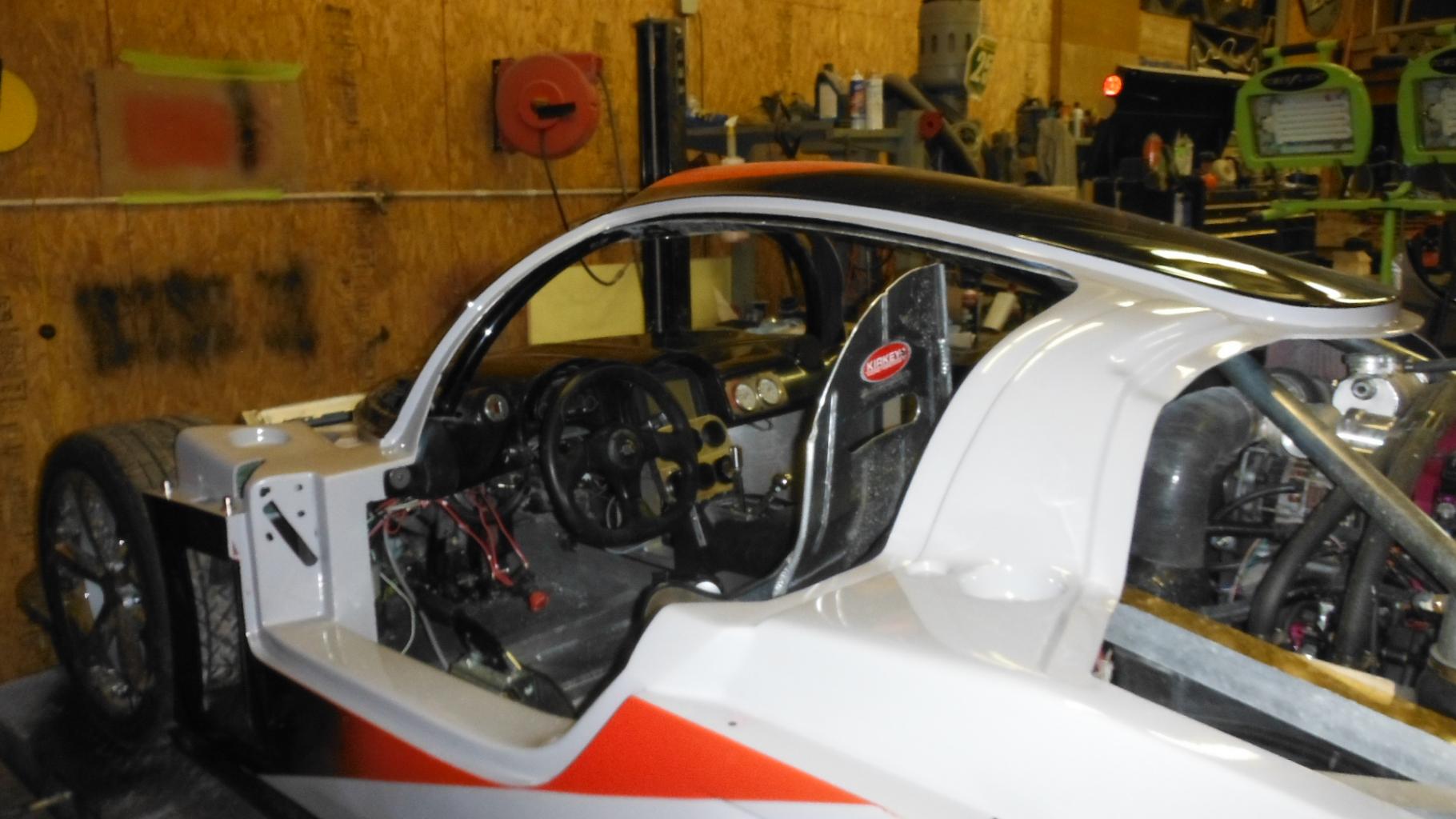

Mounted the center section today, seats, belts, wiper motor, gauges. TOmorrow the windshield, front and rear section are all done, tho I do have to touch up my tail lights, the paint came off in some spots when removing the tape, o well, I have plenty of paint.

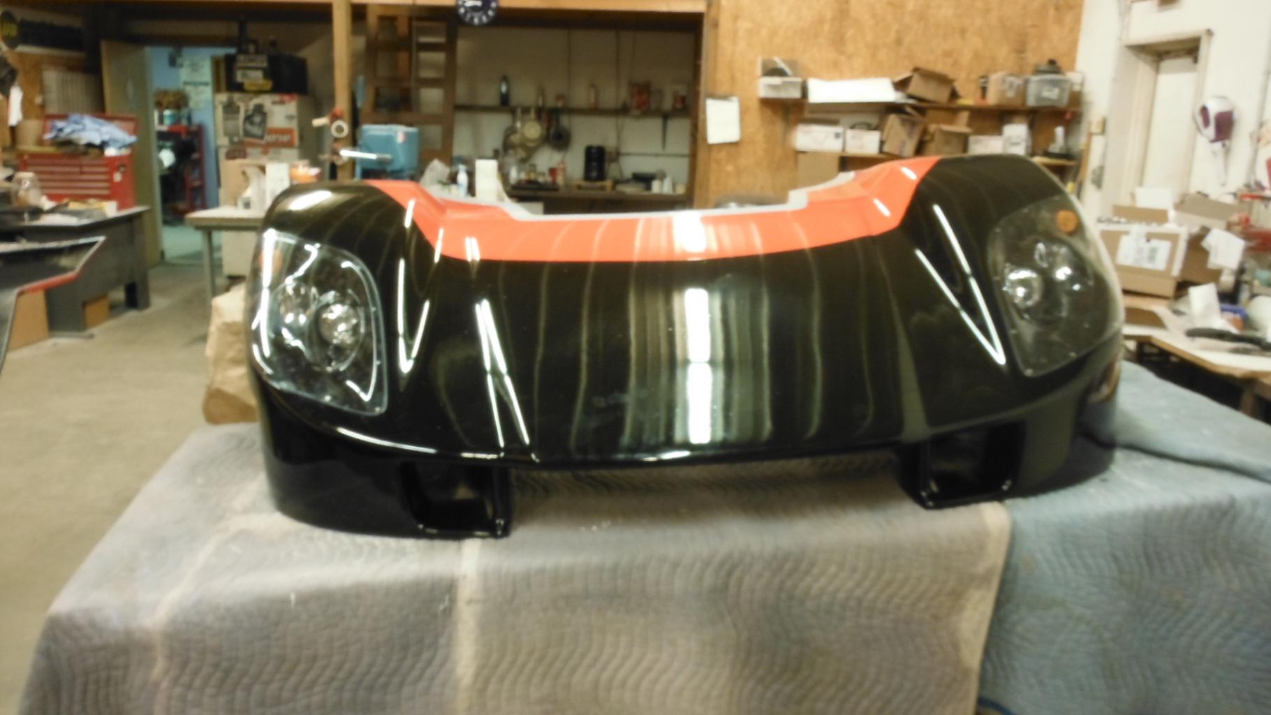

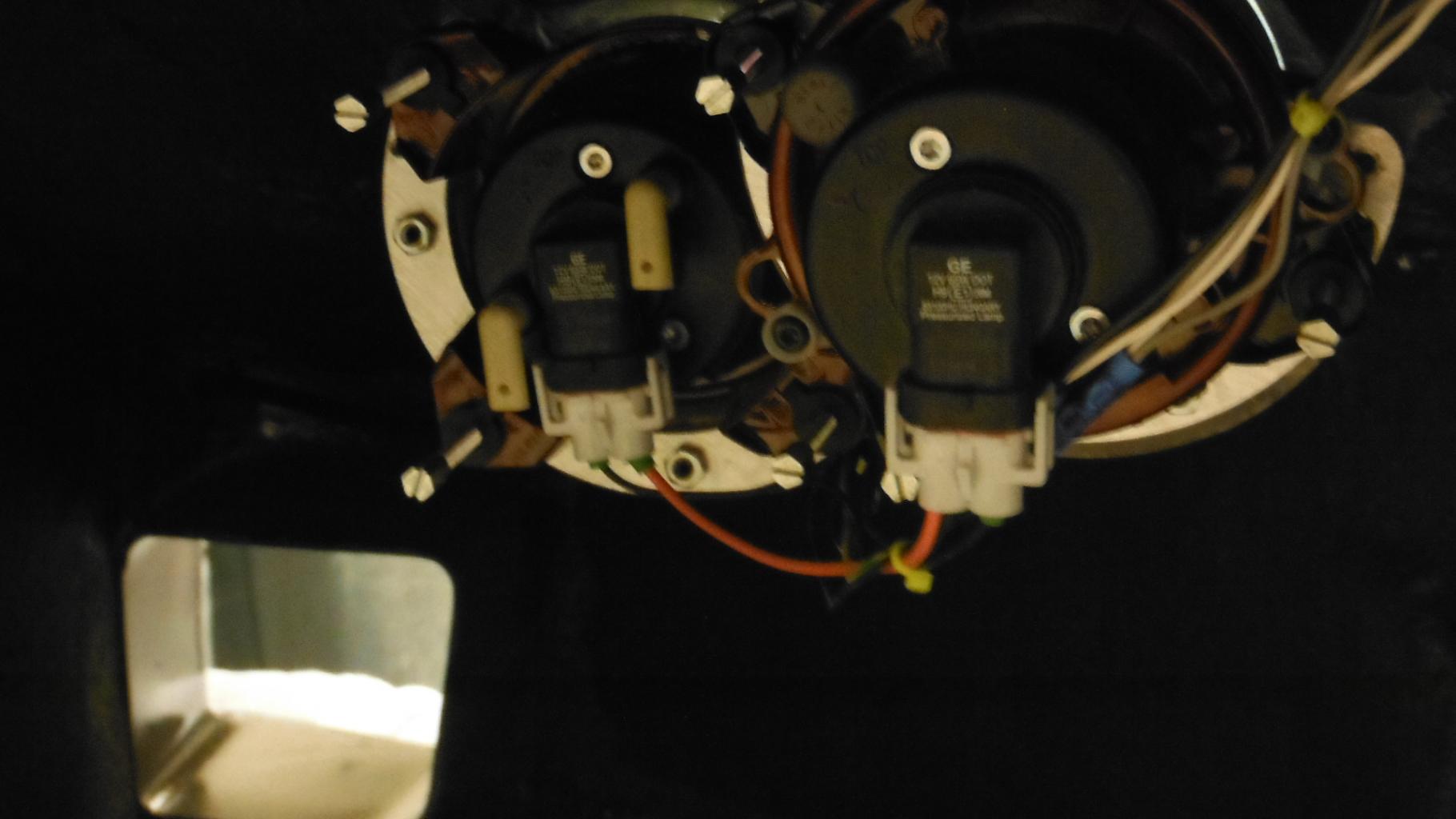

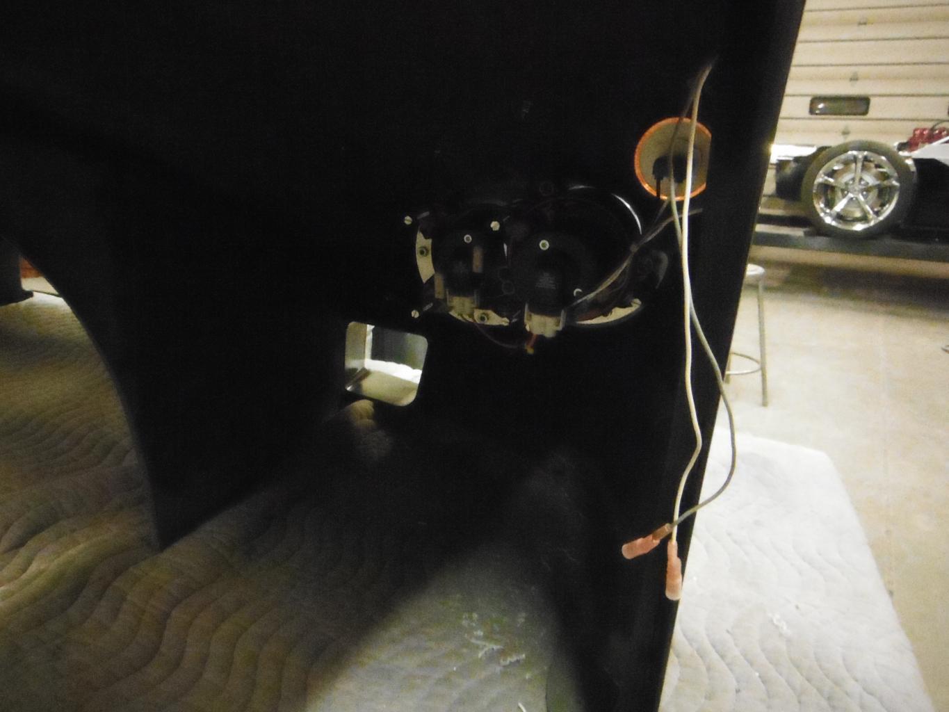

The first picture is my head light rings, you can use the stock ball and socket that comes with the head light kit. Drawing is free if anybody wants it.

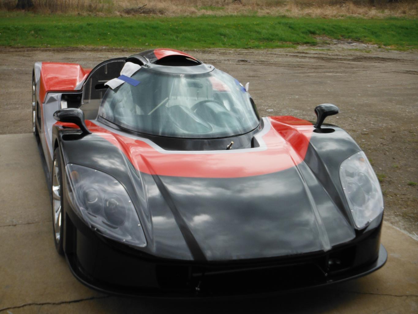

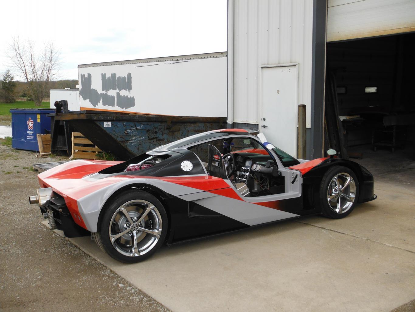

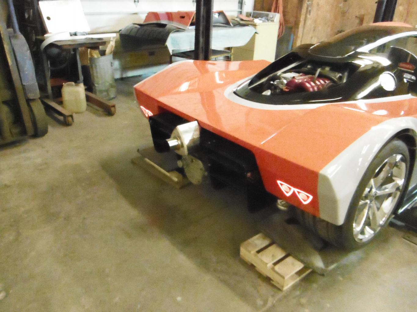

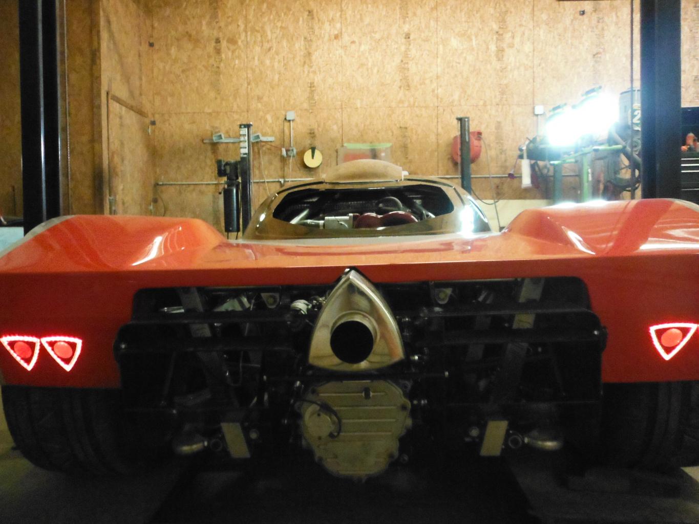

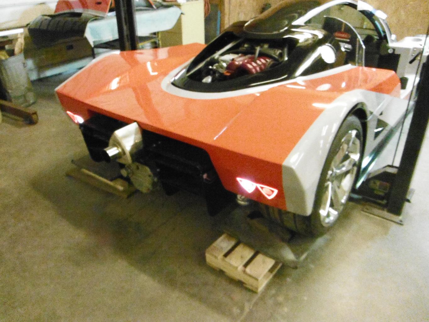

Just had the windshield installed, had to shim the body a little but is in. Back end finished other then the camera and license plate mounting. Tomorrow ill mount the front end and hope everything will work, it did when I checked it out, but its been a month now.

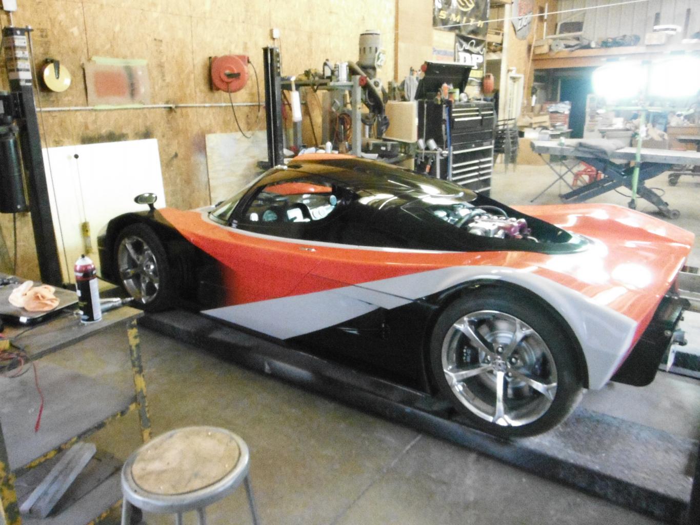

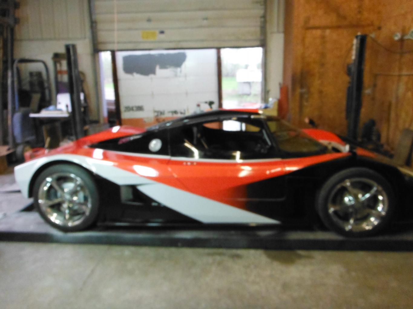

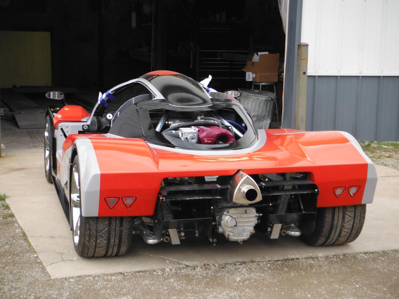

FIrst time outside, waiting for the windshield to finish drying, then Ill put the doors on, camera, plates.

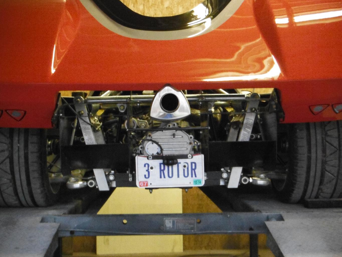

Plates and camera mounted, im going home 14 hr day today, but enjoyable. Doors and seat covers tomorrow if I have time.

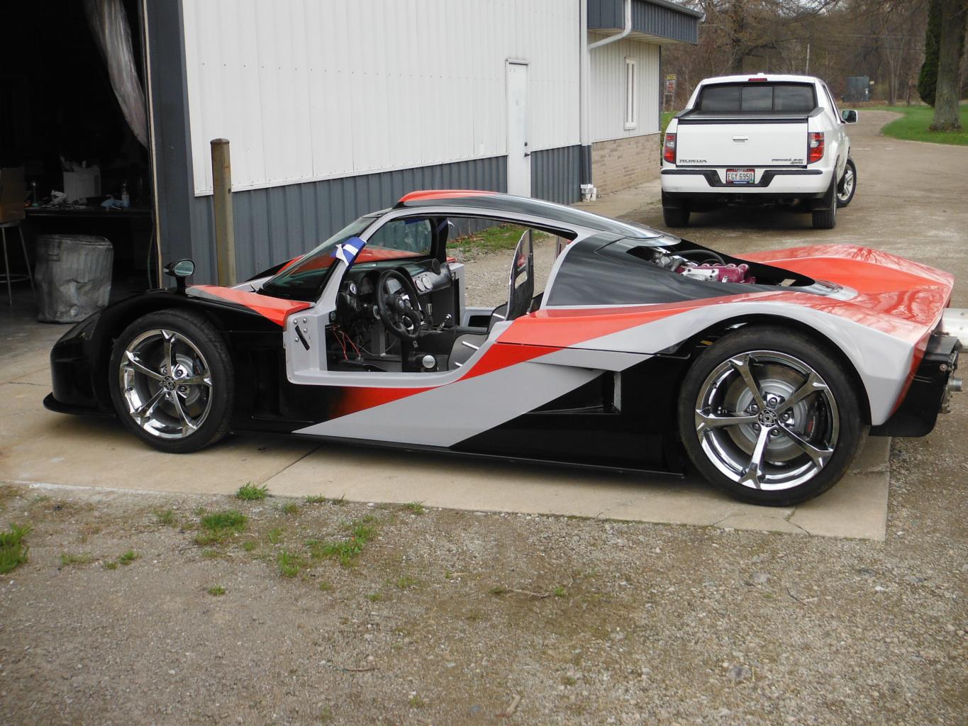

Finished putting the doors on, one shock on driver side keeps the door up, but passanger side wont stay up, must of did something wrong. Have 120 lb shocks on it also, doors could use a little massaging also, when they installed the windshield, they had to shim the body for the gap so its out of whack a little, still looks good tho. Tried to make Mongoose's cruise nite tonight, but didn't happen, couple weeks it will be there for the next one.
Garry, given all the three sided iconic clues decorating the rear end, what kind of punishment have you got in mind for the guy who (you know he will) comes up to you munching on some snack and asking: "What kind of motor have you in there dood?"
Ill have to think about that answer, probably just tell him its out of a RX 7, most have heard of that, anything else most wont grasp.
Raining most of the day, did finally get my door shocks to work and hold the door up, did use 120 lb shocks, 12" long.
