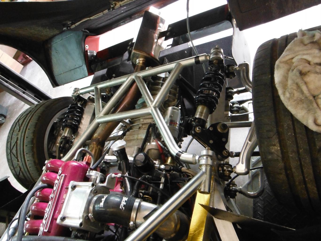

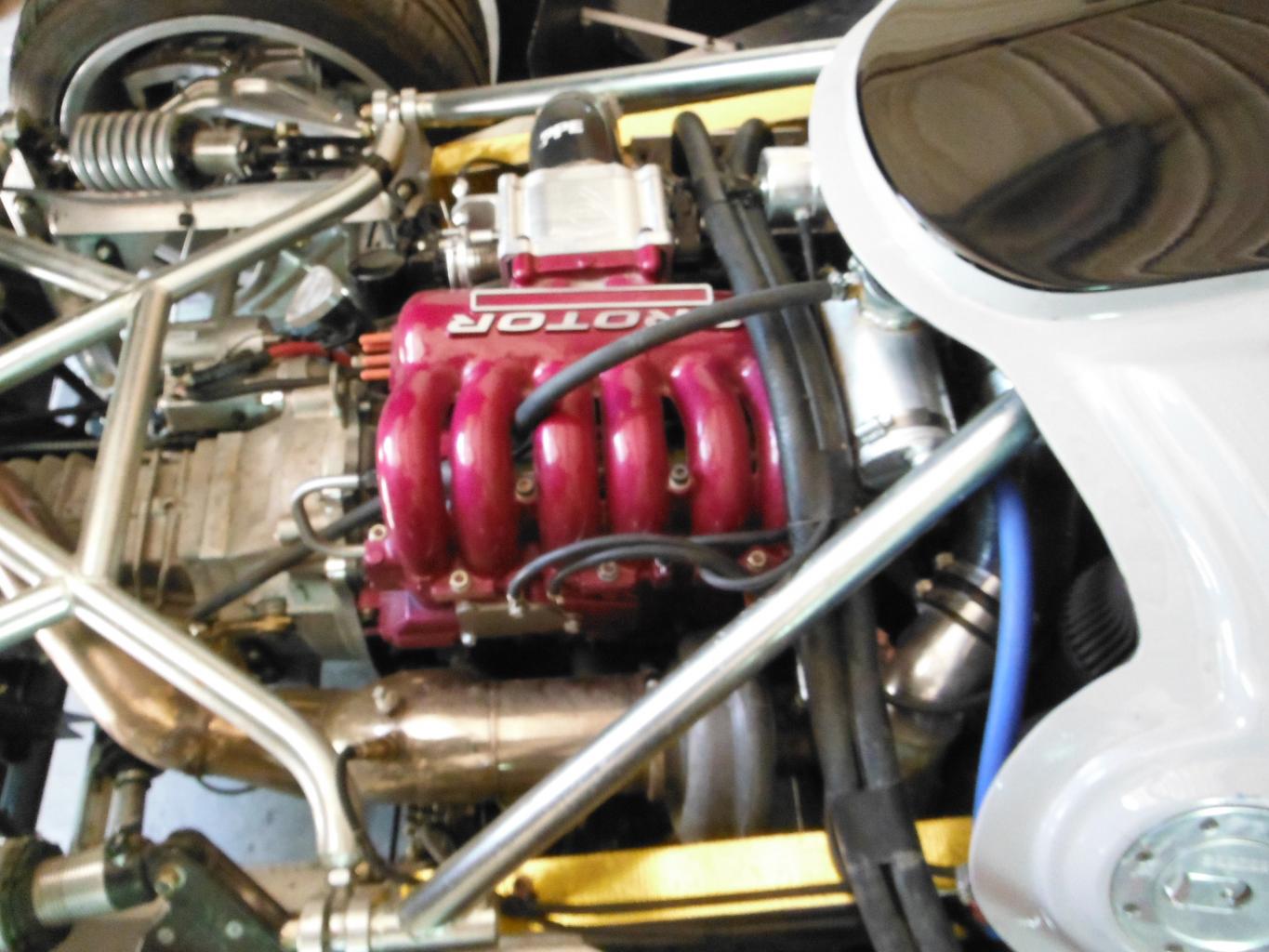

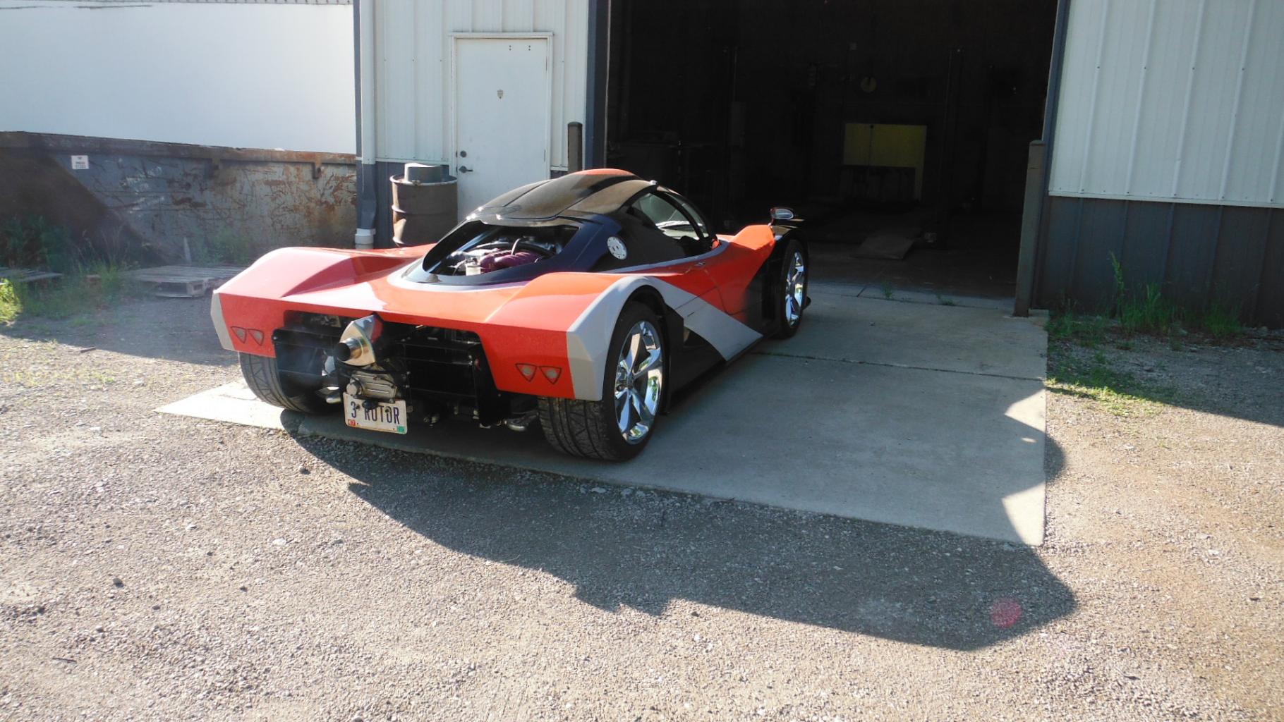

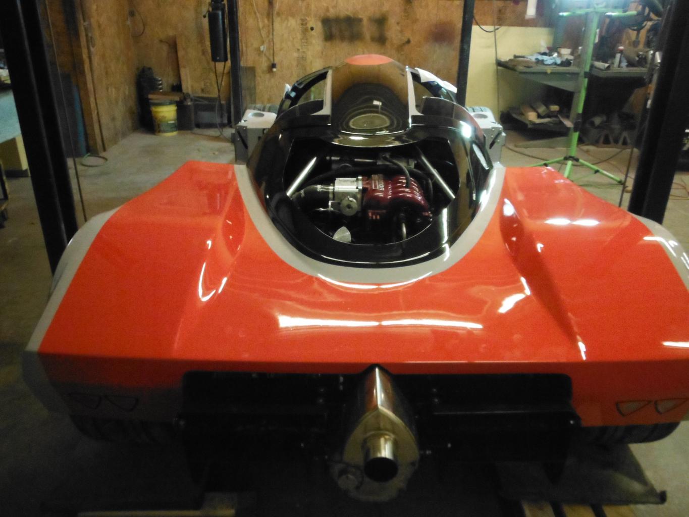

Correct me if I am wrong, looking at your pictures you might be having a traction problem because it looks like your rear springs could be coil binding under acceleration? Maybe you will have to step up to a little stiffer spring set up. I have big torque in my car and it hooks up really well with big cube LS motor. I also noticed on mine it works better after the tires have scuffed in more, same tires you have.
I think with the turbo and piping etc, around 300 pounds, shipping weight of the motor only was 260.
I ordered 750 springs, ill have them tomorrow, already have the old ones off so im not tempted to drive it tonight.
Thank Fran for the heads up on that, never even thought of it.

I'm running a LS3 (360lbs) with a G50-20 6 speed (150lbs). My rear coil-overs are adjusted nearly to the limit and the springs are compressed like yours, so I'm very interested to hear how the 750lb upgrade works for you.

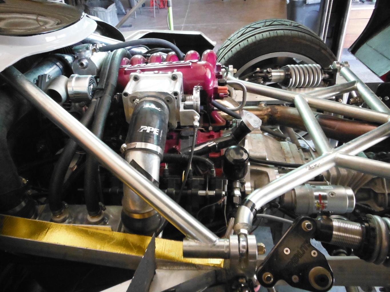

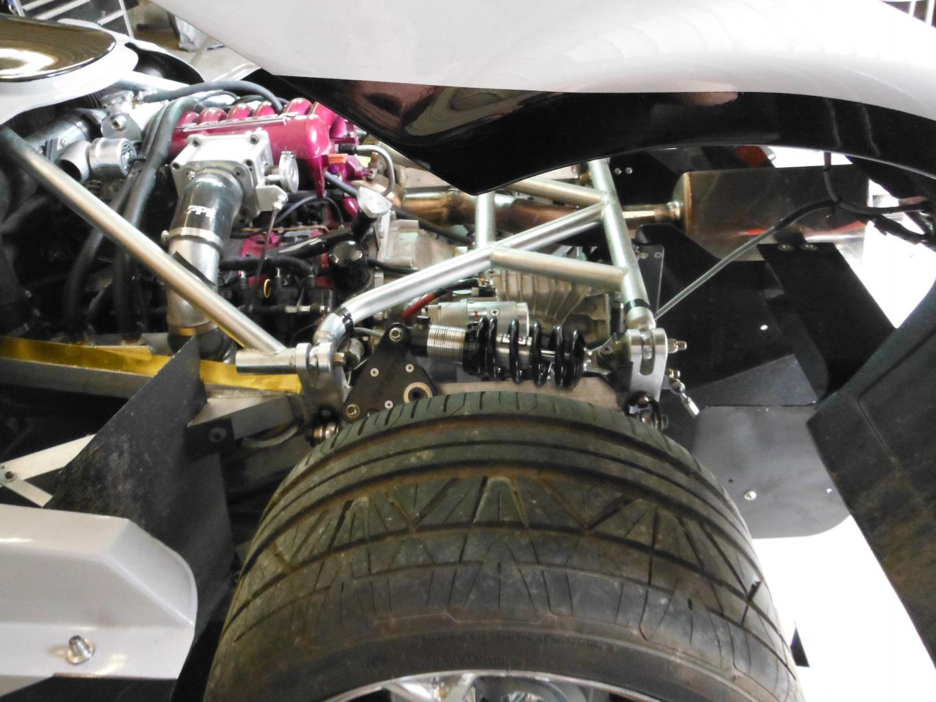

Here are the pictures of the new springs, 750 lb verses 650 lb which come with the car. Thanks Fran for noticing what was wrong before I hurt something.
Before and after pics. 5" ride height in back.

I see that the coil-overs are still adjust nearly to their limit. Are the 750lb springs shorter?
How is the ride with the stiffer 750lb springs?
I havent drove it yet, but its not coil bound at least. Yes 750 lb springs, 5 inchs of clearance.. Ill know this weekend, tonight grandson graduates high school, tomorrow baseball game and been married 36 LOOOOOOONG years, what a better way to celabrate at a ball game.
