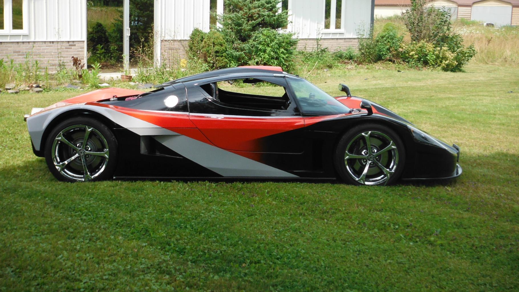

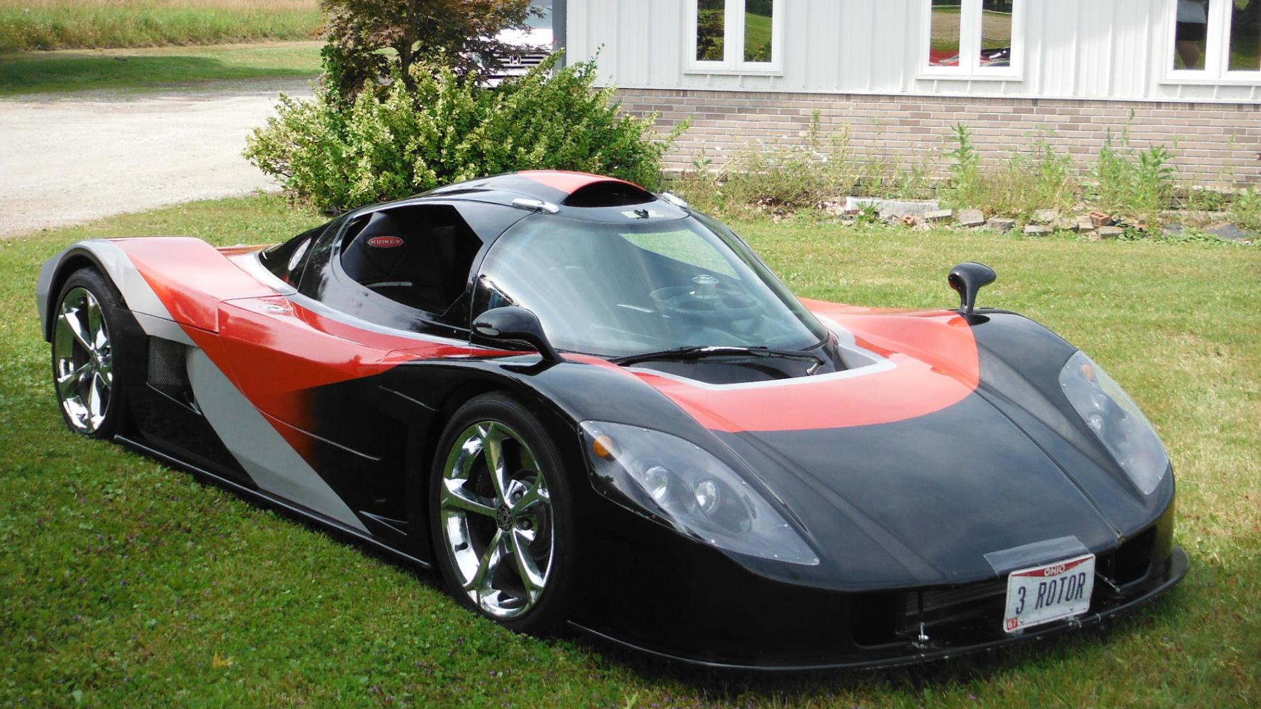

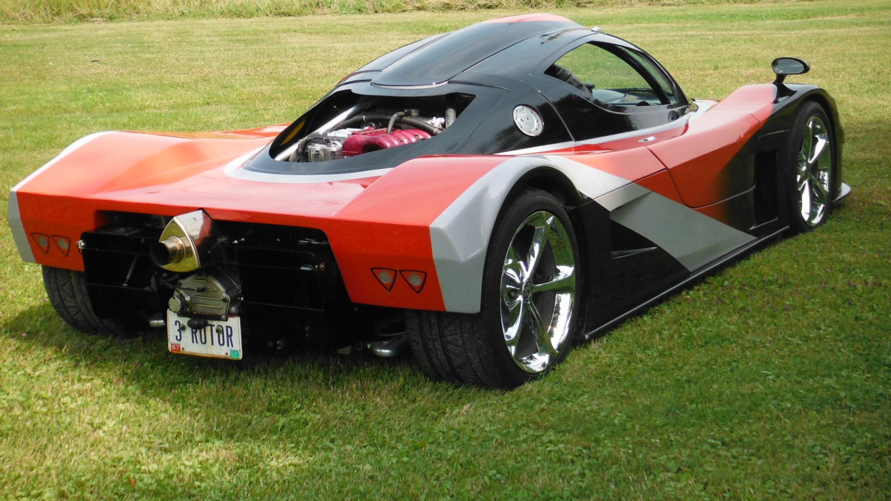

Here are some pictures I took and this is how im driving it right now. Will finish it up this winter with interior, still sorting out some mapping problems but it is fun to drive, not quite inside, nor do I plan to put windows in there either.

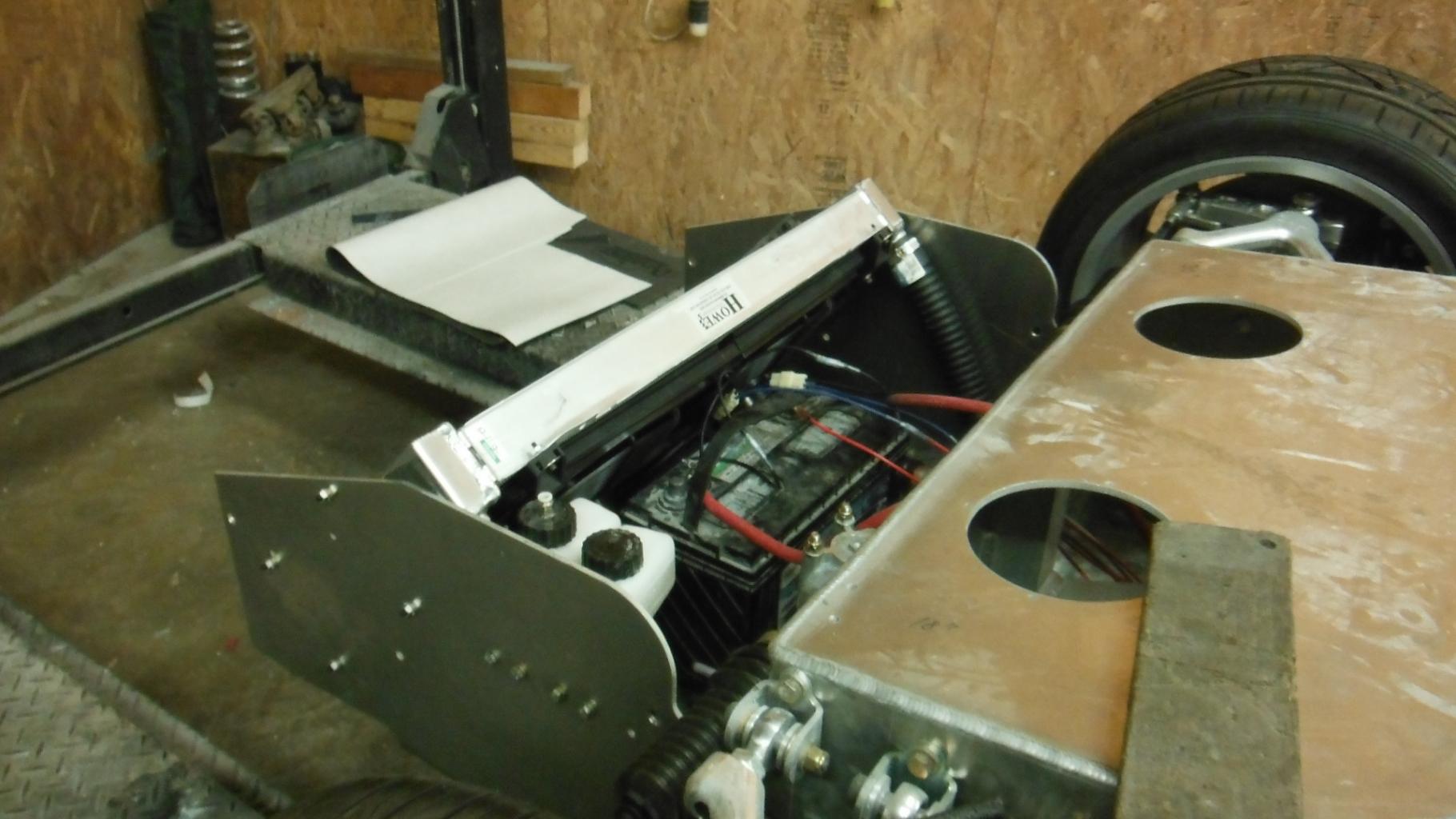

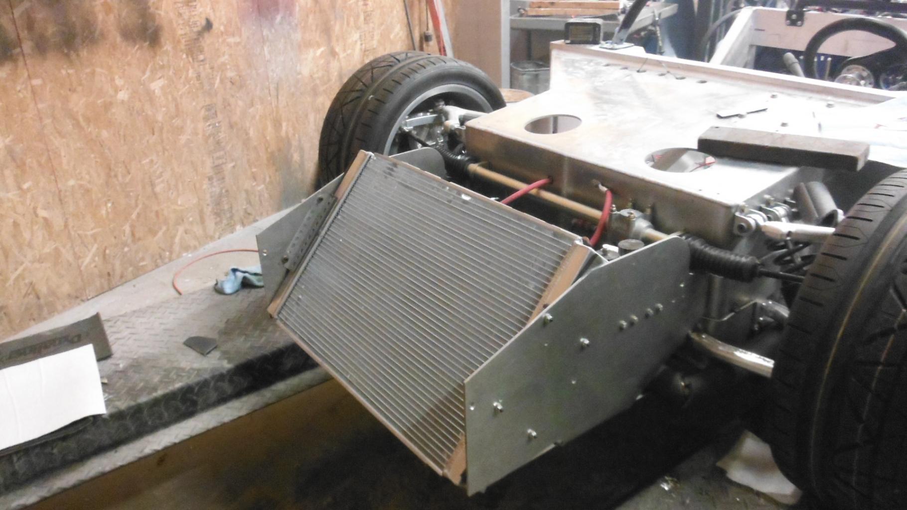

My engine runs around 150-160, I have temp gauges on the motor and on the radiator so I can see what the motor is running at and what is going into the radiator, when the thermostat opens up, you can see the water temp on the radiator go up to around 150, dont matter if its idling, running hard, on the dyno, it just stays at around 150-160. I did have a problem with air in the system, so thats why I went to water wetter, water around the exhaust port would boil after shutting off, so it would give me air, so put 2 pint bottles of water wetter in, stopped that.
I dont use Frans radiator, I use a Howe round de round one, 180.00 bucks from Summit, and 2 - 3000 cfm fans and its mounted on the angle the other way

I've seen conflicting comments about water wetter type additives. Some manufacturers claim it reduces coolant temps 8-30 degrees, while some users see no change in temps and call it "snake oil".
If your motor is running well within its operating range, you probably won't see a change on your temp meter because the thermostat will open/close to keep a constant optimal temp. If your cooling system is having a hard time keeping up, then you may see a temp drop from water wetter.
My experience is that water wetter does work, but only expect to drop temps about 5 degrees. However, sometimes 5 degrees is all you need!
I am like Gary, if my car(GT40) is moving even slowly in stop and go traffic, my temps rum 150-160 with only the electric water pump. They might creep as high as 170. If I am in red light traffic I will switch on the fans and it never reaches 170. Noticed it yesterday in 90+ degree weather and today in 87 degree temps(overcast). I have an A/C compressor but it isn't connected to anything. It gets warm of course but I don't have sweat running off me. I guess being under 160 lbs. helps.
