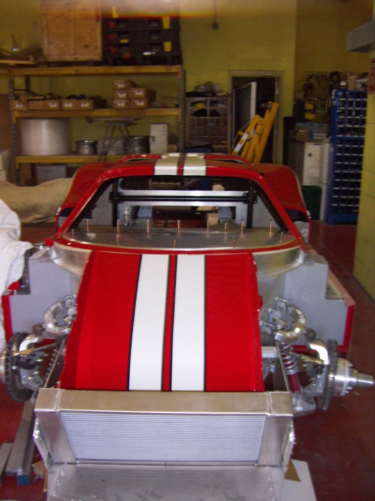

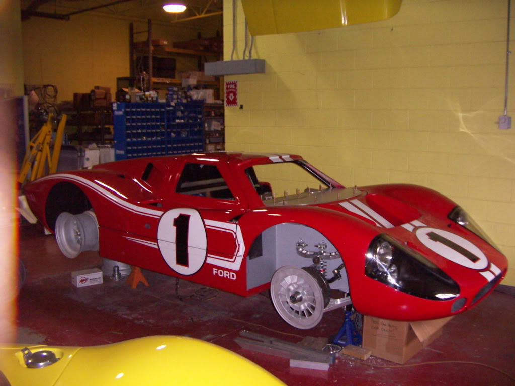

Hi Kieth

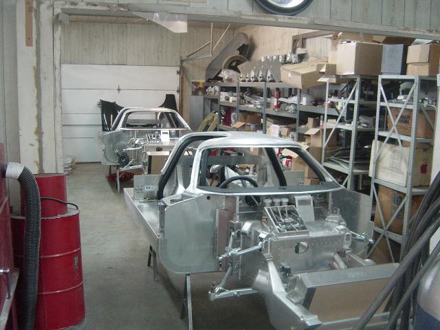

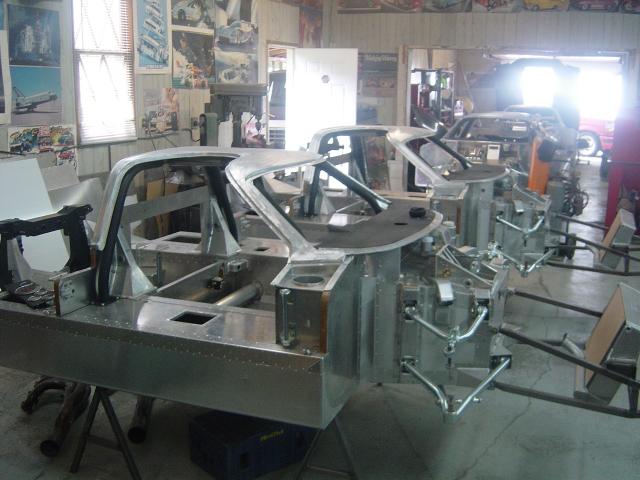

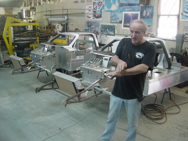

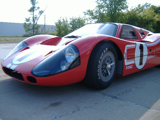

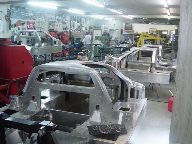

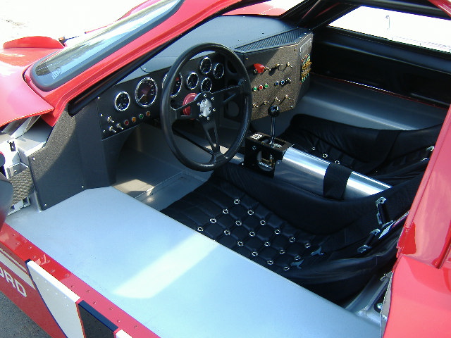

Here are some pics of Kenny Thompsons Mk IV / J car Replicas
GT40 INTRESTING PICS 068.jpgGT40 INTRESTING PICS 069.jpgGT40 INTRESTING PICS 070.jpgGT40 INTRESTING PICS 071.jpgGT40 INTRESTING PICS 072.jpgGT40 INTRESTING PICS 073.jpgGT40 INTRESTING PICS 074.jpgGT40 INTRESTING PICS 075.jpgGT40 INTRESTING PICS 076.jpgGT40 INTRESTING PICS 077.jpg

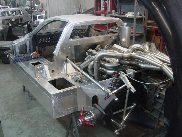

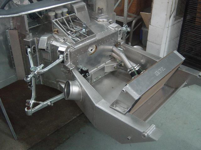

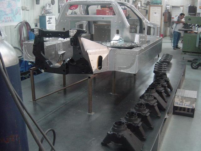

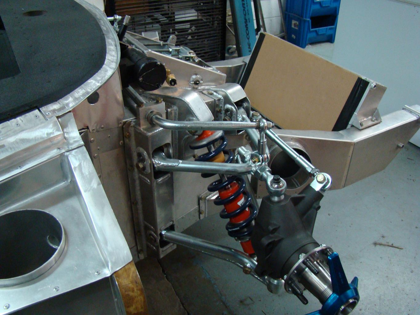

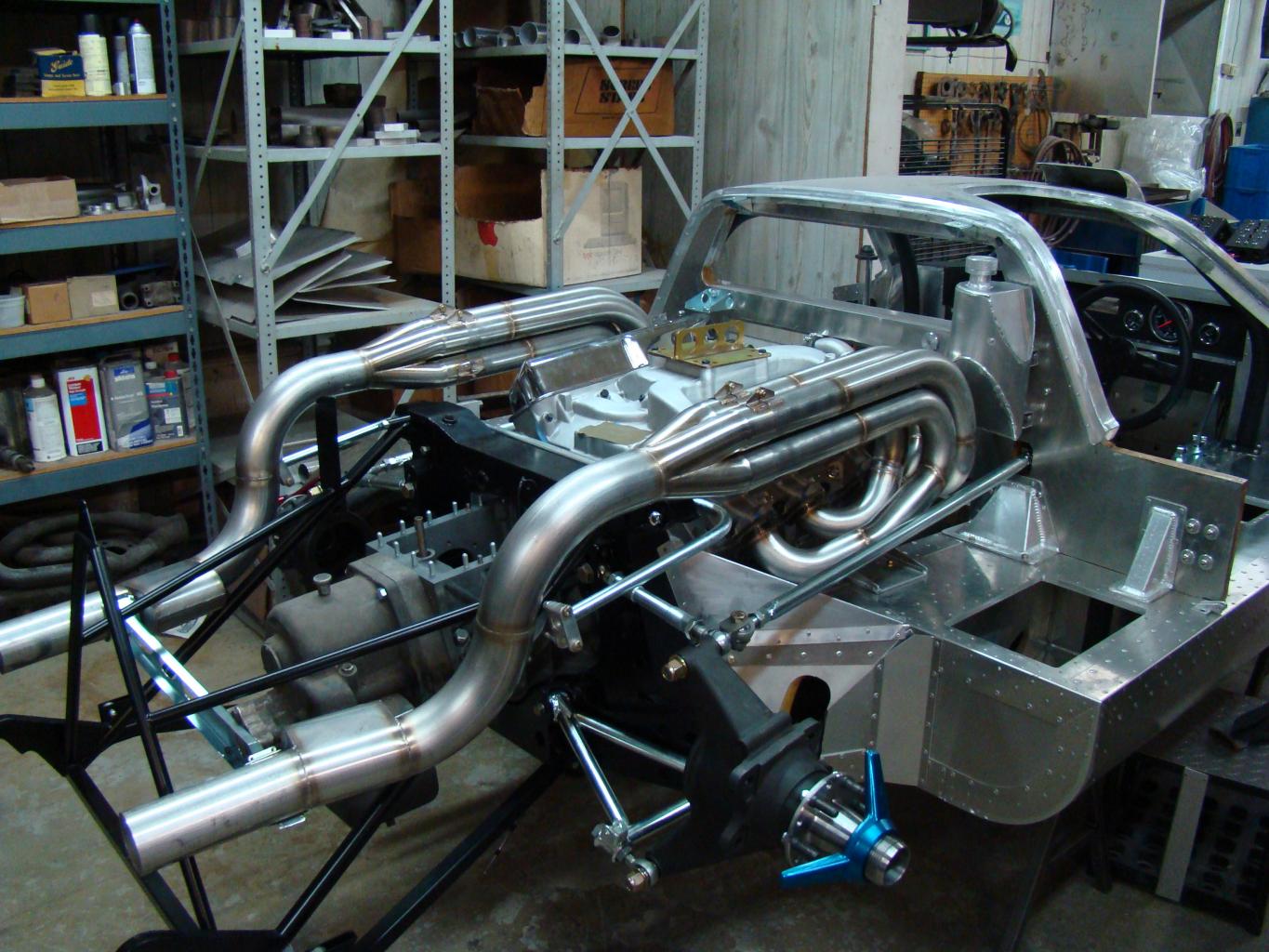

The shape of the RCR chassis is actually quite similar....although it is not honeycomb per the original it is aluminum.
Wow, those are some awesome photos... is there additional info
available on these cars? How many $$?
Very nice indeed.

All of the "J" chassis' were honeycomb construction. In fact, the material used was "strategic defense material" and Honeywell had to get defense department permission to supply it to Kar Kraft.
The suspension bracket failures were resovled with improved adhesive and more rivets. The early "J" chassis differed somewhat from the later units. The sills were squared off and the rows of rivets were increased.
