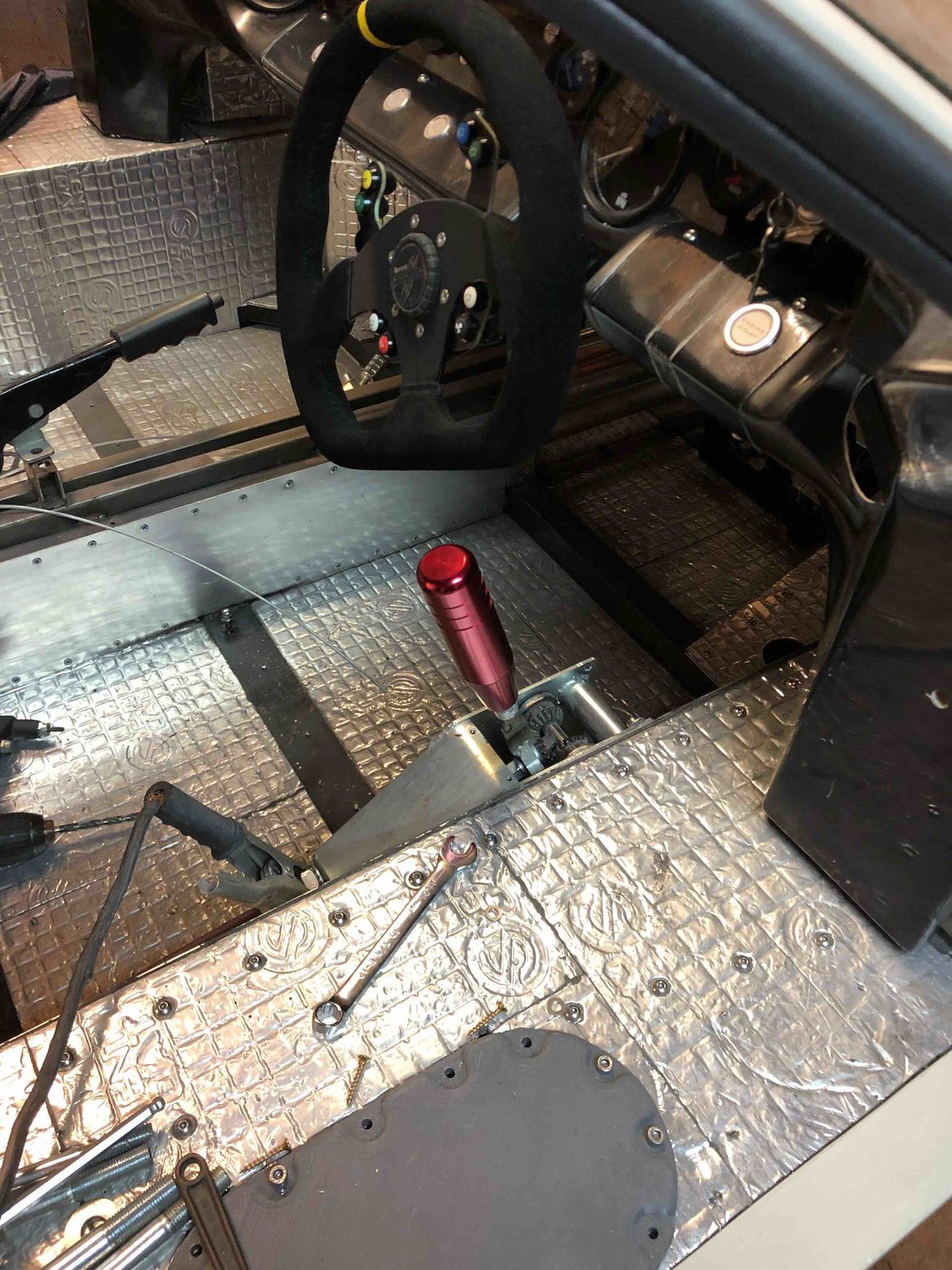

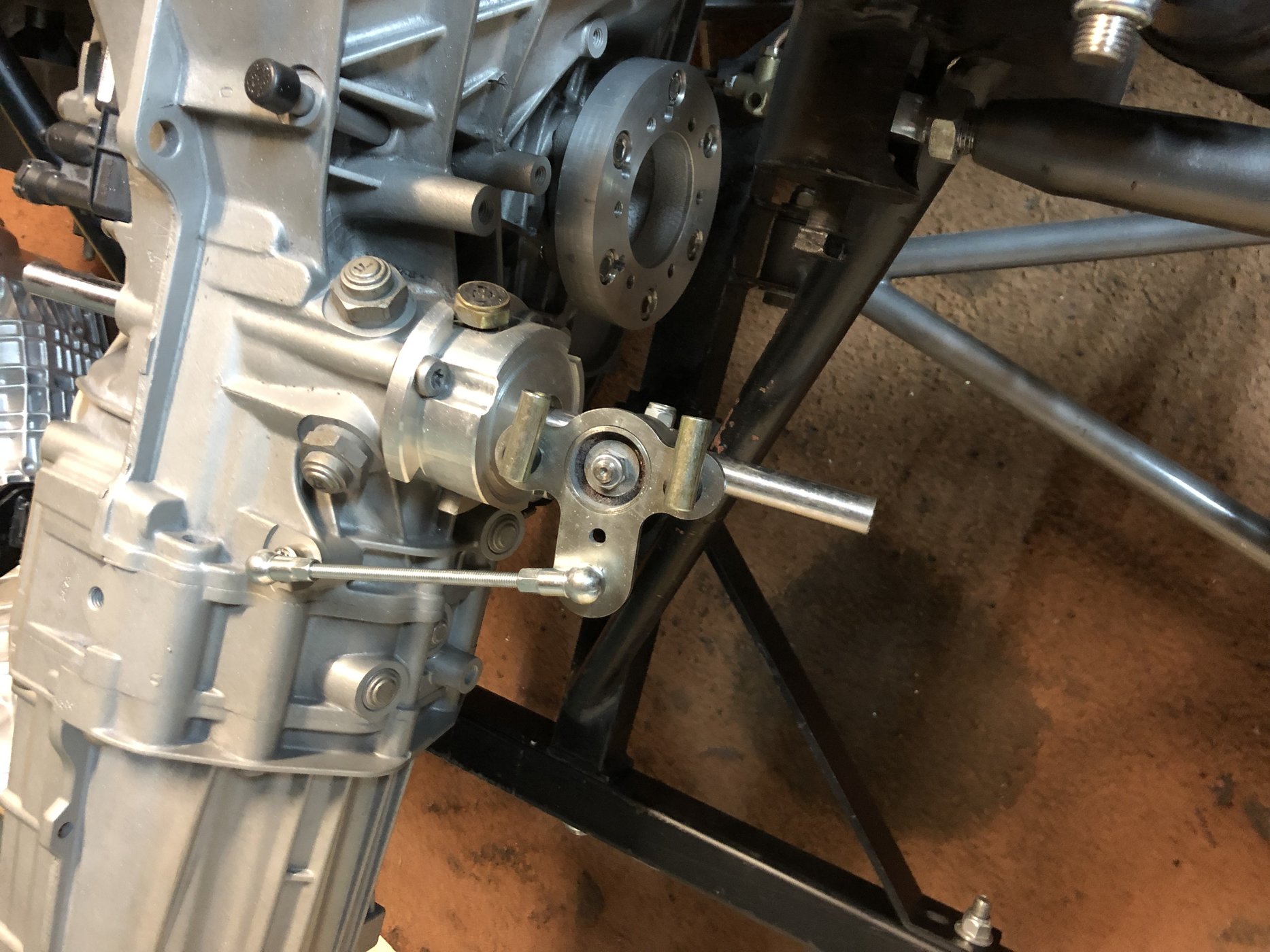

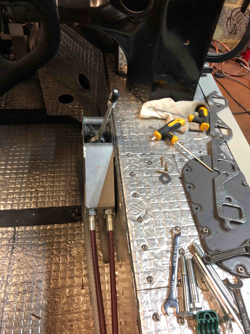

NickD
A day well spent in the garage. Managed to fit the push / pull cable mechanism and mounted the cable bracket to the chassis. All seems in order so that's another job ticked off.

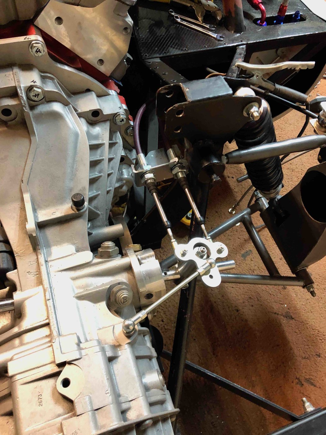

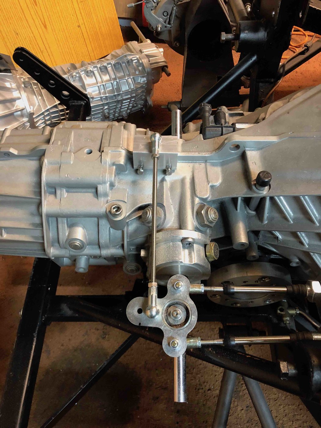

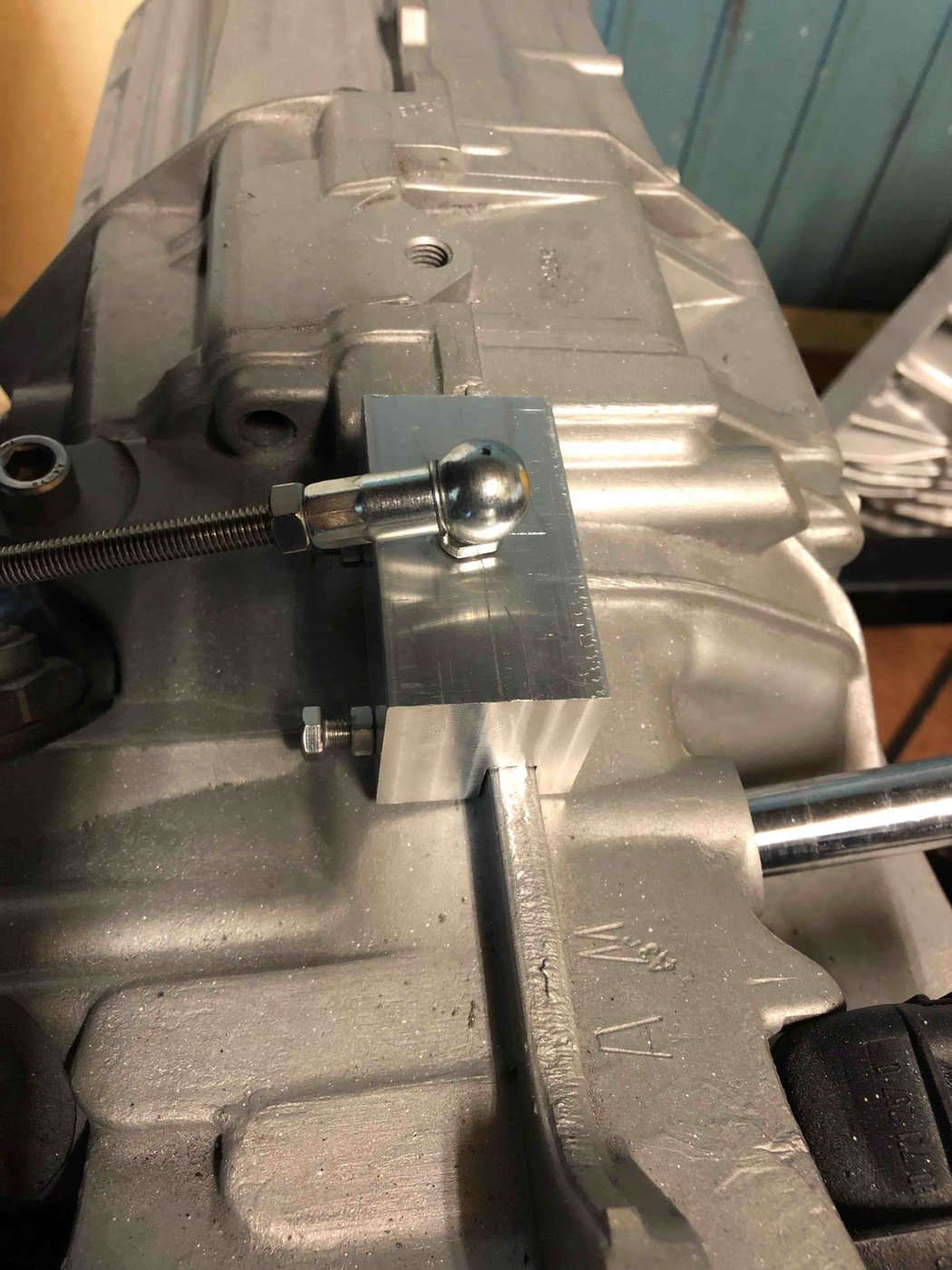

NickD
Actually, the job wasn't quite ticked off. when I tried to tune it a bit it was a little stiff up and down the gate but not across. Looking at the anchor point on the gearbox and thinking things through it didn't take long to work out why I was having a little trouble (resistance in the change) when going 1-2, 3-4 & 5-6 and visa versa. Long story short, made a small saddle to sit mid gearbox and provide a much better anchor point for when the translator threaded bar was only being used as a datum on which to anchor a push / pull point. (hope this makes sense). The previous off centre shorter mount position pic ( as suggested by the supplier along with other pre-existing mount points on the box, non optimum ) also included. Now its smooth as silk !

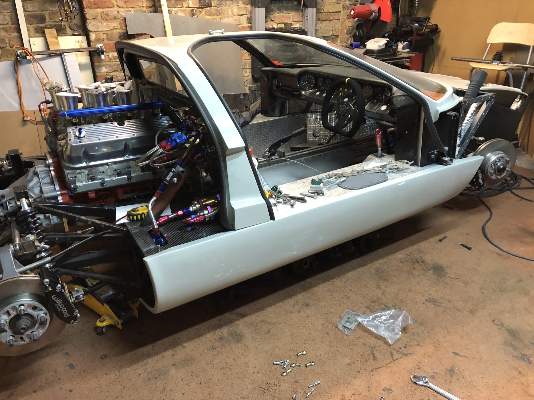

NickD
A little progress Today. For the 1st time i’m having a serious look at the body alignment. With the sills loosly in place and the Spyder also not bolted down, just trying the door fits. Have to mod the SGT door mounts Tomorrow as this is a Forte chassis but with a few mm here and there, looks like we are still on schedule for end of April engine start. (Dependant On knowing where exactly the exhausts need to exit the car so I can complete their build). As I live in a residential area, can’t possibly start her without exhaust pipes on.

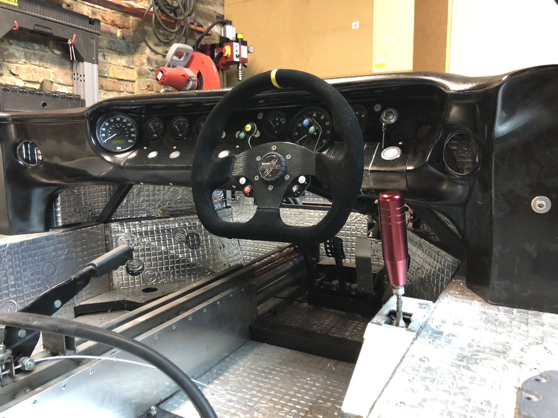

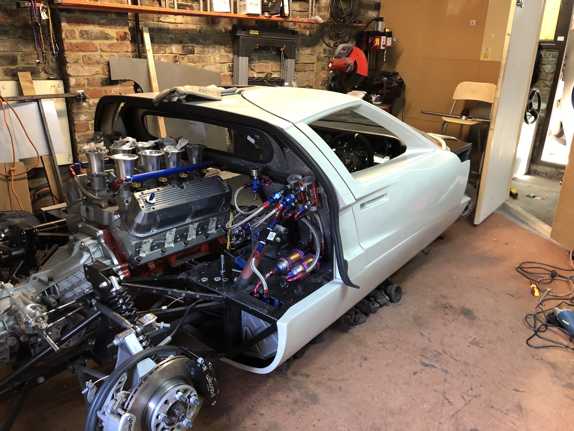

NickD

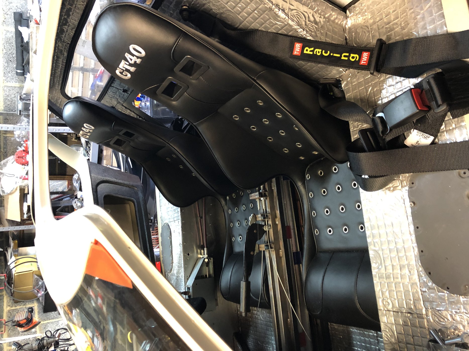

Been almost a month now but plenty of work behind the scenes. Have more or less finished the cabin and have now test fitted the seats. Have spent quite a few hours getting the Spyder and the doors in to an ideal position. Not quite done yet but shooting for an engine start in about 6 weeks given a fair wind.

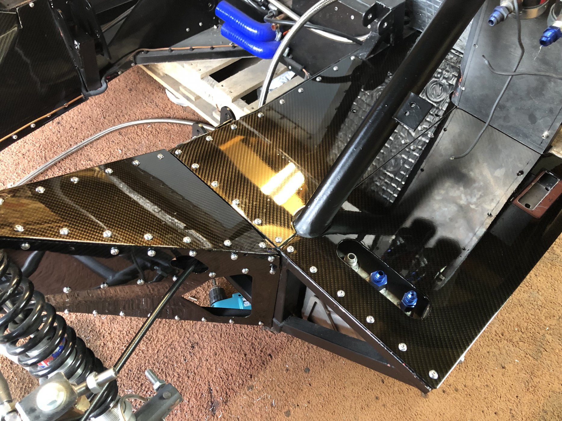

NickD

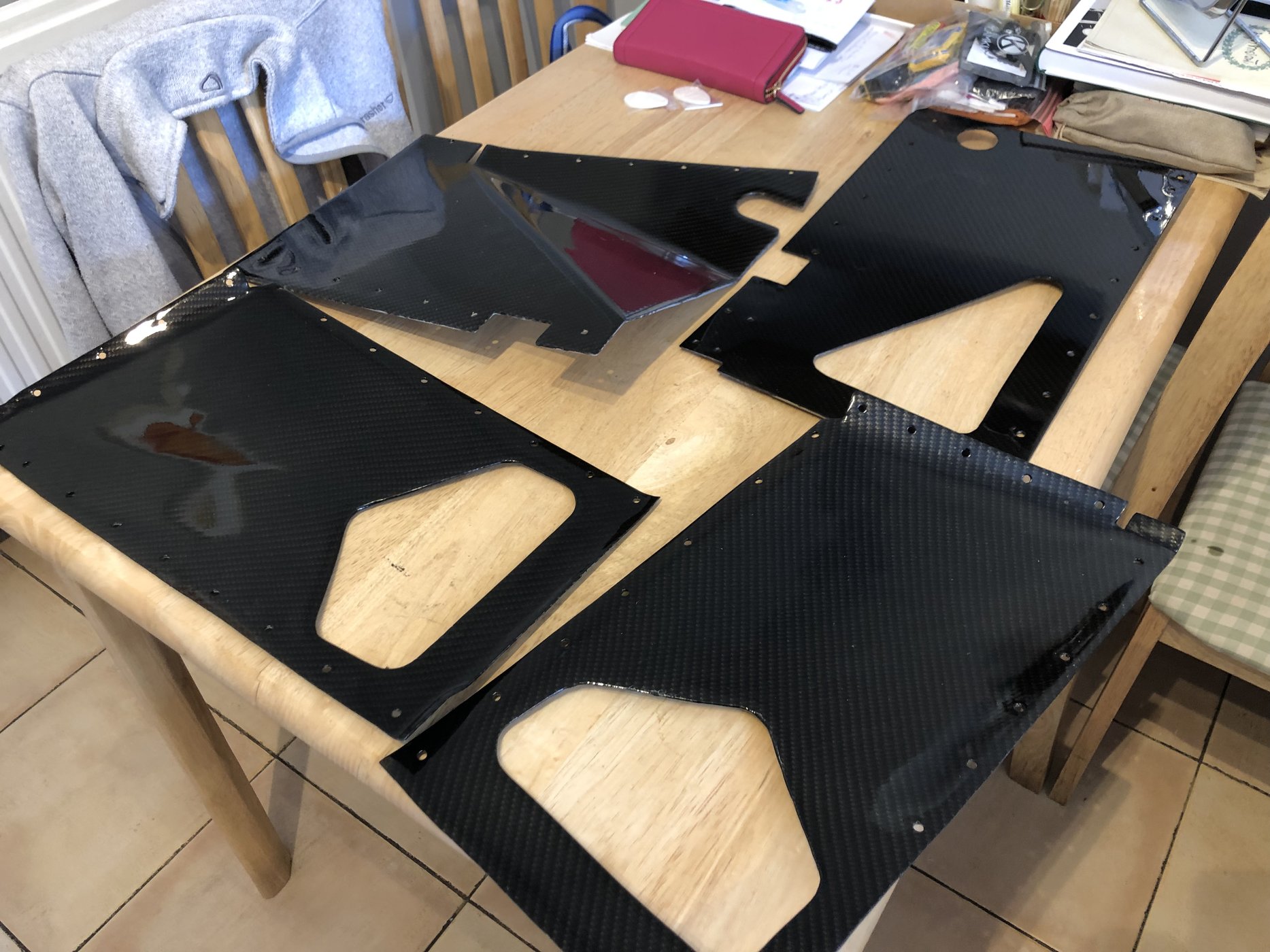

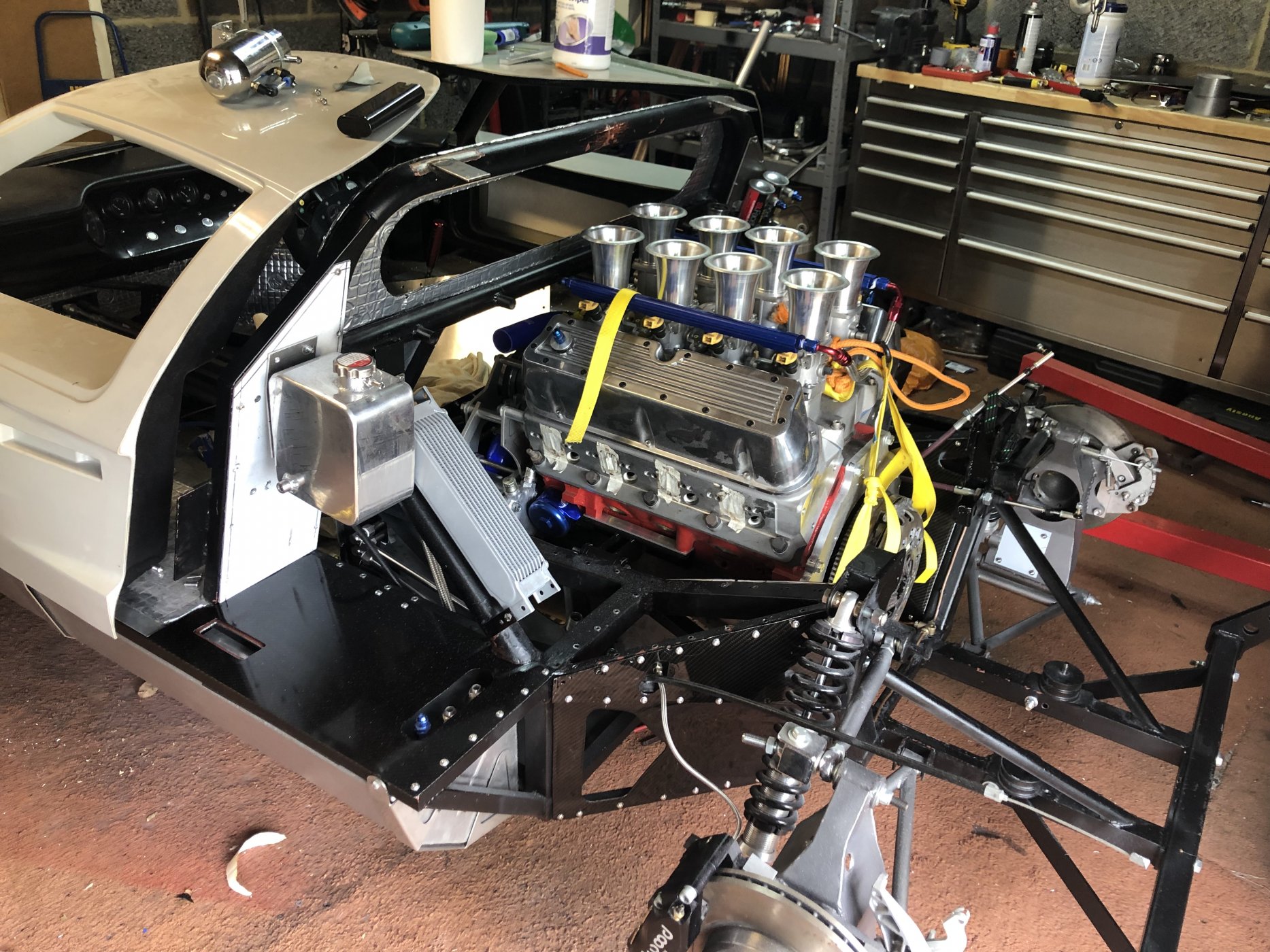

After a bit of a break to re-charge the batteries with some sun and sangria (too much I think), have the engine bay panels back from a friends and they do look good. Should have the engine bay finished within the month with the engine back in and ready to go.

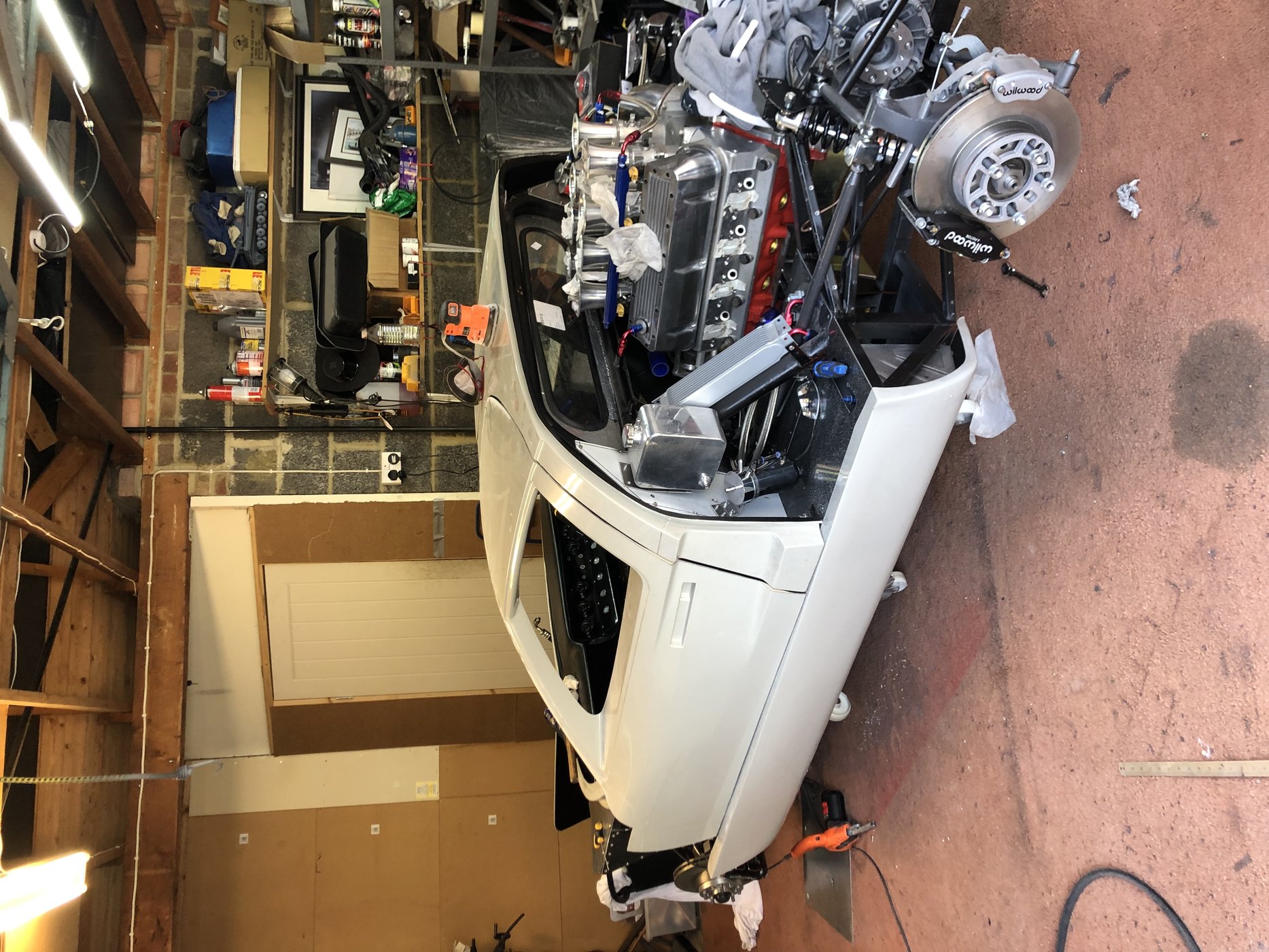

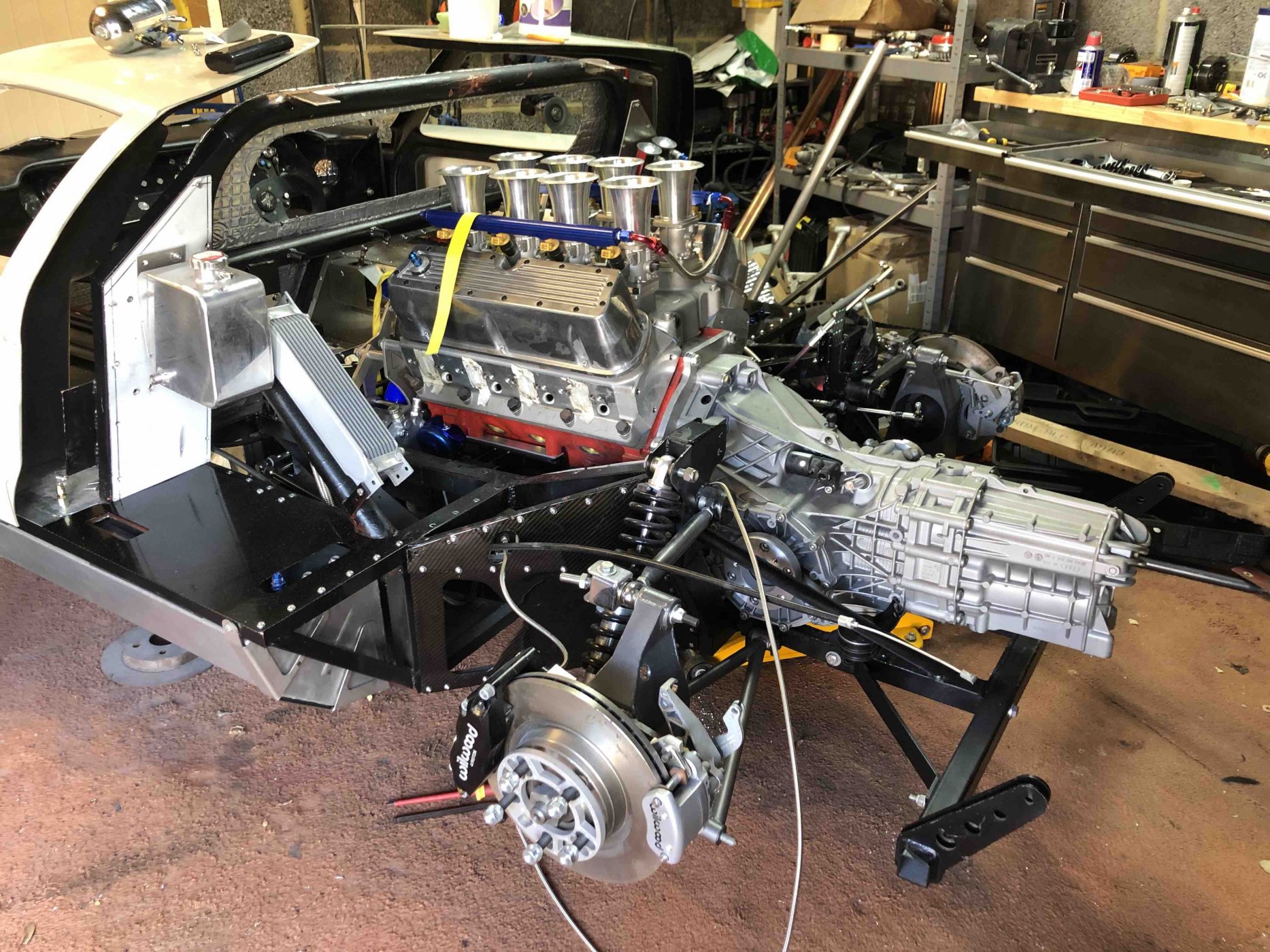

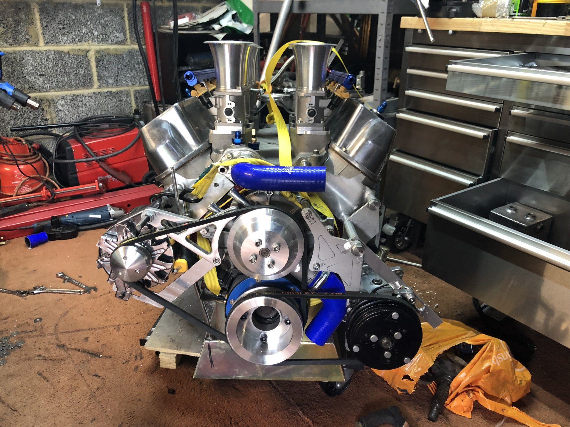

NickD
Engine pic was prior to cutting off the excess ally from the A/C compressor tensioner bar. Also having to pull the alternator in about 5mm. The Forte chassis is pretty tight so having to keep the ancillaries tight to the engine. No bad thing really.
NickD
Hi Nick what alternator bracket is that, and where did you get it from?
Nick
If I recall, it was purchased on eBay, link below:-
The lower tensioner I made myself from some sheet ally to replace the standard rod ended bar.
Nick.

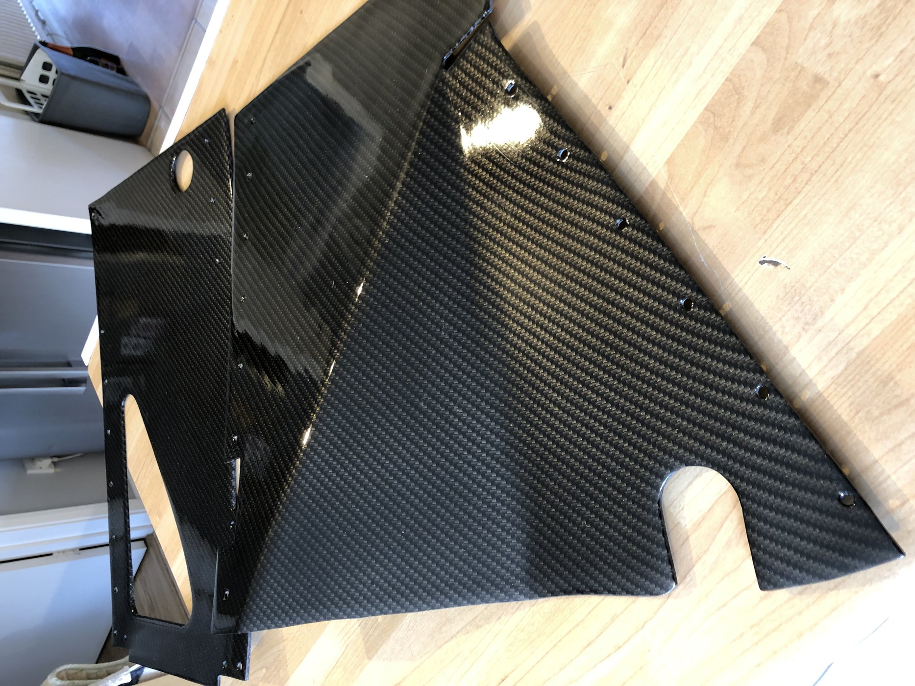

what make and model and where did you get your seats?
are the carbon fiber engine bay panels just carbon fiber or CF shinned aluminum?

Hi Jim,
The seats are Intatrim. They are based in Telford, UK. Personally I regret selecting the GT40 embossed logo on them but they are great except for that. Good value compared with others I've seen.
No, the panels are not just CF. I originally went for CF Skinned Ally which I did myself but was never really happy with the finish. So, had that all flatted back a little and then had the lot done the Hydrographics way. They now look a million times better. If I was doing it again, would I bother, probably not but they do give the engine bay a nice look.

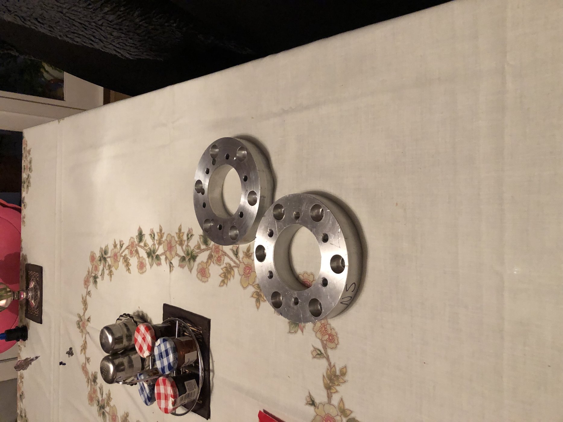

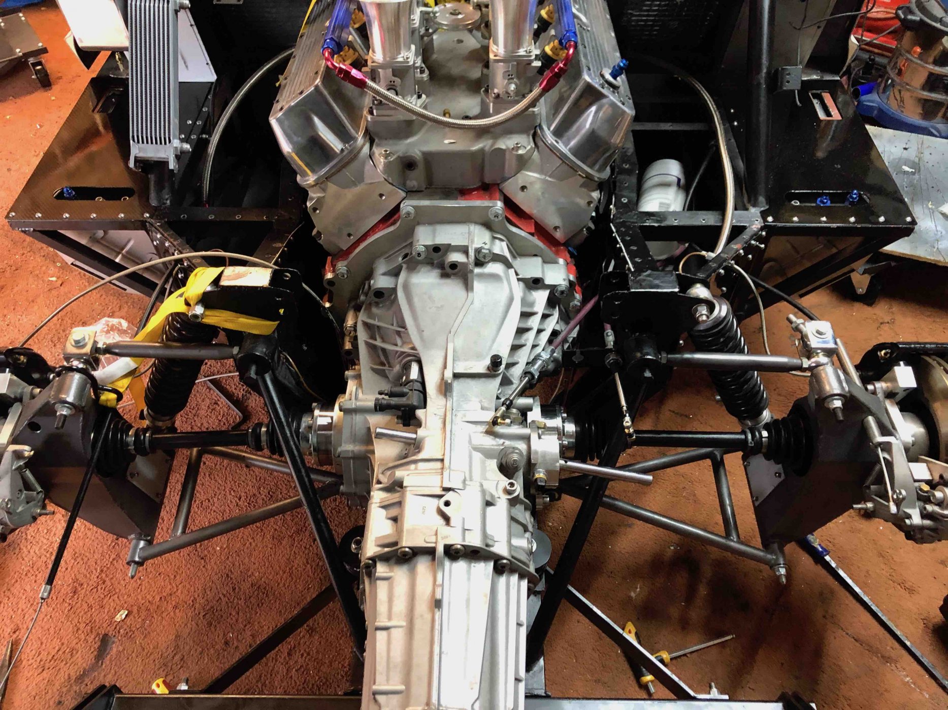

Another little milestone achieved Today as my driveshafts are now in. Having access to a Lathe and Mill it was relatively easy to make the inboard Audi Gearbox - Ford CV Joint adapters allowing me to stick with the standard ford 100mm throughout the drivetrain. The driveshafts are of unequal length given the Audi 01x is slightly asymetrical but these are available at a super price along with the 4xCV joints and all gators etc. from JandR in the UK. If the Clutch hydraulics pass the test on Saturday then the home made exhausts go back on and that's another step nearer the first engine test. Hopefully by end of Sept given a lady luck sticks with me ;-)
