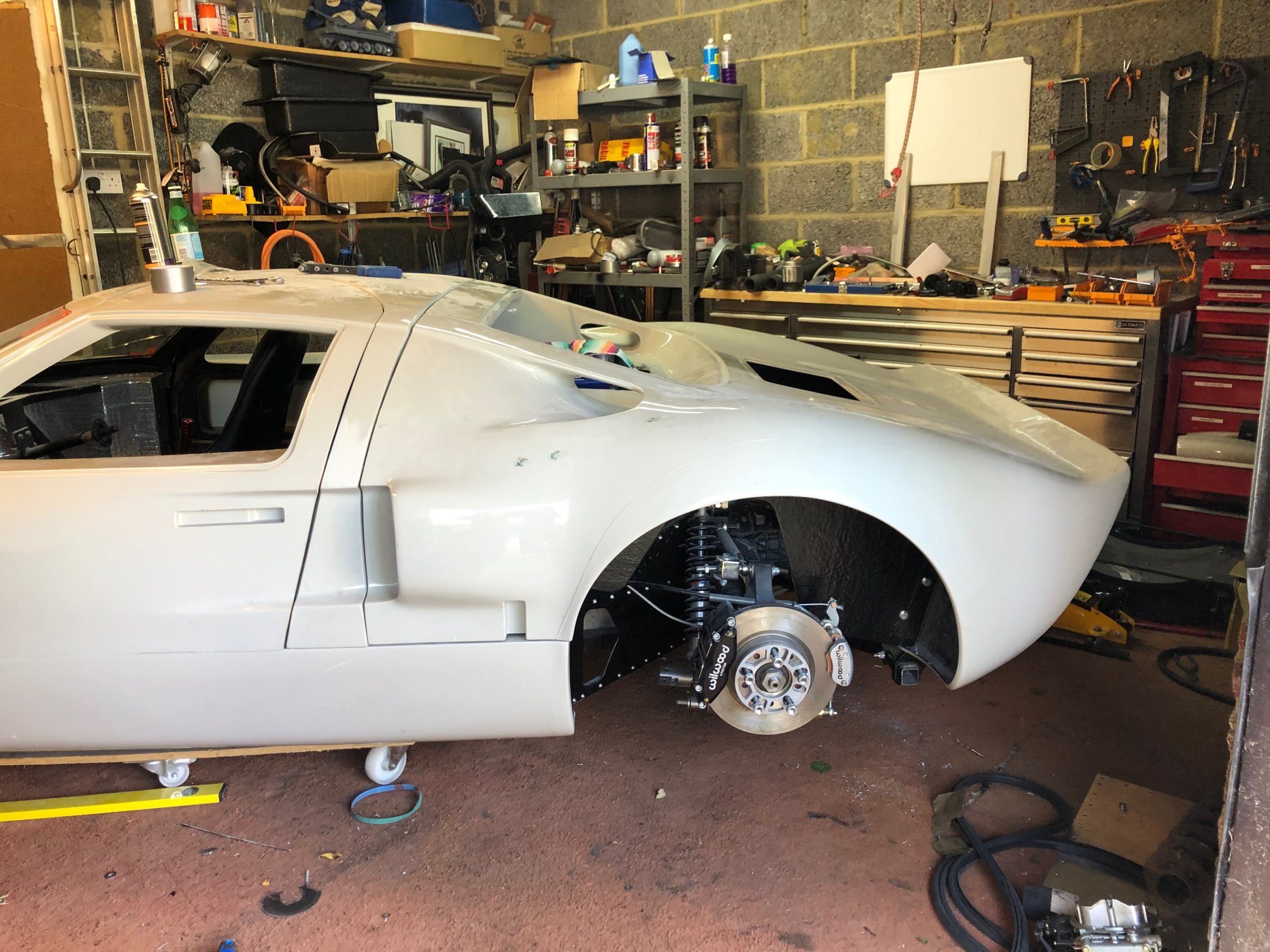

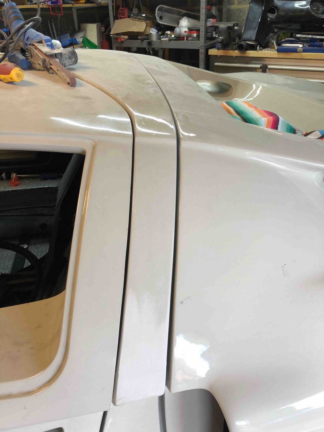

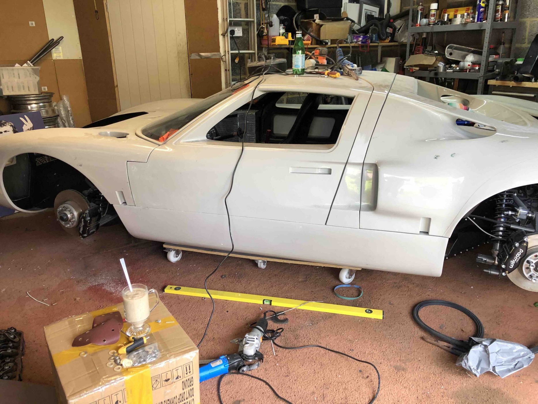

Finally feel like I'm making some serious progress. Spent a few hours Today checking the body alignment. With only the front and rear clips to properly seat down to the sill tops and a few mm's to trim off the bottom of the passenger door, all's looking like its finally paying off. Shut lines all looking good.

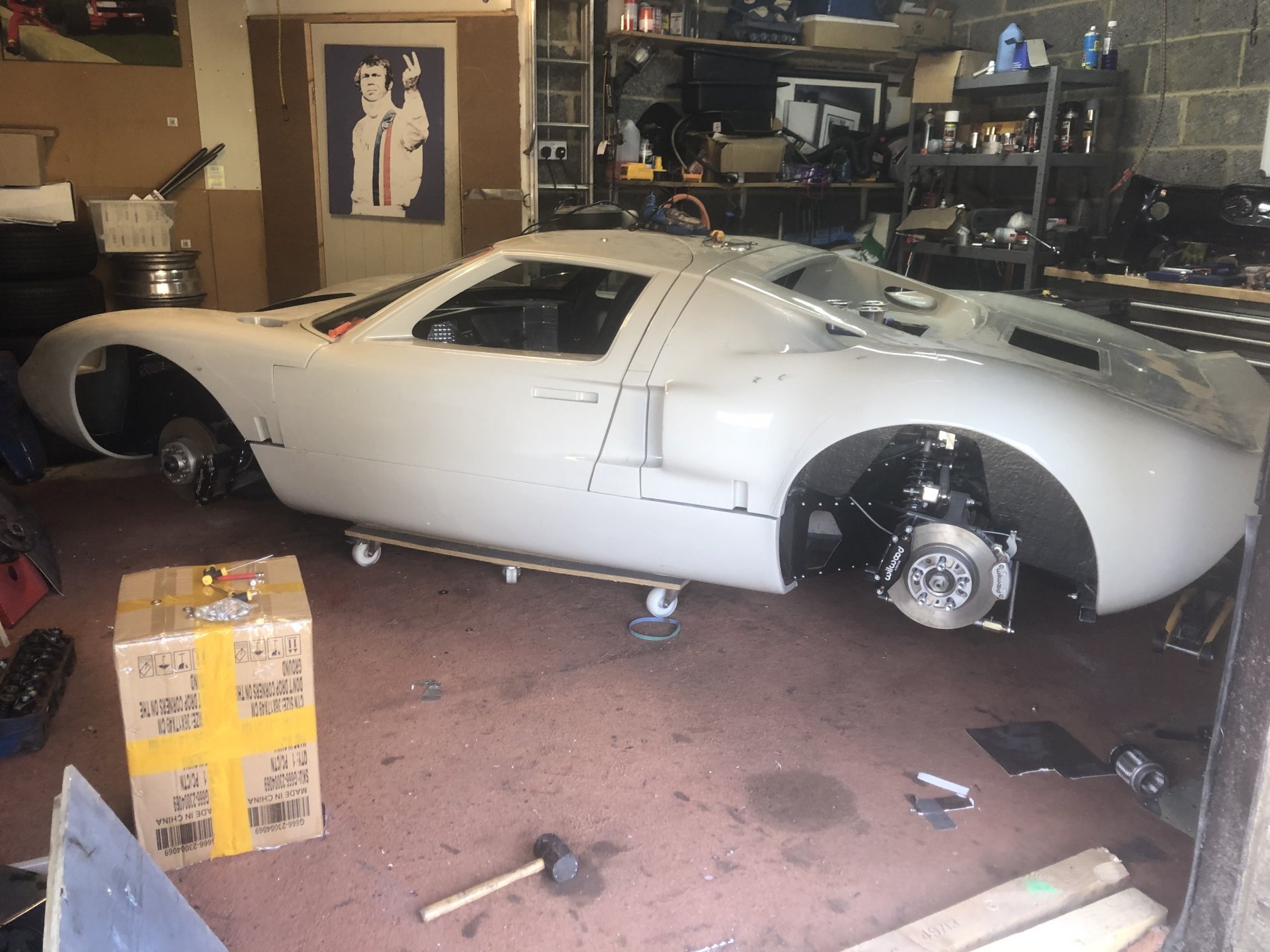

A little progress this weekend. Have been focused on the final body alignment prior to mounting the front and rear clips onto the parrot beak hinges. A little trimming to the passenger door (a few mm here and there) and checking the shut lines all around. All in all a slow pace given just how hard it is at this stage to undo and mistakes. Very happy with things at this stage with next weekend looking to the hinge placement.

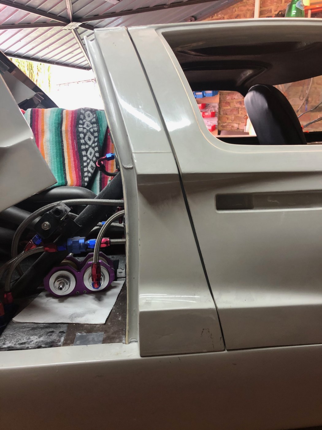

Finally bit the bullet Today and settled on my final Spyder position along with the doors. Once all these were fixed for the final time it was a case of dealing with the hinge positions for the rear clip. A real challenge of a job when your alone but after a couple of house, it all came Together as I wanted with all the shut lines nailed.
With the rear clip now easy to open, I can set about fabricating the rear exhaust components allowing the tail pipes to exit the rear bodywork exactly where I want and central.

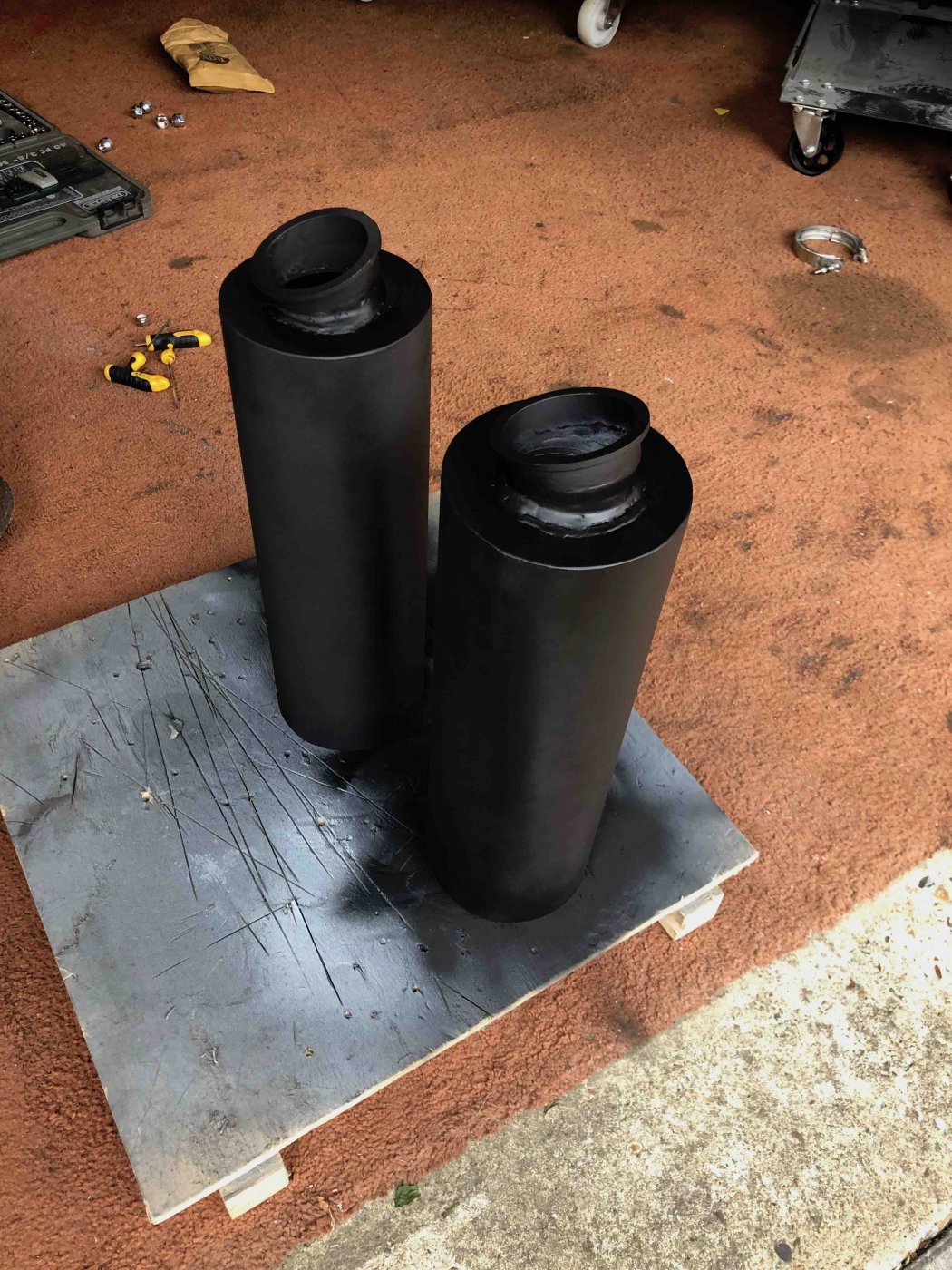

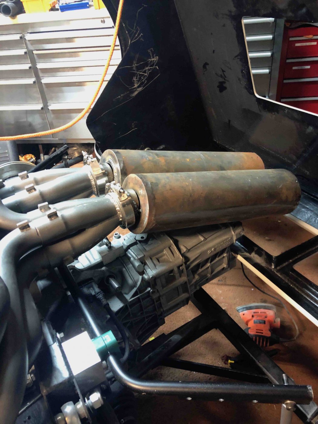

Popped the two SGT silencer casings in this afternoon and set the angle's etc. to the rear and tack welded in place. Will firm up Tomorrow. Have had the silencer casings sitting around for over 2 years so they will need a little rub down before the silica based coating goes on.
Then I'll pop on the chrome end pipes to complete.

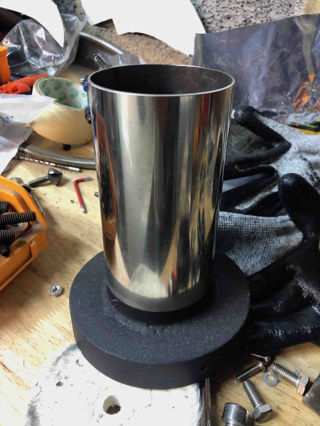

NickD

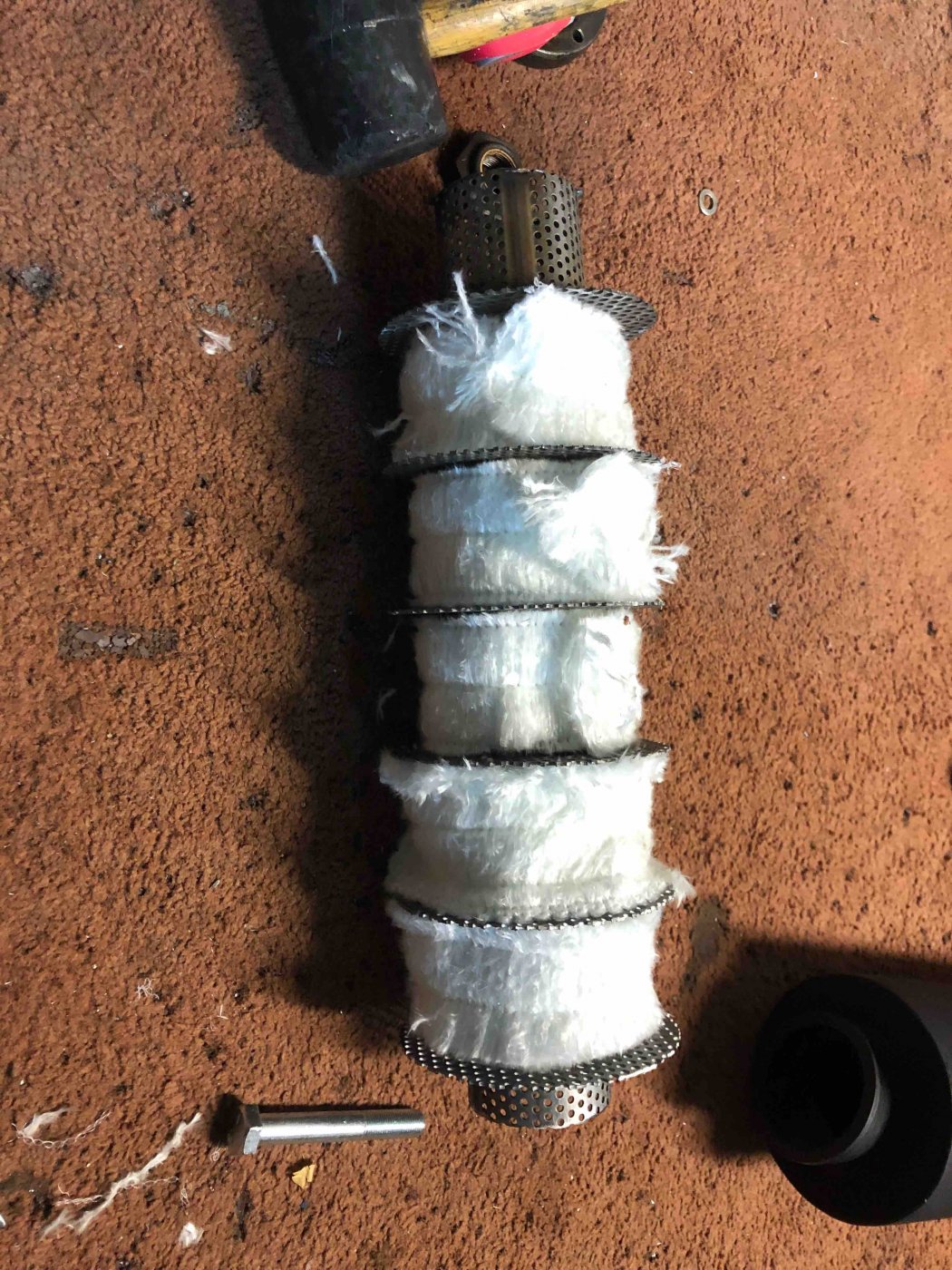

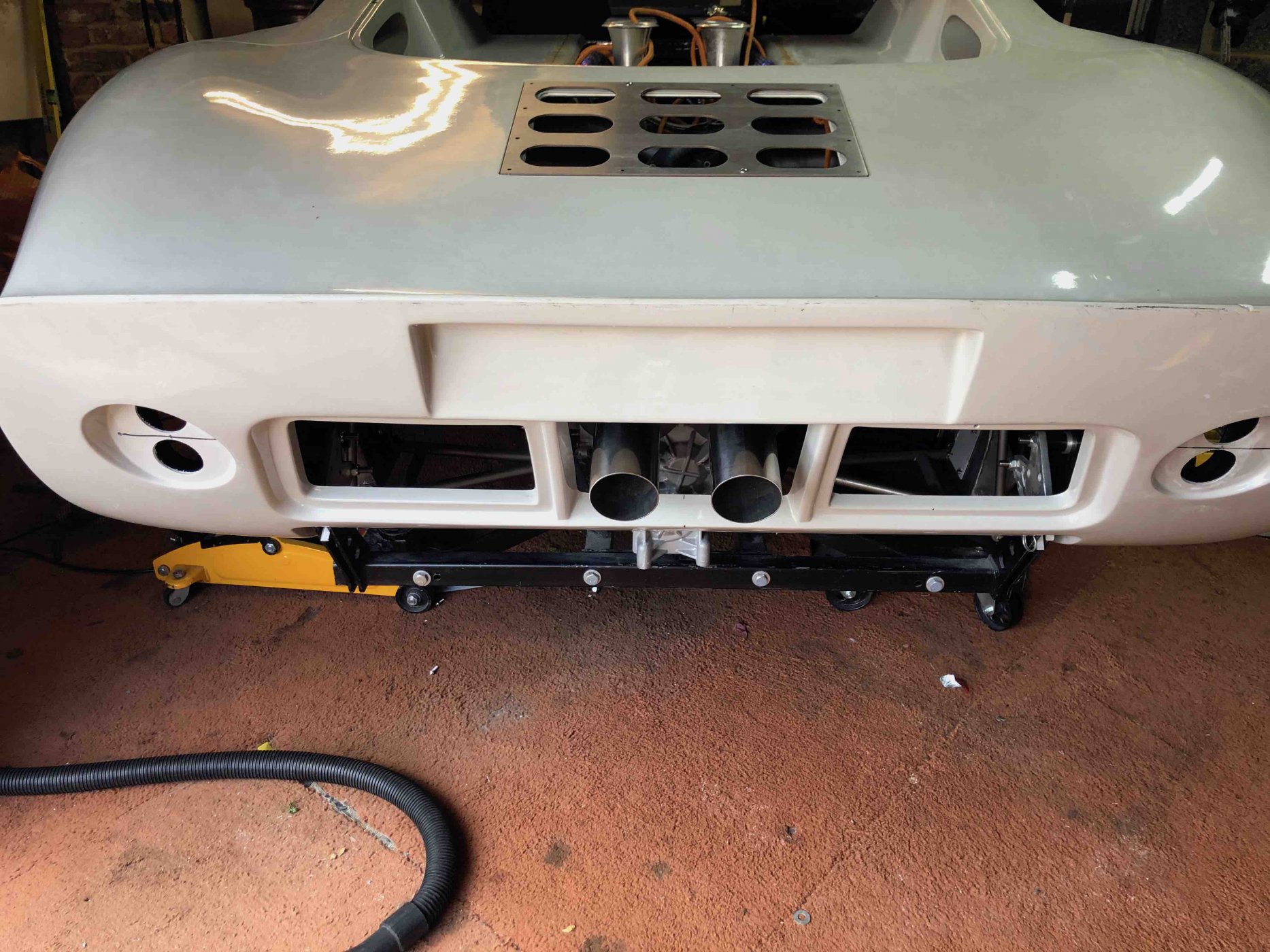

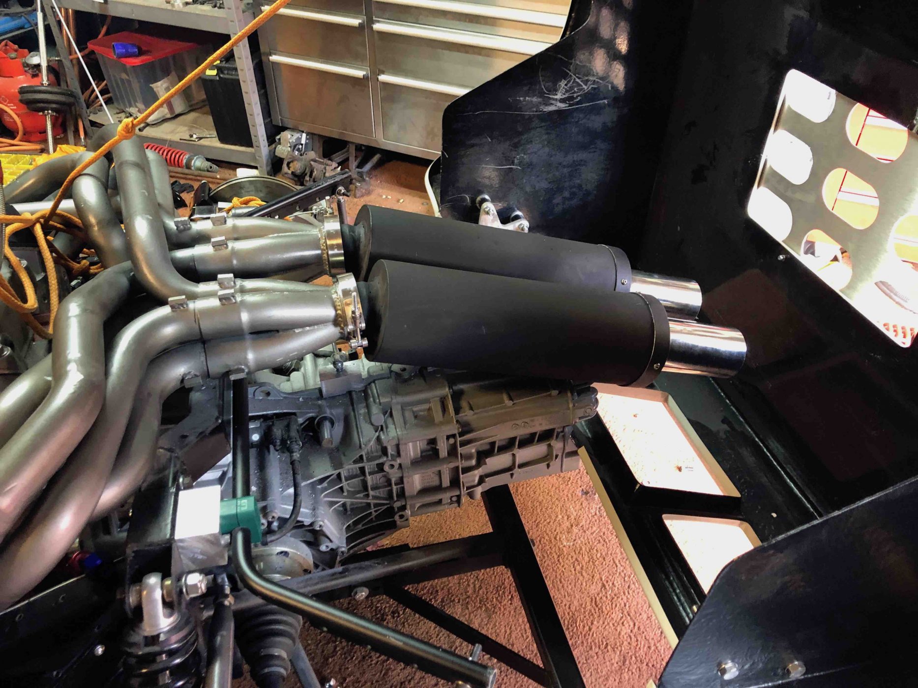

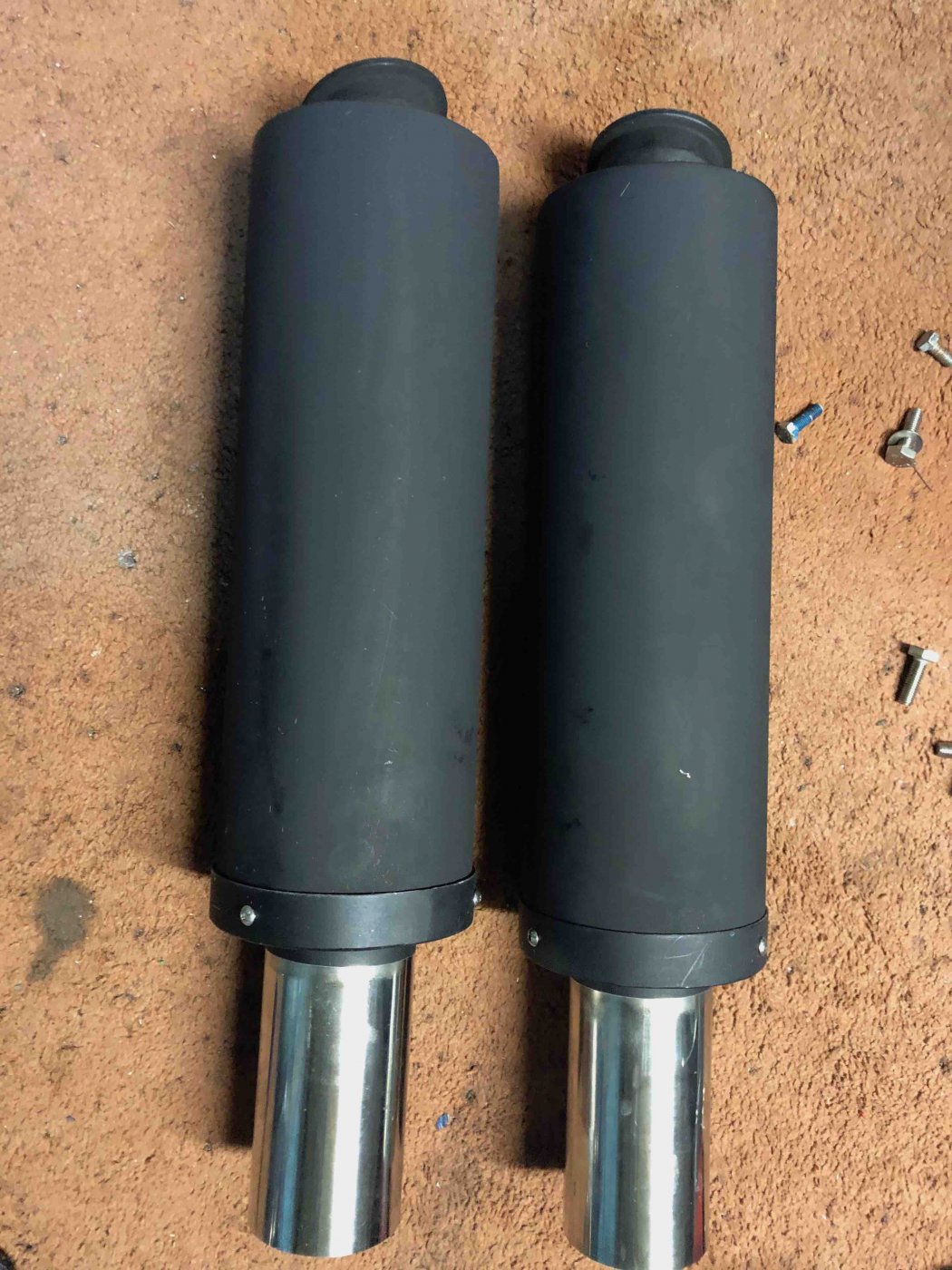

Following on from Yesterdays progress it was time to finish welding up the silencer casings, remove the two years of storage surface rust etc. and then prep. Now duly shortened to the right length and then suitable primed and painted with a 2000 degree F Silica based coating, all's looking good. Now just the case of popping in the internal metal baffles and glass wadding to make them suitable for the eventual UK ministry of transport tests. Hopefully, that's another job done and dusted.
NickD
Have now taken the next step of suitably stuffing the silencers with a sound deadening material and mounting all items to check if my measurements meant they would duly exit the rear clip exactly as planned. Long story short, this is a job I seem to have got about as good a result as I could have hoped for. Yep, I could have saved myself a stack of agro and simply purchased an exhaust off the shelf which would probably have got me 90% there but its a scratch build and I intended to do as much as I could when I started out. Well chuffed ;-)
Hi Nick,
Apologies if you already know, I think your silencer ends need a radius on them to pass IVA.
Regards
Nick

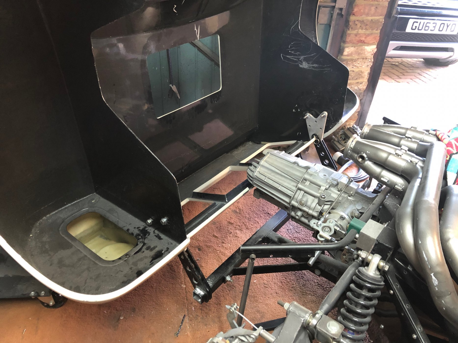

I thought I had more or less finished with the Engine and Exhaust assembly until I realised I had made a serious oversight. Given the Adapter plate on this Ford / Audi Conversion is made of aluminium as opposed to steel and given its thickness, it can't take the starter motor bolt threads as they would pull through. So, to my horror I found that the Starter has to be attached before the gearbox is bolted on as the Starter bolts essentially run from inside the bell housing. They are countersunk M10's. (also, any change in Starter Motor means the gearbox has to come off).
Yep, exactly what I thought when I realised how it had to be done. Never seen anything like it !
This then lead me to pull the entire ass end of the car off again just to get the starter fitted. Then to the next set of issues in that when I did put the starter on, the tolerances are simply too tight between the Flywheel ring gear and the Starter bendix. Video's links belo showing the difficulty in engaging the gear and then the horror of seeing the metal shavings flying off my starter gear as the harder flywheel ring gear began making a tasty appertiser out of them.
I have now actually overcome the issue by being able to slightly change the starter position by modifying the adapter plate.
