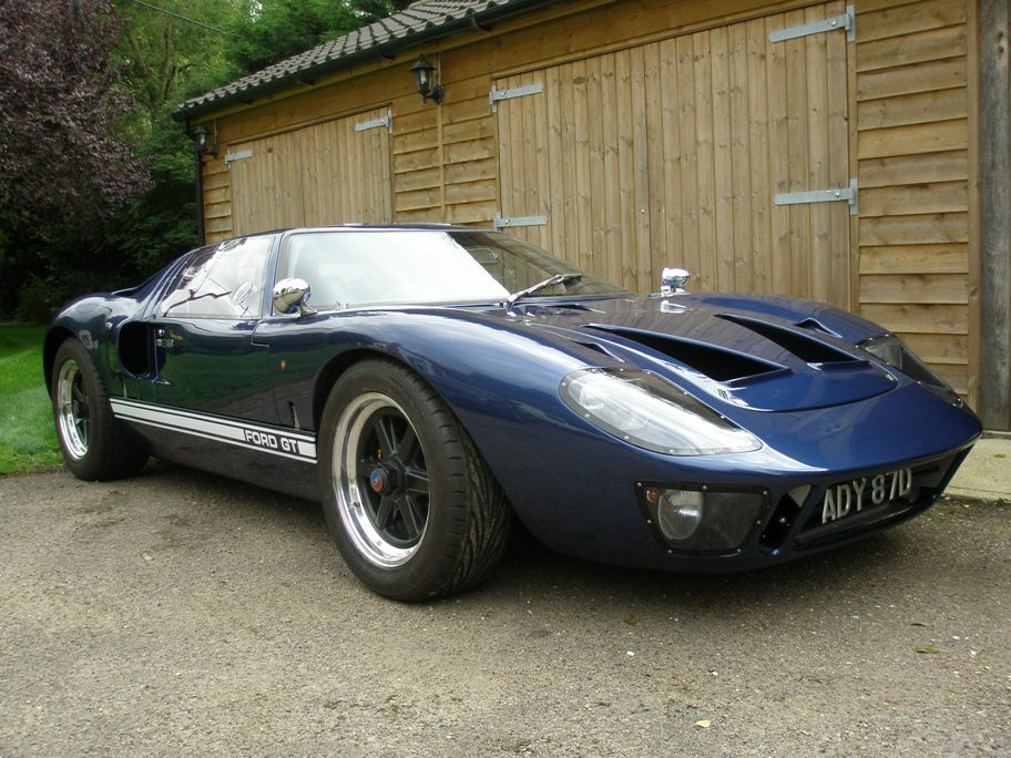

On the road!

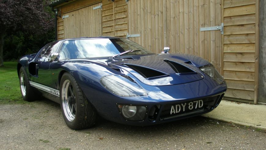

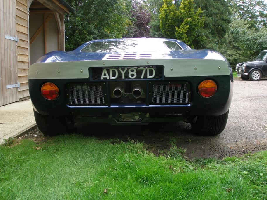

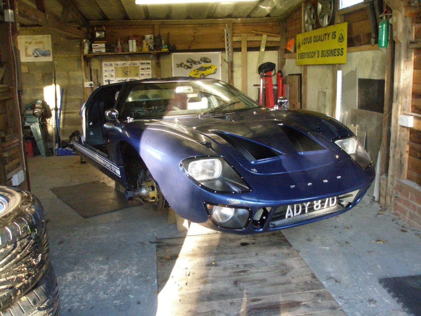

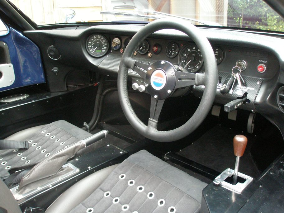

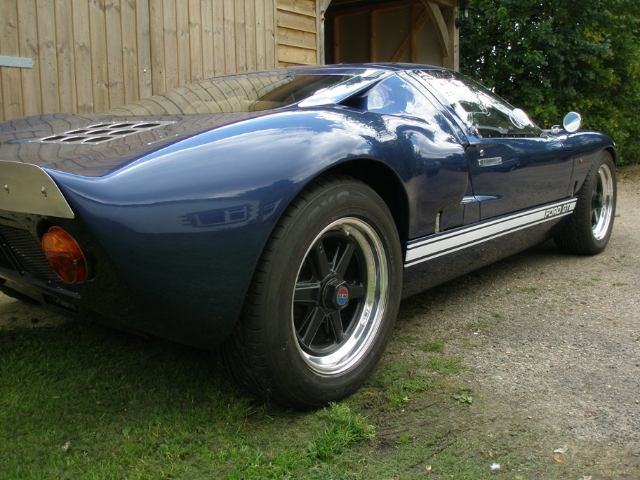

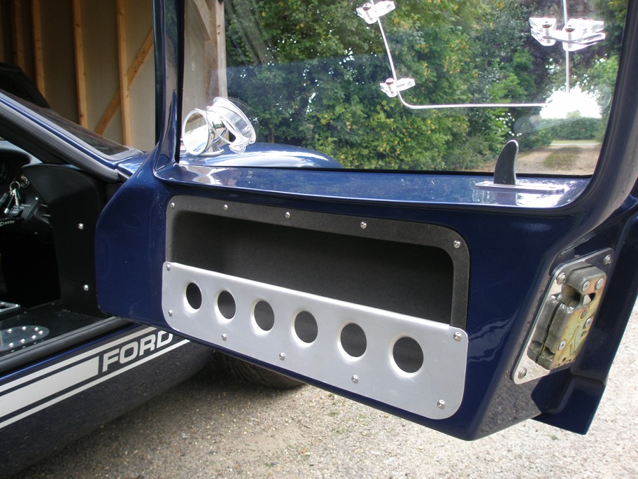

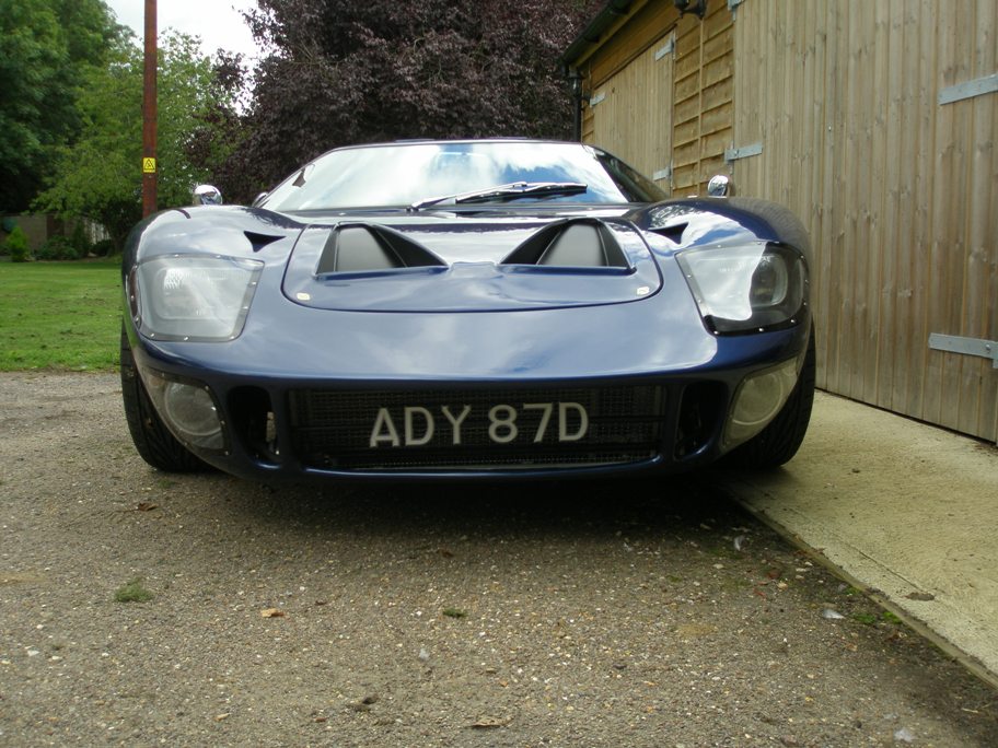

Well it took it first tentative steps last Friday back to see the painter who is only a couple of miles from home. A misfire and difficult gear selection, meant that Saturday and Sunday was the start of the fettling process. The mis-fire traced to 2 leads being swopped (after I’d removed my IVA leads which had a couple a little too short) and another go at adjusting the gearshift selector. Another run out on Sunday afternoon to visit a couple of friends got the odometer over 30 miles
A few observations:
  • The dark blue paint is complemented really well with the chrome and black paint detail
  • It’s sounds gorgeous when the throttles are opened!
  • The EPAS works well, I added an override switch so can be disabled completely at cruising speeds if required
  • The ride is really compliant; the adjustable dampers were set at their midpoint setting as a starting point
  • The helicopter vents work really well
  • The cabin is quieter than I had anticipated
  • The sinter-plate clutch is very unforgiving and needs replacing for an organic, which will make road driving easier
  • It attracted attention; people keep looking at it, pointing and taking photos – I’m still at the stage of wondering what they’ve seen failing off!
  • Trucks have really big wheels when you’re in a ’40!
  • It’s not a modern car, which you just get in and drive. After you’ve got in, making sure the gear lever doesn’t go up the leg of your trousers, the engine needs warming whilst belts are installed and the steering wheel re-fitted
There’s still a list of things that still need doing (speedo calibration, tri-lobe spinners, charge A/C. finish the engine mapping, suspension set-up etc)
A few pictures taken on a cloudy day
So there you have it, just under 7 years work to get it to this stage. Am I pleased with it – too right.
Andy

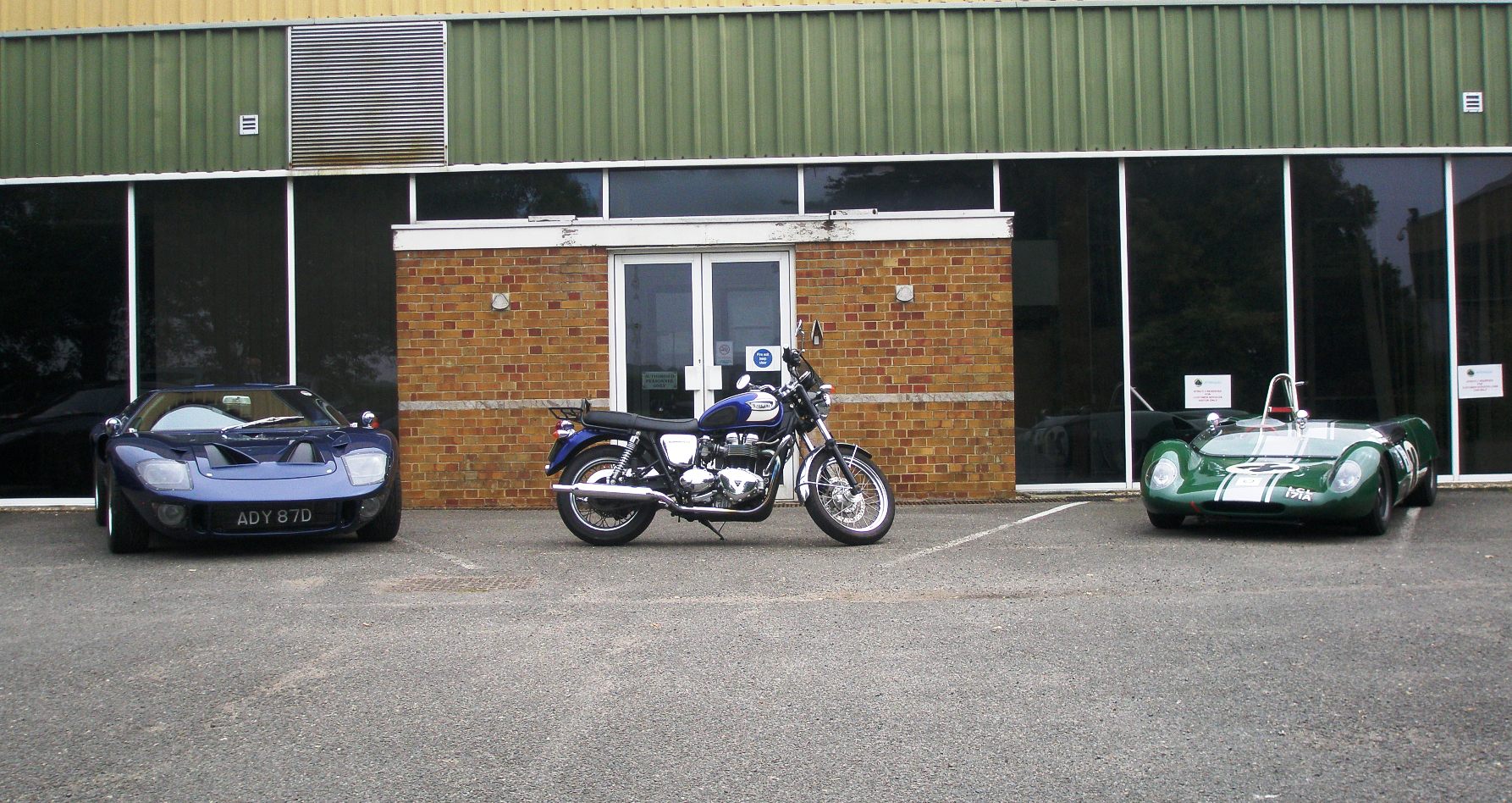

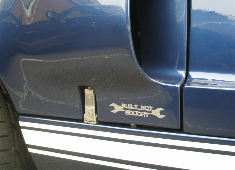

Over the last few weeks I’ve slowly been getting the miles on the car. The same misfire I had when we ran the engine on the dyno was apparent again, but the solution has been identified, but a permanent solution yet to be implemented. A larger master cylinder has improved the clutch actuation and more adjustment on the gearshift has improved the overall system. The headlamps are OK for unlit Norfolk roads, but I couldn’t use main beam as the LED warning light is far too bright – another job on the list.
I took it to work a couple of times last week and it was well received by my work colleagues. My friend also drove in his race prepared, but road registered Lotus 23 for comparison and we did a mini photo shoot including another colleague’s Triumph Bonneville.
Also a few other finishing touches and Jim we met up at the Scole Inn, which hasn’t changed since you were around these parts and it does say ‘NOISE’ next to the starter button!
Andy

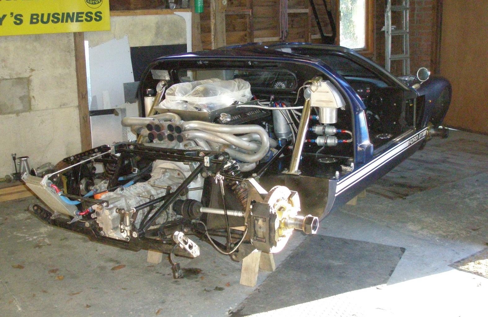

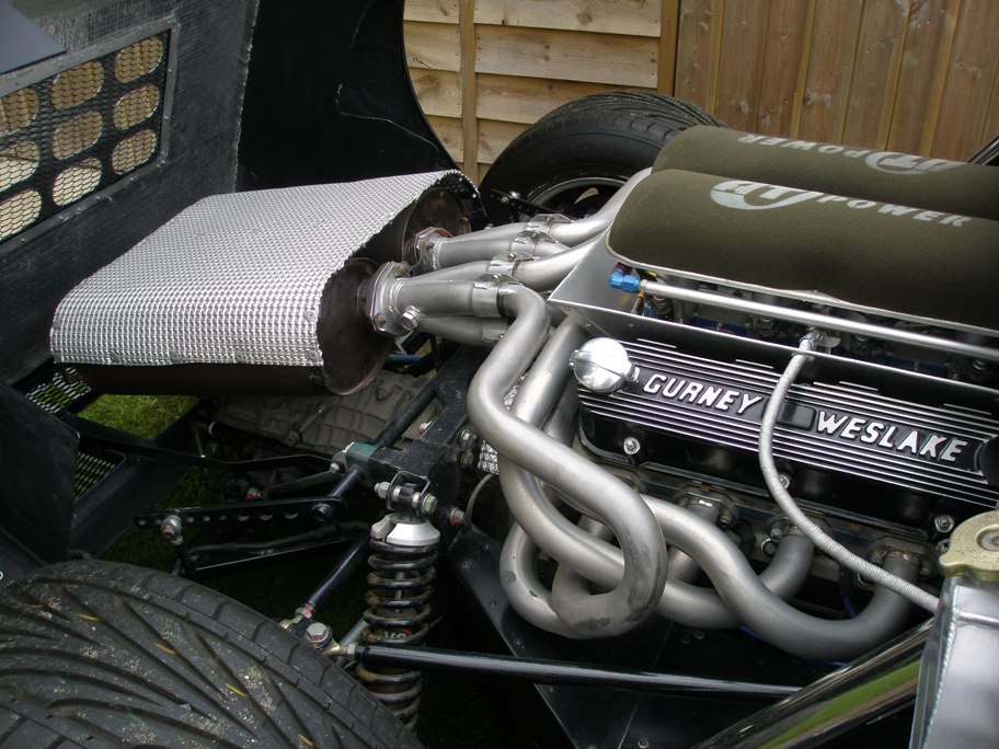

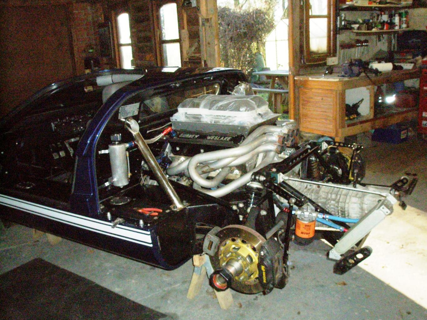

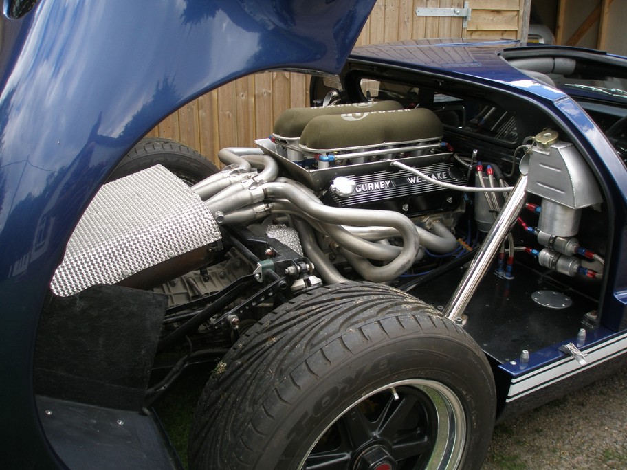

Over the last few months and the lead-up the Christmas, the ’40 has now covered 500 miles and is being slowly de-bugged and the winter re-work list developed.
During this period, the calibration has been further refined. As I’m running a wide-band lambda sensor, we’ve been able to lean the fuelling off at the part-load cruise speeds to improve the fuel consumption – not that I’ve noticed though
I’ve also had a lot of the front paintwork and around the wheel arches covered with paint protection film. As the paint has been one of the biggest investments in the car, a few more pounds spent here seems worthwhile
Now the clutch has bedded in and I’ve now got used to it there’s no need to change it. A lot of my original issues with it mainly due to the gear shift gate not being set up correctly and I’d been using 3rd gear to pull away in!
Jobs over the winter include:
  • Remake a couple of the exhaust headers, as I’ve got one too close to the trailing arm
  • New silencers – a little more rortiness won’t go amiss on a car like this!
  • Brighter headlamps – probably a HID bi-xeon conversion
  • New mechanical oil pressure gauge. The original install uses an electrical sensor and keeps dropping to zero! Fortunately the oil pressure warning light switch is mounted next to the gauge sensor and doesn’t come on, so I know it’s a sensor/electrical issue
  • New front lower wishbones – to replace the Tornado ones which bend
  • Front & rear towing eyes
  • Get the A/C system charged & working
  • Safety check on all fasteners
Other jobs include building a replica engine of mine for Tony Browne’s KVA. With this and work overseas (writing this in Malaysia again), the wife’s never going to get the new bathroom I’ve promised her.
Andy
