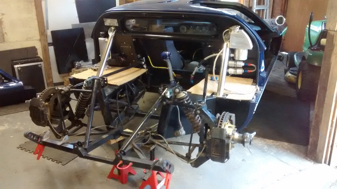

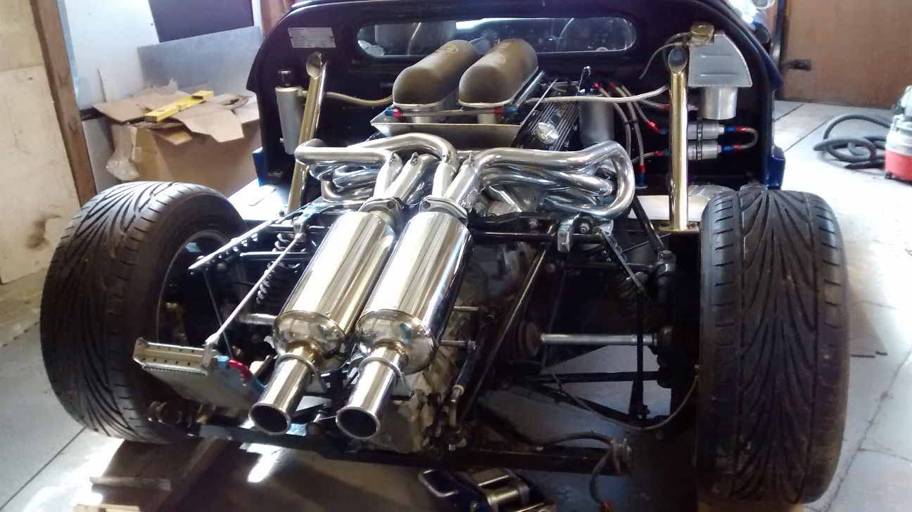

Over the winter months, I’ve been slowly working through the to-do list and finding other things than needed sorting

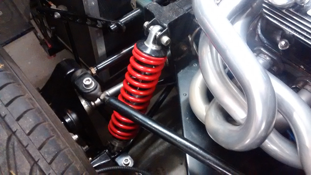

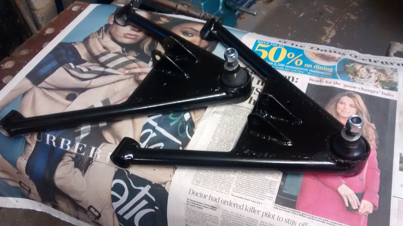

  • New front lower wishbones.
  • The new silencers are in (6” diameter straight-through re-packabale units)
  • A couple of header pipes reworked & the whole system ceramic re-coated

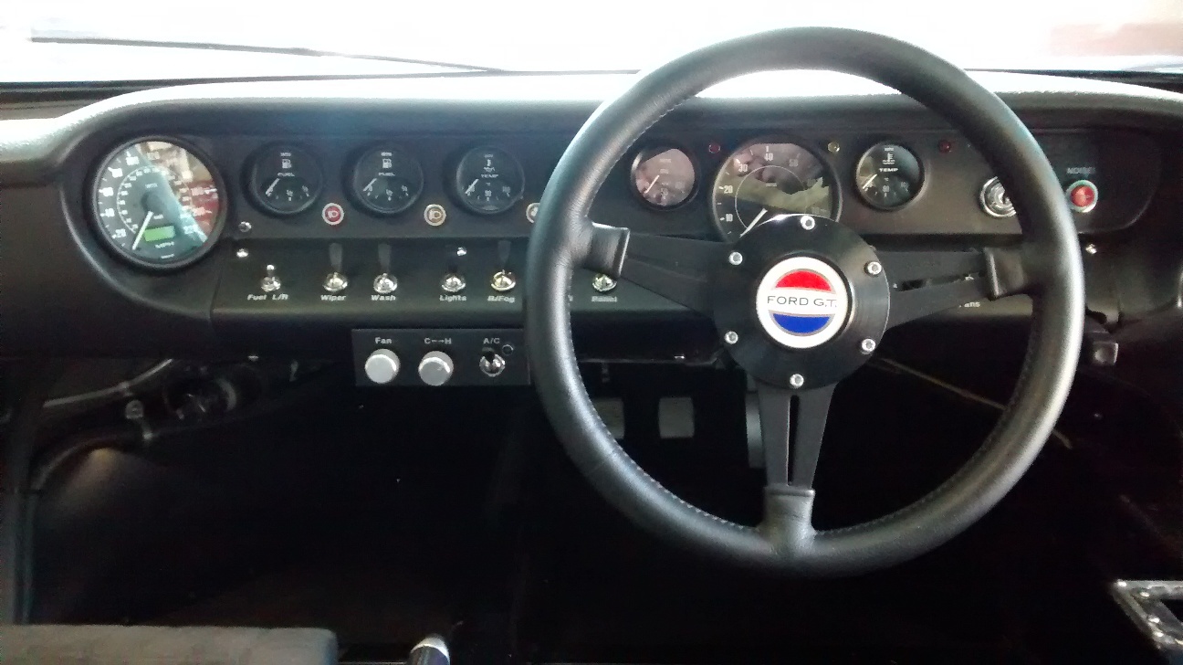

  • Re-spaced switches on new black anodised switch plates
  • New mechanical oil pressure gauge

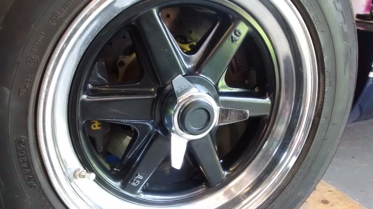

  • New chrome plated bronze spinners & black anodised centre caps. No fear of the lugs breaking off these
  • Rubber boots added to all rose joints. Fiddly to fit and cheaper than having to change them in a few years time

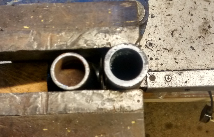

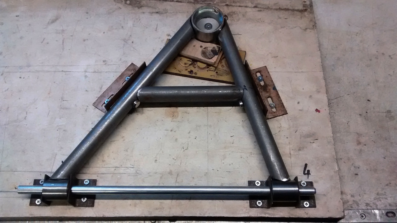

Regarding the wishbones, the comparison of material cross section is interesting. For clarity the original Tornado is 1.5mm, seamed tubing and I’ve used 2.5mm seamless tubing (as used by Lotus for their wishbones). These ones aren’t going to bend or break!

Nice work on the wishbones!! It's good to have peace of mind.. The silencers look and fit perfectly as well.
I've also wondered about the longevity of the cast alloy spinners. Yours look quite nice and fit for duty..

The new silencers have worked out well, giving a slightly deeper note and my wife now knows when I’m nearly home!<?xml:namespace prefix = o ns = "urn:schemas-microsoft-com<img src=" /><o:p></o:p>

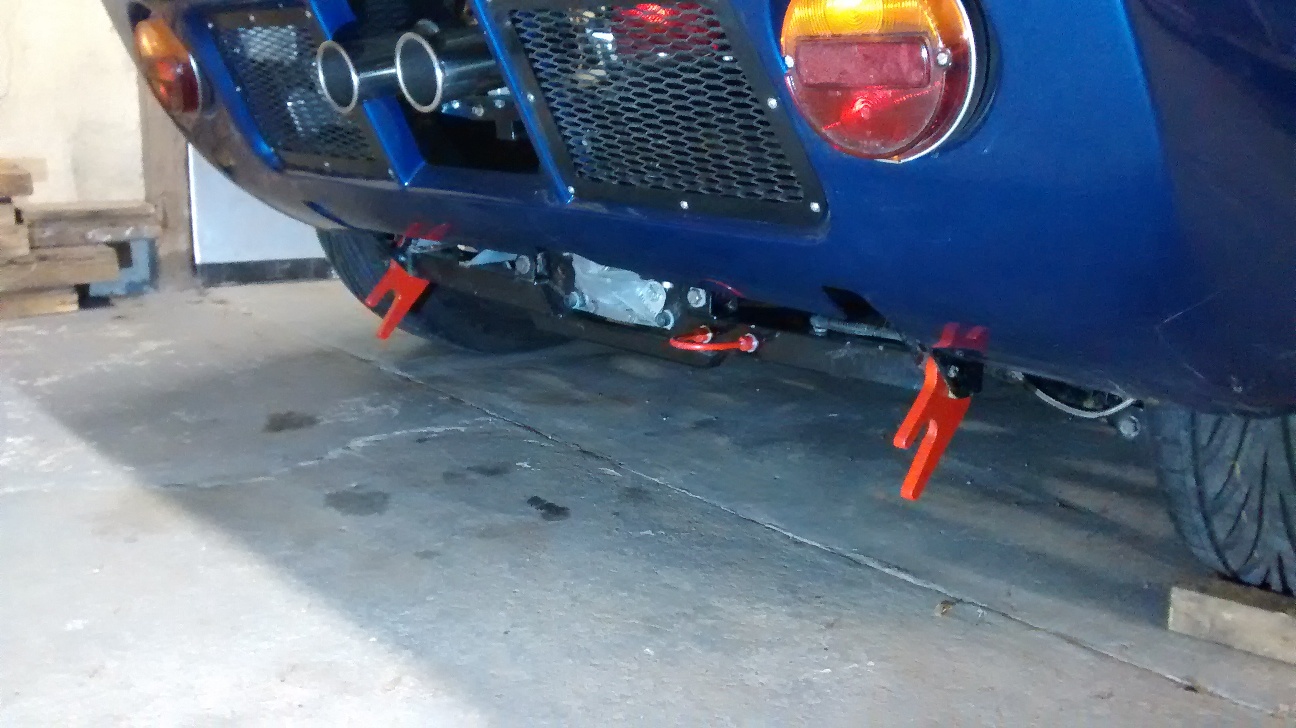

The front tracking & camber settings had to be re-done as the new wishbones have the lower ball-joint in a slightly different position. Also got the rear towing eye & quick lift jack points fitted. Next job to sort out out the fron ones.

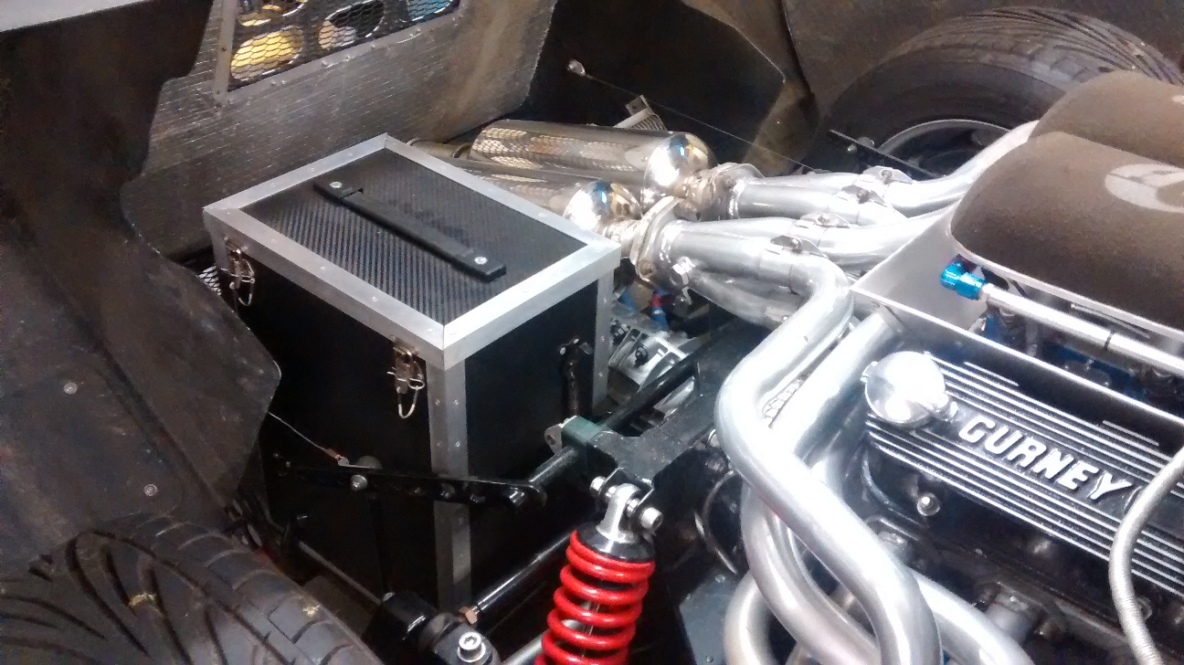

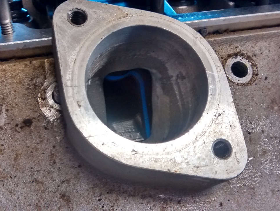

What was planned as a light winter refresh, has turned into a major rebuild, resulting in the car only being back on the road this month.<?xml:namespace prefix = o ns = "urn:schemas-microsoft-com<img src=" /><o:p></o:p>
It started with a slight oil leak from the rear crank seal and the concern that the oil pressure seemed low, eventually resulted in a full strip of the engine<o:p></o:p>
<o:p></o:p>

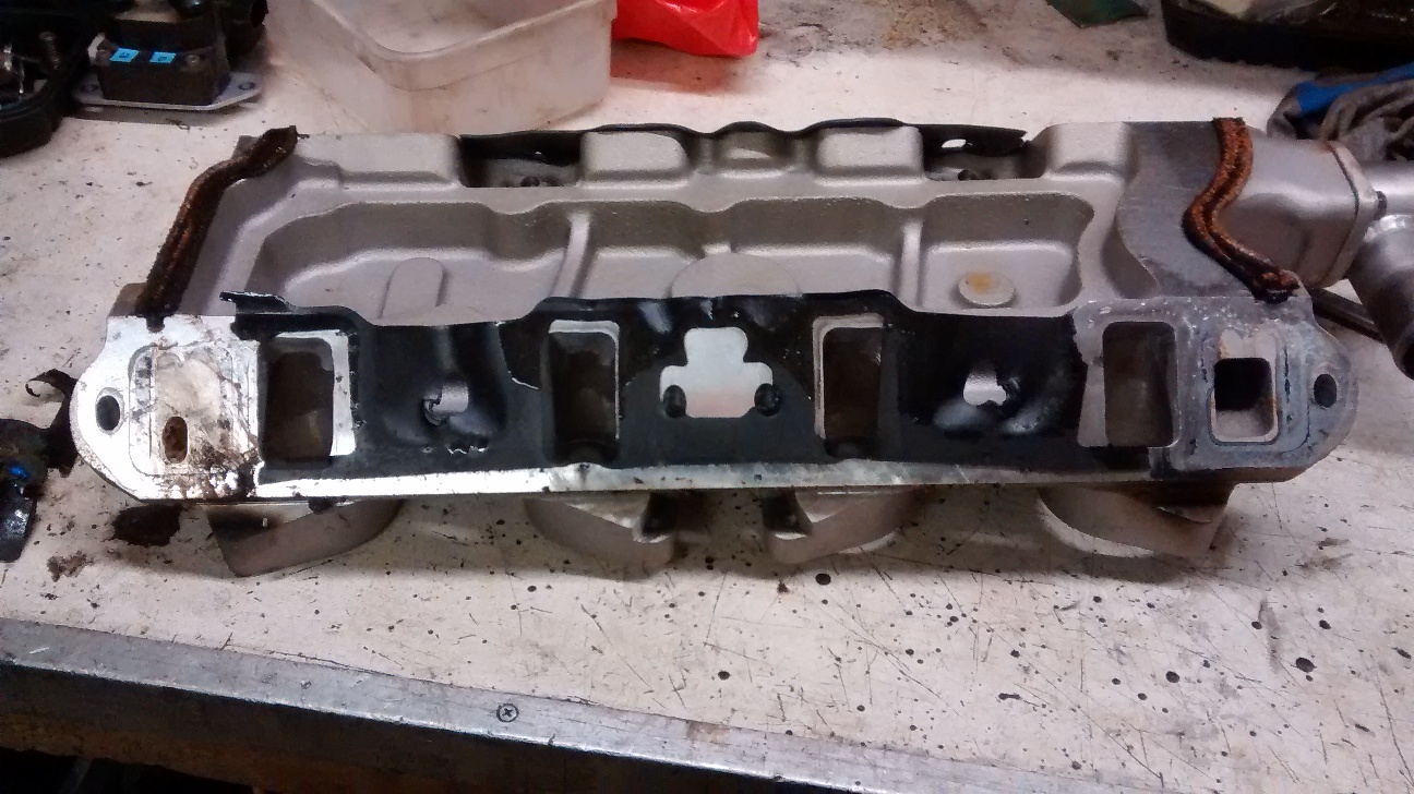

The first issue I found was a problem with the inlet manifold gasket, which had moved, causing a bad air leak. I believe that issue was caused by the cork gasket between the block and the manifold being too thick, preventing sufficient clamping force between the manifold and heads. A dry build confirmed this and it was rebuilt with o-ring cord between the manifold & block (the manifold has a channel to take this) and a small amount of sealant on the gasket to cyl head to prevent any movement<o:p></o:p>
<o:p></o:p>
Removing the oil pan to check the bearings I found 2 of the internal gallery plugs had come out (the ones behind the cam sprocket). The one that hadn’t been mashed by the chain, showed a perfect sealing witness make around the periphery, so it was a bit odd. All plugs have now been replaced with threaded ones. The resultant low oil pressure had damaged the crank, resulting in a re-grind and a fresh set of shells. At least I’ve now got good oil pressure again.<o:p></o:p>
<o:p></o:p>
Whilst it’s been off the road a few other mods were done:<o:p></o:p>
<o:p></o:p>
  • Rear wheel rebuild with 1” additional offset, now fills the arches out better<o:p></o:p>
  • Rear suspension rebuild, due to the original powder coating flaking off!<o:p></o:p>
  • This strip resulted in new rear dampers, as one had a bent rod, which was only noticeable when the spring was removed for re-coating<o:p></o:p>
  • Removable luggage box, made from a few scraps left over from panelling, finished with some carbon effect vinyl wrap<o:p></o:p>

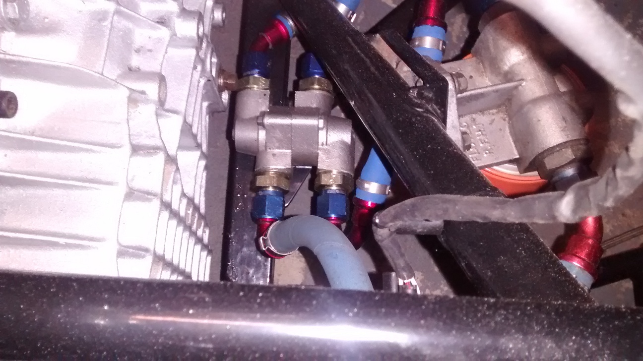

  • Thermostat added to the oil cooler<o:p></o:p>

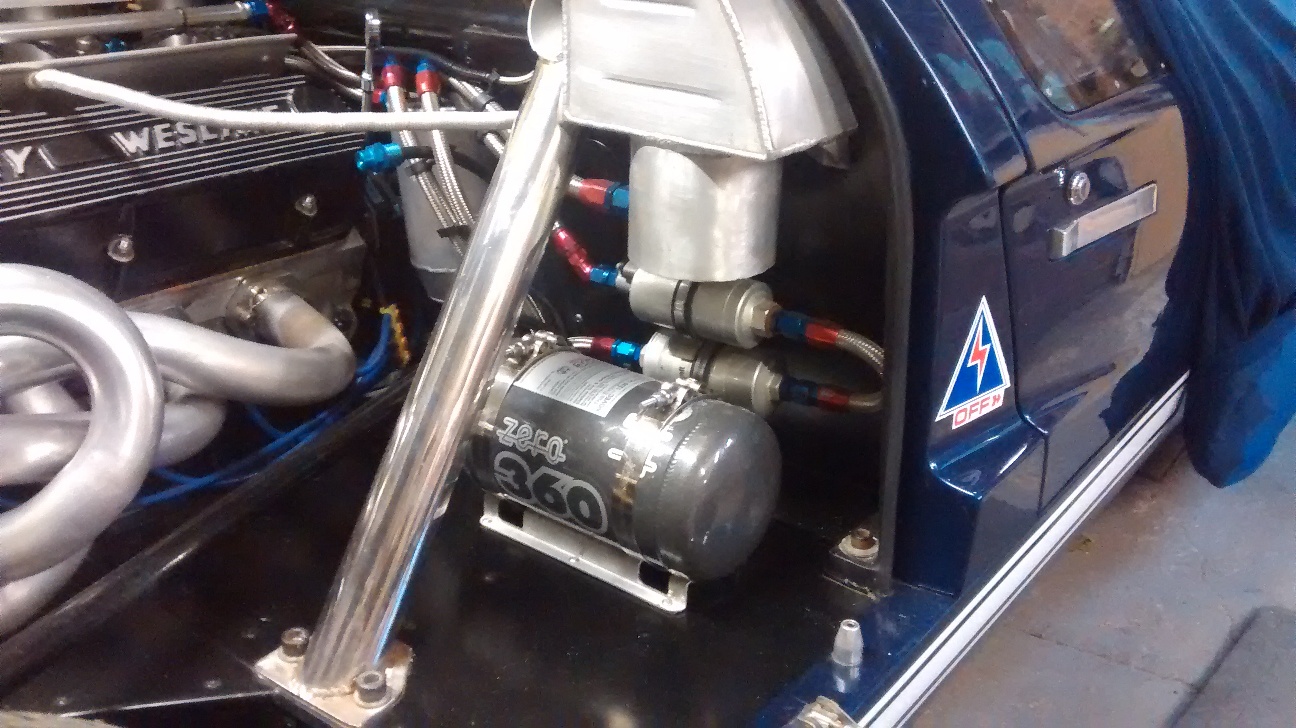

  • Plumbed in fire extinguisher fitted<o:p></o:p>

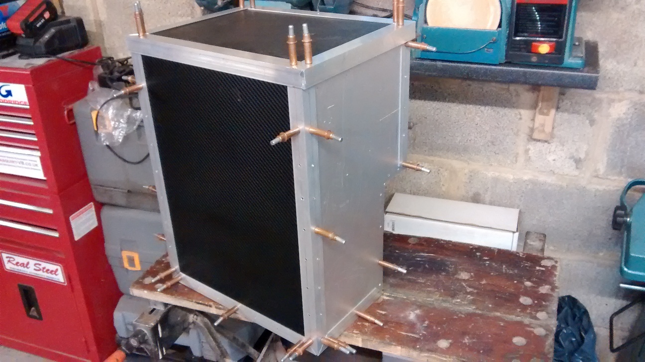

From memory the wheels are 7x16 with a -0.5" inset on the front and 9x16" with a 1" offset on the rear, supplied by Image Wheels
