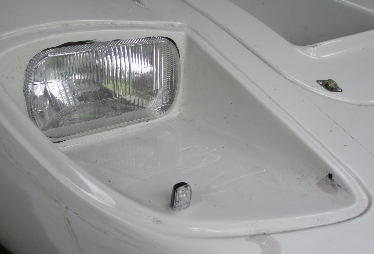

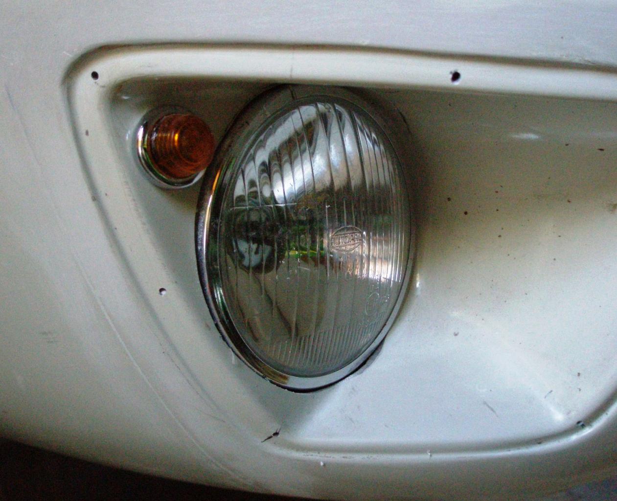

Andy, again congrats, have you been out driving yet? How far in (errr out) did you have to move the front indicators? I may be OK, as I have another indicator lens in the centre of the lower aperture, beside the foggies. K
Thanks for the compliments guys, it’s an immense weight of my mine to get it through and it proves you can do it yourself, despite being told on a couple of occasions to take it to one of the specialists
The car’s backing the workshop now being stripped & prepped for painting, so unfortunately no chance to really drive it yet
The attached shows where the front indicator ended up. I asked the inspector where he wanted them, he pointed, we drilled and he was happy – they aren’t even symmetrical!
I haven’t make my mine up yet what to eventually use, either the micro indicators where I originally had them or some small round ones in the corner of the spot light aperture.
Andy

Andy,
Do those micro units emit anything off to the side?? You may want to add some on the side of the front clip.
I think most people that see the car from the side, would be distracted and never see your "blinkers". I like for those coming from the side to know my intentions to turn.
Hi Bill,
I've got some really bright LED side indicators in the same position as on yours, which are a UK legal requirement. These will be staying on the car for the reasons you've highlighted.
Andy

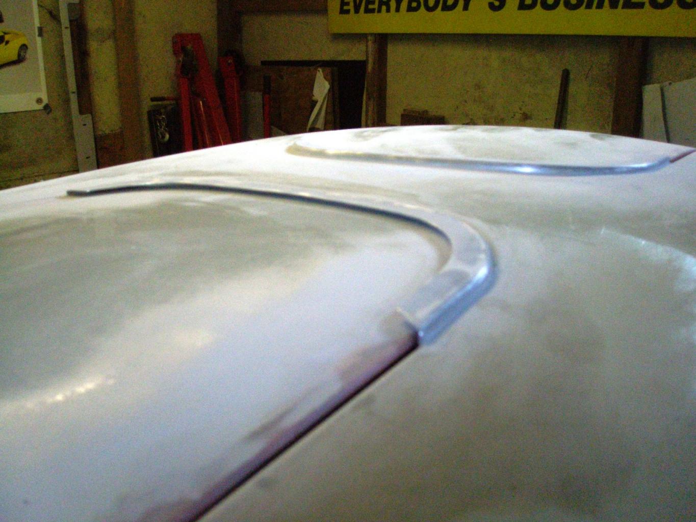

  • Deep front vents fitted – easier said than done, as the panel pulled during curing causing it to sit proud of the body by ½”. Cut it off & start again!

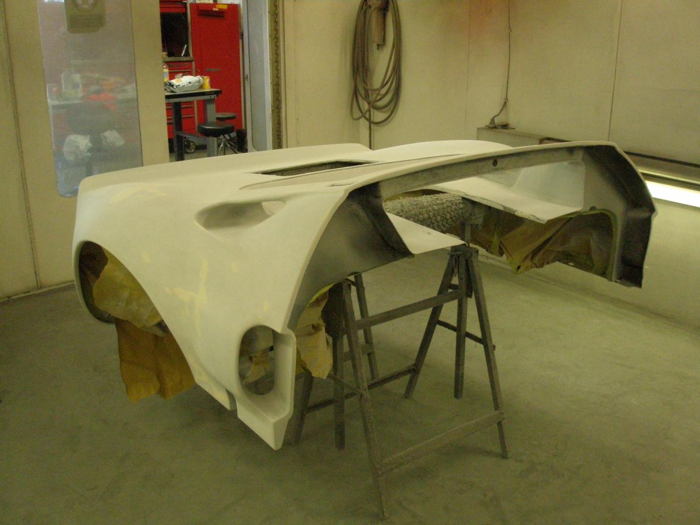

Again, works been getting the way of regular progress on the ’40 (currently writing this in South Africa) and I’ve been waiting for last several weeks for my slot at the paint shop to materialise. The previous car delaying my slot was a Jaguar XKSS, based on one of Classic Car Development’s tubs from New Zealand, but as the paint shop specialises in composites and aluminium bodies, I know it’s in good hands.

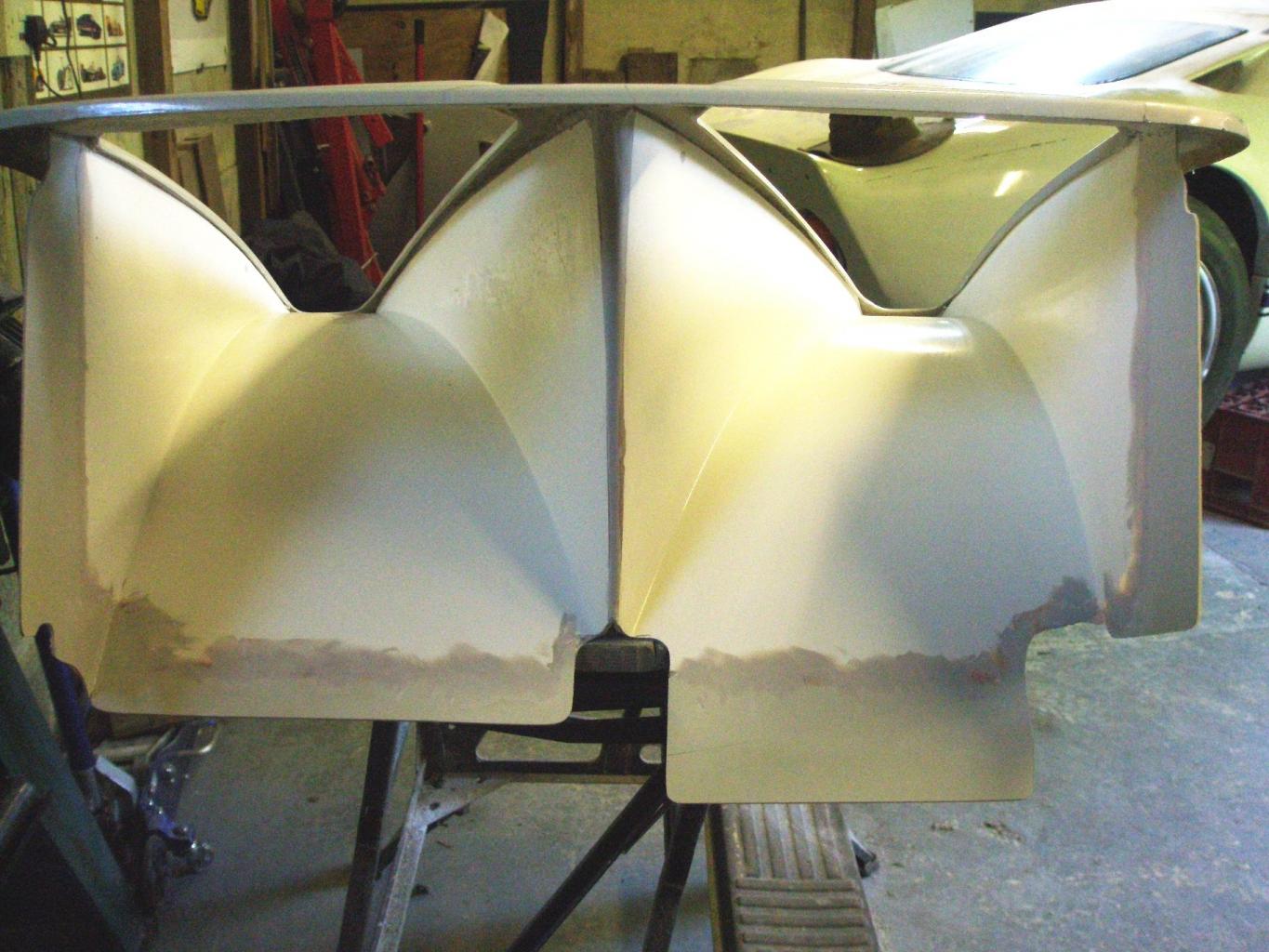

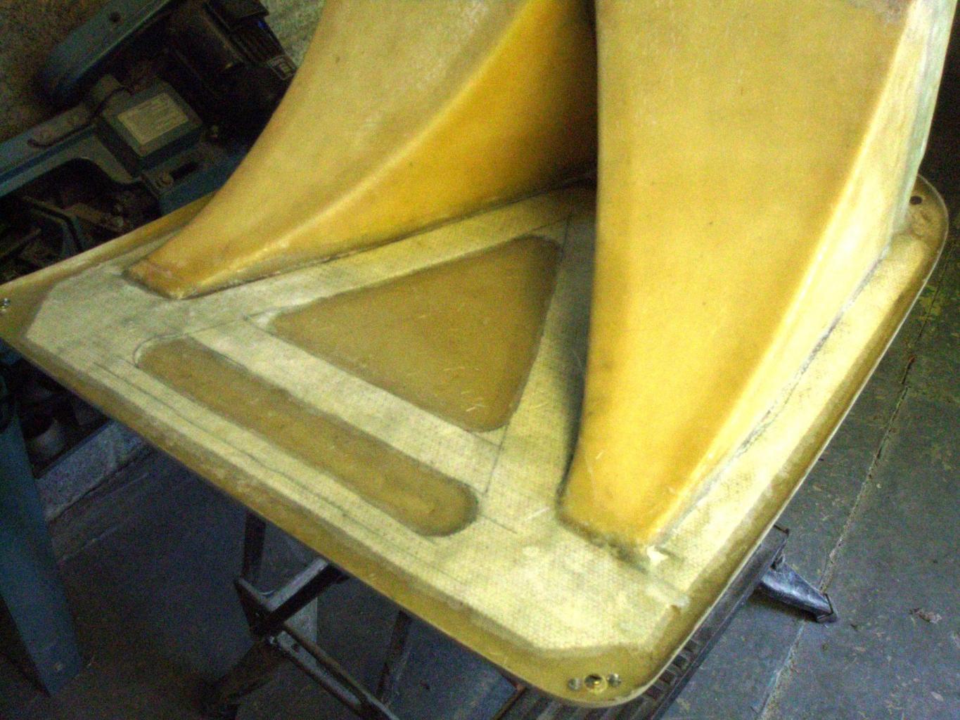

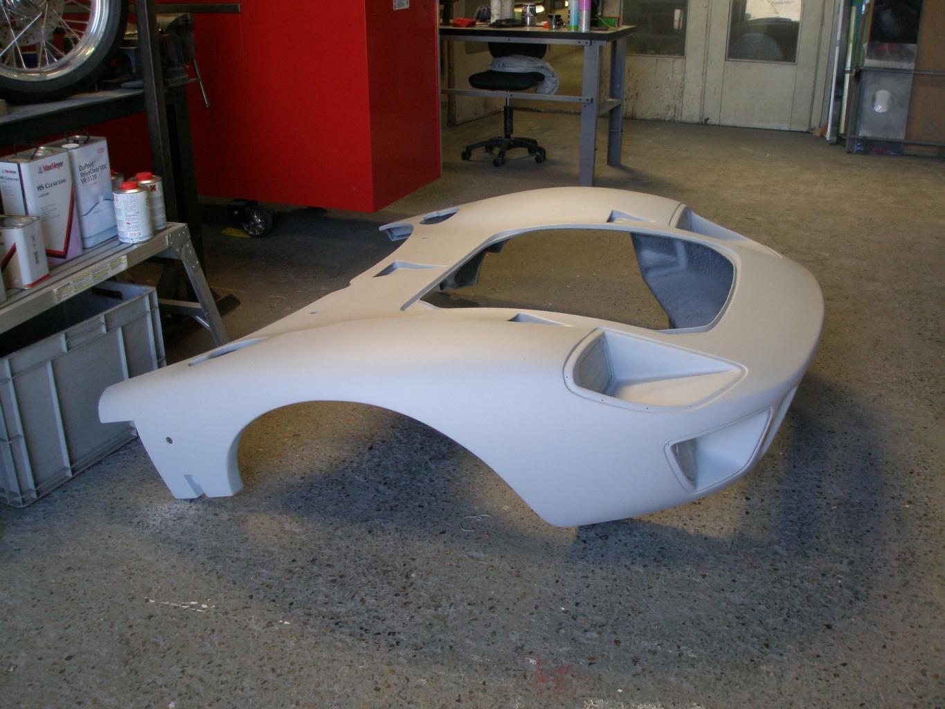

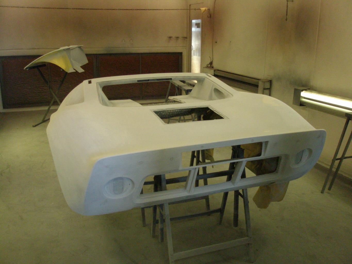

I did as much of the body prep as I could, mainly setting all the surface levels, shut gaps and keying the surface for the first coat of primer. However I was shocked how poor the front & rear clams were for distortions and sinks. About 20 hours of filling & sanding has had to go into these 2 panels alone to give an acceptable result. As the car’s going to be a dark colour the body’s got to be spot on to give a good finished result.

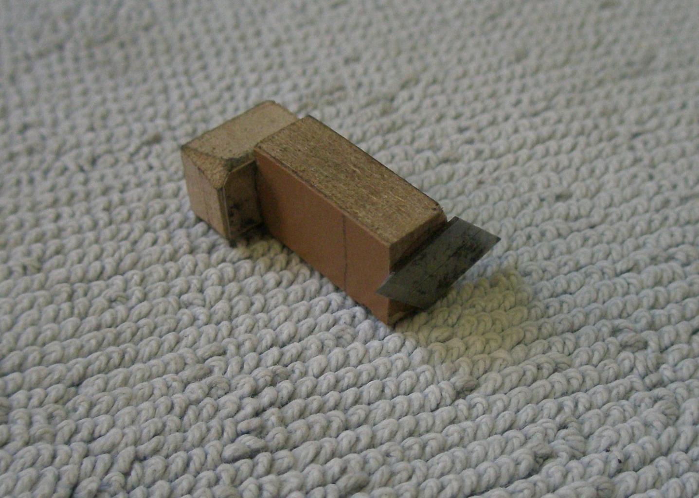

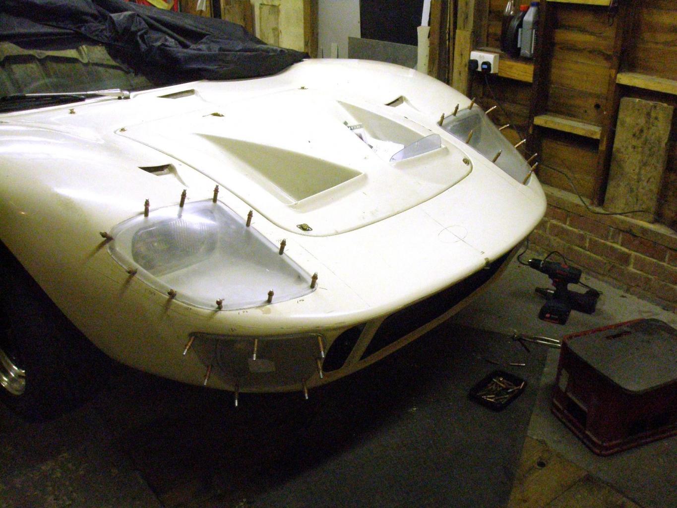

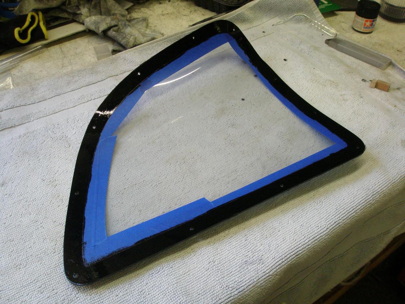

I added the black border to the head lamp covers. After reading how others did it, it seems complicated (reverse masking etc) so I looked for a simpler solution of a small jig to trim at a fixed distance from the outer edge. The attached was made in a few minutes using the blade from a modelling knife. The results worked well and I used Tamyia acrylic paint out of my old modelling box

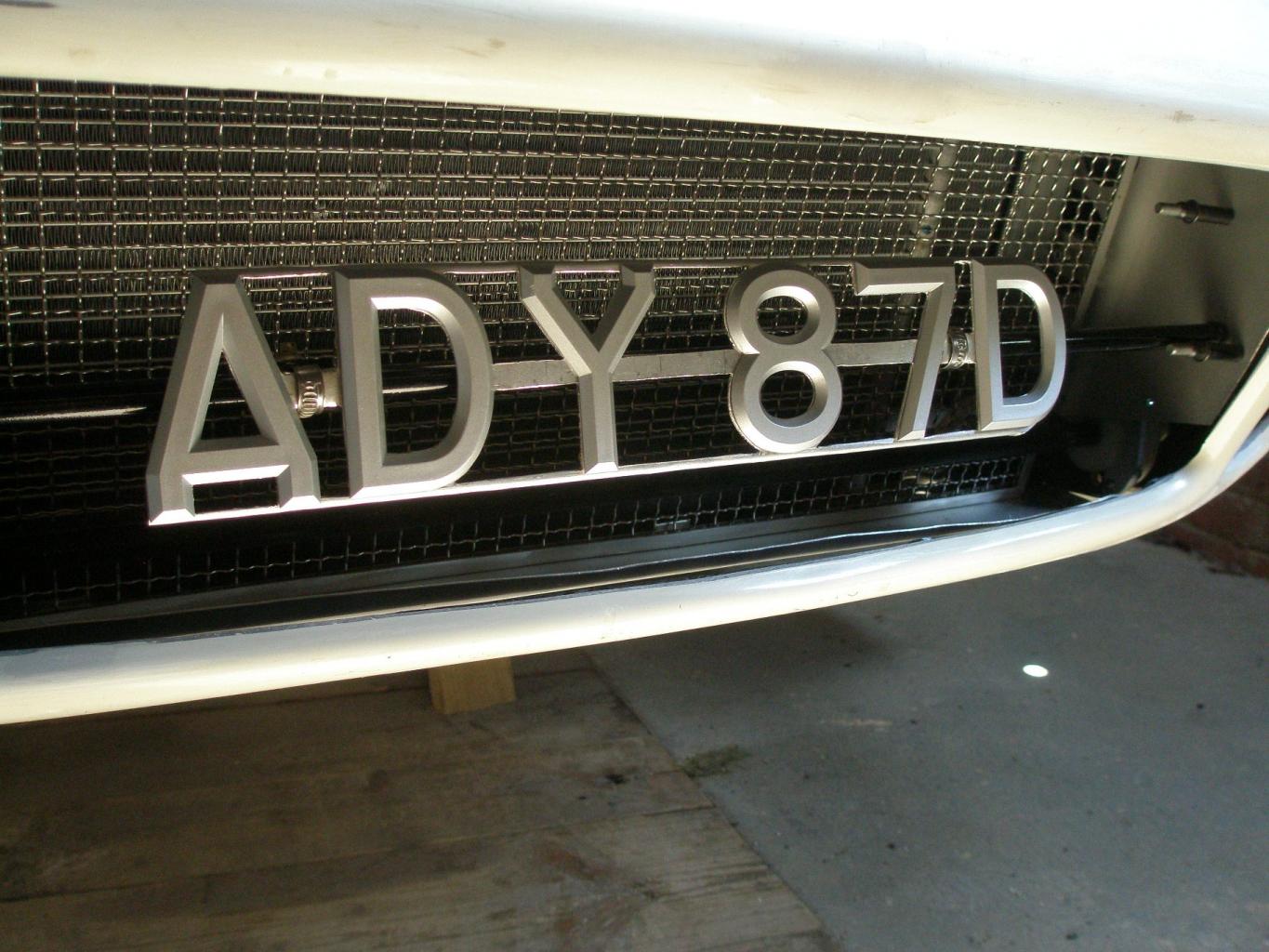

  • Front number plate mounting

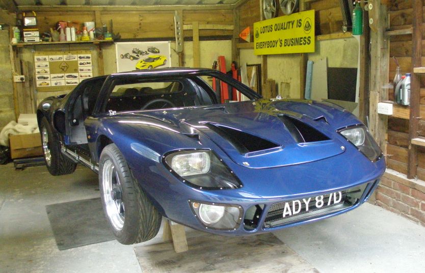

I’ve now picked the car up from the paint shop and to say that I’m pleased with the end results is an understatement. The guys have done a great job in sorting out all the irregularities in the body and whilst the paints more metallic than I was expecting, it does look brilliant in the sun.
Paying the bill was painful, especially as it’s been the largest bill since buying the car in the first place, but I always knew this would be the case and the paint has got to be right, as it sets the first impressions.
Anyway a bit of a teaser shot, whilst I get on with the re-assembly :thumbsup:
Andy

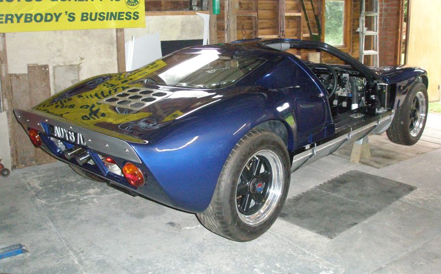

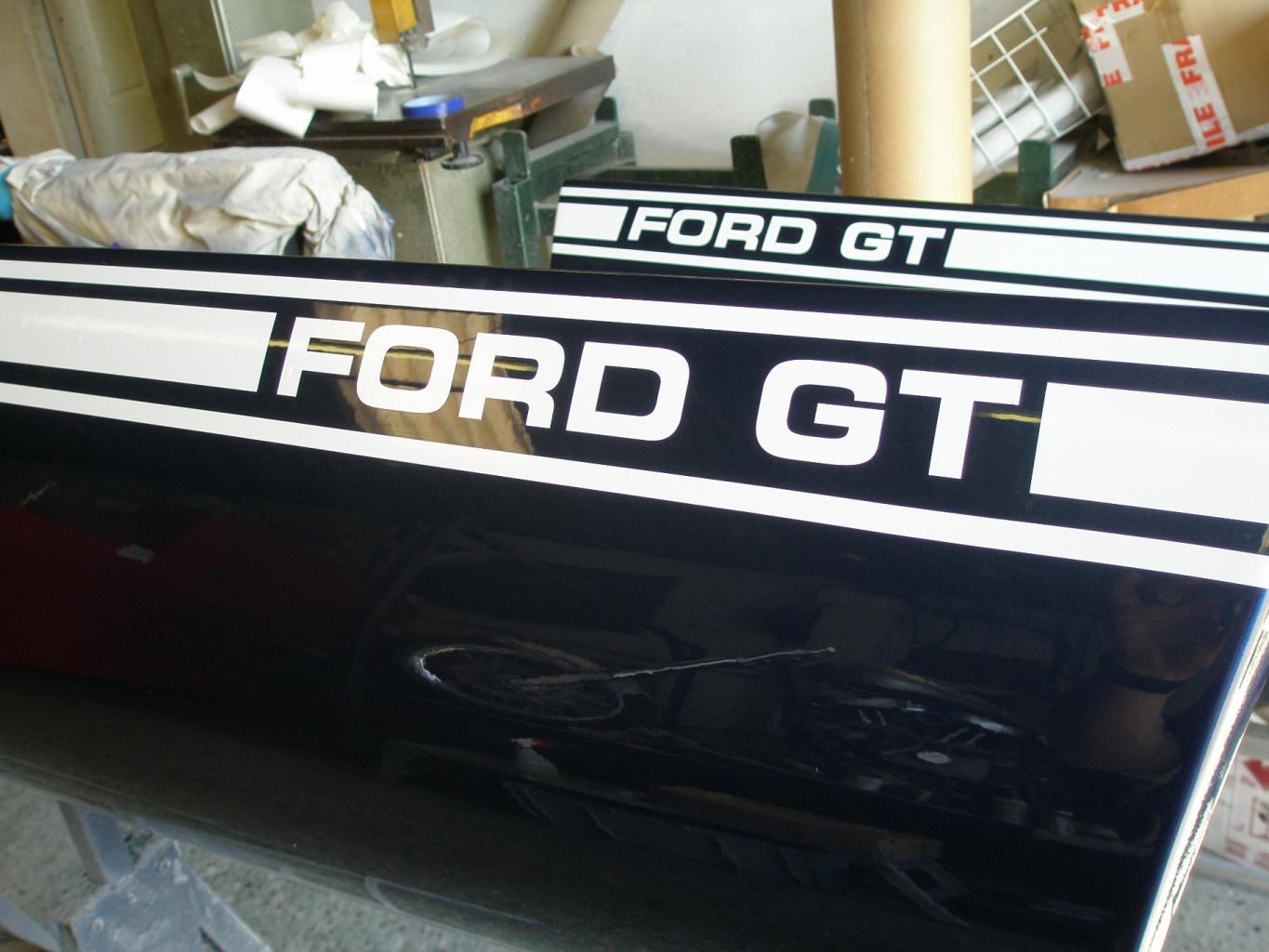

Hi all,
I originally thought I’d have it back together in a few weeks, but it now clearly not the case. There’s been so many little jobs that need doing or bits I’ve now decided need re-doing and this excludes the separate list of jobs after the cars on the road!
Registration was a lot easier than I anticipated; again the frustrating point is that I’ve been paying the road tax on in since the beginning of July, despite asking for an August start
Anyway here’s where it is at present. Next big job is to get the front screen back in – properly this time :laugh:
Rgds,
Andy
