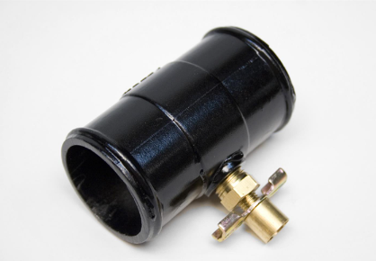

Thanks for the quick reply! My solution is to add something like this to drain the system, where it exits the chassis near the engine. Thoughts? I also need to make a fan shroud. Can I ask why you put, what appear to be decorative slots in it?

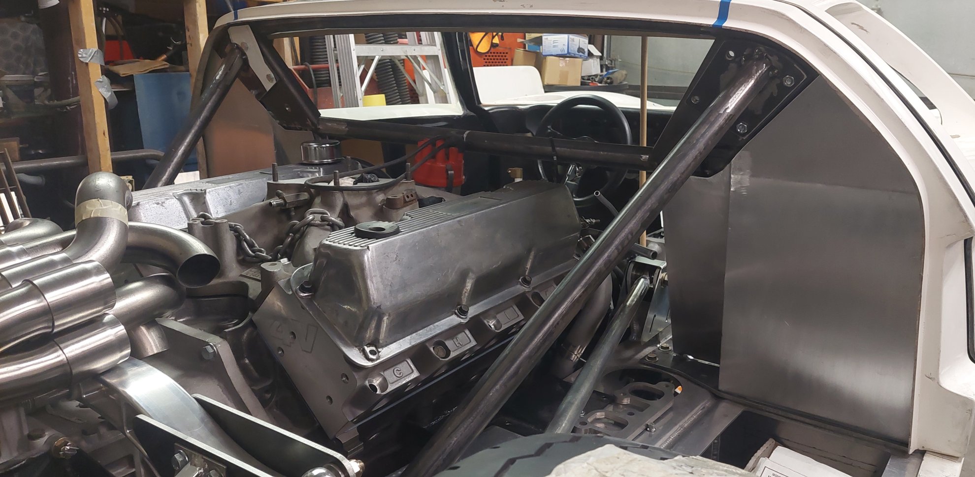

I do track and AutoX and didn't like the supplied roll bar or forward cage at all. By moving it behind the firewall I was able to get it farther out to the sides of the car and also taller. Where the supplied had no diagonal cross bracing, I now have diagonal bracing of sorts and a much bigger base mounting plate. The only draw back is forward cage construction has to be designed around the firewall. I also feel the rear braces are better except for the exhaust design is tighter.

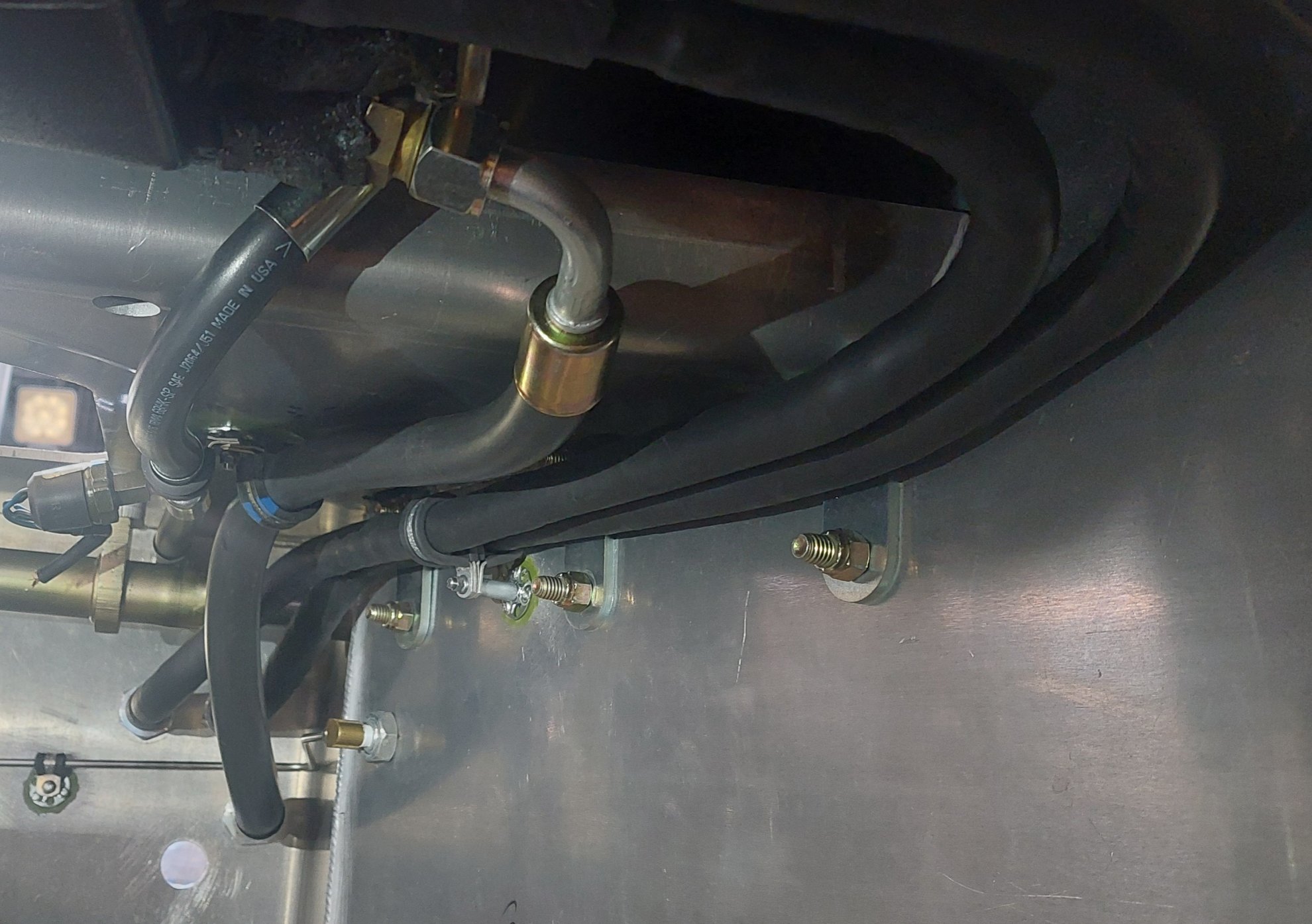

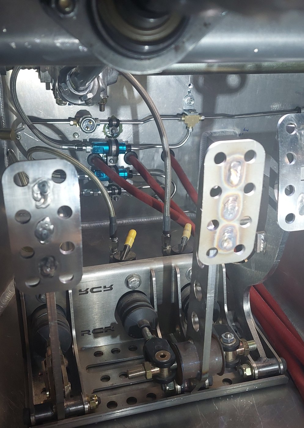

Well I have been putting it off but finally getting the routing and clamping sorted for the brake lines, heater, A/C lines and hoses in the footwells. After getting the heater - A/C, unit mounted, Used some threaded clamp standoffs and riveted them on with solid aluminum countersunk rivits. Wait to finish pedal placement after seat is positioned.

Paul, Looks good. Are the three red lines next to the spine for the A/C? Is there not enough room in the spine to fit them? Cheers, Randy

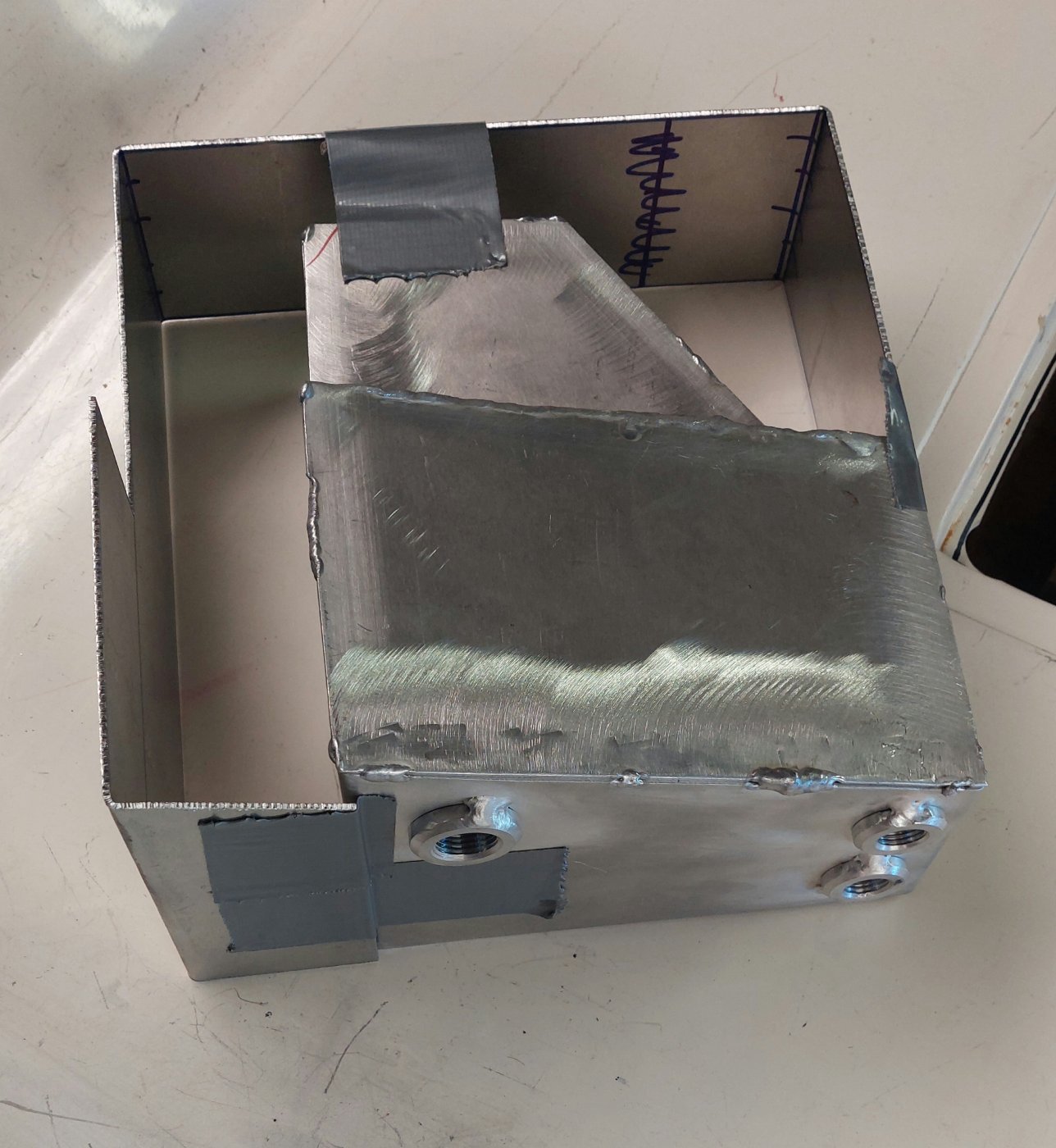

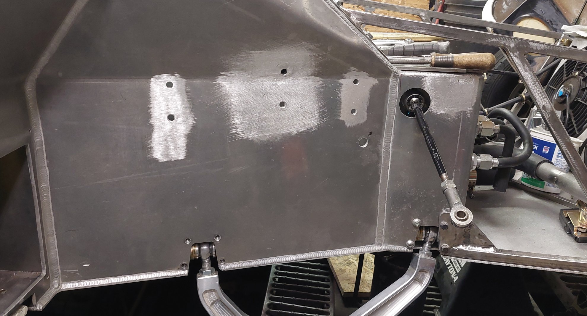

Starting design-build of a combination expansion, recovery, and overflow tank with two fill necks and recovery tank sight gauge. Will have lower return suction fitting and two upper bleed fittings, from the radiator and the engine. Tapered, angeled and fitted to the straight and angled portions of the firewall wings. Good practice for aluminum welding. Maybe by the time the car is done I will be able to run a decent looking bead.

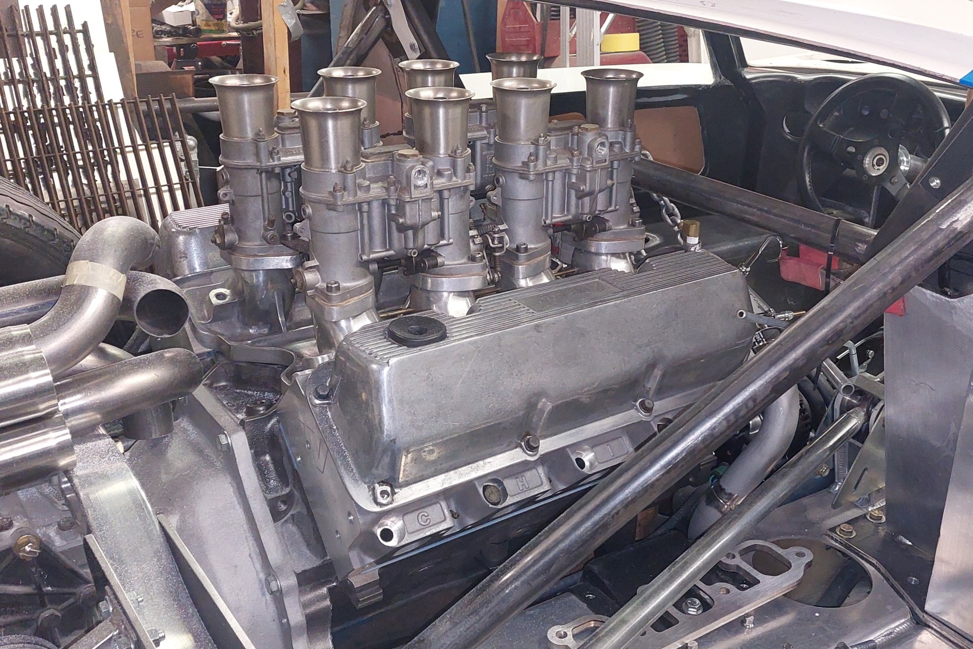

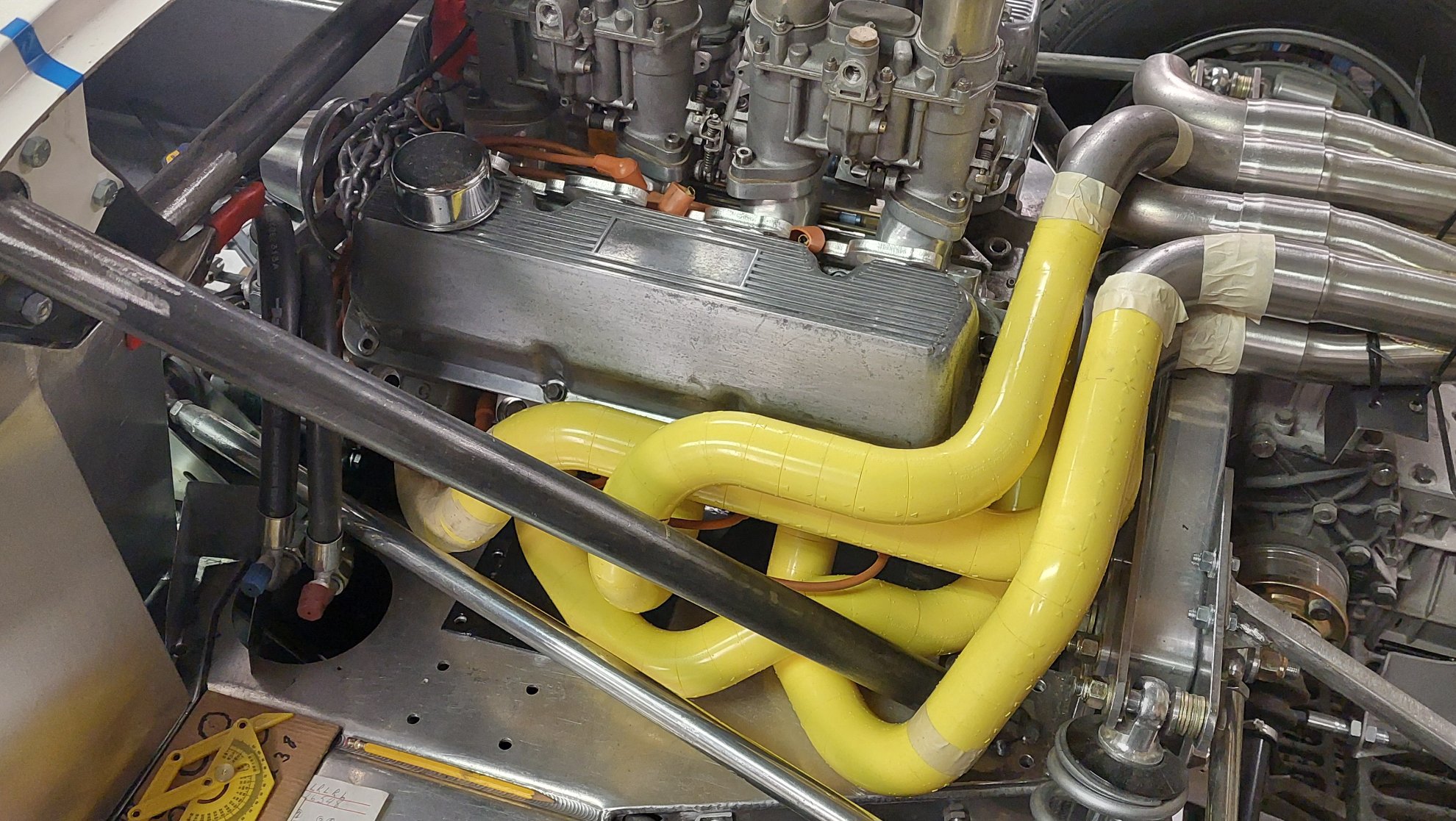

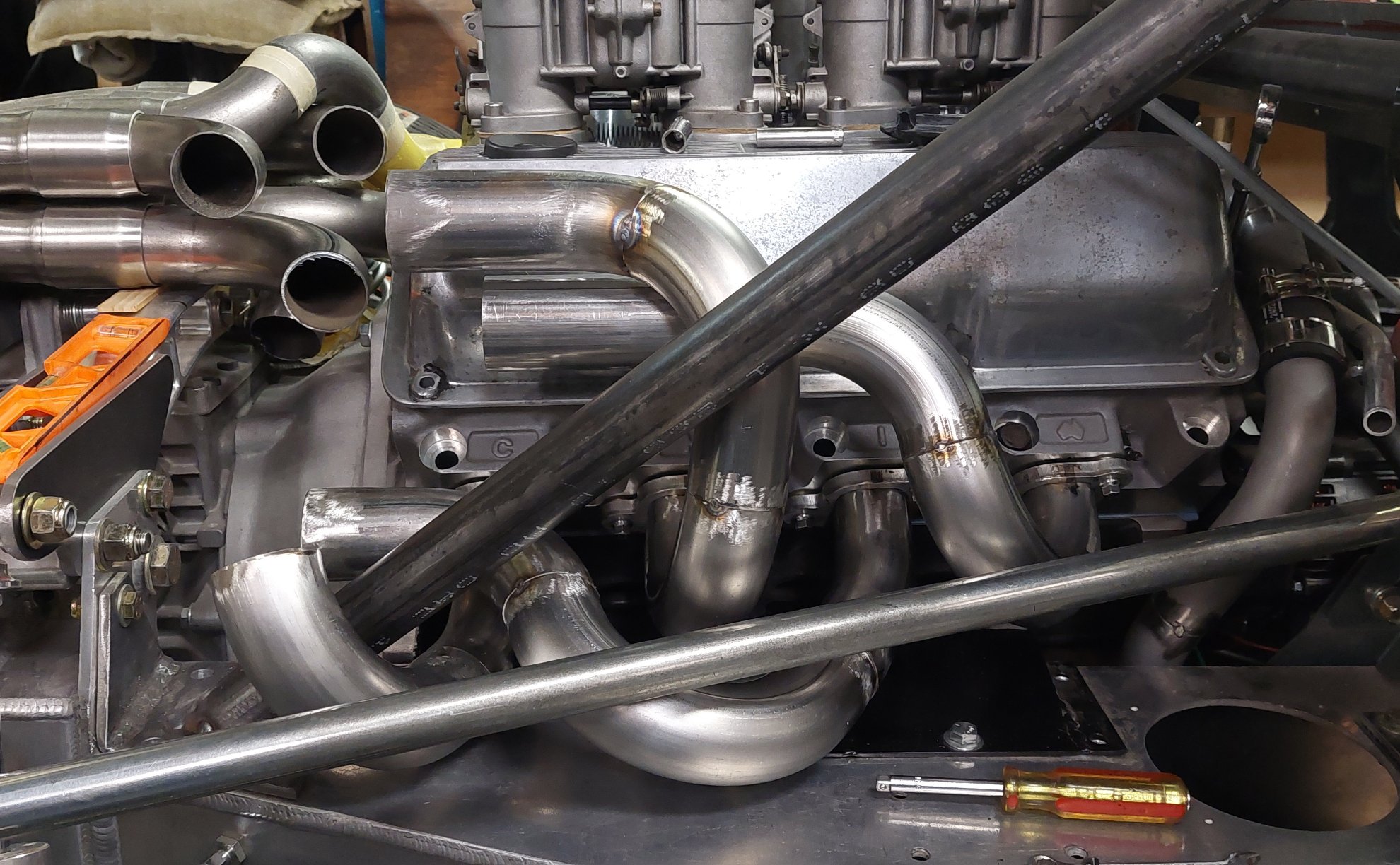

Working thru my header challenges with the cleveland engine and the repositioned rollbar support bars. Came up with what should work to get the crossover and keep them close to the same lenght. Also thinking about access to spark plugs and valve covers. Now to order up some 2 inch mandrel bends and get to work.
Paul T.

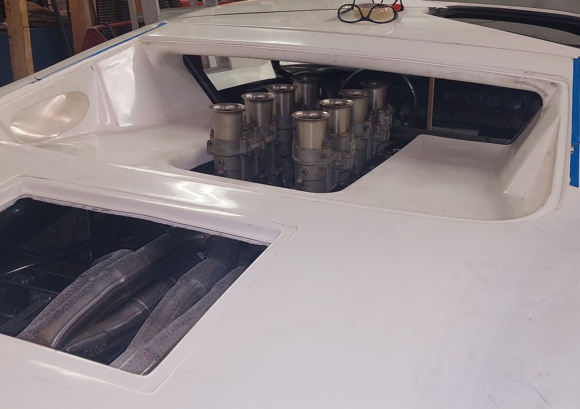

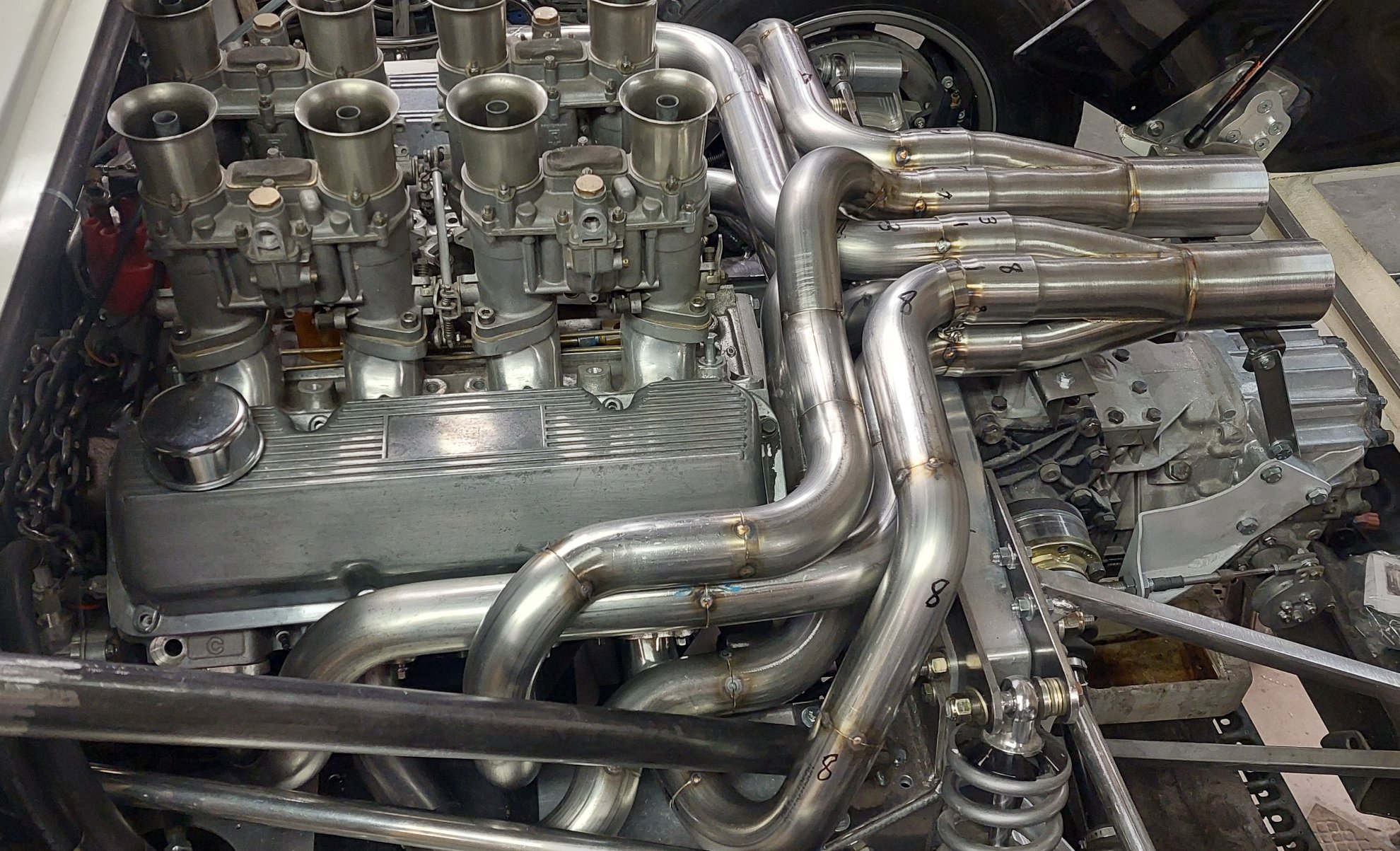

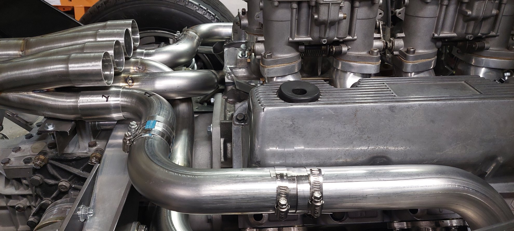

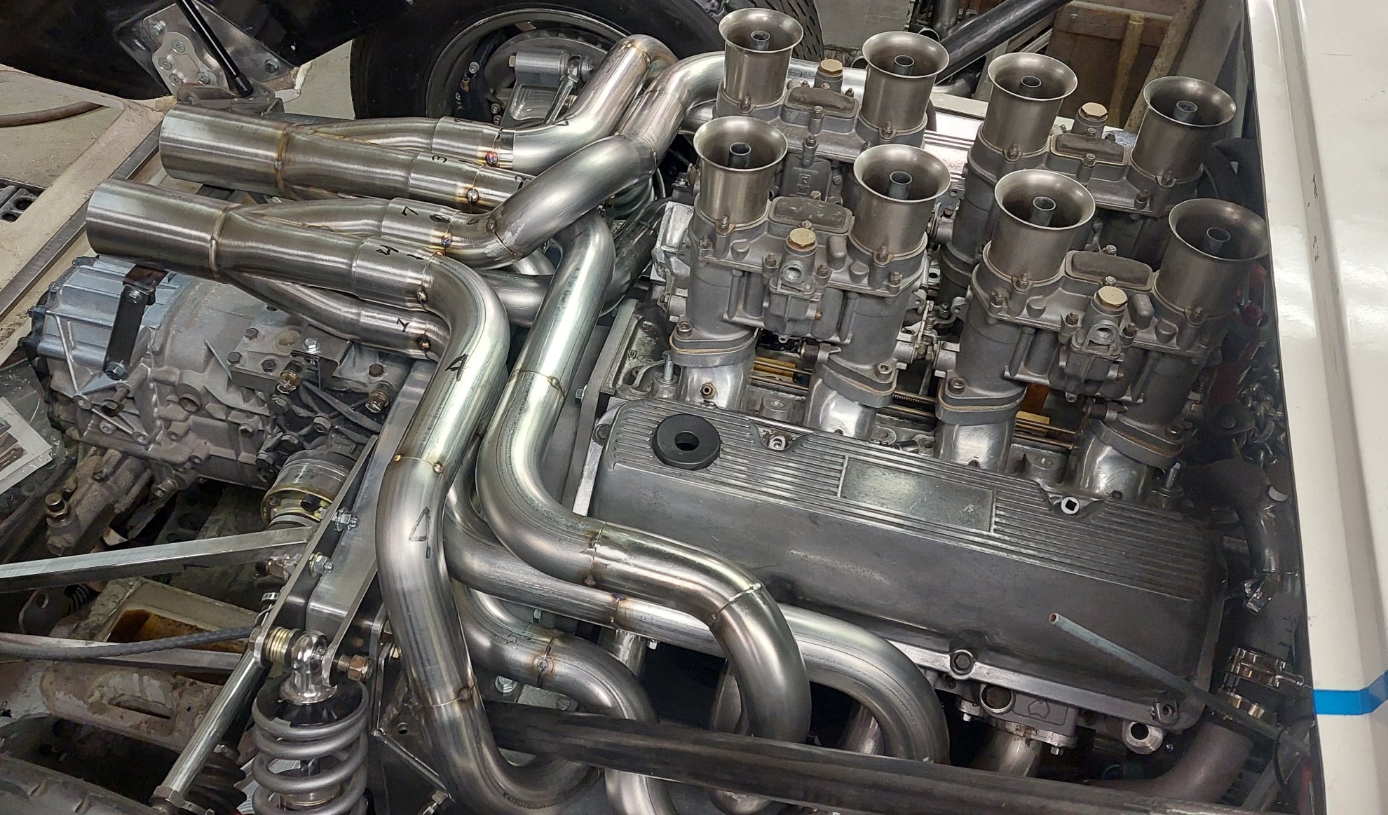

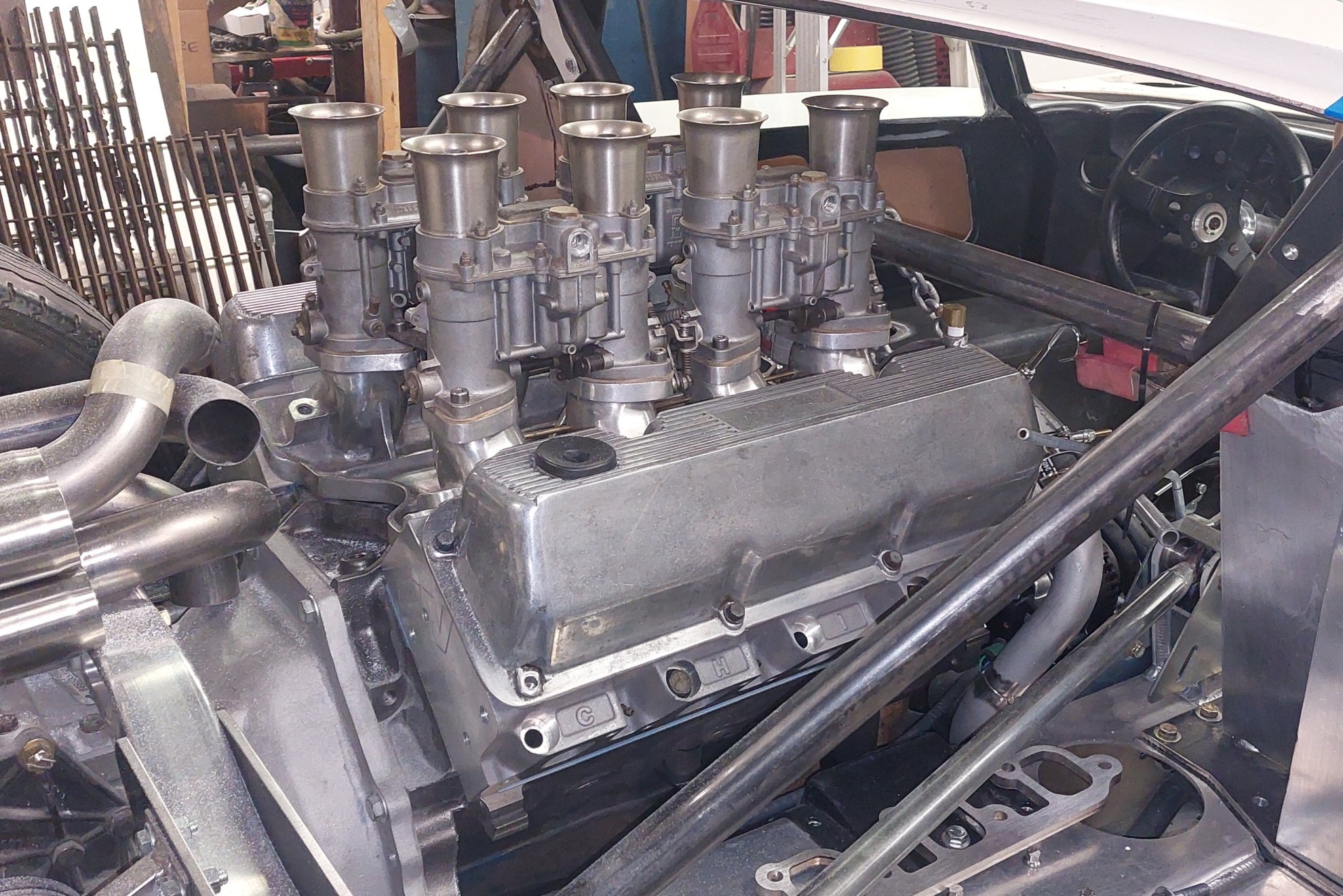

After a break on the GT40 to help my son with his 1914 Model T speedster I was able to get back to the headers, got them fitted and tacked together. Used hose clamps and cut up pieces of hacksaw blades to hold in place to tack. 2" 304 stainless with double slip connectors at the collectors. I've built headers for two other vehicles but these were definitely a challange. Have good access to all spark plugs and valve covers. Ended up with an inch of clearance between headers and clamshell at the closest place. Will finish welding later after getting some other things mocked up and decide what to do for mufflers.

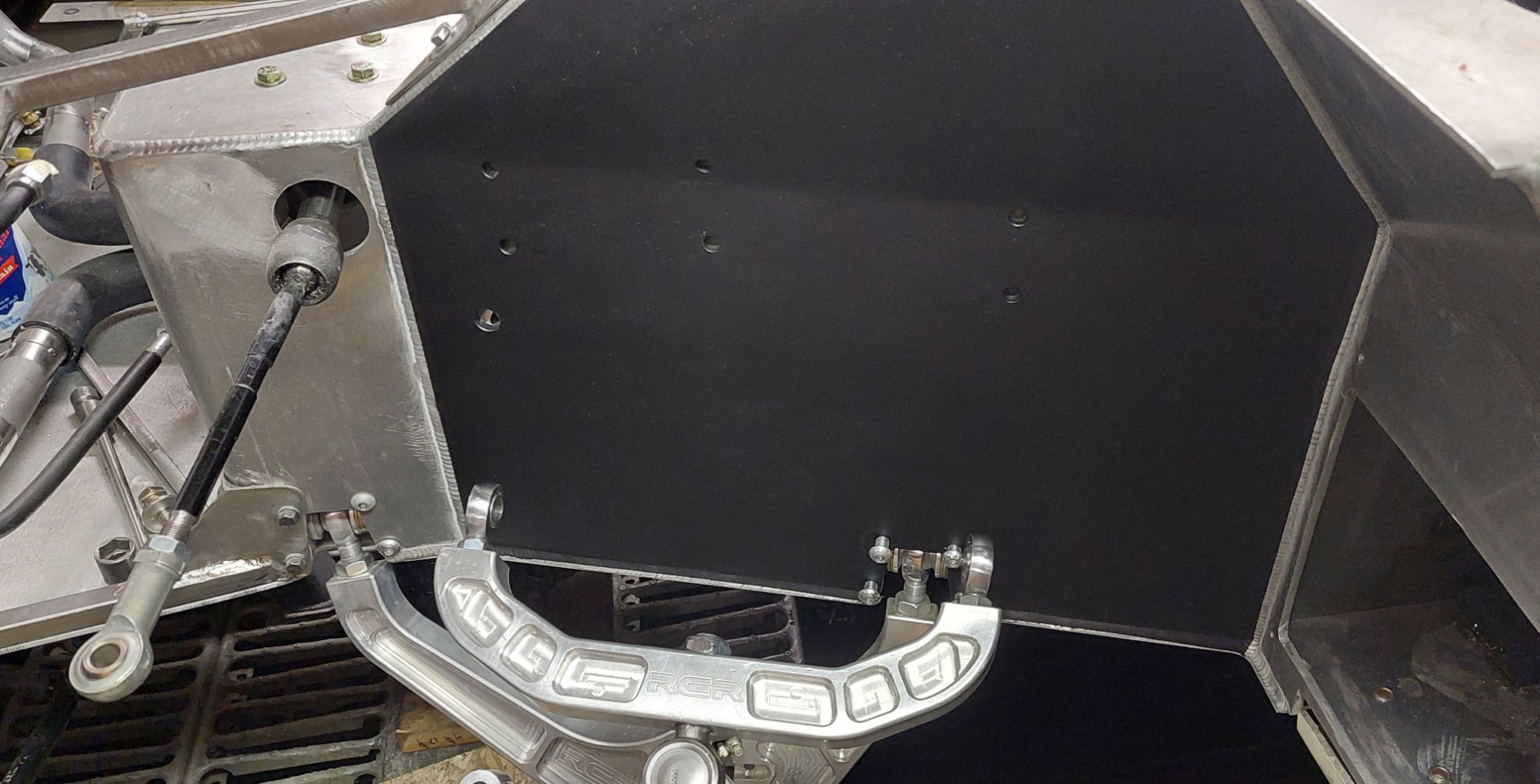

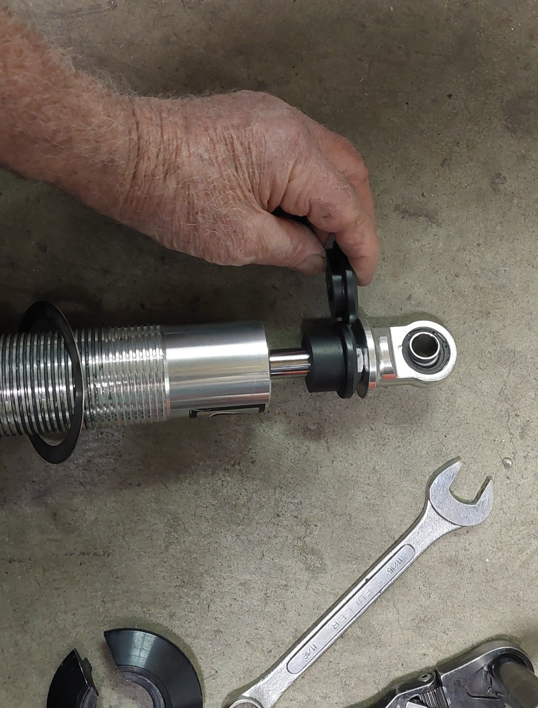

Working on front suspension, checking travel. Found it has more extension from ride height than compression with two limiting factors, The coilover and the travel on the upper ball joint- tie rod end, plus the coilover would bottom out with no stop. To increase the compression and lessen the extension I moved the upper coilover mount forward 1" and up 3/4". Put the travel closer to a 60/40 split instead of 40/60. Also now there is room for a bumper stop on the coilover to help it from destroying itself. Will determine thickness of bumper when I get the mount brackets back fron the platers. Wheel wells will finished in bedliner. Next comes fuel tanks while waiting for brackets.
