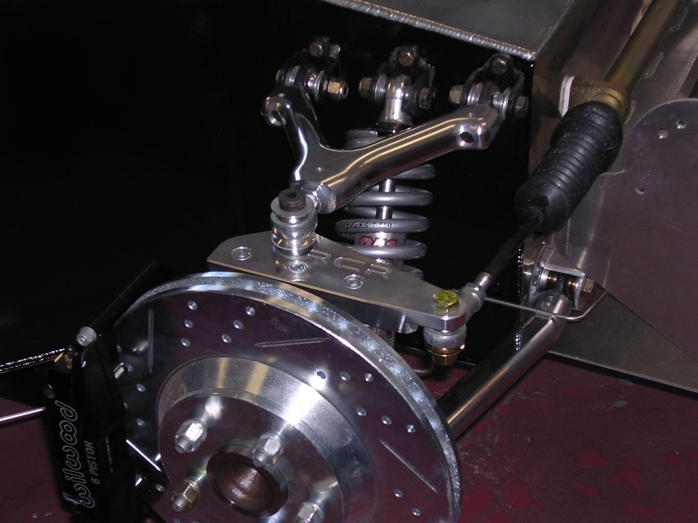

Randy, I have used Rust-Bullet on the bottom of my chassis. Works a treat!
As Thomas mentioned, replace the rusted hardware.
Some 400 grit on a DA should clean the rest up okay, then to a polish.
For polish I use Busch's aluminum polish (on-line) which can be done by hand or buffer. Haven't found anything better yet. The aluminum is still bright after several years.
No reason to powder coat after its polished. I had a GT40 chassis polished almost 8 years ago and it still looks good. The big advantage is that if it gets looking bad, its pretty easy to polish it again.
