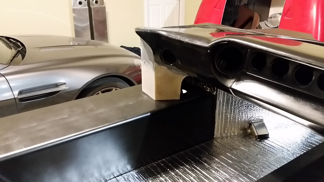

I had to modify my dash quite a bit to get it like I wanted it. My RCR GT40 is right hand drive so my dash is different than the left hand drive dash RCR GT40's. The ends of the dash that go down toward the sill only go half way down to the sill, they stop about 4" before the sill. I didn't like this so I extended the ends all the way down to the sill like most of the dashes that I have seen. The front edge of the dash that meets the windshield was very wavy and crooked (not level at all, so I trimmed it to match the windshield profile and then molded a return down to the aluminum mono and sanded it to match the windshield profile. One side of the top edge of the dash was low by 1" (where it lines up with the door when it is shut), and the other side was .5" low so I had to split the dash on both ends and re-fiberglass the ends so that they meet the door profiles like they should. After about 60 hours of work my dash looks good now. You may e-mail me at gt 40 rick @ yah oo . com no spaces and I will reply with my phone number. I hope to be ready for paint by September so I have probably encountered many of the same issues that you may have.

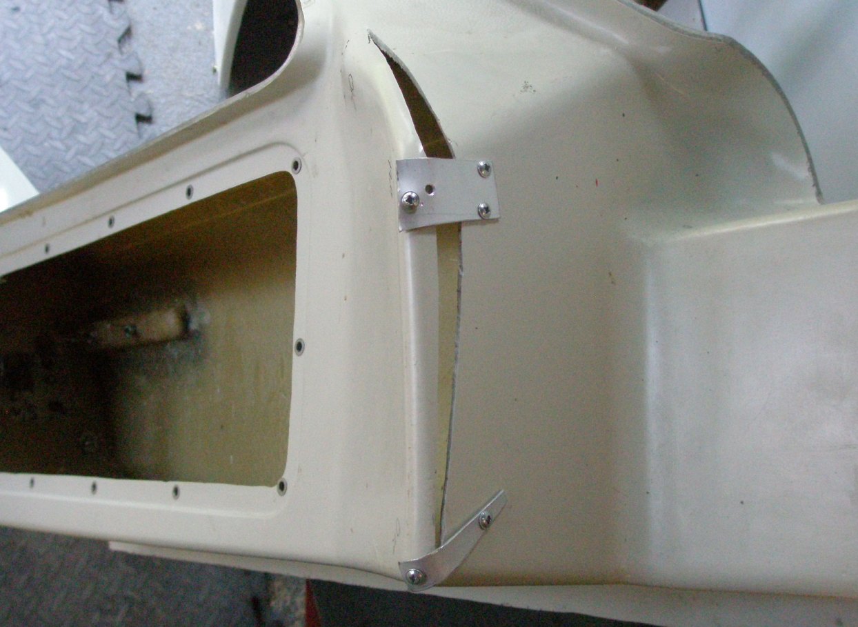

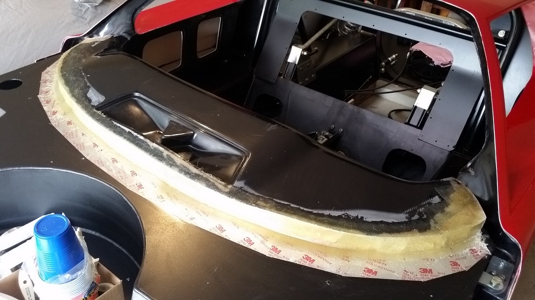

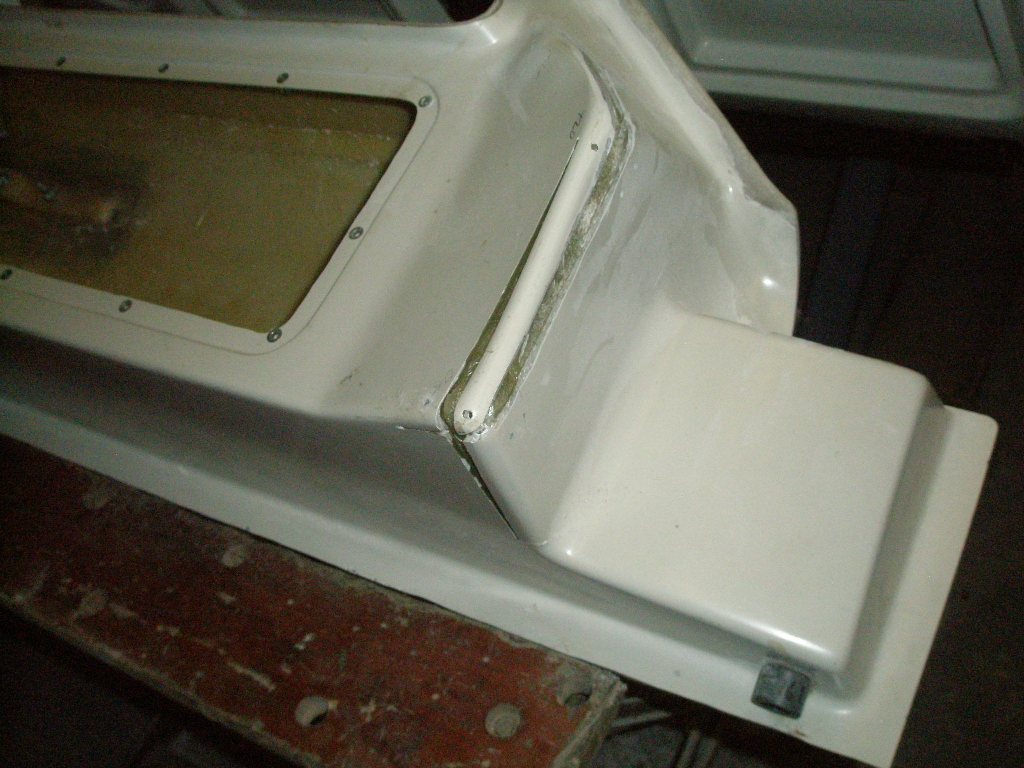

Hi Louis,
When I built my ’40 (a Tornado) I had similar issues with the door to dash panel gap, mainly on the left side. To resolve this, I split the door skin & pulled it to where I wanted it.<?xml:namespace prefix = o ns = "urn:schemas-microsoft-com<img src=" /><o:p></o:p>
By heating the panel with a hot air gun, it can be gently reshaped and when it cools it will retain the new shape and then re-glassed<o:p></o:p>
This was done as 2 separate operations (i.e. each plane cut, opened up & re-glassed) which made it easier, but was still a real pain.<o:p></o:p>
Regards,<o:p></o:p>
Andy<o:p></o:p>

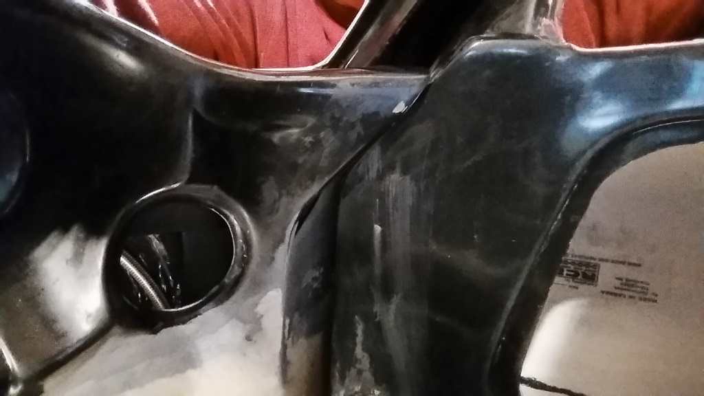

This may also help explain.
Regards,<?xml:namespace prefix = o ns = "urn:schemas-microsoft-com<img src=" /><o:p></o:p>
Andy<o:p></o:p>

Pictures below will help clarify my dash to door fitment issue mentioned in my previous post.
