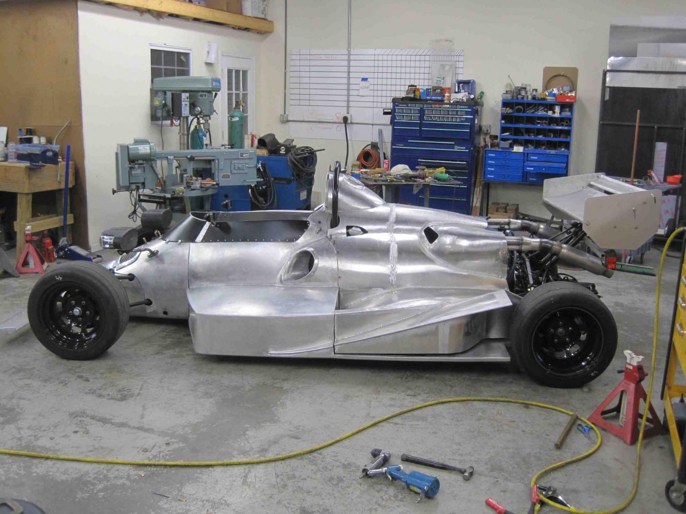

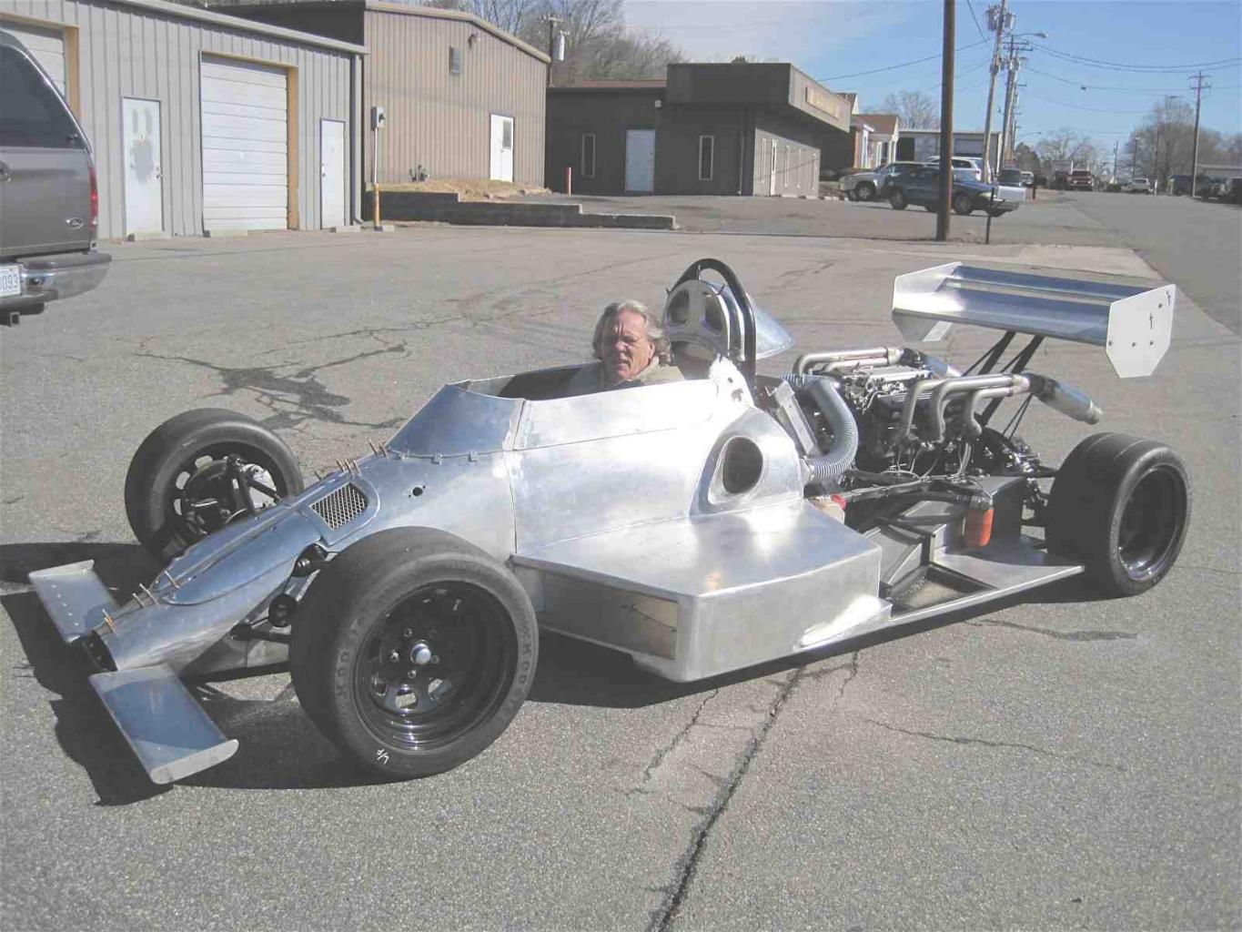

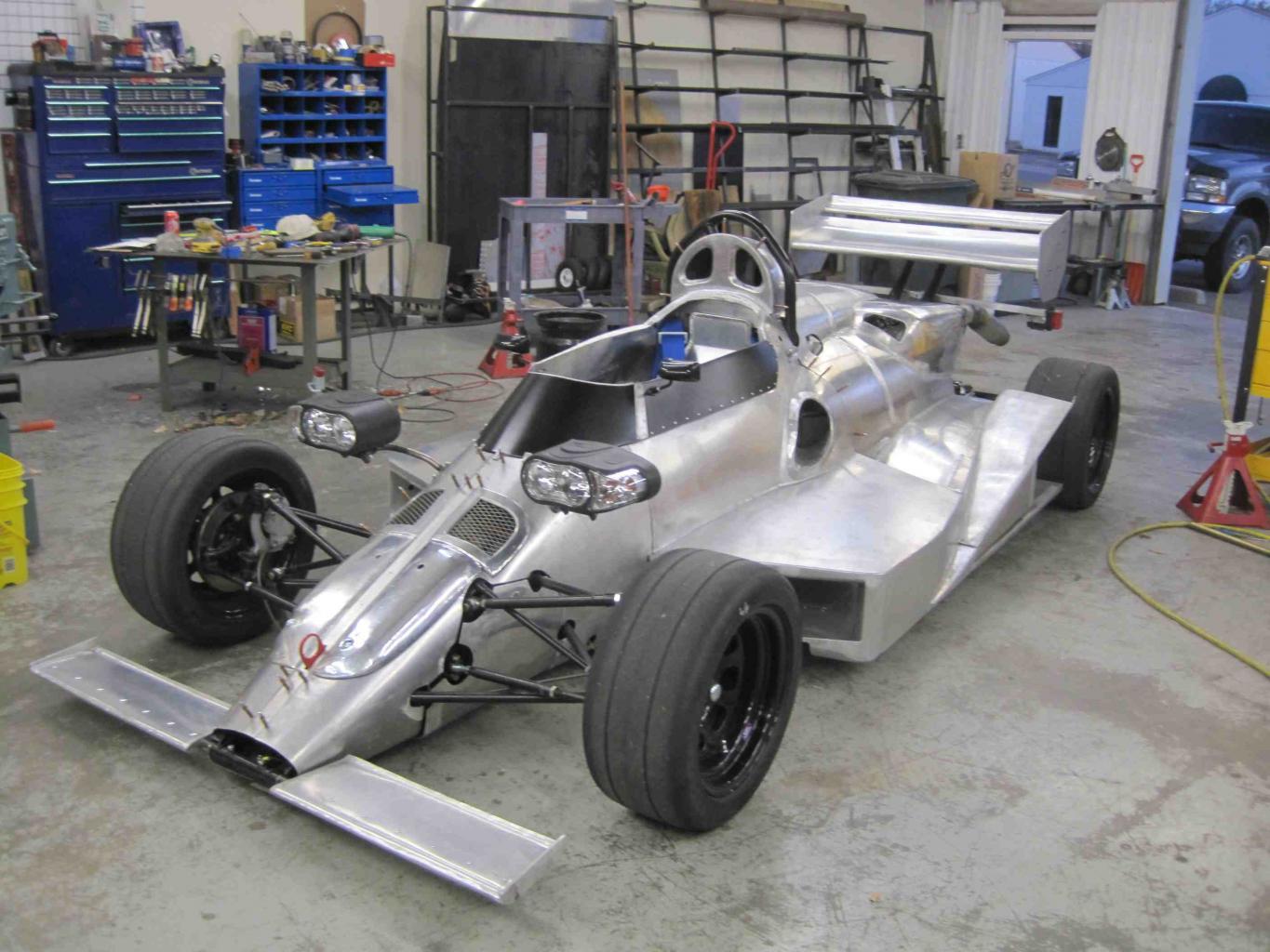

While there I shared with Fran a few photos of my latest build .... could something like this be a possible next design project for RCR?:laugh::laugh::laugh:
Thanks for your hospitality, Fran.
Dick Bear
The engine is a refreshed (but stock) LT1 Chevy taken from a late 90's Camaro and the transaxle is from 2002 VW Passat with a custom design adaptor plate and after market clutch/flywheel.
My theory concerning the power generated by he engine as opposed to the size and strength of the transaxle is: the lightweight of the car (1,800 lb.) will offset the possibility of damage to the transaxle through drive wheel spin. That's the theory and if correct the cost difference between the VW Passat ($200 each) and a proven large bodied transaxle ($4-8,000 each) will keep the system within my means. We'll see! :rolleyes:
