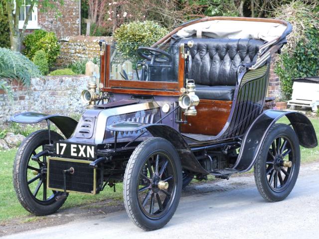

Just pushed this out of the shop yesterday for first road test, 106 years old and now running fine. After 100 years of assorted engineering we found the brakes assembled back to front, the gear selector linkages upside down and the engine just about staggered into life. And all of 1 horsepower !

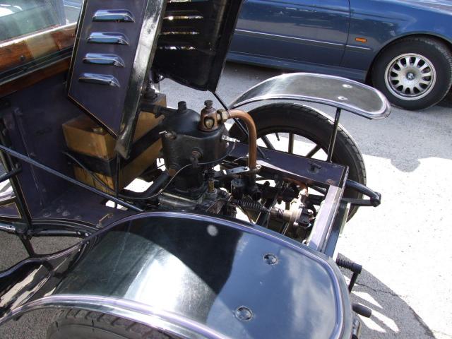

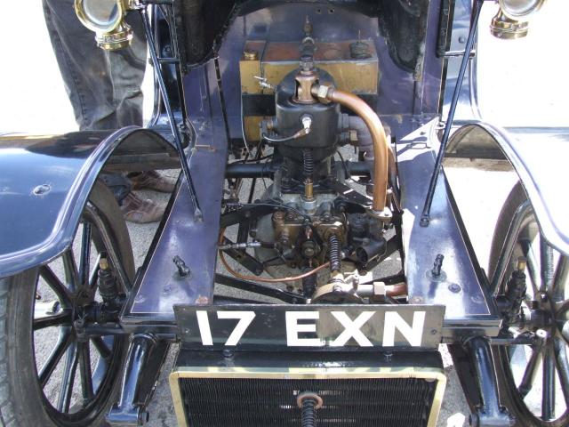

Is that a suction intake with an cam driven exhaust? Looks like some of the old stationary engines used around here in the early part of the last century...except minus the water trough/tank for cooling. I love old engines, the absolute bare neccesities. Combustion technology has come a long way, for better or worse :-)
De Dion Bouton made a large number of early engines and sold them on to whoever wanted to buy them and they were fitted to a number of other cars. You could even buy a ‘Selfridge’ for Selfridges in London – they sold their own car in kit form…. You could go in each month and buy the next bit and slowly put it together yourself …. or someone would build it for you… (sound familiar?). They are quite reliable (??) engines and high revving – max around 1,500 rpm. A number have been found on farms as they were often used as agricultural engines when the cars came to the end of their lives.
De Dion were quite advanced in their day – this engine has variable exhaust valve timing and lift (you cut the lift to help with engine braking) and this car also has a mechanically operated pre selector type semi automatic 3 speed gearbox, with internal wet clutches in a transaxle unit and was the first to use the De Dion rear suspension (hence the name) – not bad for 1903! Mind you, they didn’t get it all correct though – the inlet valve is atmospheric – when the piston goes down, the valve opens by suction. You can ‘tune’ the engine by altering the stiffness of the valve spring….. mind you its all rather marginal, but every ¼ BHP helps!!
