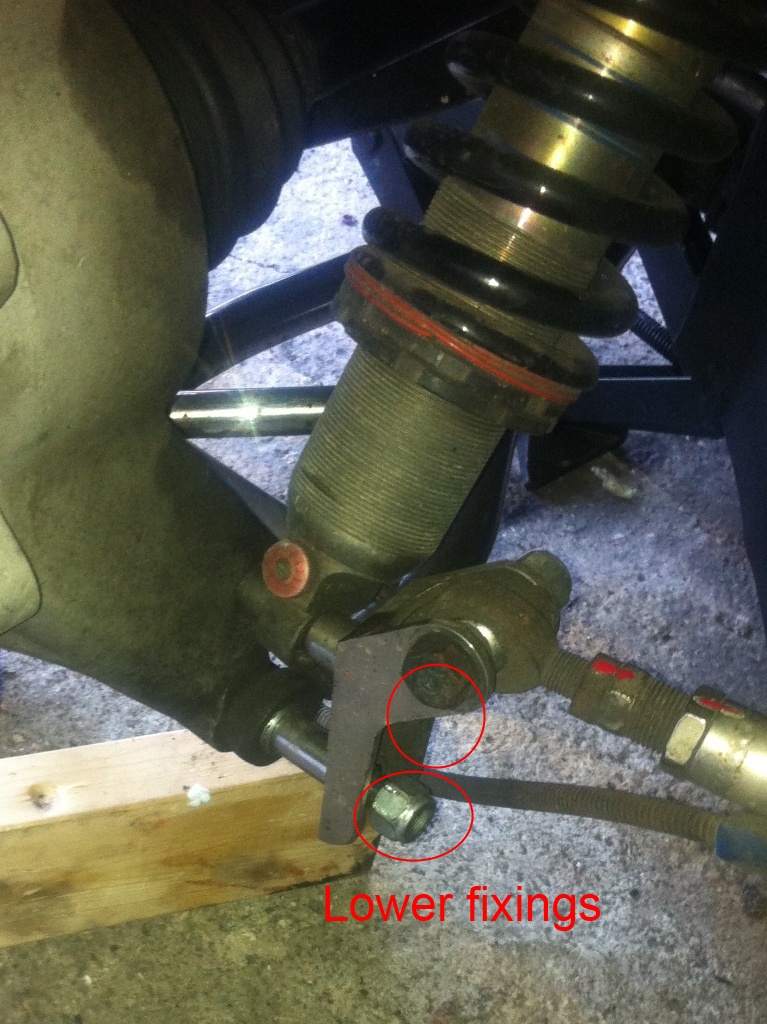

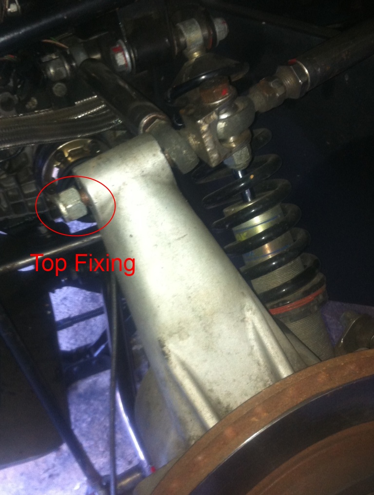

have a bit of a clonk at the os rear and think it might be rear wheel bearings ( it seems to be speed and wheel rotation related). I have started to take the rear upright off the car and have come to a stop.
Below are pics.....
attachment.php
attachment.php
I have slackened off the top and bottom upright fixings, removed the brake caliper and now need to be able to remove the upright from the driveshaft.

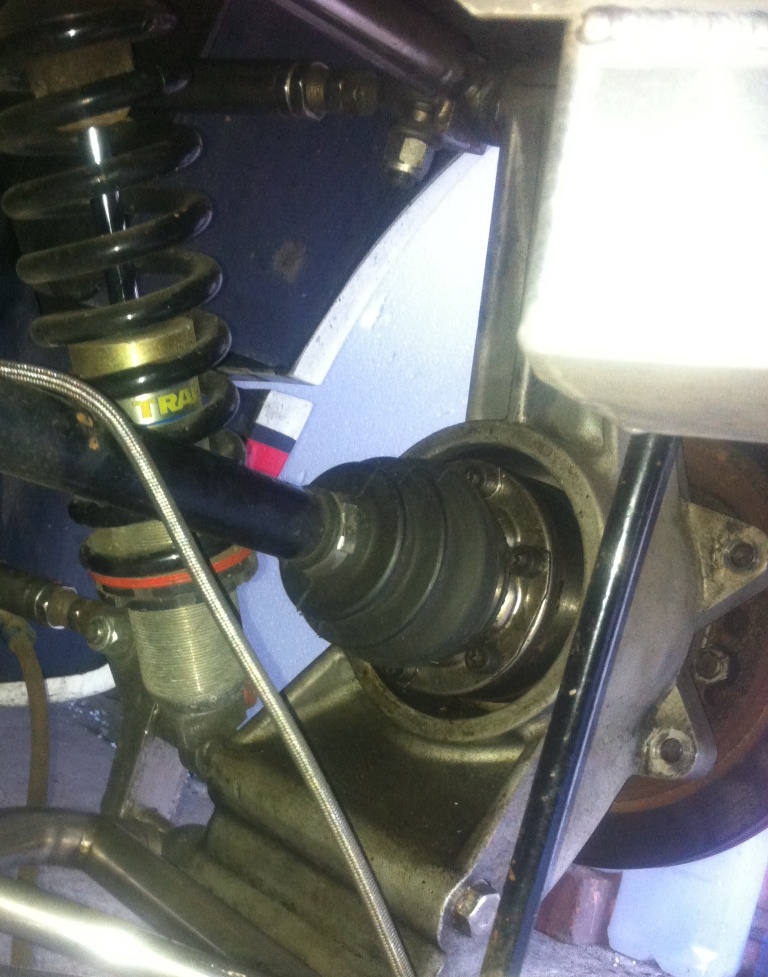

attachment.php

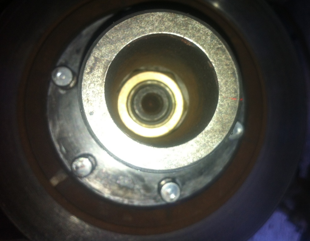

Looking down the end of the stub axle, I can see a nut on the end of the driveshaft but cannot get to it easily.
attachment.php
Do I need to remove the bolts around the drive shaft at the rear of the upright, or somehow remove the disk and get to the nut on the end of the drive shaft.... or both?

I have a hub nut socket if you want to borrow it
It takes a hell of a force to move the nuts

Maybe I didn't explain very well..... I have already loosened the top and bottom hub carrier fixings ( those highlighted in red) if that is the "safety issues" you are speaking of. If not, please tell me what you have seen.
