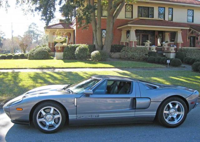

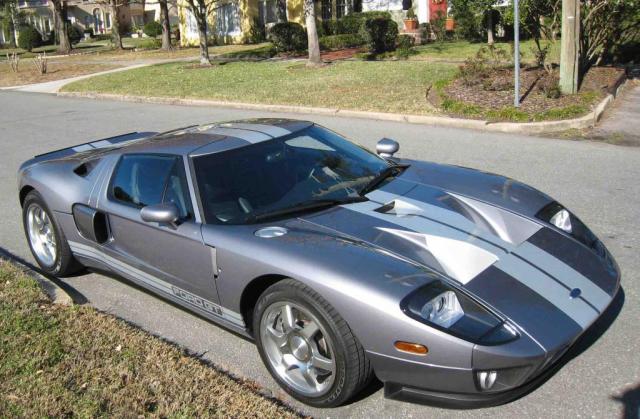

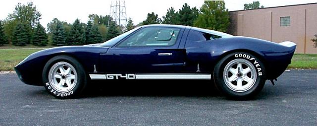

What if you were to modify the latch mechanism inside the door like a modern car, or even install a more modern latch but keep the door handle. I've looked at several pics of the door and it looks like there's lots of room in there. The only thing that would worry me would be the the reccess in the door for the clamshells air intake. because of that you would have problems mounting the glass flush. On the other hand the ford gt has rolldown windows and the side profile of the door has a close resemblance to the gt 40 and it looks like its glass is flush to the door.
Here pics of the gt and gt 40. Doors look similar, I think rolldown windows can be done.
