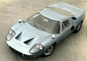

Well he used to frequent this forum posted a picture of a motorised window system that he had acquired that was at one tome on a Sparro machine
What if you used it in the reverse of the subaru where as the front half of the window went up and down this way you would avoid the lock and door handle issues, this has given me new ideas on how to do mine now, thanks guys.

If memory serves....... there was one GT40 MkIII road car which was modified with roll down windows... wasnt it the one built for a famous conductor???? cant remember the chassis number......
anyone???
Edited...... after google search...
"Of the seven Ford GT40 Mark IIIs built, only four were delivered with left hand drive like this car. This rare street-legal example (serial #MK3 1105) was originally owned by well-known Austrian conductor Herbert von Karajan, who drove it sparingly and never in the rain."
And it wasnt this car with the roll down windows........

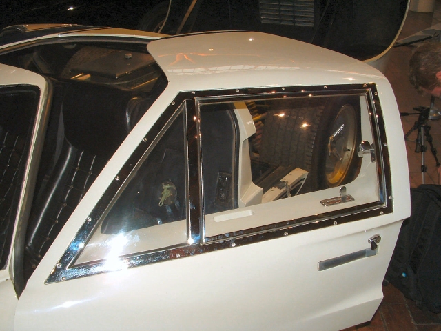

Also found this MkIII with chrome surround side windows (although not roll down).
Andy
Doc Watson
Found it......not!!!! this is not a roll down window.....

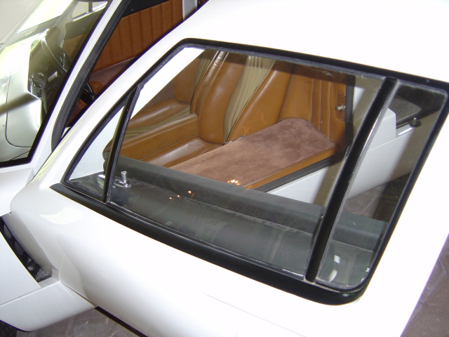

I know I had seen it somewhere (actually in the flesh!!! its at the Beurley Motor Museum in the UK)
Any more info from anyone??????
Andy
I think that for those who, like Dimi, use their cars frequently on the road, a roll down window isn't vital but would be extremely useful and pleasant. However, it would reduce the storage space available in the door.
Some years ago, before Ford put out the new GT, I studied this and proposed to a local kit builder that with a fixed front "quarter" window, a roll-down could be fitted if the glass wasn't really flush, but the back corner was inset slightly so that the glass rolled down into the door inside the latch mechanism and air channel recess. This inset could be disguised with a blackout or trim. The builder said the angles were all wrong and it couldn't be done, but I thought it possible. Obviously, the glass would need to be curved in one plane, and wouldn't roll all the way down, but I thought it would feel much better and be useful. Then what happens, but Ford follow this approach (successfully) with the new GT. If someone developed a kit for the replicas that could be retro-fitted into the doors, I think it would be purchased and fitted to many of the road cars, but it wouldn't be cheap.
In the meantime, the DRB road cars here are tending to use the Mk III type hinge out windows, with a fixed front quarter, plus lift off type hinges so you can have fully open areas that are quickly "windowed" again if locking up somewhere, or if it rains.

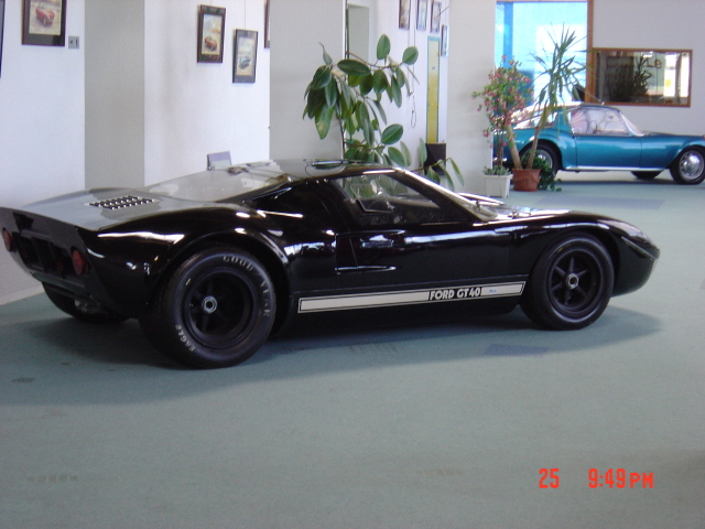

Hi Guys
is this what you want? electric door windows.
regards
Chris.
Chris - Who's car is that? Would be very interested in hearing more...
Hi randy
Its one of Franco Sbarro's GT40's it was on display at Franco's car design school in Switzerland. It had full leather interior.
Regards
Chris.

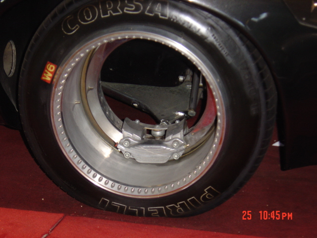

Interesting exhaust system on the car shown - not to mention the braking system shown!

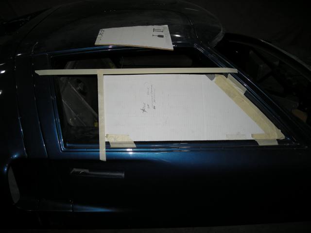

Made a crude mock up of what I envisioned the glass to look like, this mite be doable next step is a trip to my favorite bone yard and look at windows and regulators
See ya later,
Bob
