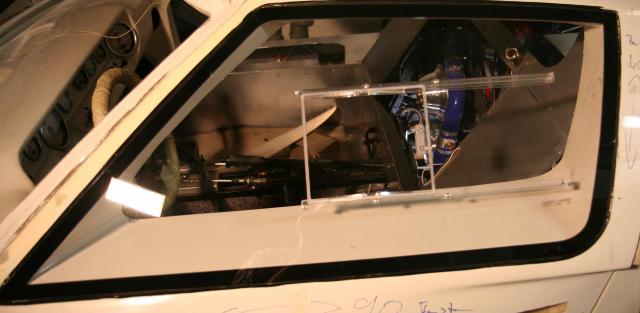

DRB here in Australia have a Mk III type of window conversion that can be bolted or fibreglassed into place with a fixed quarter window and a hinge-out main window. The main window can be readily unclipped and removed. A good compromise, but I would like to see more development on the roll-down window idea.

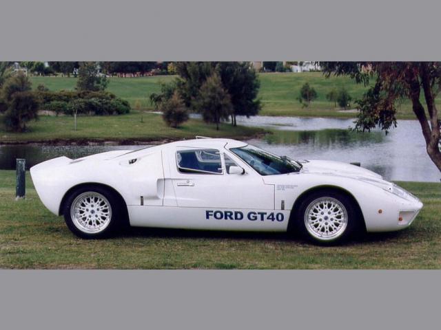

Hi guys,
I use a slide window and I am very happy with the result. I made a few short test drives and it works very well a lot of air comes in and I can reach the parking ticket machine :-)
Also it doesn't disturb the original look to much .....
...Here is a picture....
Also it is compliant to german regulations, see the watermark ? :-)

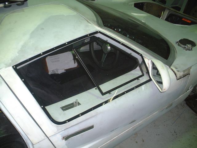

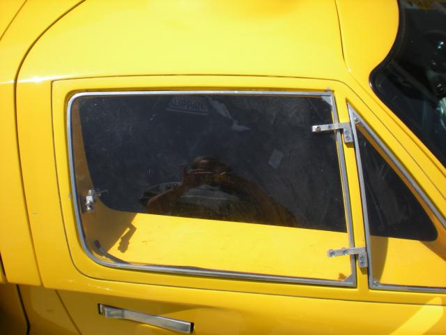

I made these windows.
I made the frames then urethaned the windows into them.
The frame has a seal around the outside.
The window is held in with toggles that are turned 90deg.
I find it gives a large opening.
Jim
