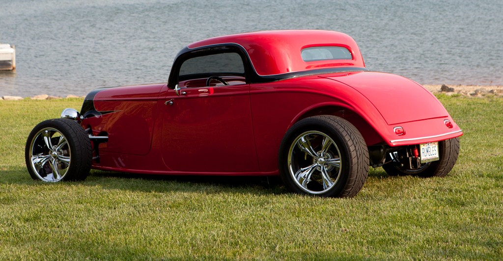

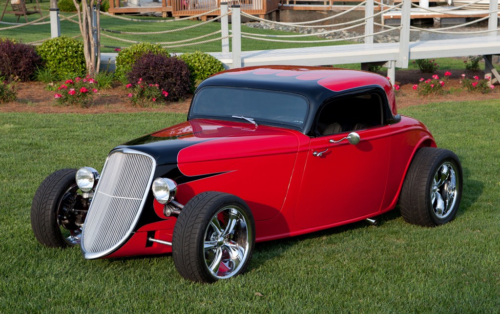

Here are a few PICs of my Hot Rod

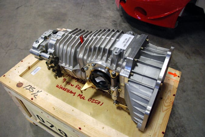

For all of your G50 questions and/or items I would recommend contacting Stan (PORSCHE RACING AND STREET GEARBOXES-GBOX Transmission) and/or Roger (California Motorsports Kit Car section - FFR GTM Ultima GTR GT40 inverted Porsche transmission transaxle).
Mendeola's SDR-5 may be a five-speed option. You will be able to use an LS clutch set and starter and it will bolt up without an adapter kit. Mendeola Transaxles, Inc.
I'm personally running a G50 20 that Stan inverted and added a taller 6th to. If I had to do it over I would have had him re-gear all six. As it is now 1st is really only good for driving onto a trailer or for making a really smooth very low RPM start. However I will be able to cruise at 70mph @ ~2000rpm.
