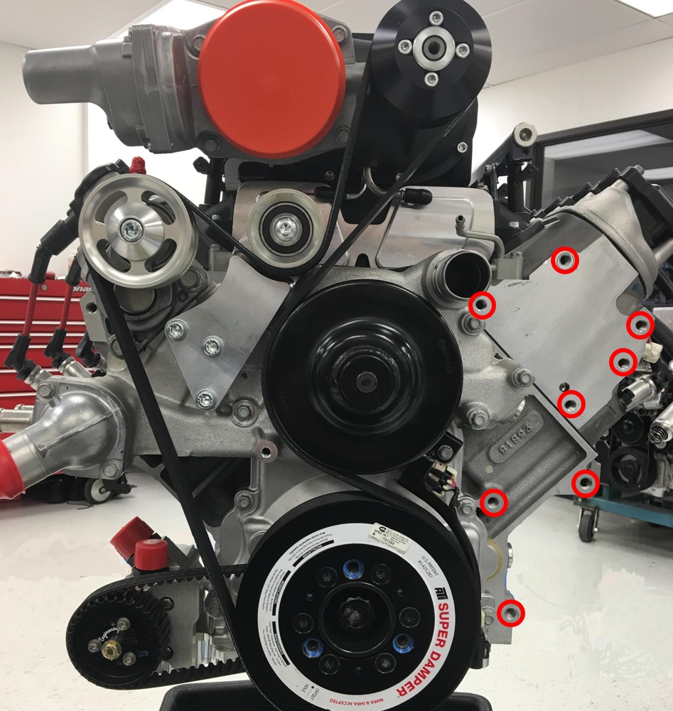

Because I went with a Daily Engineering dry sump I need to relocate the A/C compressor to the driver's side of the car. This requires a custom A/C compressor bracket and potentially a custom alternator bracket. The engine is currently installed which makes it really difficult to take measurements. Does anyone know where I can get the bolt pattern for the 8 bolts circled in red in the picture below? They're OEM LS7 block and heads. I'm also looking for the distance of the pulleys from the face of the block.
