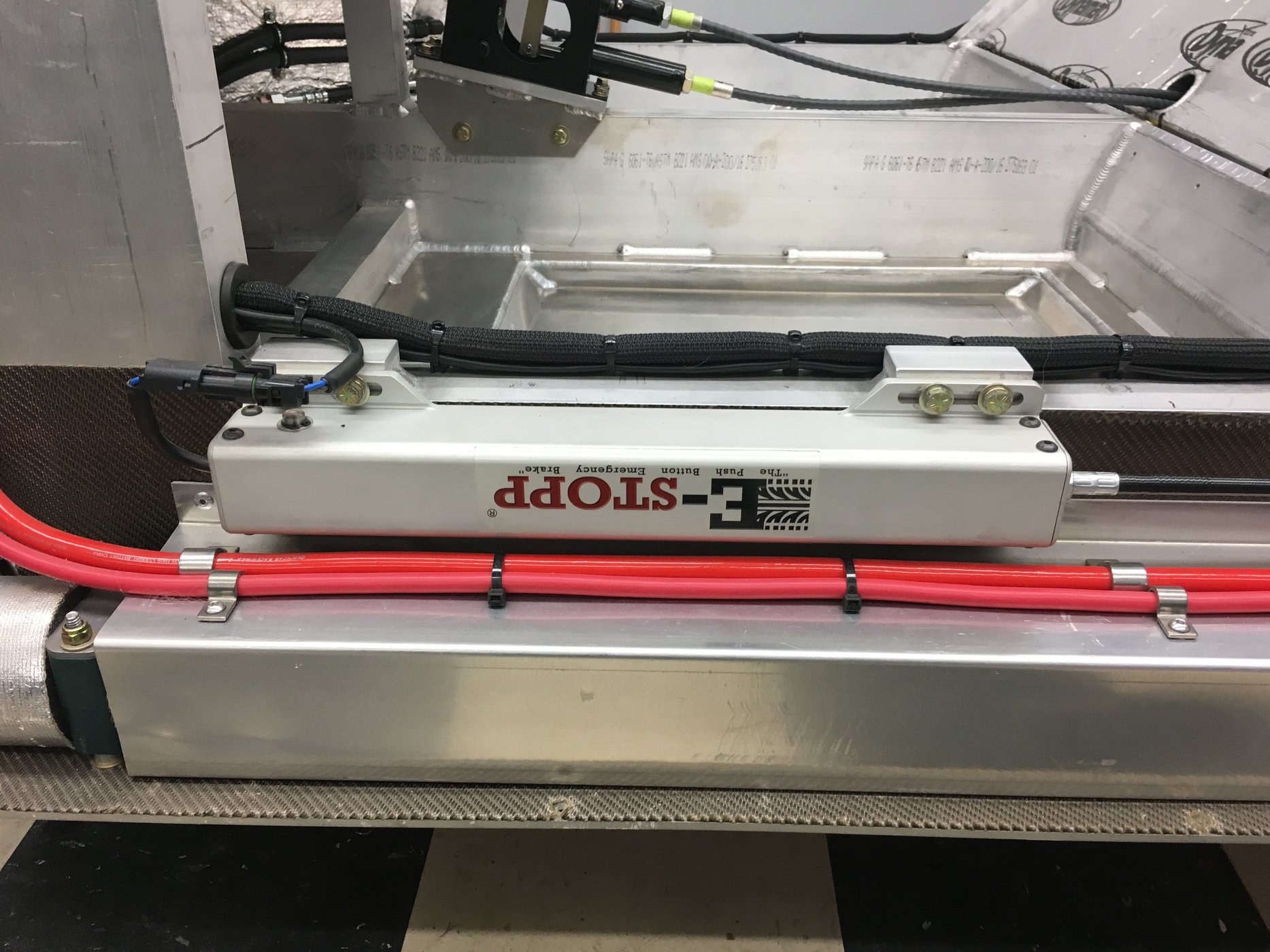

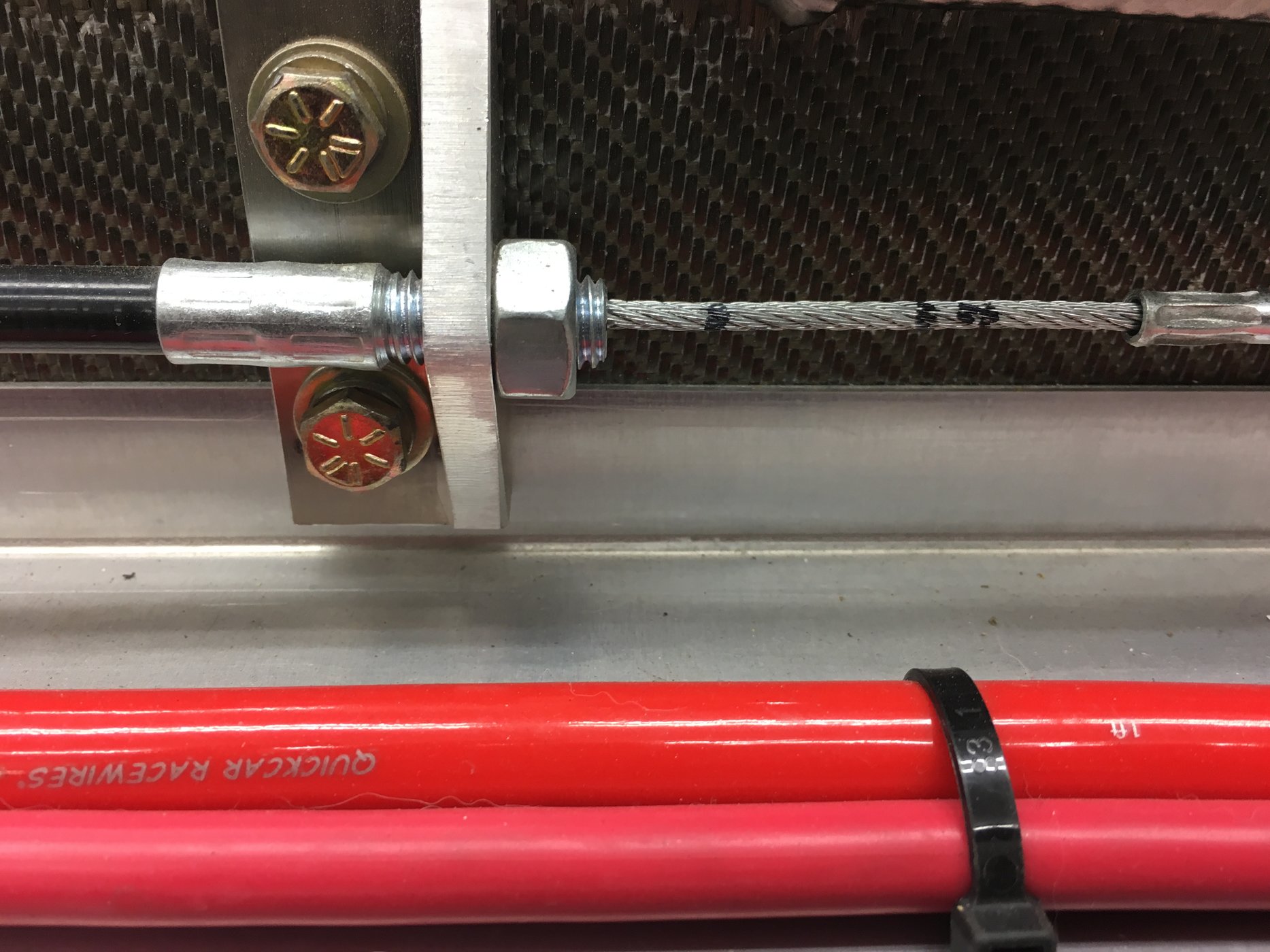

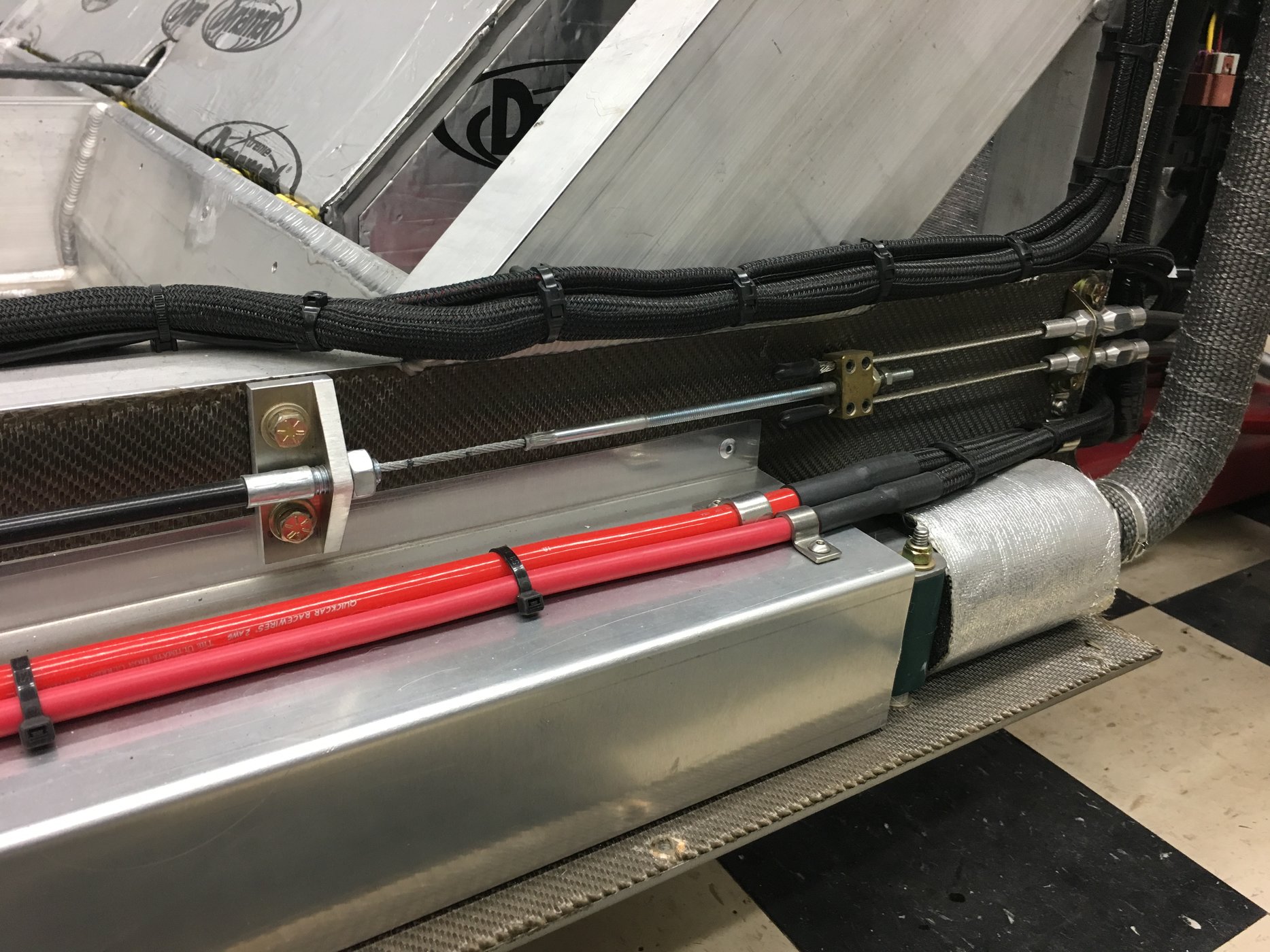

I have had no luck with the E-Stop .. Pics show .. It does fit nice .. Too bad it almost rolled over my wife while loading the car on a trailer.
MANY calls to E-Stop .. No Help .. Mine would also never stop in the same spot. See the black marks on the cable .. I kept marking it to try and get a consistant pull length .. I GIVE UP ON IT !! Gonna order the one Scott found ! MY HERO !!!
Joel K
Just wondering is it possible that the parking brake pads are not burnished and that is why the E*stopp cannot apply enough pressure?

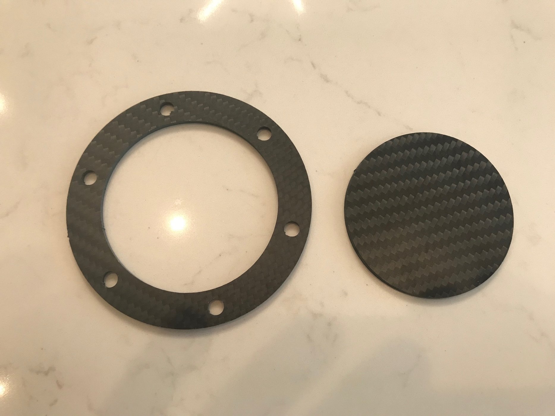

I cut my first piece of carbon fiber on the Wazer this morning. The cut is very clean with no chipping, no dust, etc. The picture is 3mm matte plate with no cleanup... the only cleanup that needs to done is to clean up bump from the tabs that keep the cutout pieces in place which will take about a minute to do.

I solved the "beer holder" enigma... at least for me
To make room for the cold air induction box located next to the rear vent, I had to mount the oil reservoir near the firewall which would require me to use a long funnel to fill it. What to do?… fabricate a remote oil filler and locate it in the beer holder.
I bought a billet screw-on cap and a -12 AN weld bung. I then used the Wazer to cut an aluminum weld plate, a cork spacer and a carbon fiber trim ring. The spacer was used to pad the cap down so that it was below the surface of the body. Everything was welded on the inside diameter. Welding the outside diameter would have been easier, but I didn’t want oil to get trapped between the weld plate and the weld bung or cap body. The weld bung is offset to make it easier to run a hose from the filler to the tank. The cap fits perfectly inside of the beer holder (i.e., my fingers easily fit between the body and the cap), but I need to increase the OD of the carbon fiber ring to better fill the space and counter sink the flat-head screws. The next step is to modify the top of the oil reservoir, connect it to the filler with some hose and laser etch the cap.

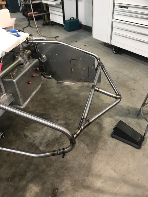

The SL-C’s aluminum semi-monocoque chassis is a work of art, but in comparison the nose support structure is a bit of an after thought. It works, but it allows the nose to move around more than one would want and it would absorb very little energy before an front impact reached the monocoque. While I’m not capable of designing and building an engineered crumple zone, I’m going to build a tube structure which will absorb some energy before the stout monocoque is reached. I have the following objectives:
  • Stiffen the nose and splitter
  • Absorb some energy in a collision without being too stiff
  • Provide a towing/recovery point at the front of the car
  • Provide a solid mounting plate for the nose hinge
  • Isolate the radiator which is wedged between the support verticals which move around
  • Provide additional support for the intercooler’s two heat exchangers mounted on the splitter

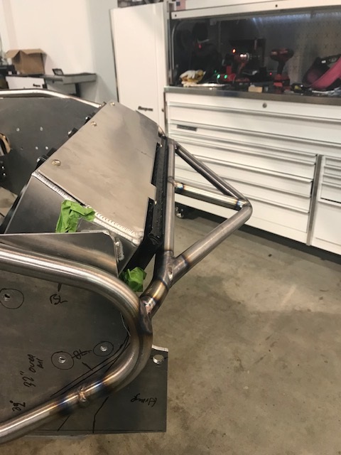

Each side of tube structure will be mounted to the nose box via two 3/16” steel plates, each with four 1/4” bolts. This results in 4x the bolts and slightly more than 4x the vertical separation between the top and bottom mounting points vs. the stock solution. The top plates ties into the 1/2” upper-control-arm bolts and the lower plate wraps around the corner of the chassis. To create the bend in the lower plate, we clamped the plate and a steel rod which matched the radius on the corner of the monocoque in a vice. We didn’t have an acetylene torch, so we heated the metal with a propane torch. This took a while and the metal never got red. We bent the metal about 30 degrees and noticed that the bend was occurring above the steel rod (i.e., higher than desired). We opened the vice, dropped the hot rod on the floor and re-positioned the bend where it should have been with respect to the steel rod and bent it to ninety degrees… basically a game of hot potato with profanity. The result was a near perfect bend.
The first picture shows the top plate and a modified version of the vertical support mounted on top of the bottom plate. We cut 3/16” off the back of the vertical support to account for the thickness of the lower plate and welded it back together. This allowed us to use the vertical support as a surface on which to mock the tube structure. The stock solution is just the two 1/4” bolts spread 2” apart on the lower plate.
Upper plate & modified stock vertical support
Top plate ties into upper control arm
Heating & bending the lower plate
Lower plate wraps around monocoque radius
The frame will be made from 1” x 0.095” chrome molly tube. I choose 1” tubing for two reasons; I didn’t want the tube structure to absorb too much energy before crushing (I hope) and there is only about 1” between the vertical support and the radius on the monocoque and I wanted the tube to T-bone the chassis on a flat surface. The picture below shows a mockup of the bend angles using pieces of DOM tubing. The side tube will be made in two pieces.
After bending the side tubes we machined slugs out of 1” solid stock. I learned about the importance of drilling a small hole (i.e. 1/16”) so that hot air can escape the tube while welding. In this case I drilled the holes in the mounting plates. I also learned a way to quickly dress up the chrome molly tube. The side tubes are fully welded and tacked to the mounting plates. The tube that crosses in front of the radiator will be 0.095” chrome molly. I now need to decide if I should use 1” or 1-1/4”. I will mount a towing point to the center of the cross bar so strength is important. The 1” tube can be bent and coped into the side supports and it will look at lot better. The only question is, “is it strong enough?”
Slugs made from 1" solid rod
Dressing up the chrome molly
1" cross tube
1-1/4" cross tube

Will the nose fit over those tubes? Mine would not.
Howard, as you guessed the vertical supports won’t clear the tube frame so I cut them (I’ll take some pics when I get a chance). IMO the full height of the vertical supports doesn’t do much. My plan is to panel bond 1” foam to both sides of the remaining stub and then fiberglass a “U” (i.e., both sides and top) onto the nose to create a beam. While that’s a lot of work, it will be stronger than the verticals which are thin and only fiberglassed to the nose on one side. This also allows me to mount the intercooler’s two water-to-air heat exchangers to the tube frame. I didn’t want to mount them to the diffuser because they would get bounced around more and removing the diffuser would become a much bigger project.
I like the idea of it as the nose structure is a little under spec IMO. My take is the inner nose vertical supports will want to sit right on those external side tube structures. You could move them inboard or outboard.
Mesa, I agree. A lot of the chassis and suspension is overkill, which I like, but IMO the nose box is under kill. As I pointed out above, my plan is box the remainng vertical support both inboard and outboard, but I'm not sure it's worth trying to get them to sit on the top tube.
The structure isn't done, but you can figure out where the tow loop will be welded. We’re also going to add a short tube from each side to the bent front bar tomorrow.
