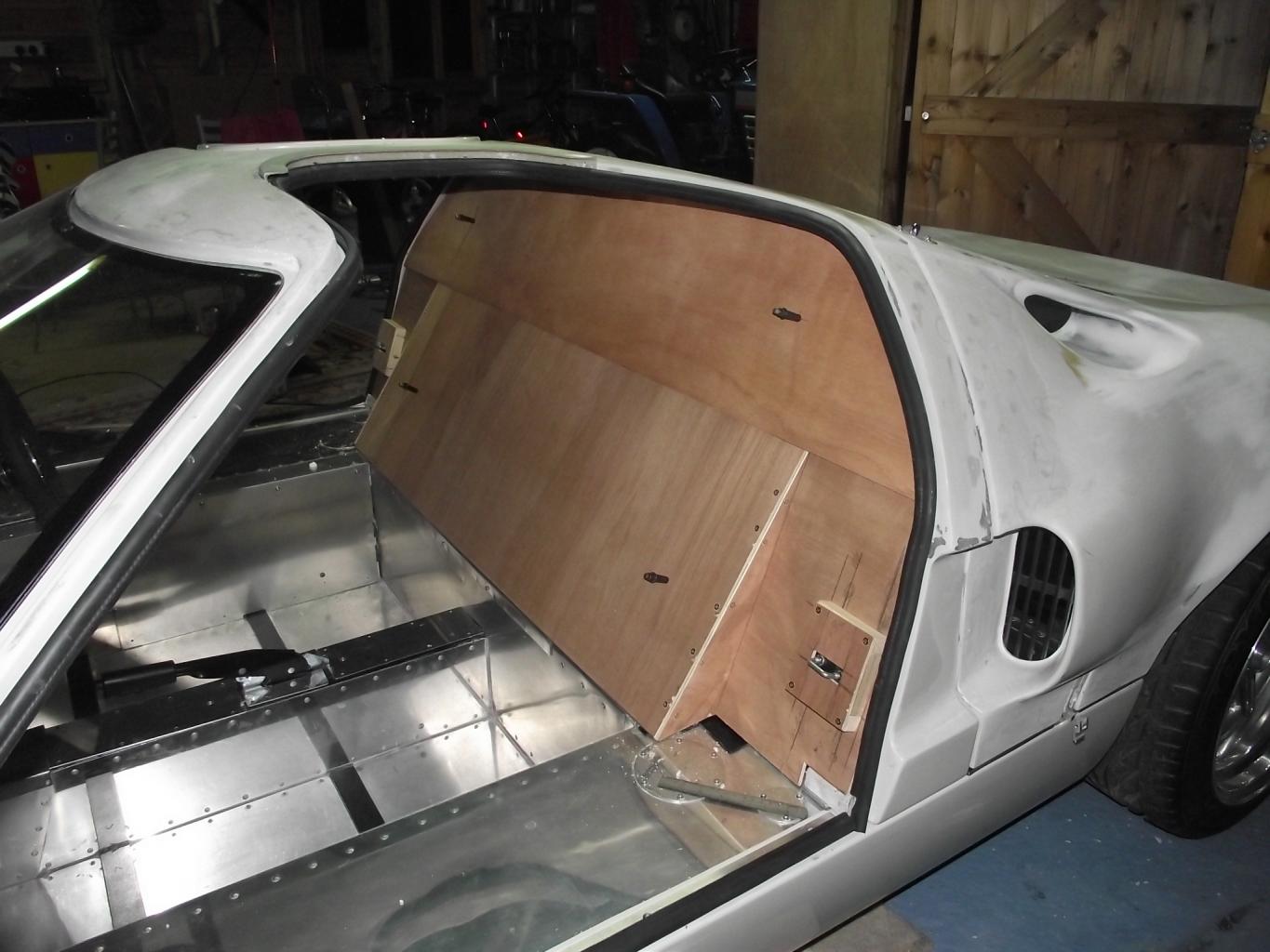

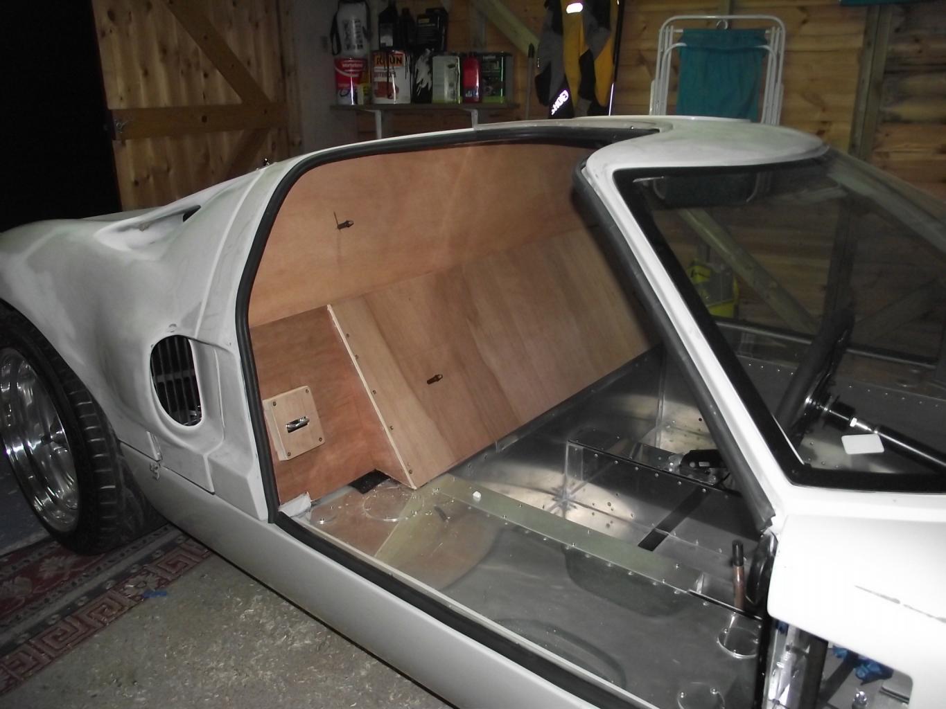

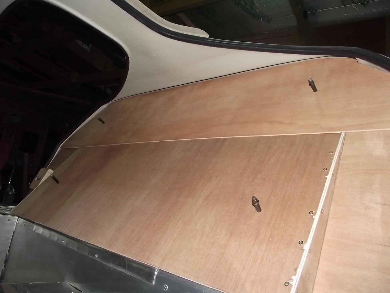

Started on the interior this weekend; made up the rear panelling which I will cover in leather. Need to cut the hole for the window and add the bulge.
Mark
Its 4mm marine ply, very light, gives a firm base for covering with leather and hopefully shouldn't deform over the years. What other material would you suggest ?

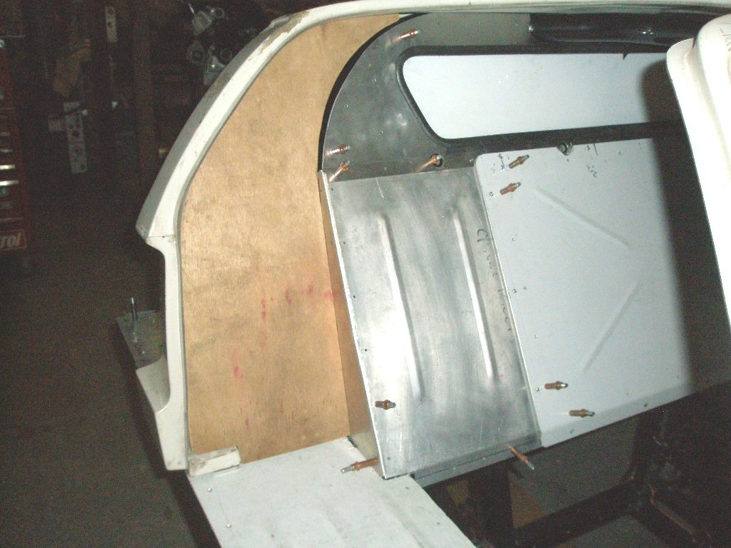

I've also used 4mm marine ply, but mine will be skinned with powder-coated aluminium to match the rest of the cockpit.
Regards
Andy

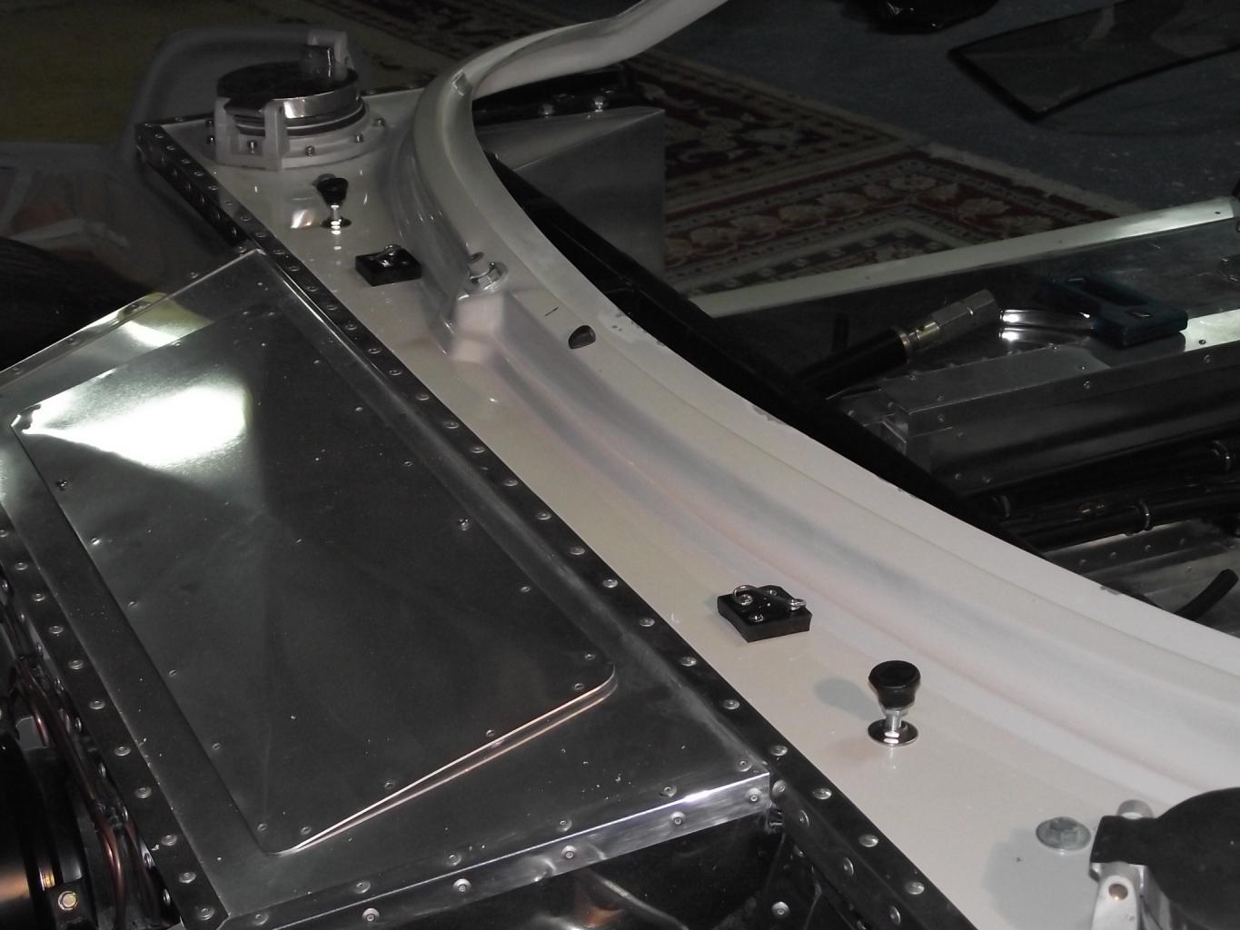

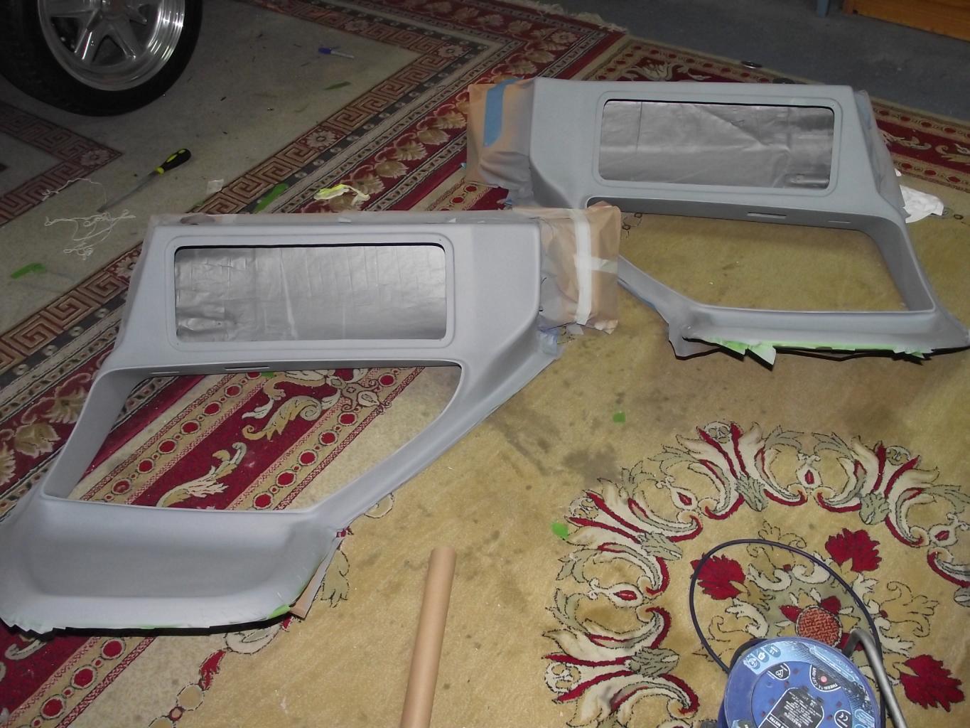

I have now prepared and primed the doors ready for painting. I also fitted vents to the front panels as suggested by a few people earlier. I have also fitted the front clip fasteners and made up some fixing clips for the front apron.

No its single glazed only. Maybe as part of a future upgrade I'll change it out as I have sound insulated the doors, sides and footwells, plus padding in the rear marine ply framework so the glass panel may be the weak link in the sound deadening.
