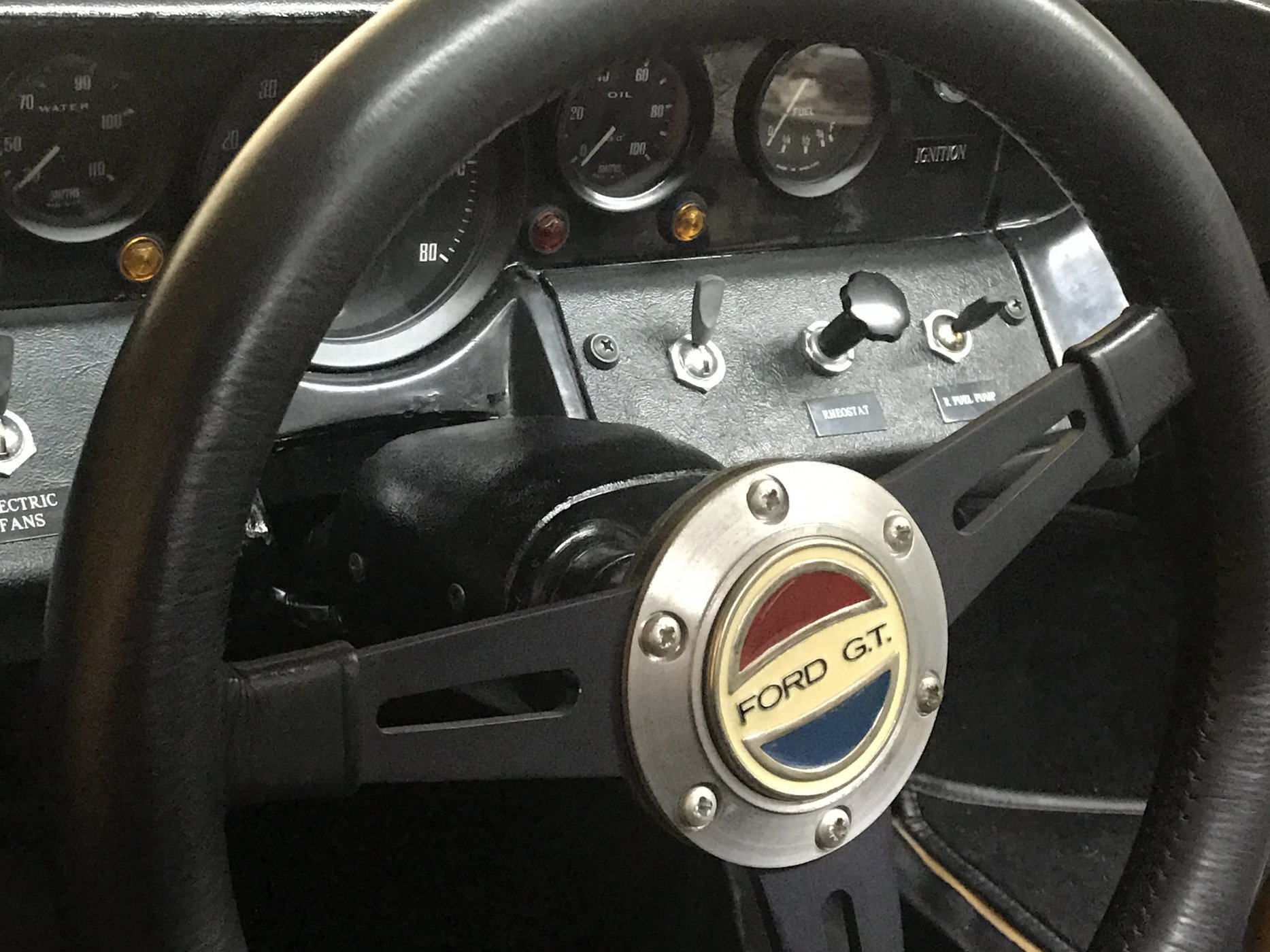

as it should be, the car is a rock star. I will simply be the curator and pilot. The story of how she got to me is one of those that I could not Imagine ever happening in real life, but she is mine. That said, before i purchased her a significant amount of research was done, here being a major source. Bits, pieces, knowledge were the concern and I think all the above is available and here. I chatted with Olthoff also. I figured most sanctioning bodies here in the US were not a problem. I have owned and raced many GT350 Shelby cars and have always been of the mindset they were to be raced period correct. Not interested in a modern/historical car. This car will be period correct as much as possible, safety requirements the most significant changes. Have all ready found out the rear upper clevis has to be changed to modern one/with an angle due to tire rub at speed. Any idea where to grab one without paying a mint? Folks have them, but to suggest I did not want to buy a second car seems to insult them....
