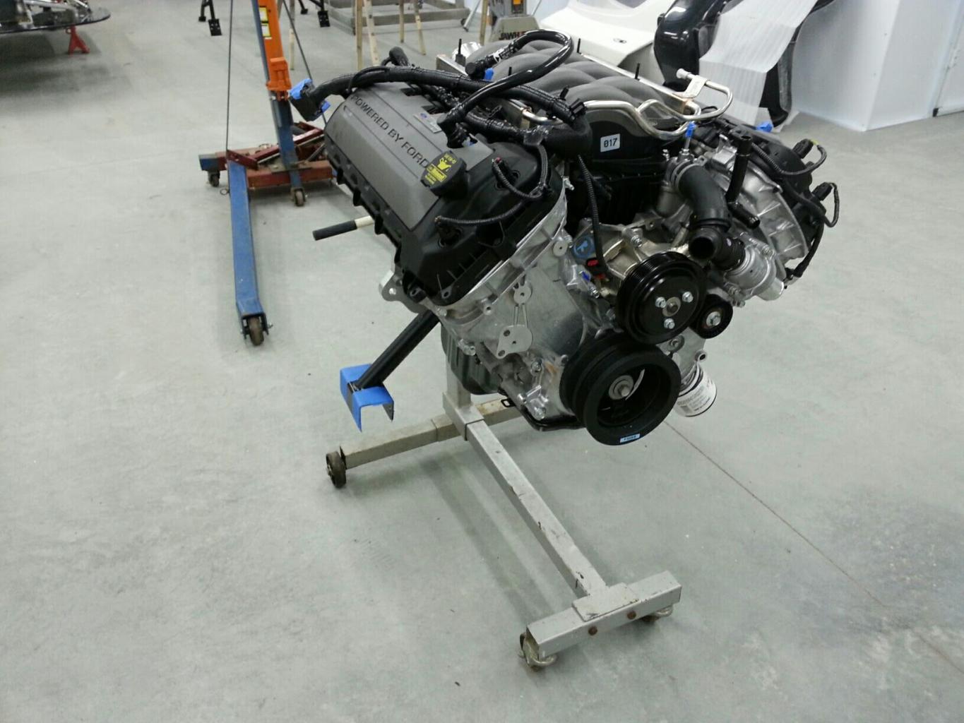

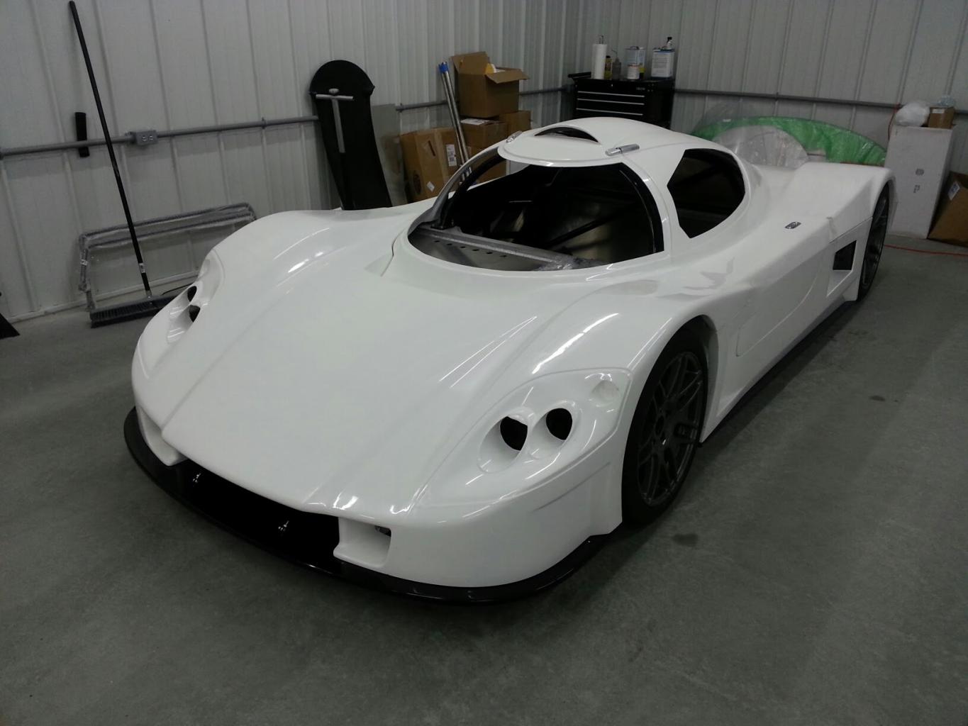

My coyote-based beast is coming along...
attachment.php
attachment.php
Allan is doing his thing now. :)

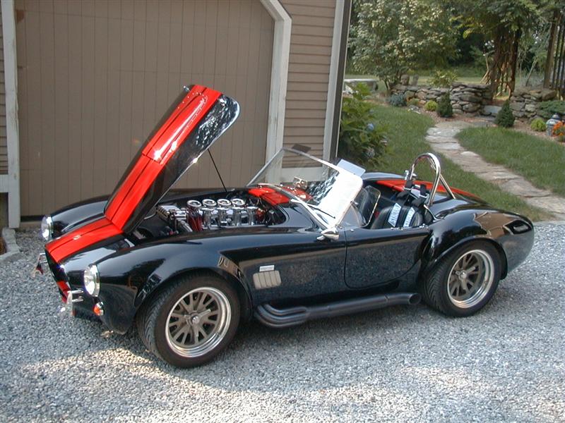

Had some TWMs on my Kirkham.
