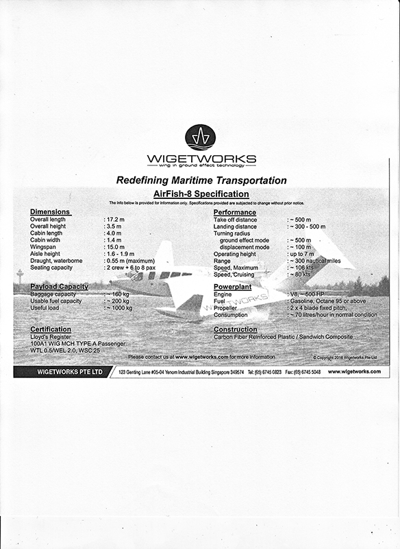

I located some specs. on the AirFish8.
It appears to say that it can cruise at a height of 7mm, 21'.
Would that altitude still be considered as riding the ground effect ?

Yep - with the wingspan of 15m, I would expect that 7m would be a safe altitude while remaining in ground effect..
