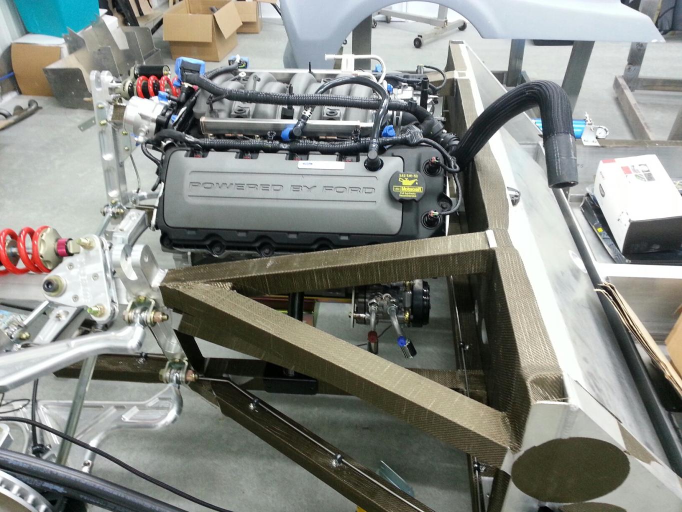

Going for Coyote Aluminator with a Canton shallow pan and an accusump.
attachment.php
