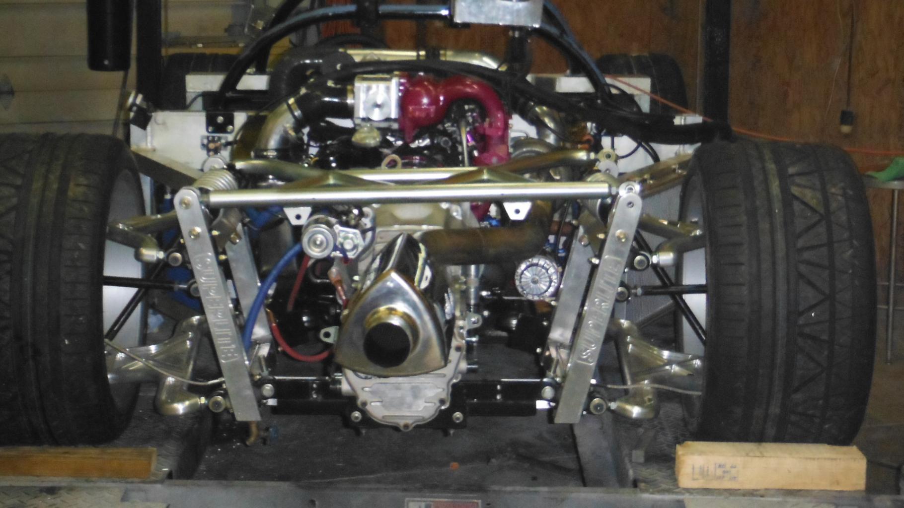

I have a 20 B rotary in mine, not that it is smaller, but it is lighter and more HP then your stock LS motor. I just like being different and since in the 70's and 80's I drag raced them makes it more familiar with them.
Yes you will spend 20 K by the time its all said and done.
Mine is 600 HP at the rear wheel , on pump gas, 18 psi boost, with fuel can go up to 900, but I plan on driving the car, so 600 is fine.

I've seen that engine in person. Beautiful.
Not too much bigger than an LS engine as one of these engines is designed to replace 2 blown big-blocks and fit in the same location for offshore boats.
