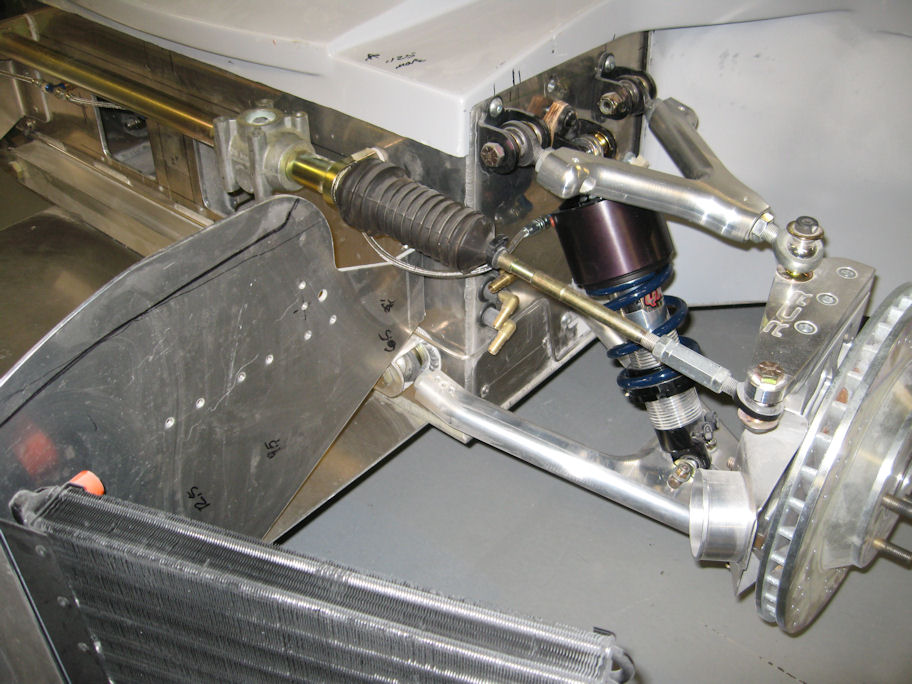

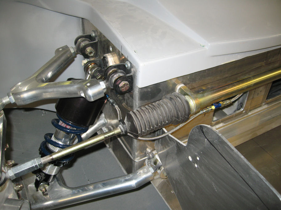

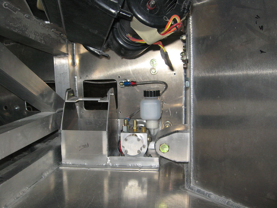

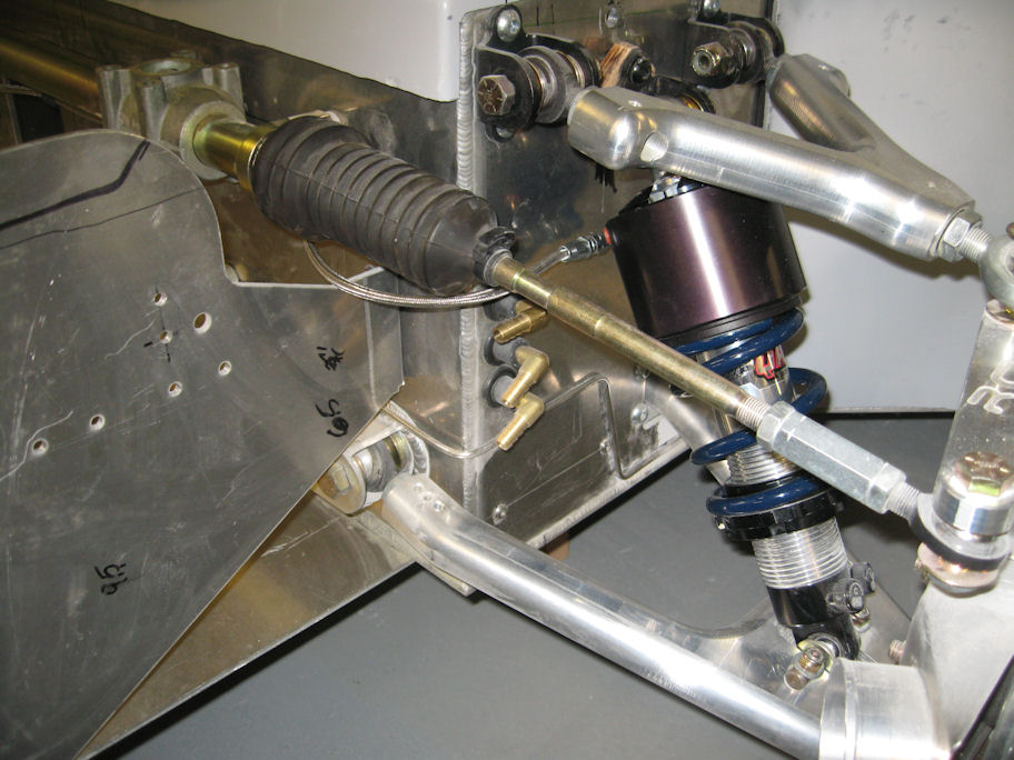

Some 'right side up' front end lift pictures. It took only minor mods to pull this off, I like the fact the pads and lines don't move on this configuration. Also a shot of the quick disconnect battery combination hydraulic lift pump box (beginning fitment work). I will need to raise the pump fluid tank a bit, but I needed the whole thing in place to judge how much room I had/not. The pump line passing through the footbox features a dry-break quick disconnect.

The reality is that the assembly is near center balanced. So either way it is a tossup in the sprung weight equation. But this way the lift pad cylinder is stationary and therefore so are the fluid lines.

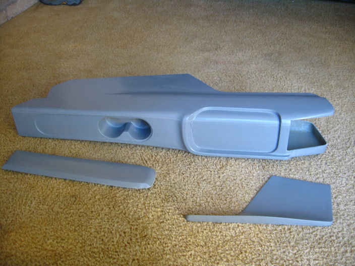

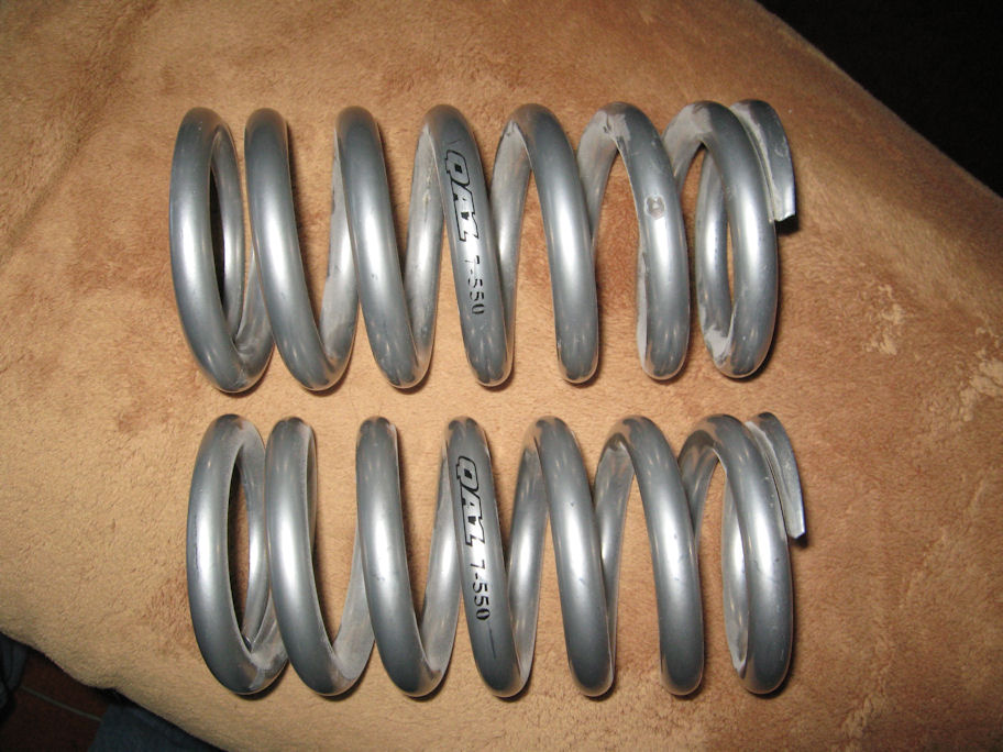

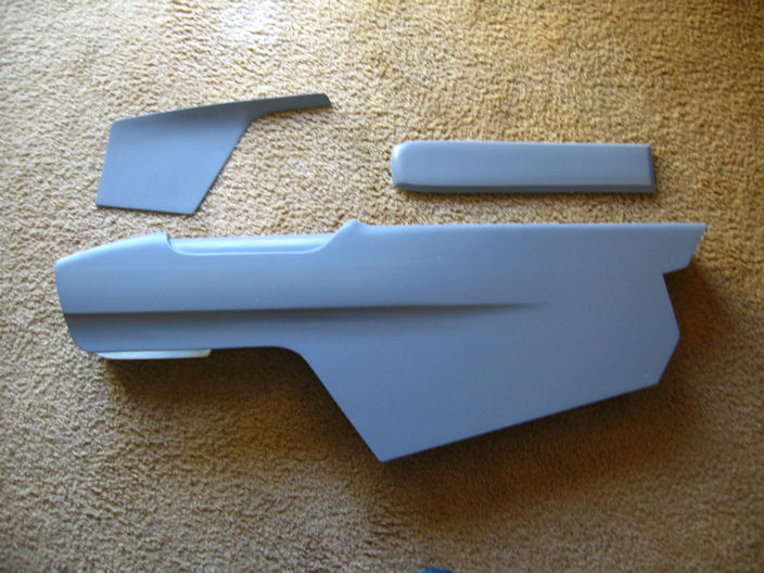

Stuff for sale:
Complete RCR SLC center console - $250
Two QA1 7-550 springs - $80 (seven inch tall, 550 pound)
Plus shipping
