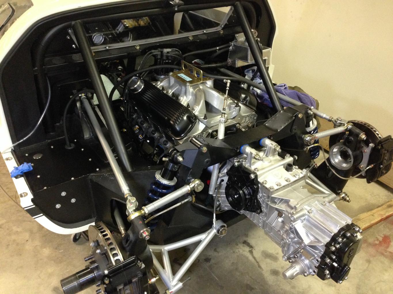

Finished assembly tonight. Pedal box stripped, new throttle pedal pivot fabricated with sealed bearings, powder coated, and Tilton master cylinders added. Needed to cut down pushrods and add spacer in top bolts so they would not contact reservoir ports. Clutch and transaxle later this week. Just a couple weeks away from final assembly.

The gentleman who is building the exhaust is a couple weeks out so hopefully mid July I can have it on the road.
No paint. Black bits are powder coated. Everything else is raw or burnished. Burnishing closes pores but still looks natural.
Back on the ground. Will load into trailer this week and take to Luftkraft for handbuilt exhaust. I'm always surprised when I put it back on the ground after having it elevated for some time, just how low to the ground these cars are. I am in awe of you guys that build these cars from scratch. I started with a completed car and tore it completely apart and wondered several times if I would ever see it in one piece again. Should see some driving time within a few weeks now.

Will he make an effort to get the runners equal length? Not having equal length runners is evidently what is killing some power on my engine simulation.

Are you talking intake? No changes are planned at this time. Made 450 which is more than I need.

No, I was talking about the exhaust runners or headers. You said someone was going to make new headers for you. You also have said that you were hunting for that unique GT40 sound. I think header lengths are a key to that.
