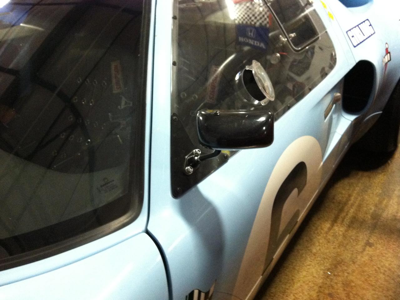

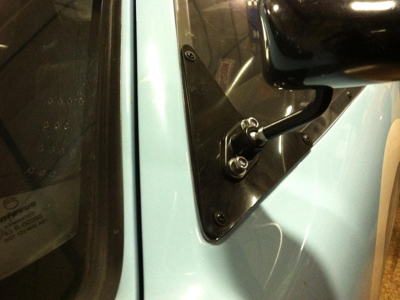

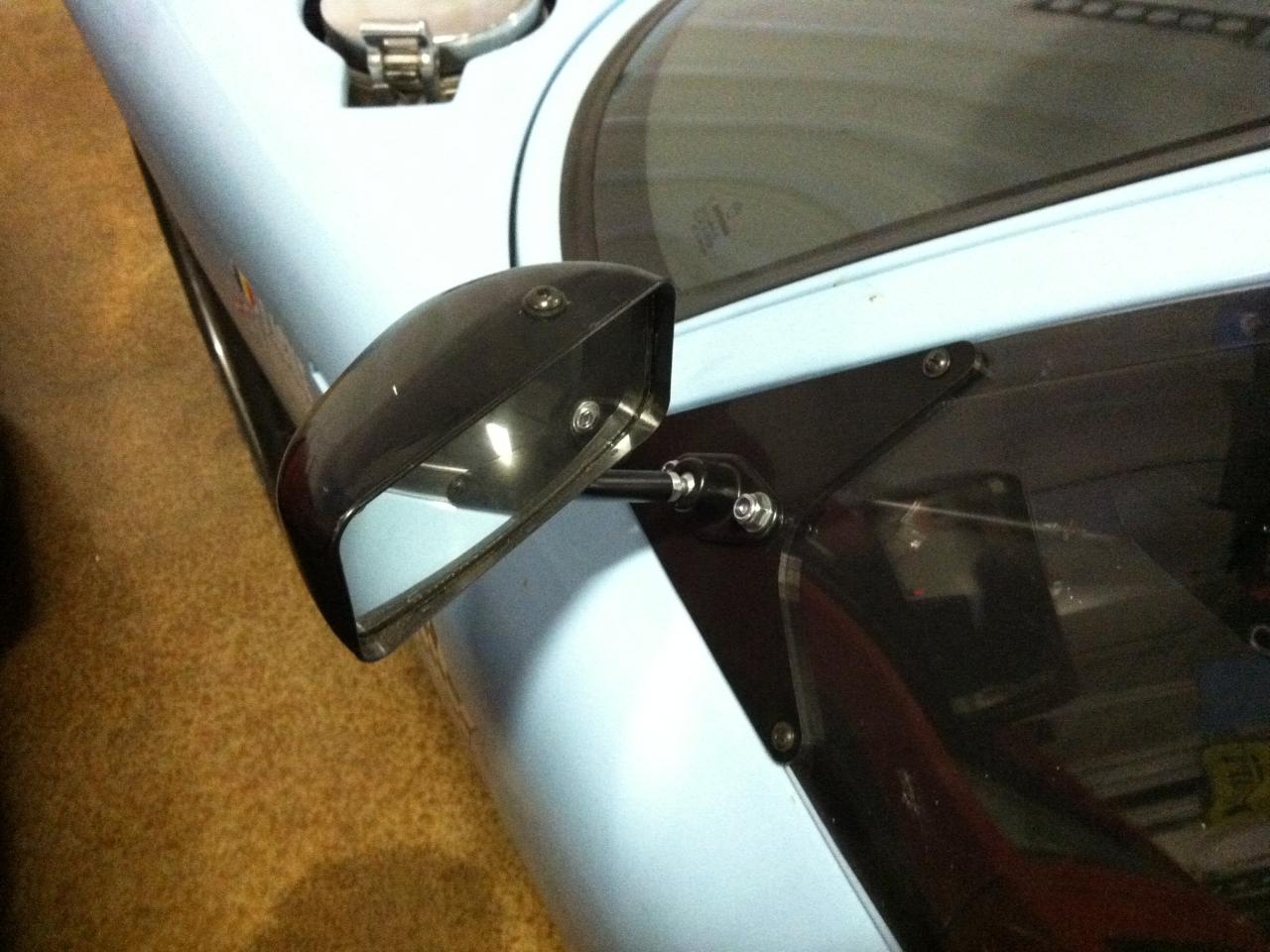

Here are the side mirrors mounted with the brackets/mounts I laser cut. I use the Convex mirrors purchased from Pegasus Racing...about $150 set.
Brian

I have used those mirrors before and they are quite light and also come in either flat or convex (recommend the later)...
One thing you may want to do Brian - there is a set screw that uses a hex key from the inside to lock the mast in place. The screw is steel and the bracket is aluminum. I had one corrode due to dissimilar metals and water from washing and rain. Pull that screw and give it a couple of twists of teflon thread tape. Since I did that I no longer had the problem.
Brian,
Slick installation. Wish I had seen that before I did my mirrors. Had those exact same mirrors on my Formula Atlantic years back and they work well.

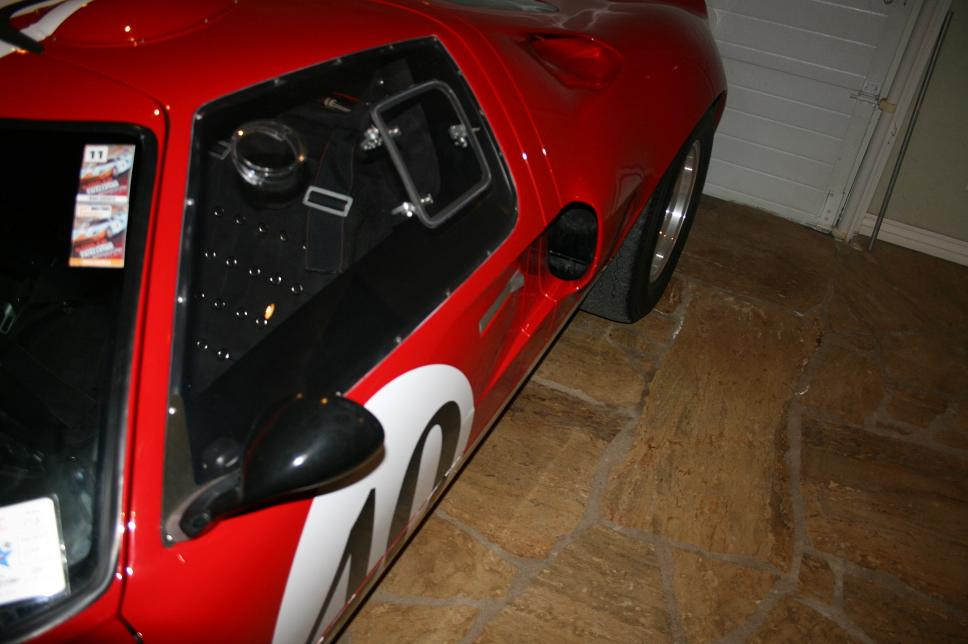

The helicopter vents are wonderful and you can turn one forward and the other backward and they vent the cabin well, I unfortunately put them high where the air from the radiator passes by the window and the air is hot, I wish I would have put them where Brian did.

Dennis installed mine and mounted them down low. I never gave it much thought but I'm glad he did :)
They do work great for adding circulation in the cab.

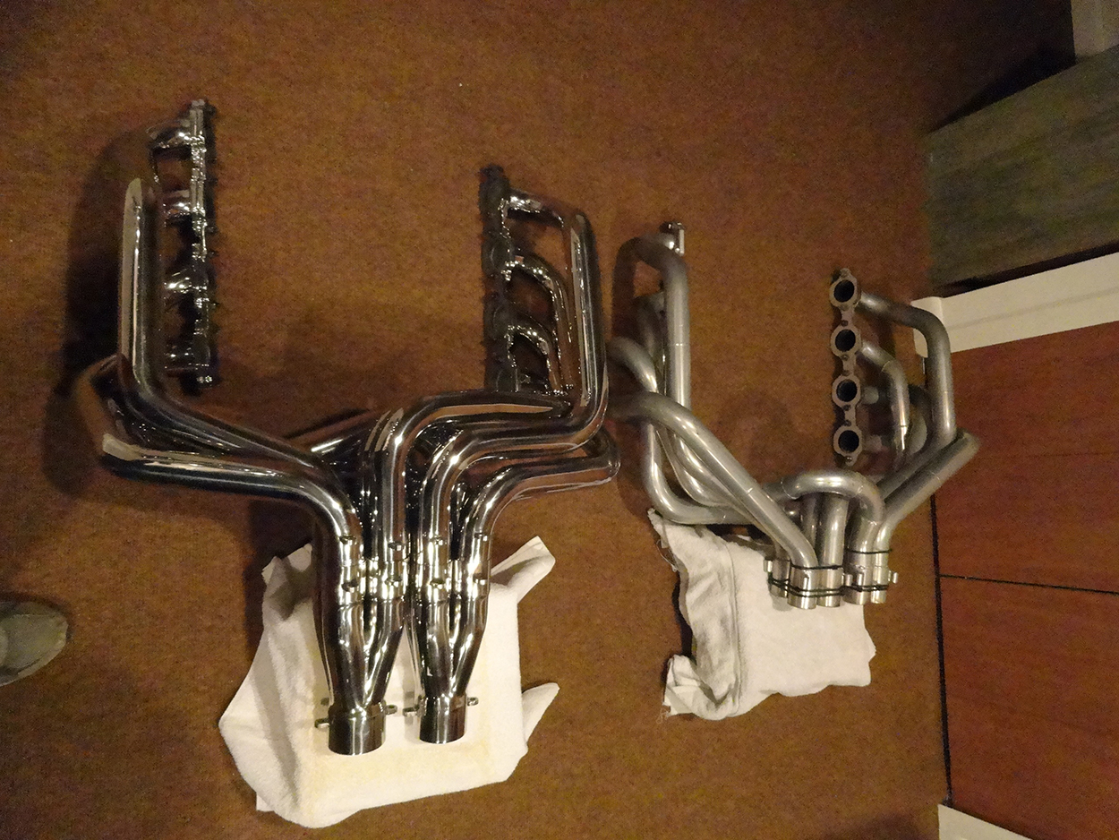

My main purpose in visiting today was to post a couple of photos of both the upgrade headers and the SPF headers. You may remember that in a recent post I mentioned our disappointment that the upgrade headers were not fitting properly and I had to return them. The fabricator is working on attempting to solve the fitment problem, so that outcome is unknown at present. But, feast your eyes on these slightly larger and striking bundle of snakes.

Who are you having build the upgraded headers?
Mike, that's a decent question, and I haven't forgotten the previous question you posed inquiring how much it cost to polish the RBT trans. First the trans.
My answer would be misleading without ample information. It ended up being $3,200, but I would guess that 50 to 60% of that expense was relegated to picking the trans back up from the shop, draining the oil, disassembling, sending to polisher, and performing all of that work in reverse order. My fault since I was unaware that such could be accomplished, and that I would desire it, so I paid the penalty for my ignorance, as many of us may do from time to time . . .
As to the headers, at this juncture it would be prudent for me to leave that name private. The company sent me a full refund for the product and freight, so thus far they are acting in good faith.
However, a mystery of sorts is in the process of being solved. Basically, the fabricator tends to believe that all was well with fitment, and even though we sent numerous eMail photos indicating there was a problem Houston, the fabricator remains uncertain.
The fabricator is concerned and recently purchased a non operational 351W engine, and is in the process of setting it up as a permanent future template or jig rig, so to speak. Once that process is completed and headers bolted on, the answer MAY become known.
In addition to this state of confusion, I don't know if this vendor is an advertiser here on the forum, so I may ultimately have to send you a PM to avoid issues.
This is my way of letting you know that I'm not playing games, or being intentionally elusive or secretive.
Cheers, Robert
Great observation on the in/out setup accelerating ventilation, and thanks for the advanced notice of proper vent positioning, and the problem that may arise otherwise!

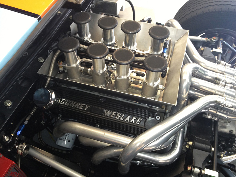

First of all, welcome to the SPF GulfClub! I have a few additional suggestions. Ingleses makes a velocity stack sock that has zero resistance on the dyno. They work great and look great. See photo. Also painting the door roof guides is another nice touch. Lastly, is a photo of my driving lights and blinker combo.

Randy, Thank you. I enjoyed seeing the picts you sent. I spoke to Jim 6 or 8 months ago when I originally contemplated Webers, and I especially liked his sidedraft set-up! He's a decent guy. I'll check in on the velocity stacks with screens. I did very much like the creative upgrades you used such as the driving lights with turn flasher. I liked the position/angle of the conards too.

Robert, the second set of exhaust pipes are really top-rate. I mean the polished set that look like they were sand-bent, not cut and welded. Who made those for you, and if you can't post it, would you PM me with that information?
Robert S.
PM Sent
