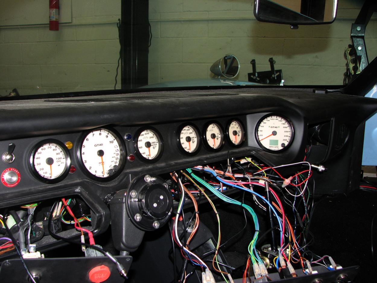

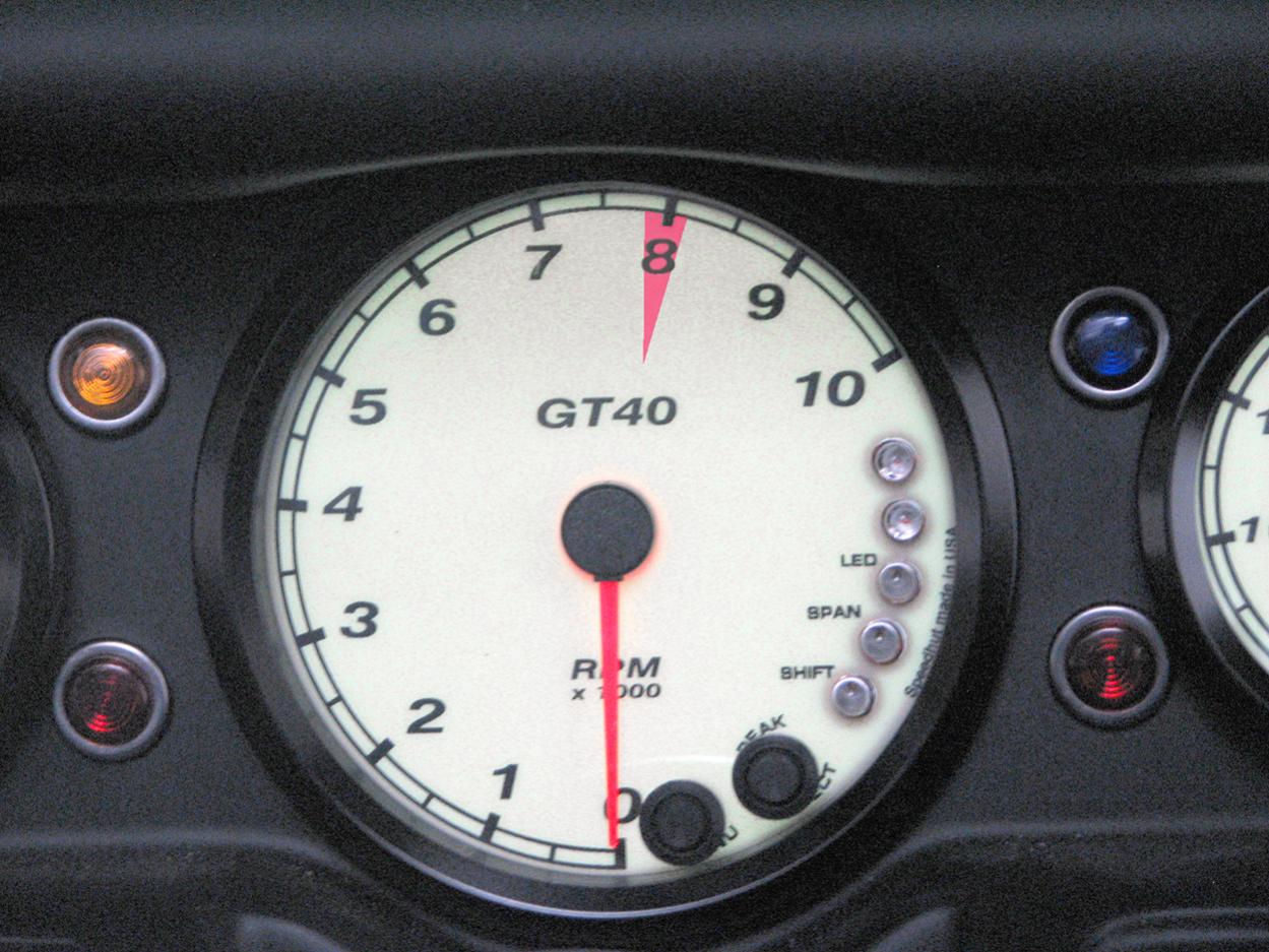

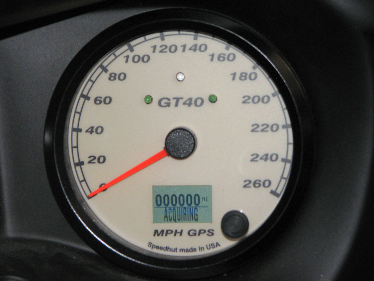

Gauges, Mirrors and Canards
Robert,
Very nice gauges. I wish the GPS and Tach units were available back when I got mine. Would have solved a lot of headaches and extra equipment. Bill
Hey Bill, thanks. Remember, it was seeing the photos you posted of your gauges on an old post that definitely inspired me. Well, that in addition to realizing the uselessness of the original gauges.
I'm seldom impressed with products, but this line of gauges, and the personal way they conduct business was like being back in the 60s - and for those who may not know, that's a big compliment.
Besides the GPS, just beneath the speedo is a screen operated by miniature computer inside the gauge. It displays instant and average gas mileage, and other useful info just like the real cars do . . . :laugh2:
It was great to rid the car of the two mechanical gauges (Oil and water temp) and use the electric sensors in their place. Each of those gauges feature very easily programmable warning lights for BOTH low and high conditions. Obviously the gas level only sports the low warning. The kit included a nice and useable small dimmer switch too. The speedo also sports a tiny high beam light, and two small turn signal indicators, but for now, I’ll use the factory ones. As you know, the original five gauges were 2 1/16” inches, these are 2 5/8” but fit existing cutouts with trick adapter provided with the set. Can you tell? I just can’t say enough about them.
I also took time to install four additional led dash lights beneath the three exterior light toggles, but they were not viewable in the photo because of dash angle.

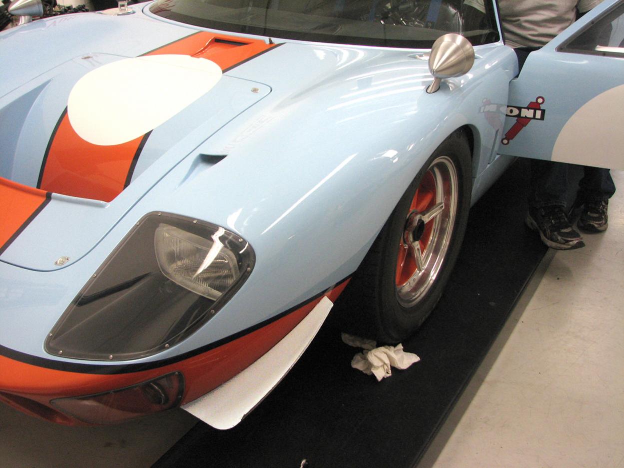

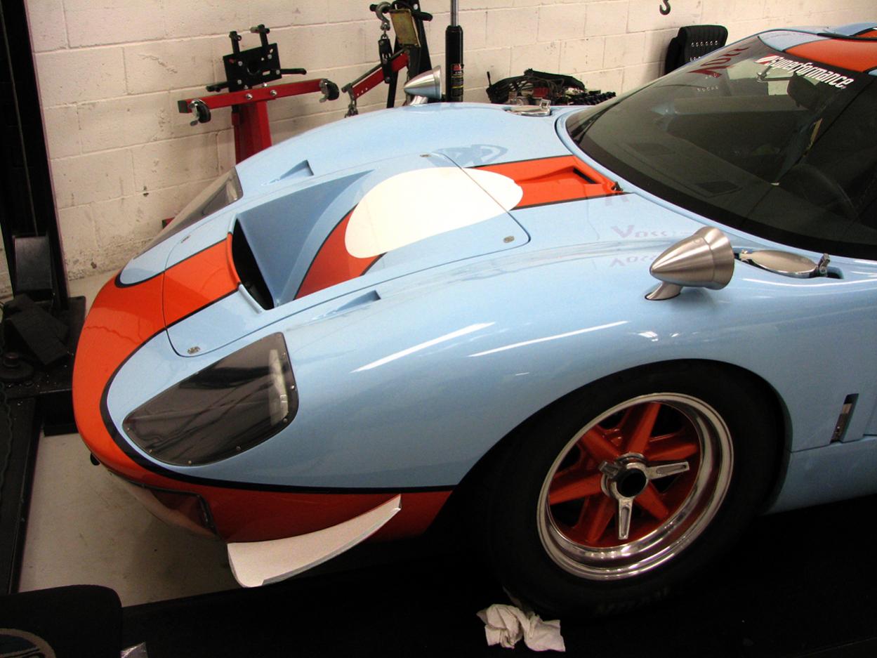

260 on the speedo...go get em Robert! Your car continues to impress. Can you photo how the canards are attached to your car please. I assume the canards came from Dennis. BTW I like em a lot.
Robert S.
260 mpg speedo
Thanks Jimmy. I know that some may consider the 260 mph an ego type circumstance, or perhaps otherwise. However, in the early days after I made the roller purchase, I thought I wanted a six speed ZF. Once I found the very handy web link to a special calculator page with graphs, I learned there was truly no room for, within the range of gears, nor actual need for a six speed, and I was thankful I used that page. In addition, the page tells you from the simple info you enter about your car: redline, tire diameter, and rear end ratio, it will immediately tell you not only your top speed capability (My top speed calculated 236 MPH), but it will tell you what RPM you will be shifting at through all your gears, and that info was used to design my solid roller cam. Anyway, they offered 200, 220 and 260. So, that's the story on that.
As far as the canard goes, you are correct about Dennis. I did work on it for several hours for several reasons once I received it and before installing it. I pondered the color, since I already have the touch-up paint for my ride, but for now decided to brush the aluminum, and clear coat it.
The canards attach at three points: near front, middle, and near to rear. I believe it was either 6 mm or 8 mm stainless steel screws, with nuts and washers that were provided with.
It is easier to install once you take both front wheels off, remove access panels that lead to the inside of the box surrounding the headlights and other lights. However, we were able to turn the wheels out on the waist high lift point, and reach the panel and remove the fasteners thereby, without removal of wheels.
Soon, I will remember to photograph beneath the spoiler for you, and that will likely be when we install the totally bitchen/awesome brace I have for the canards that did not come from Dennis.
