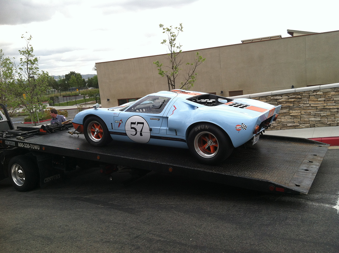

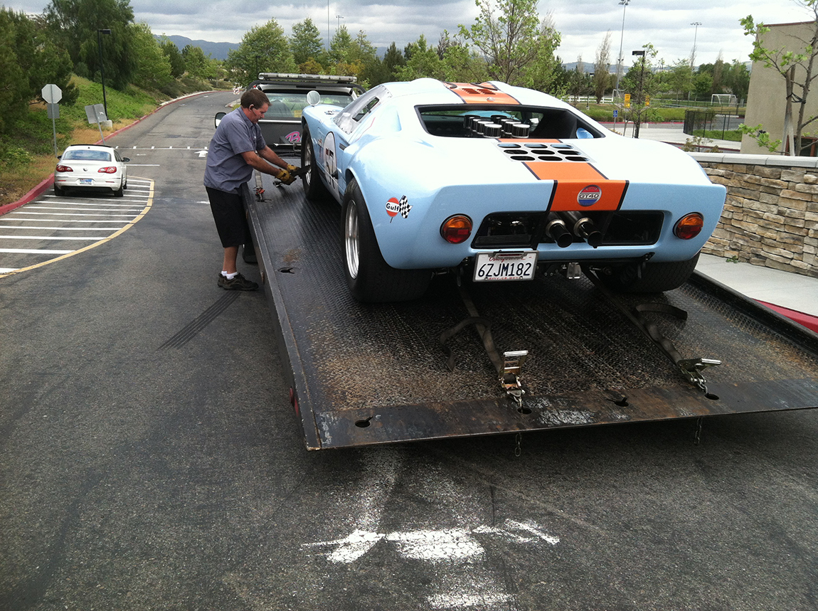

This post concerns two issues: Possible Engine Failure and Photos that depict the HIGH stance of the car when the four wheel lift system is in the UP position.
Engine Failure
The engine made a chain grinding type noise, followed by a quick exhaust backfire, and then would not start. Hope it was not detonation, but likely is not since it happened at low speed. Standby for diagnoses.
High Body Stance
Due to recent interest in four-wheel hydraulic lift system on my GT40, the following photos will show the HIGH position. The lower ride position was depicted in the photos within this thread, page 14, post#266.

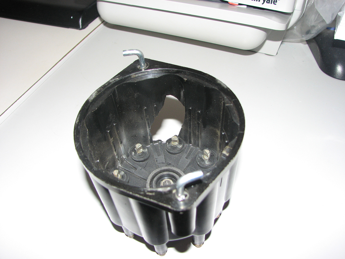

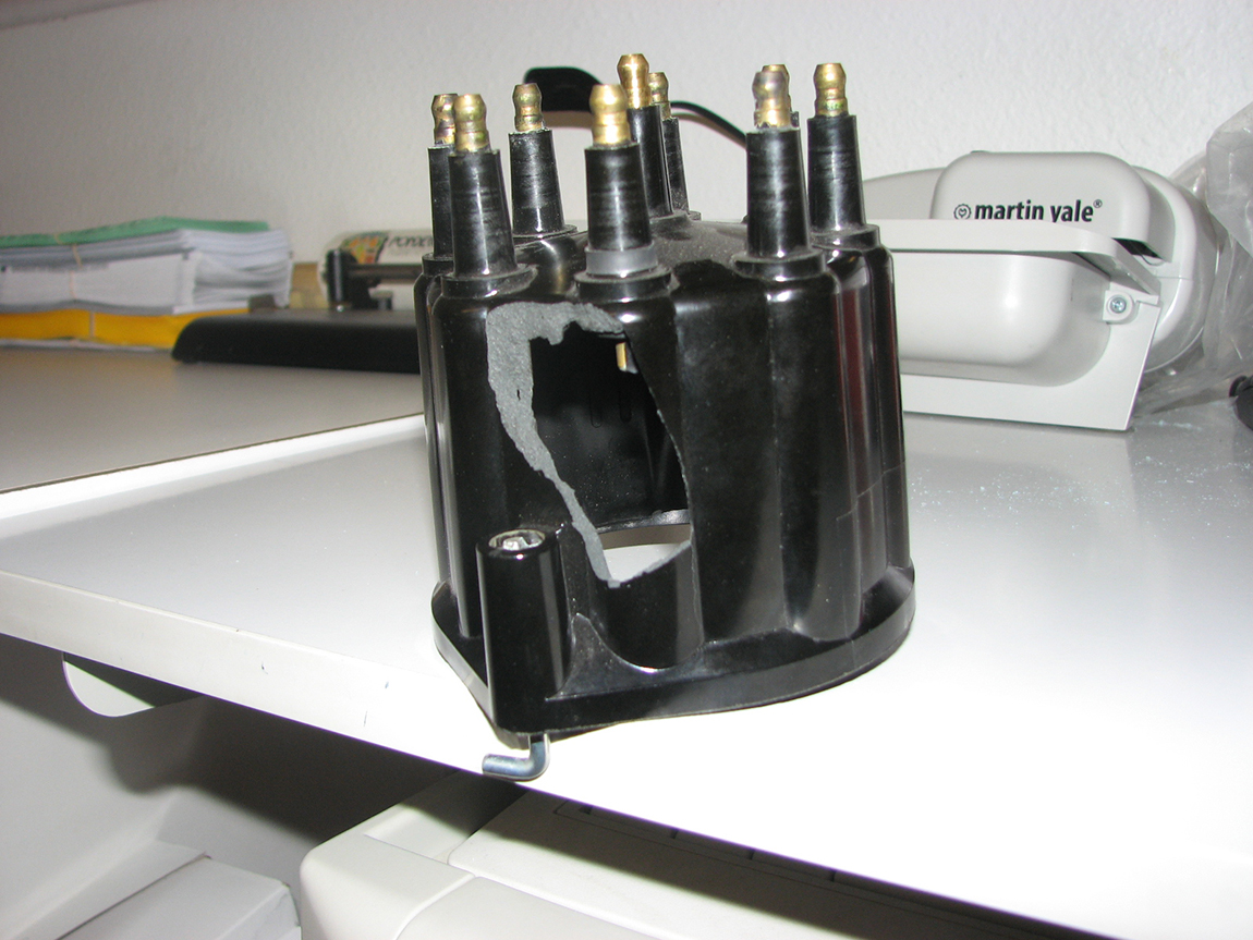

We used the FAST 2.0 ECU, and the FAST dual sync distributor to control the 8-stack FI system on my GT40. The FAST distributor employs the G.M. type of rotor cap that uses two small screws to fasten the rotor to the top of the distributor. Neither of the two screws were installed with any lock-tight, or other type of screw retention device. One screw came completely out from its location as the engine was running, and began to bounce around inside of the top portion of the distributor cap. During its travels it chipped the tops of most of the eight spark connectors at the top of the cap, scored the inside of the cap and top surface of the rotor, and was eventually ejected like a bullet out through the thick body of the side of the distributor cap. This damage was initially hidden from view because it was located exactly at the back side of the distributor right up near to the glass bulkhead window. SEE photos below.
It is currently not known if any other components were damaged.
Robert
Does the distributor shaft turn evenly as the engine is being cranked over?
On the older GM rotors, I used only star washers for screw retention although they typically came with a split lockwasher.
If the distributor still turns with the engine, you should be building oil pressure with a mechanical gauge. Some electric gauges don't show a reading while the engine is being cranked.
Maybe l your damage is limited to the cap and rotor.. I believe MSD makes an HEI tower cap in the smaller diameter that you need.

Maybe your damage is limited to the cap and rotor.
It now appears we were not that lucky.
Upon start-up, the engine idle speed was merely 500 rpm, and the engine struggled at that speed. The normal, and programmed idle speed was 930 rpm, and the engine galloped between 930 and 1,150 due to cam. Now there was misfiring and ruff engine between 2,000 and 2,400 rpm, along with slow throttle response. In addition, the spark plug wiring is properly connected.
Above 3,000 RPM, the engine was happier. However, the distributor was not moved, and the ECU programming was not changed, thus we've concluded that the distributor module below the rotor was likely damaged by the incident either from the sudden partial stopping or reduced speed of the distributor which snapped both the round and square pins, or perhaps by some high voltage, or both. We have ordered a completely new dual sync distributor with brass cam gear. Once installed, it will either eliminate the engine symptoms and correct the idle and timing, or it will not. If it changes nothing, we will be able to eliminate it and move on to the next component. We may receive the new parts on Tuesday or Wednesday.
Thanks, Robert
I suppose it could be possible that the hall effect trigger wheel got tweaked when the rotor jammed up in the cap and probably shot bits down into it..
Either way, your engine runs and most likely has good oil pressure or you surely would have reported that. A few hundred dollars is a lot smaller than a few thousand, but still the teething pains of a new car can be wearing on you...

View attachment 64638 View attachment 64639
I took nearly the same picture as you did right after I took ownership. Teething pains...
Good luck!

Those Embarrassing Photo Moments
I took nearly the same picture as you did right after I took ownership. Teething pains... Good luck!
Kevin, you too, huh.
I have to force myself not to become angry with the negligence, stupidity, lazziness, and poor quality of work that many companies and individuals are almost proud to put on display. Not using lock-washers, or equivalent for a fast spinning primary component on a vibrating gasoline race engine fits all of the above in my simple mind. I just keep focussing on how fortunate we all are to have a GT40, I count my blessings, and it often keeps me from doing and saying things I may regret . . . :laugh:
Thanks for sharing that tidbit of kindred GT40 spirit. Robert
