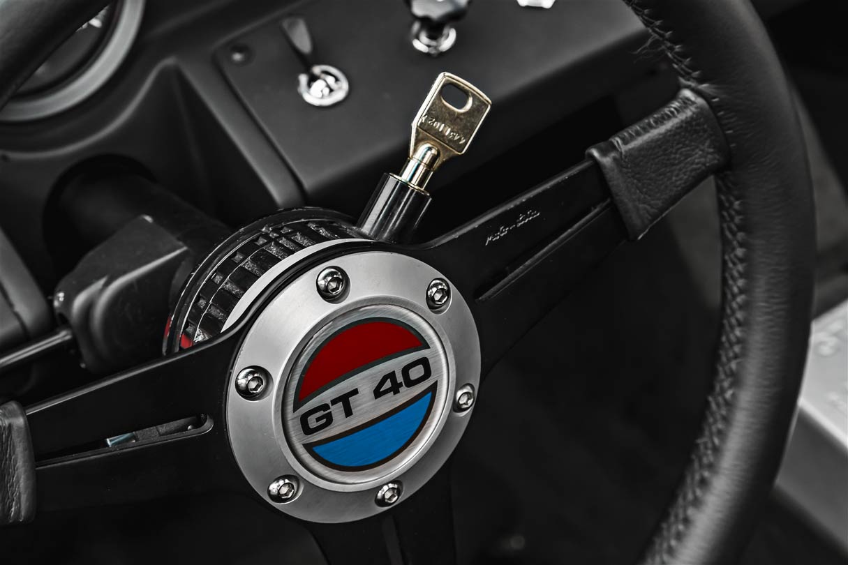

I like this one. Dull raw alum looking center pc.
That is the Superformance wheel/hub. We use "GT40" as it is licensed to SPF, the repro centers we sell are "Ford G.T." as the FAV cars were. SPF cannot supply the "Ford" center without licensing it, the manufacturer that we get the "Ford G.T." centers from have licensed it, this is separate from Superformance.

Will that wheel pictured fit my CAV, and do you have them and that exact center pc?
No, the Moto-Lita wheel will require modification of the boss on a CAV shaft. The PCD is different. We can supply them as shown, but as was suggested, a "quick-release" hub will allow you to install whatever wheel you want.
