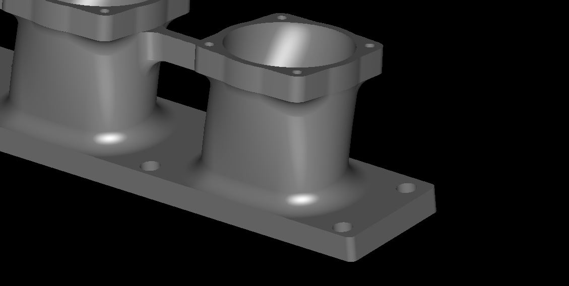

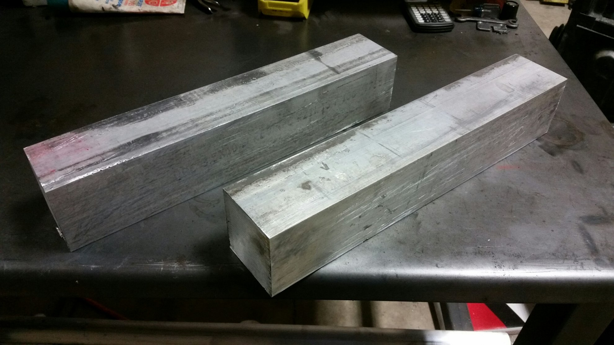

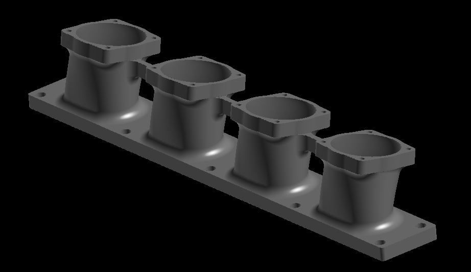

The final version of the new intake manifold was drafted in AutoCAD and will become reality as soon the billet material was delivered.

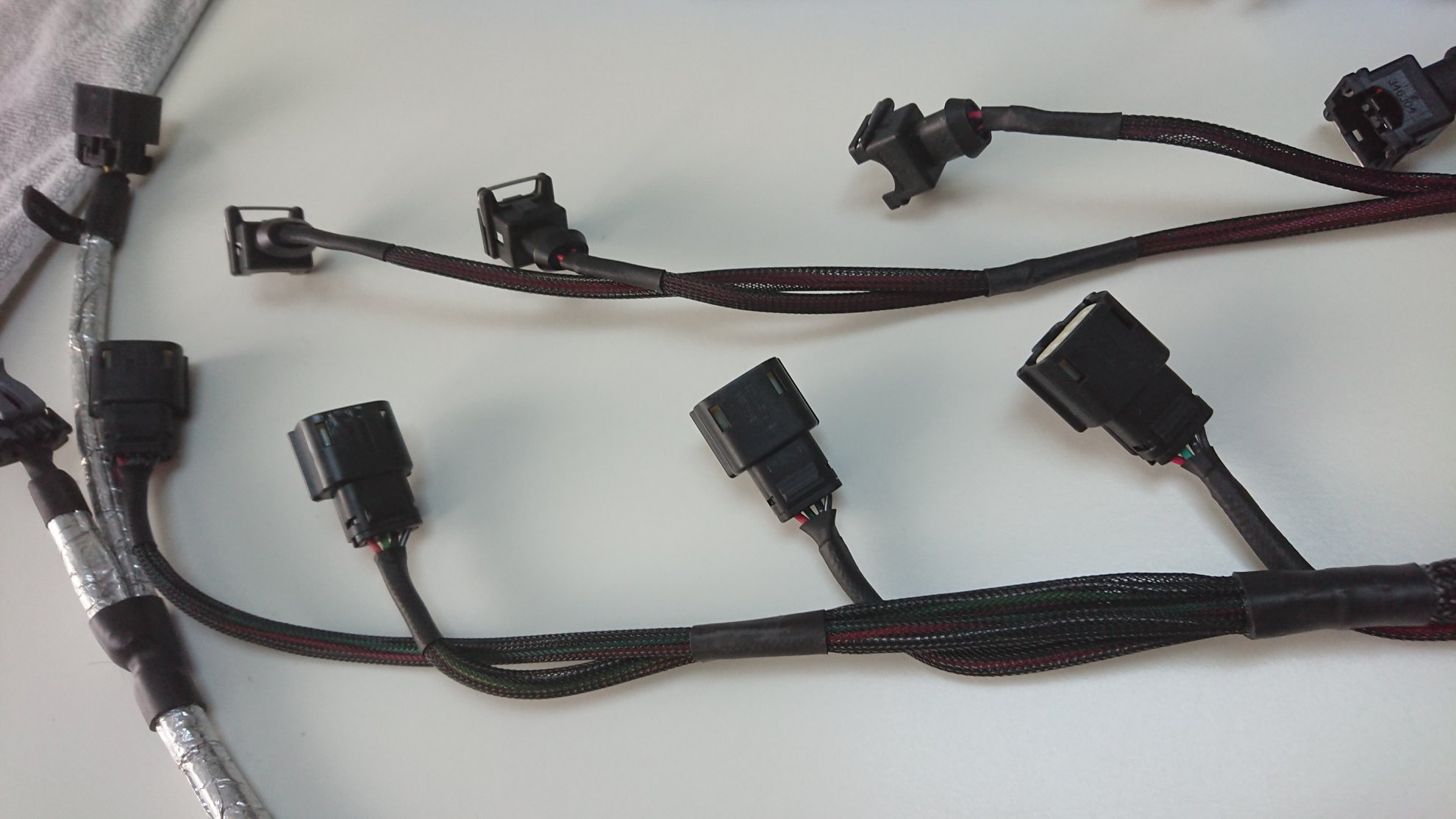

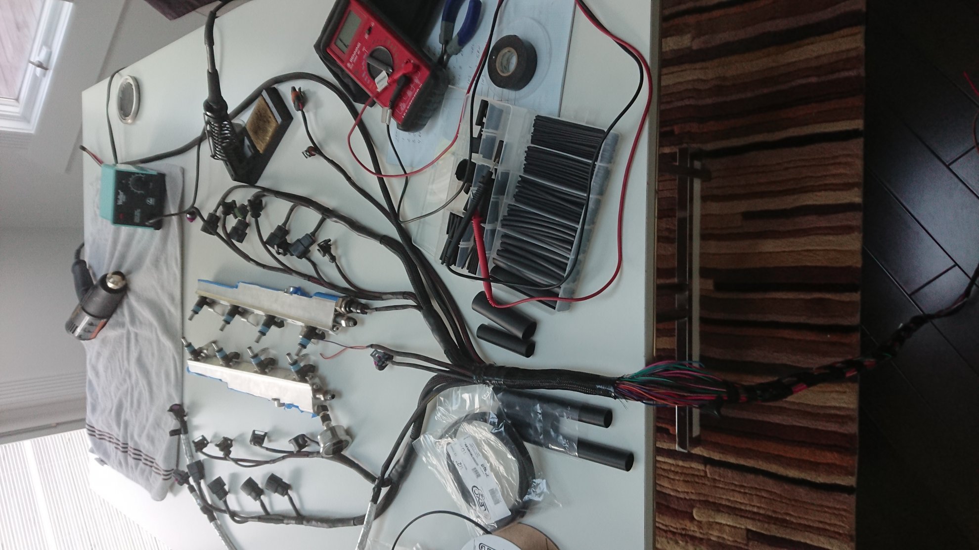

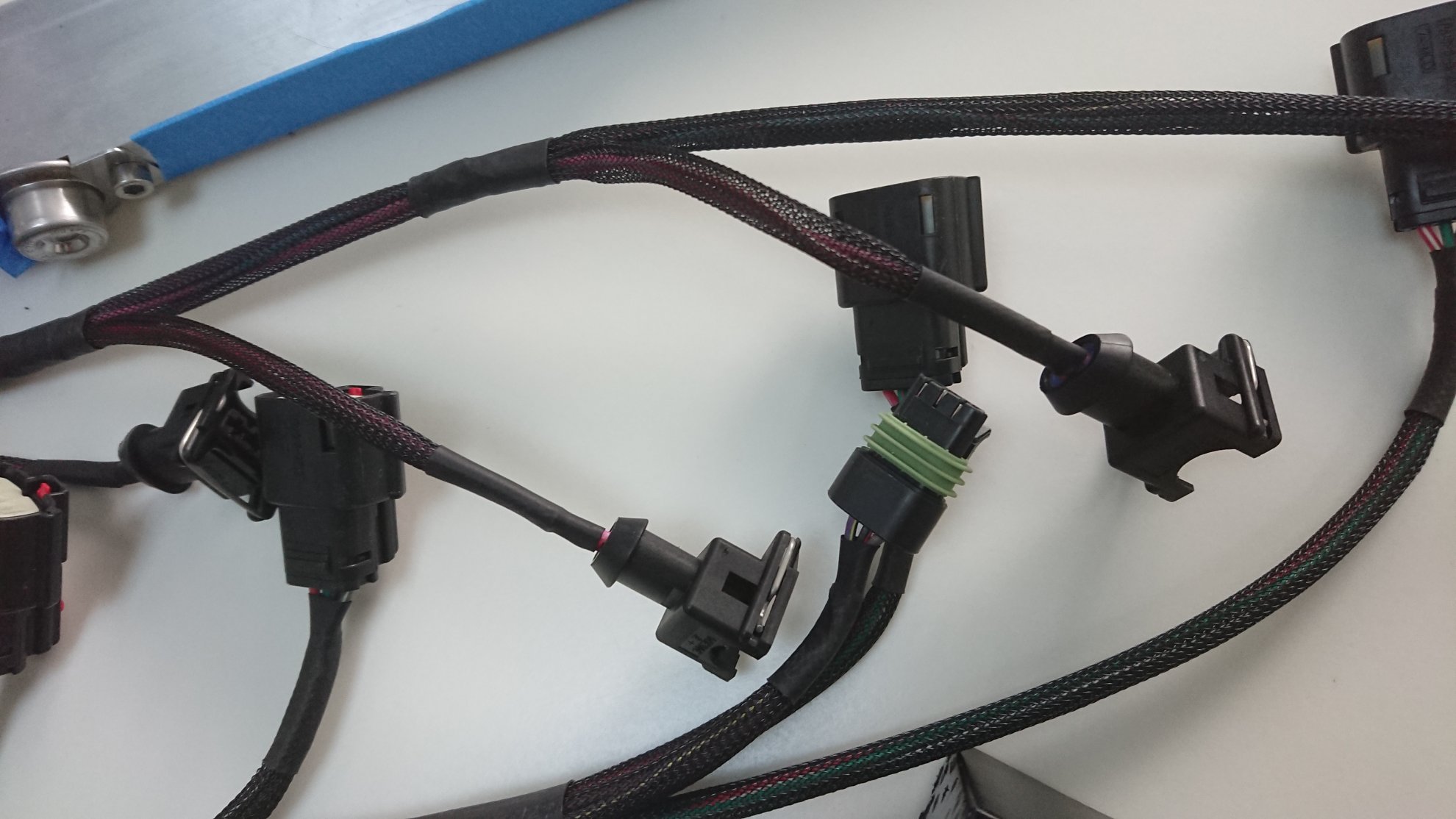

Still a long way to go. Currently I am working on a completely new wiring harness which turns out to be quite nice when done. ECU choice is imminent. The bad news is my exhaust system is too small for the new output. Too much back pressure. I had to stop kidding myself that the LS stock headers will do the job. Need new headers and piping to increase to 3.5". The new BTU calculations are telling me that is time to retire the SLC stock radiator which requires a new front end design to install a larger unit. I am thinking of a new space frame front end incl. hinges with quick release to take the whole thing off in a minute. Slowing down due to home remodeling...

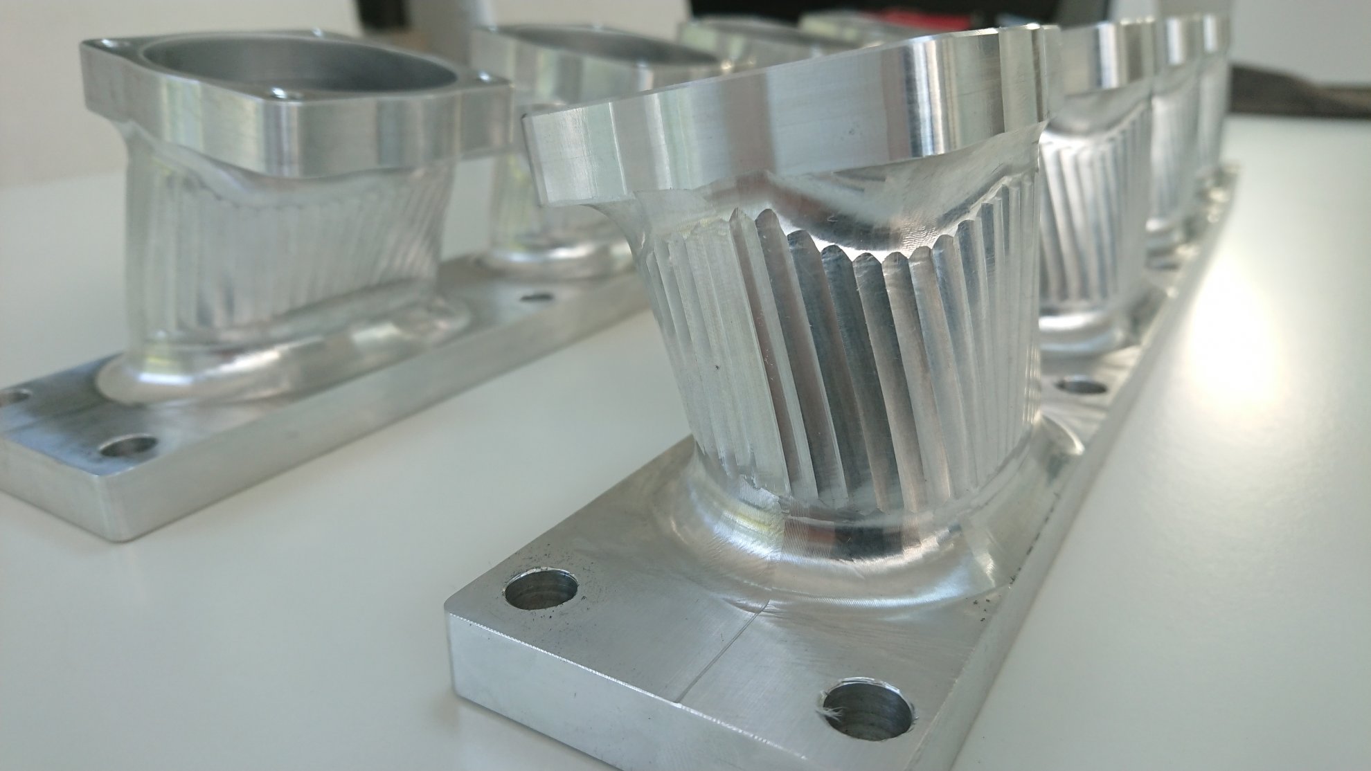

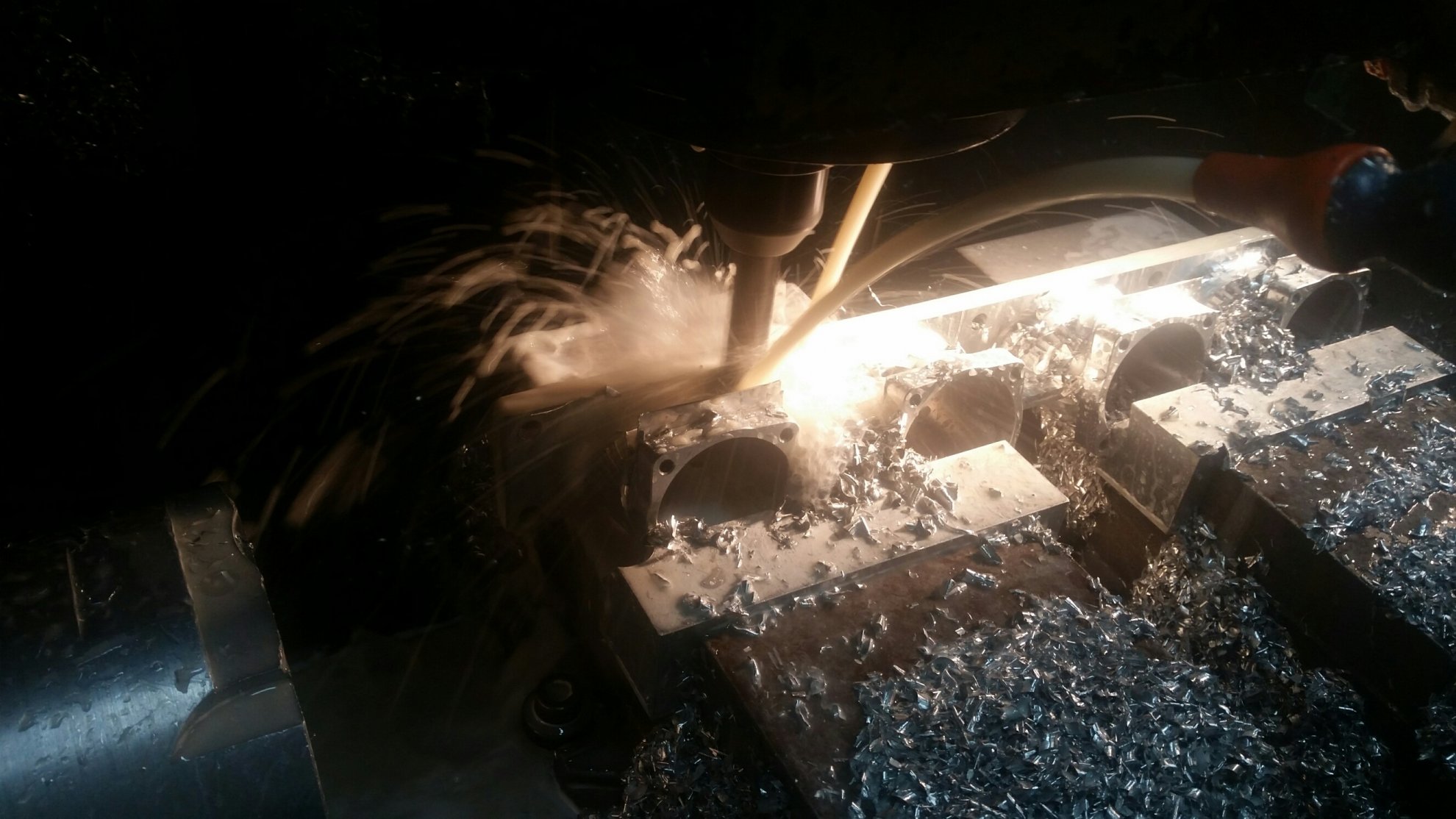

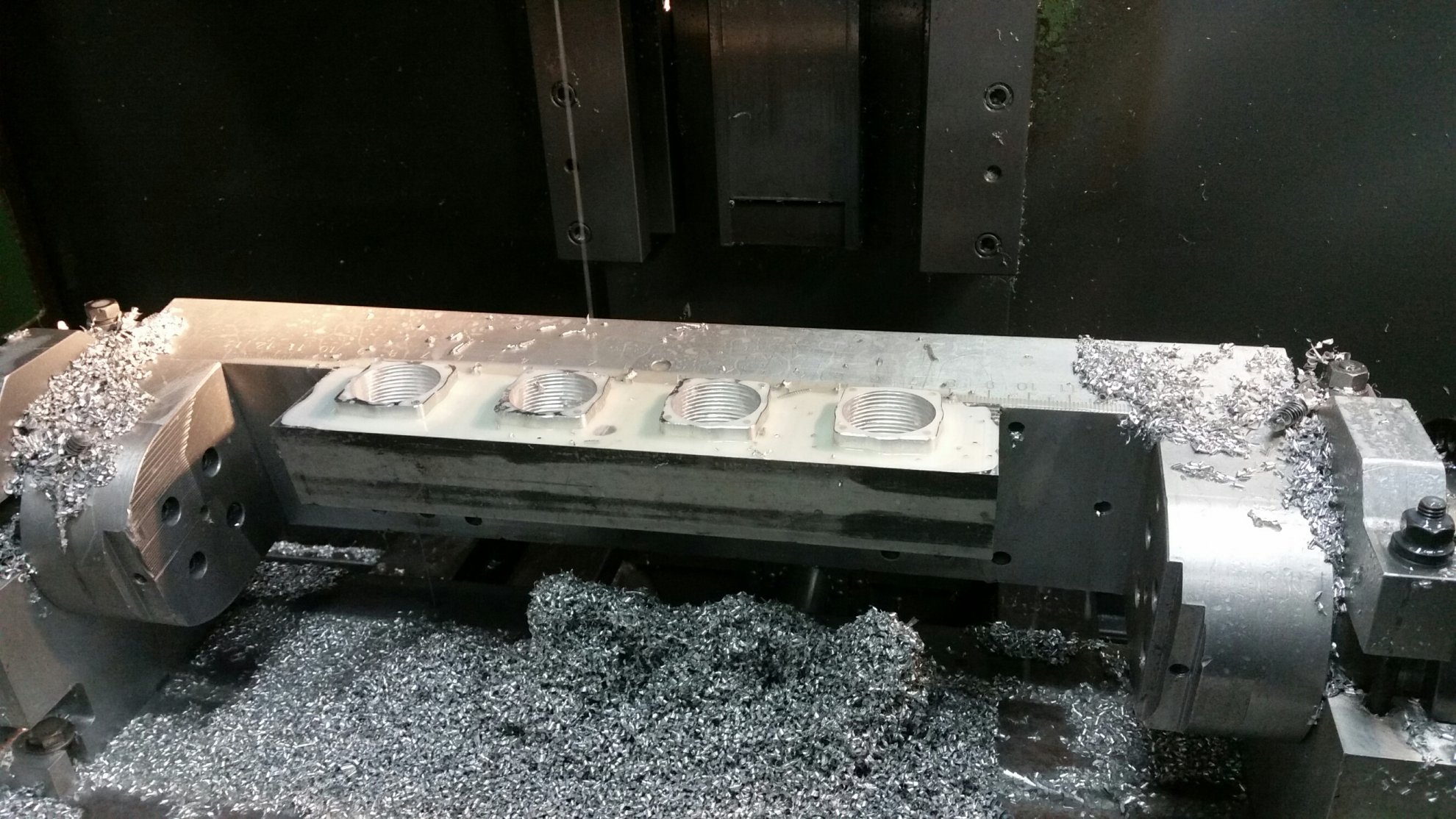

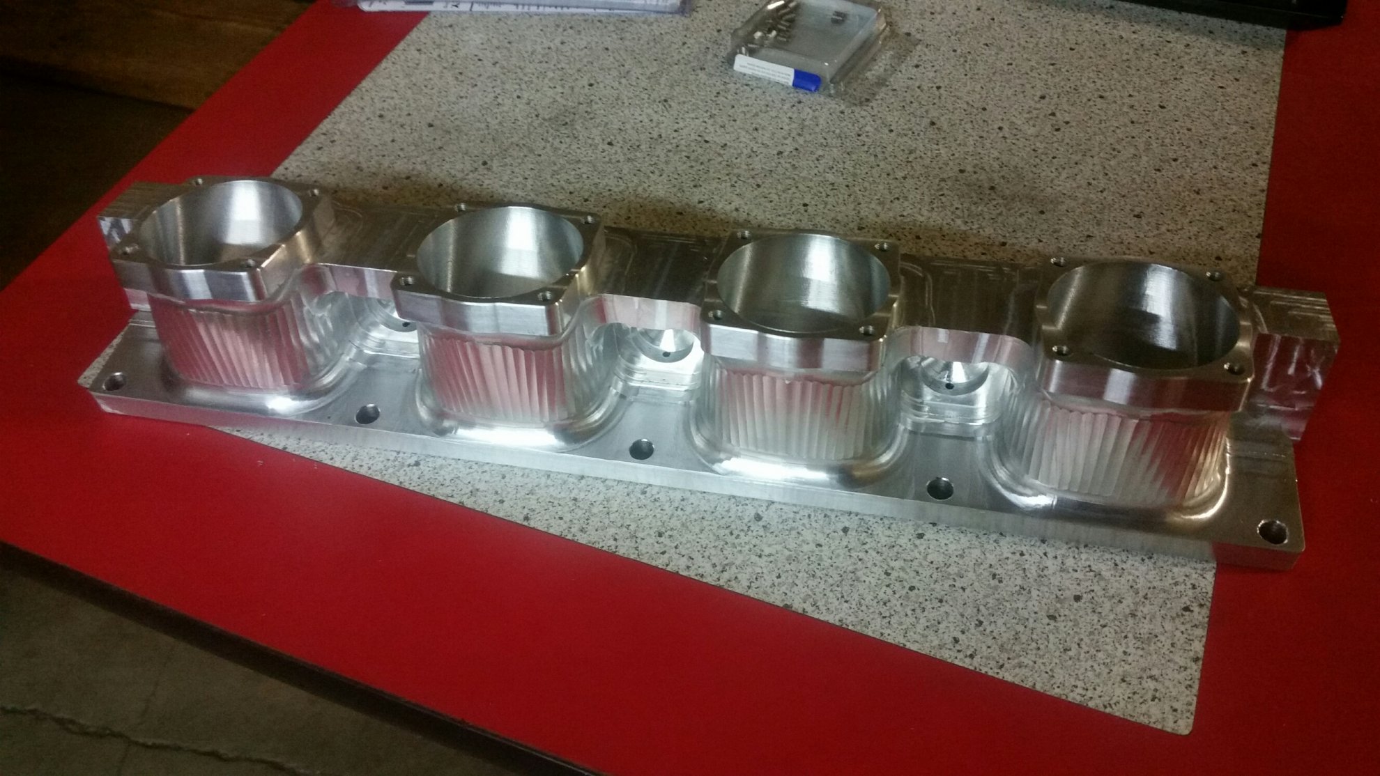

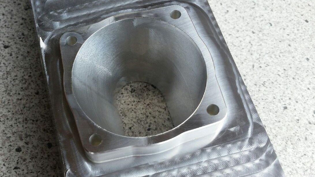

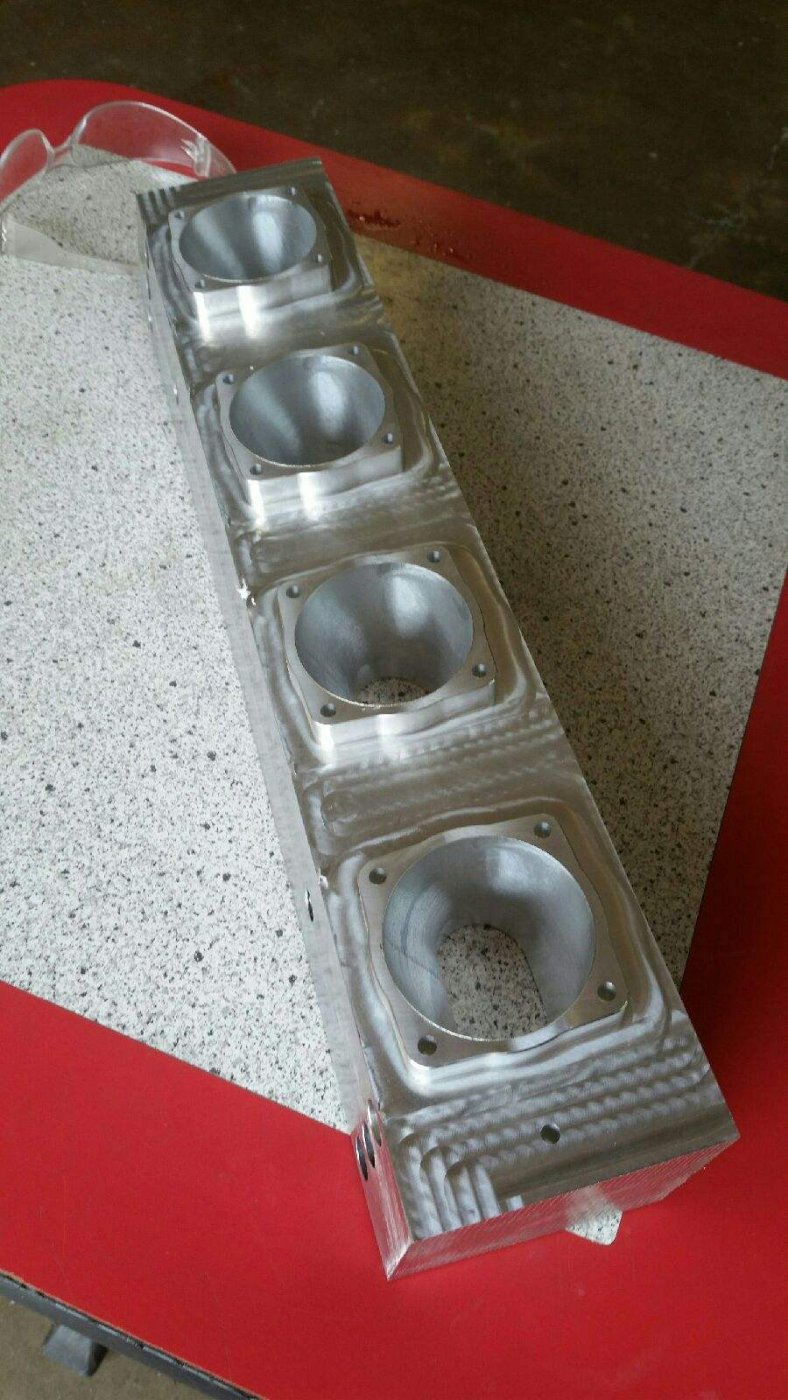

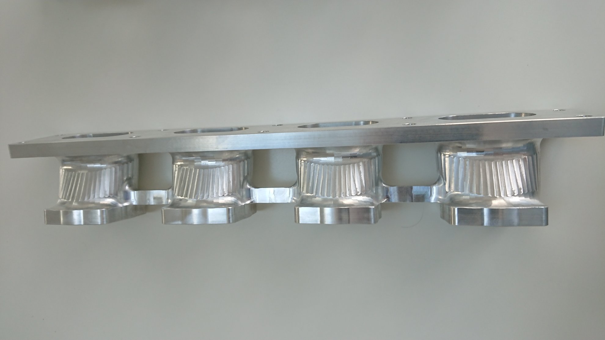

The finishing of the interior walls of the manifolds was just completed. That was a lot of detail and machining hours. There will be Helicoil inserts for the bolt down of the throttle bodies to prevent the aluminum to strip. Moving to the exterior shaping.

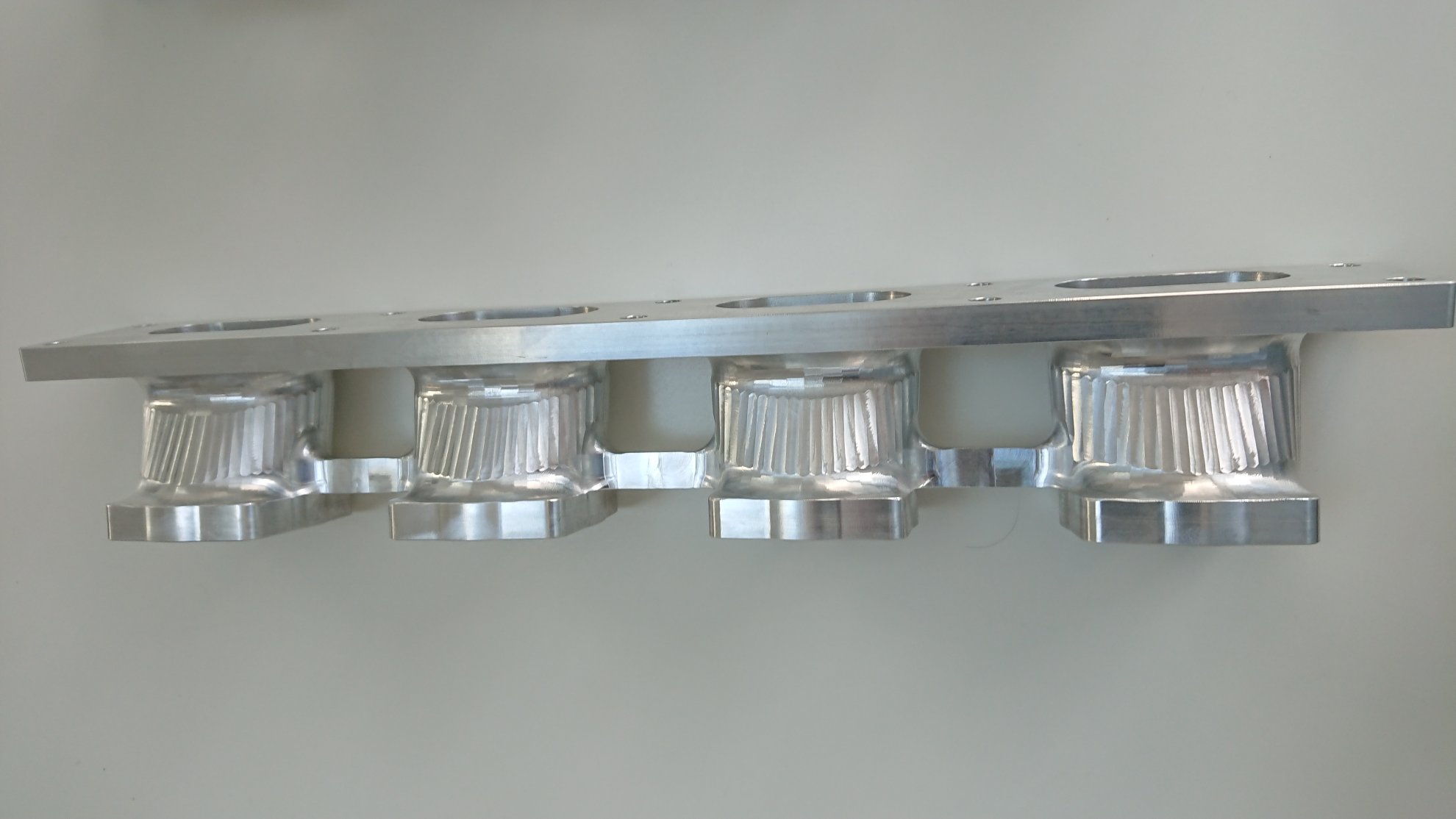

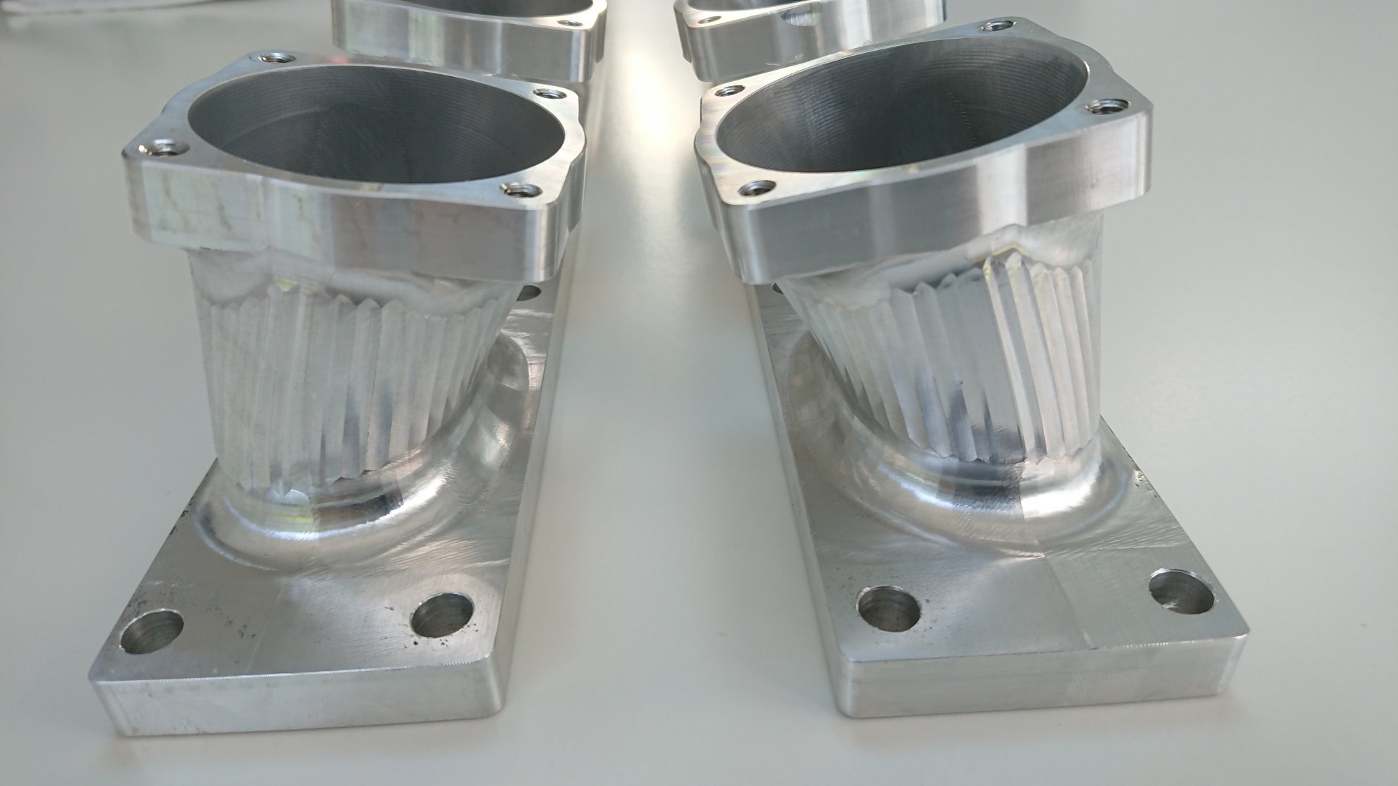

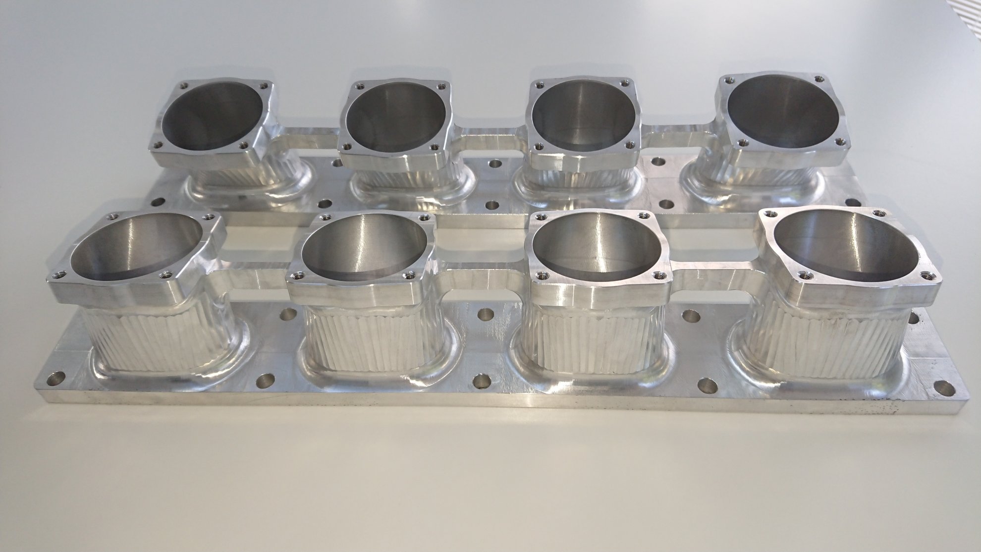

Stephan E.

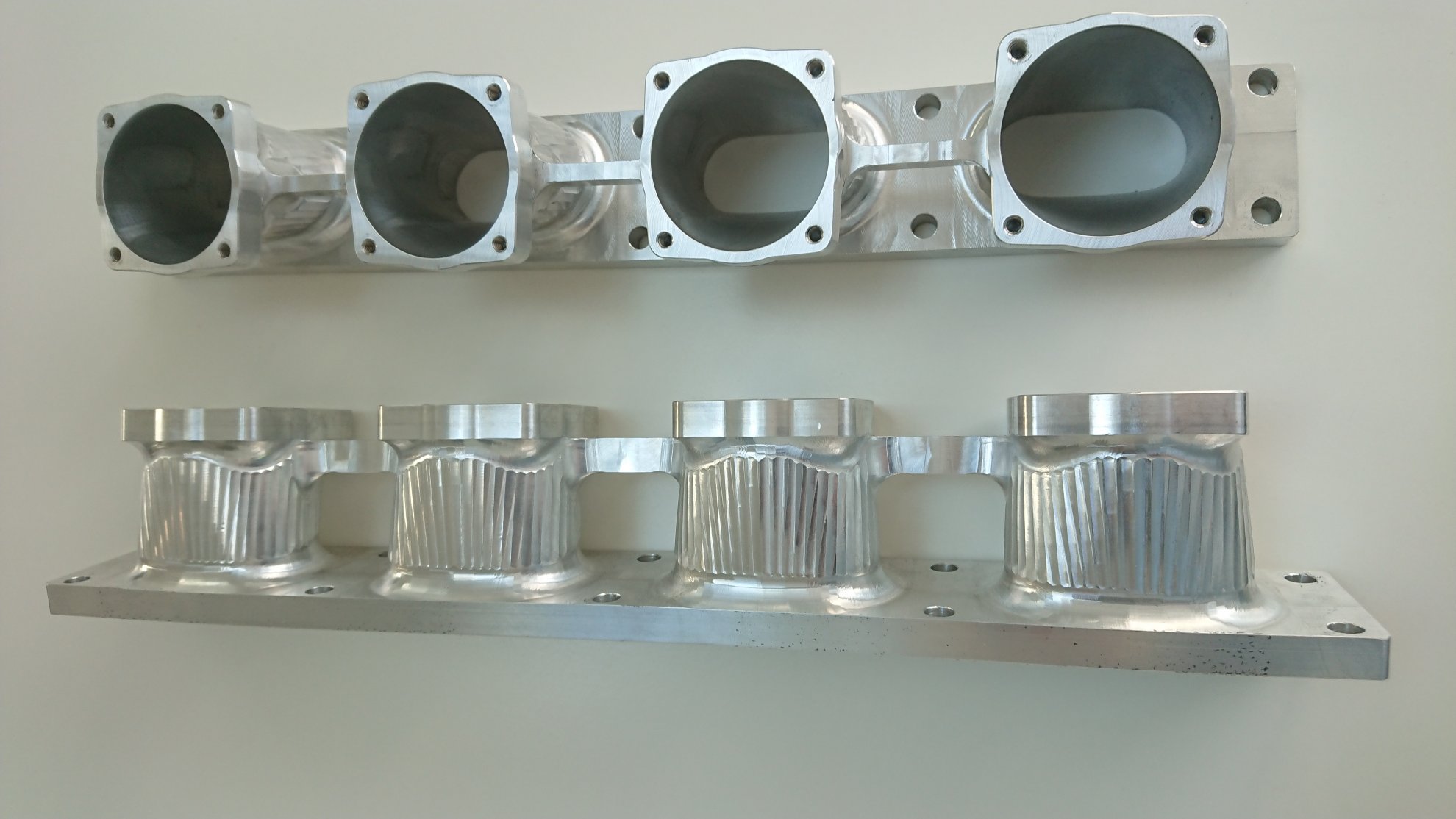

...and both banks completed. Next I'll be ordering the throttle bodies and linkages. Will take a few, some parts come from the UK, some from Australia. Stay tuned.

Stephan E.
Wow! Now that is impressive Stephan.
Hi Joel,
Thank you for the compliment. It took some imagination but it will eliminate the need for a sound system. A full orchestra in the rear compartment. It certainly was a challenge but that is what a SLC is all about. Still, a few bridges to cross...
