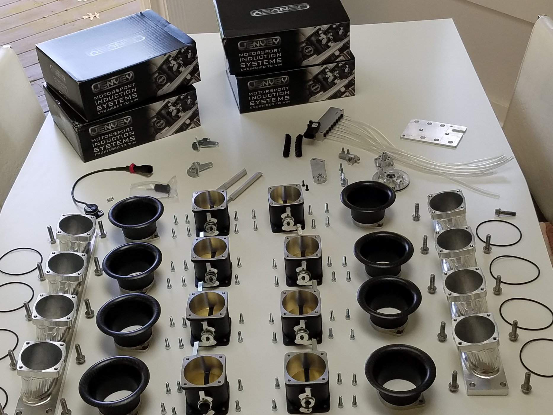

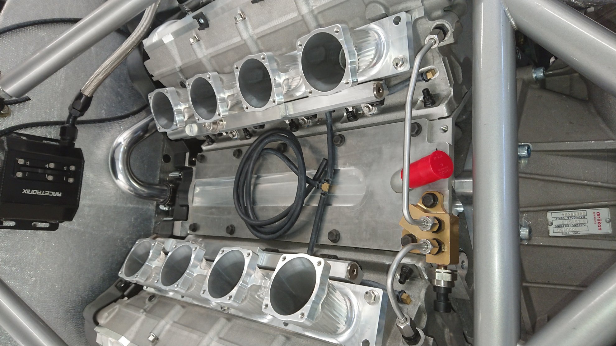

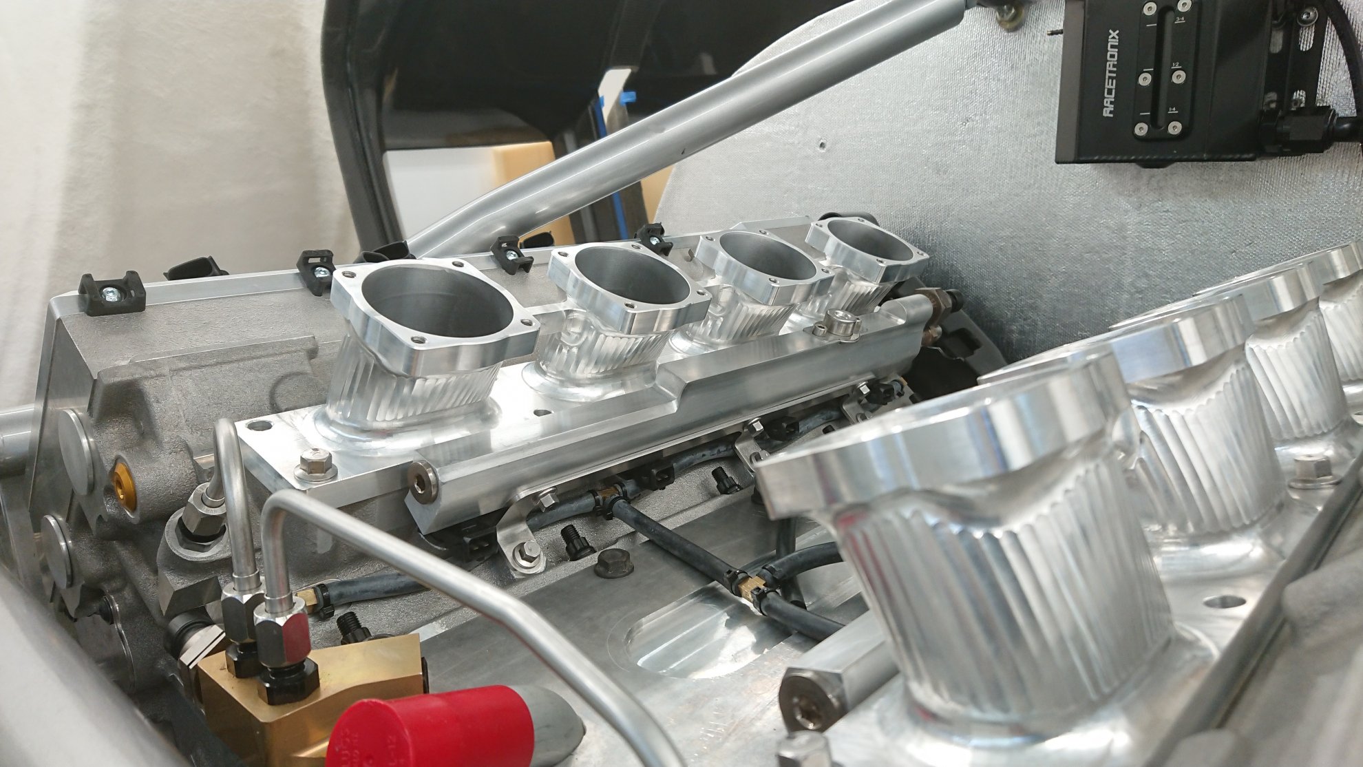

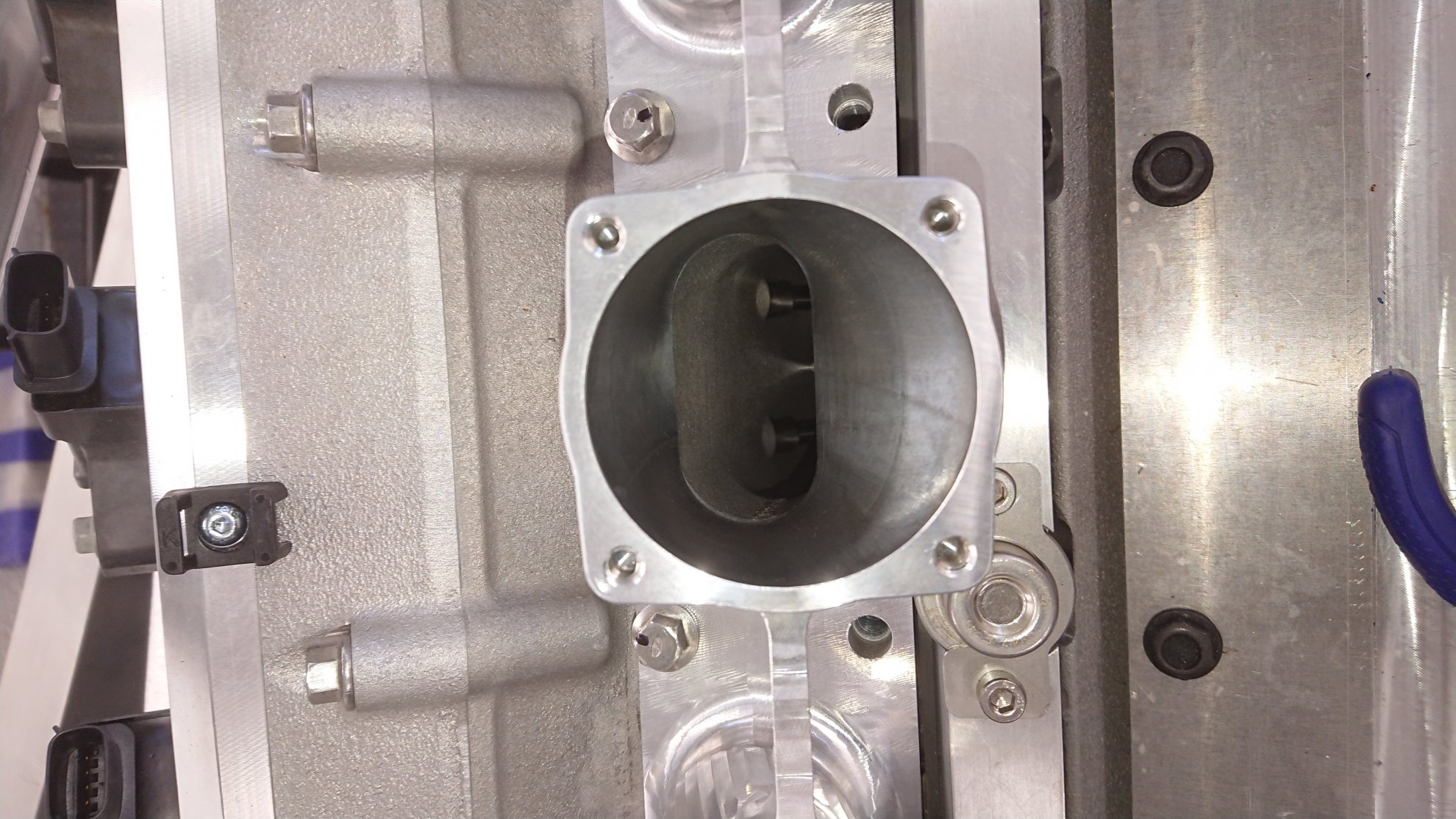

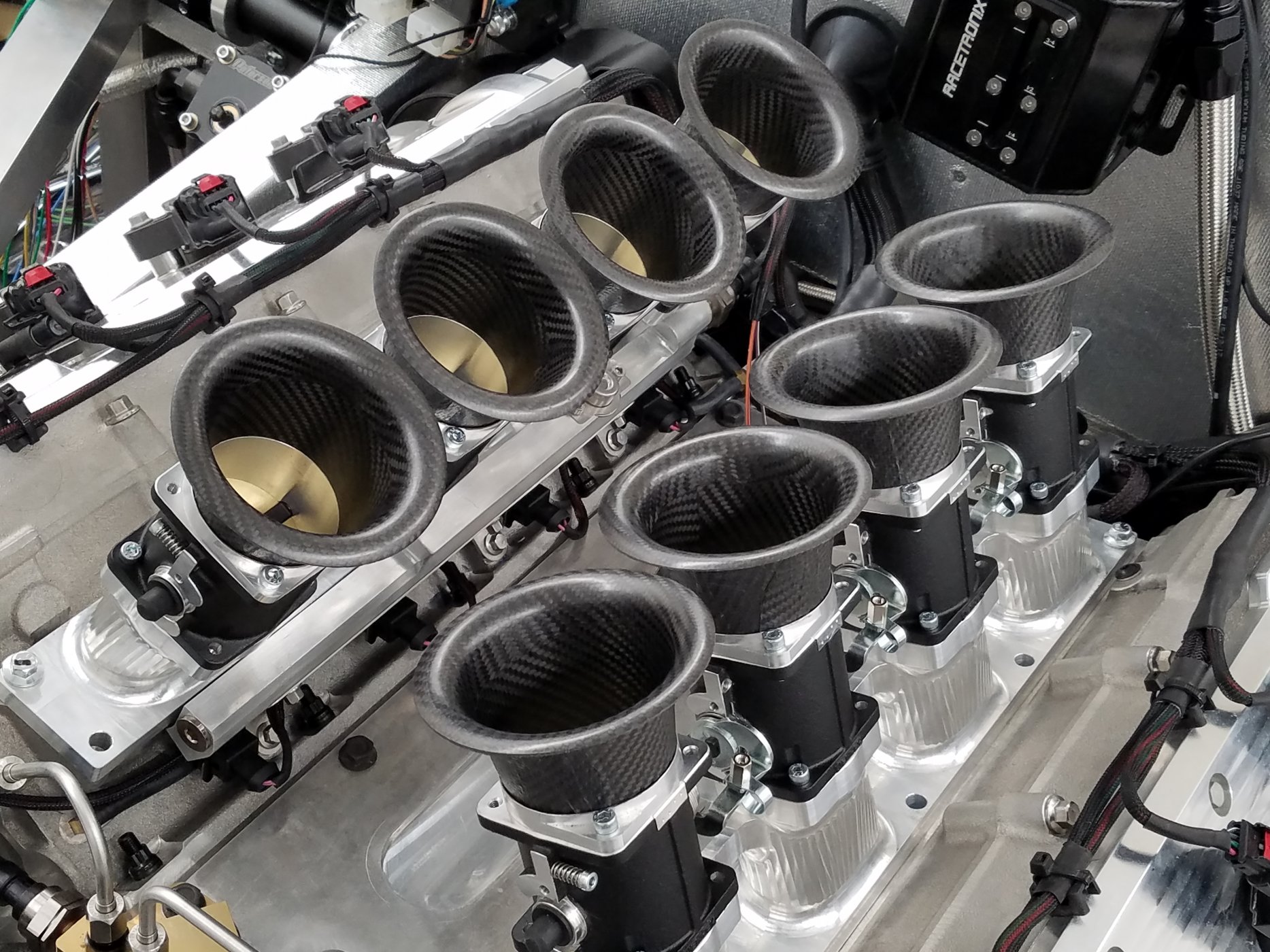

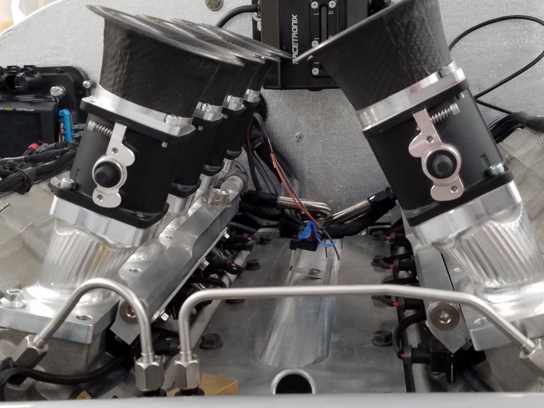

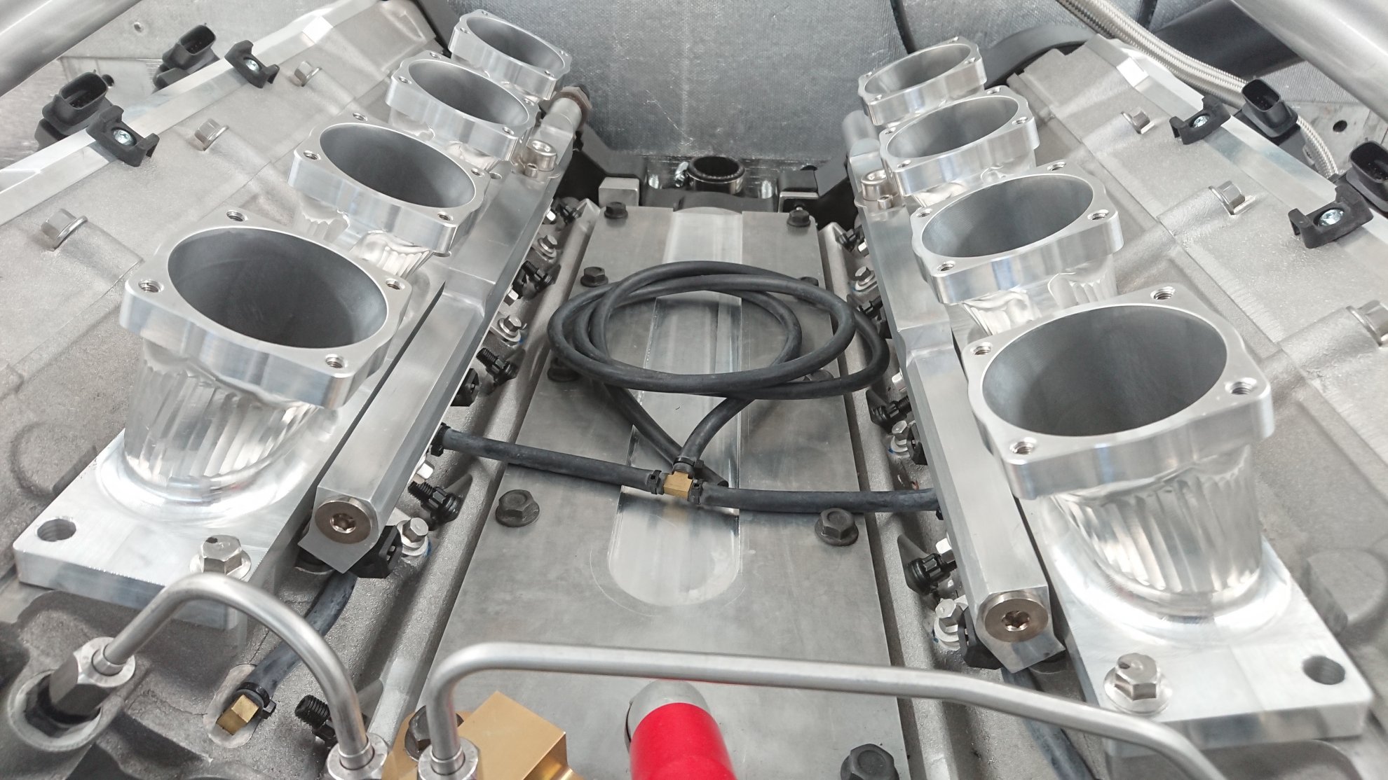

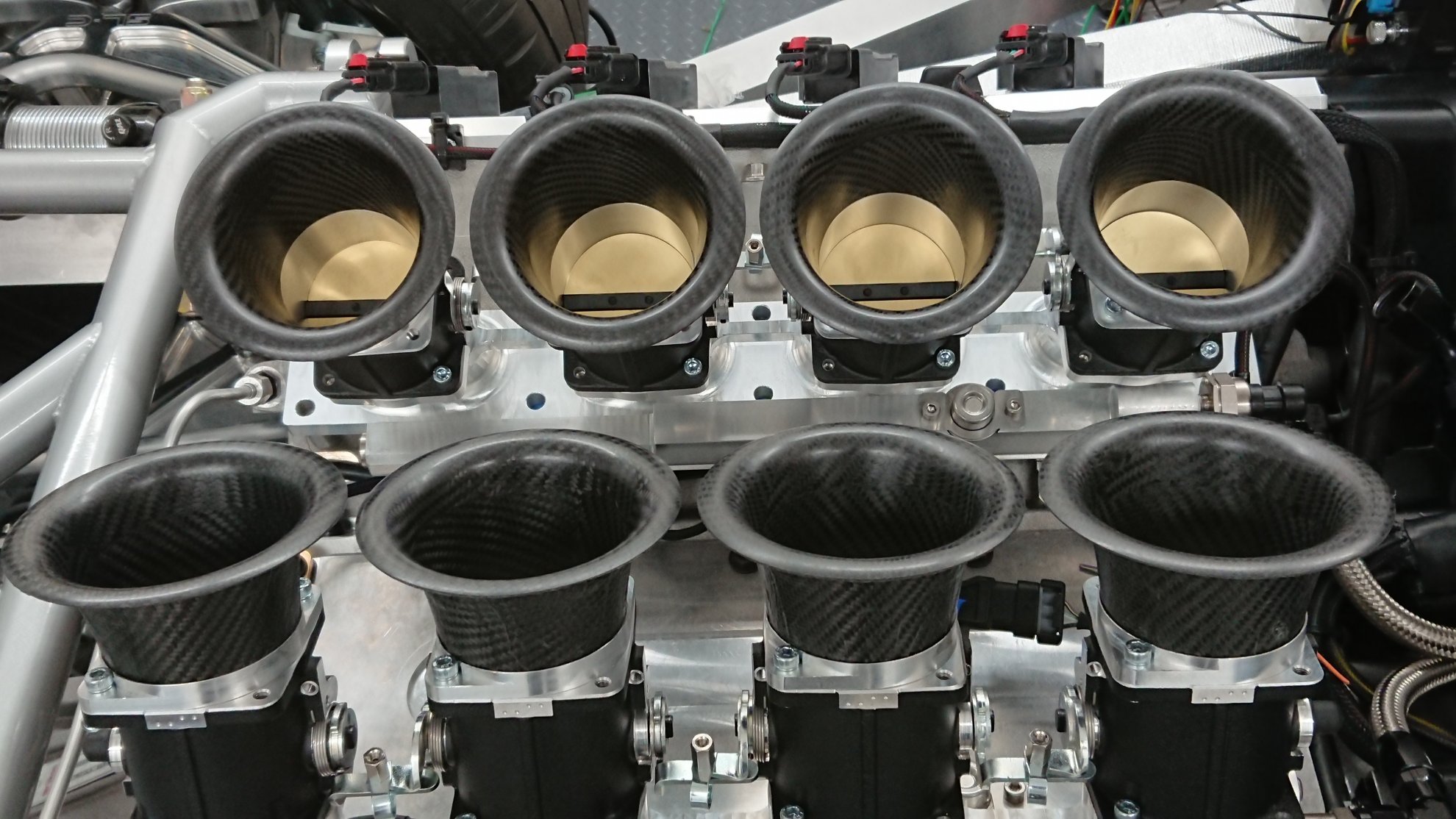

First test fitting. Seems that all that measuring paid off :cool:. The billet fuel rail are a nice match. I wanted to mention that the throat of the intake runners at the head entry are almost 3 in. wide. It does not come across since there is no dimensional reference point. I am afraid that there will be some sort of fuel consumption involved here.

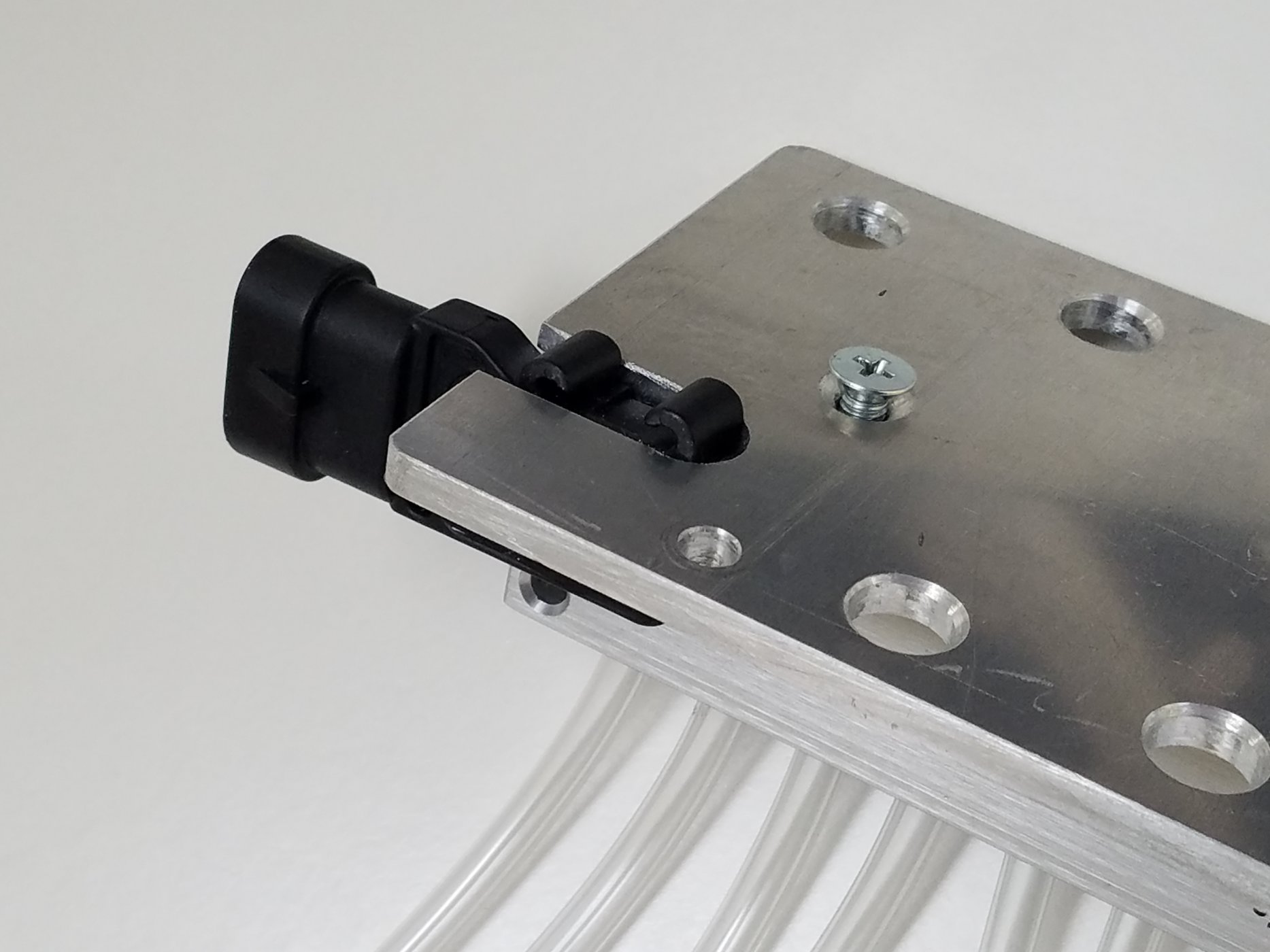

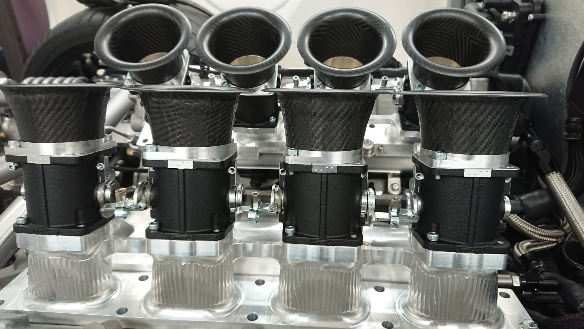

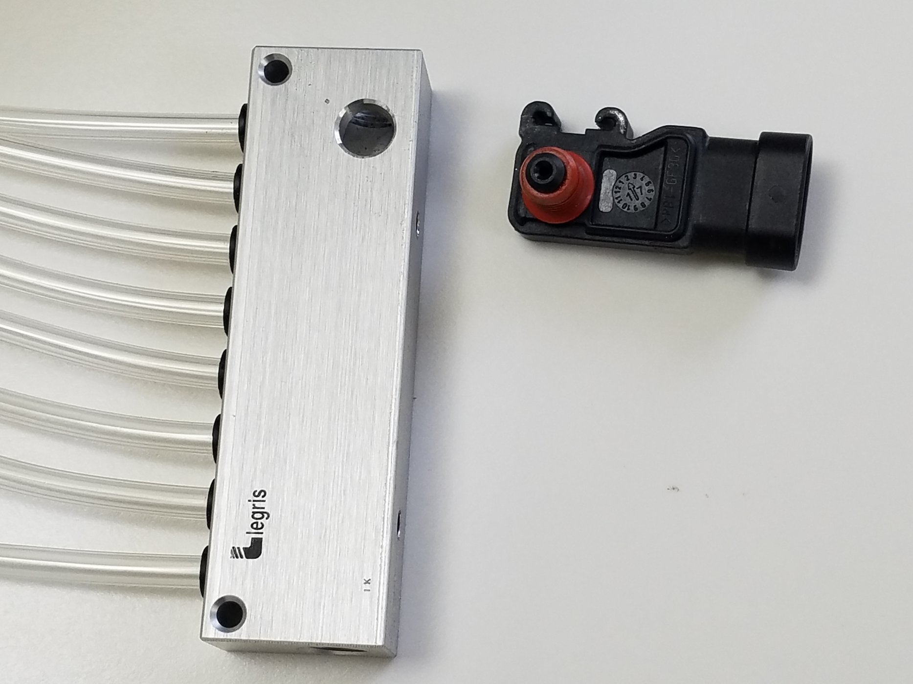

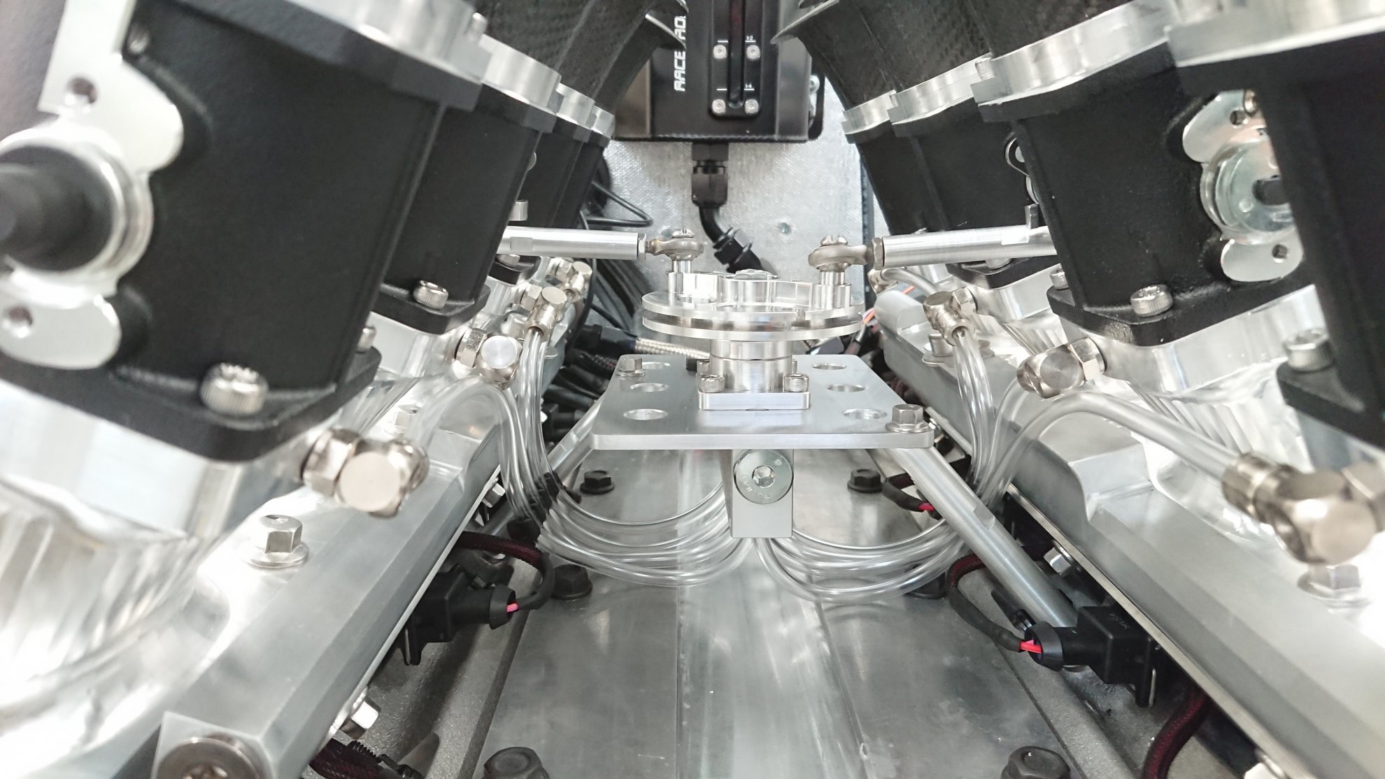

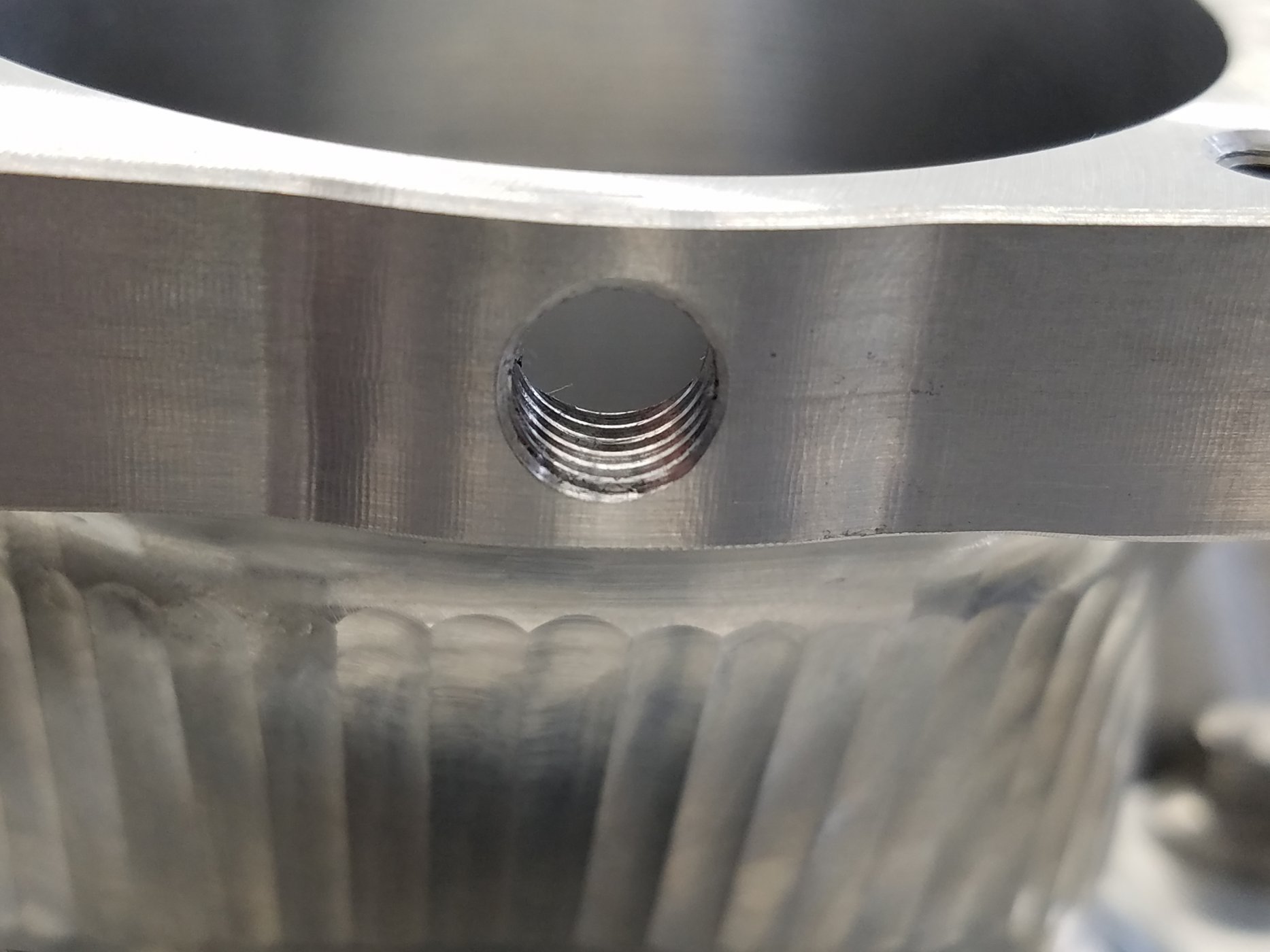

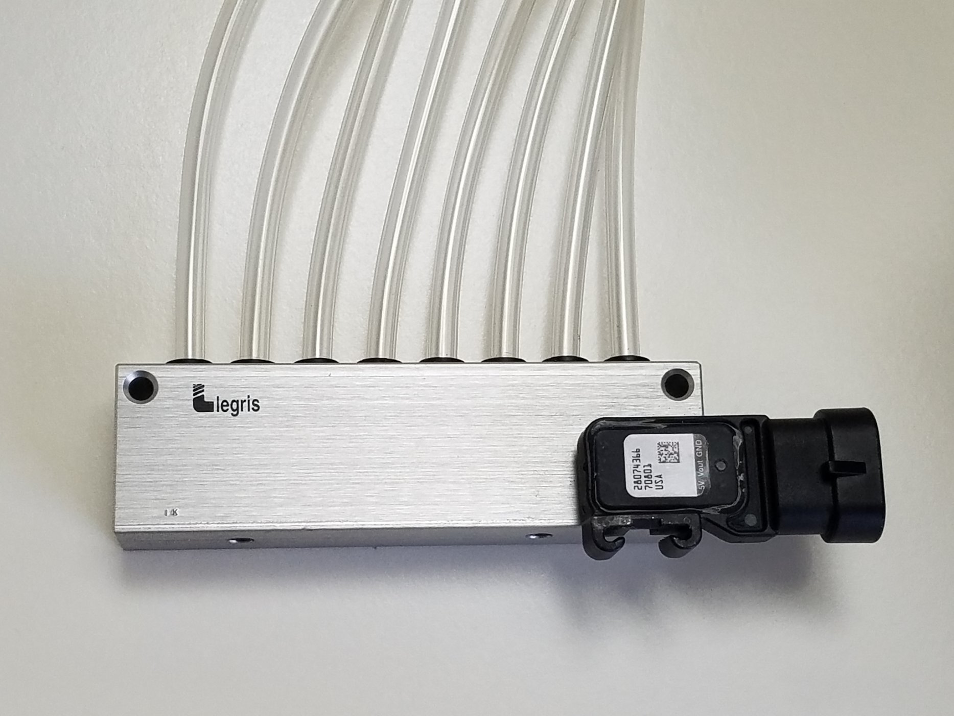

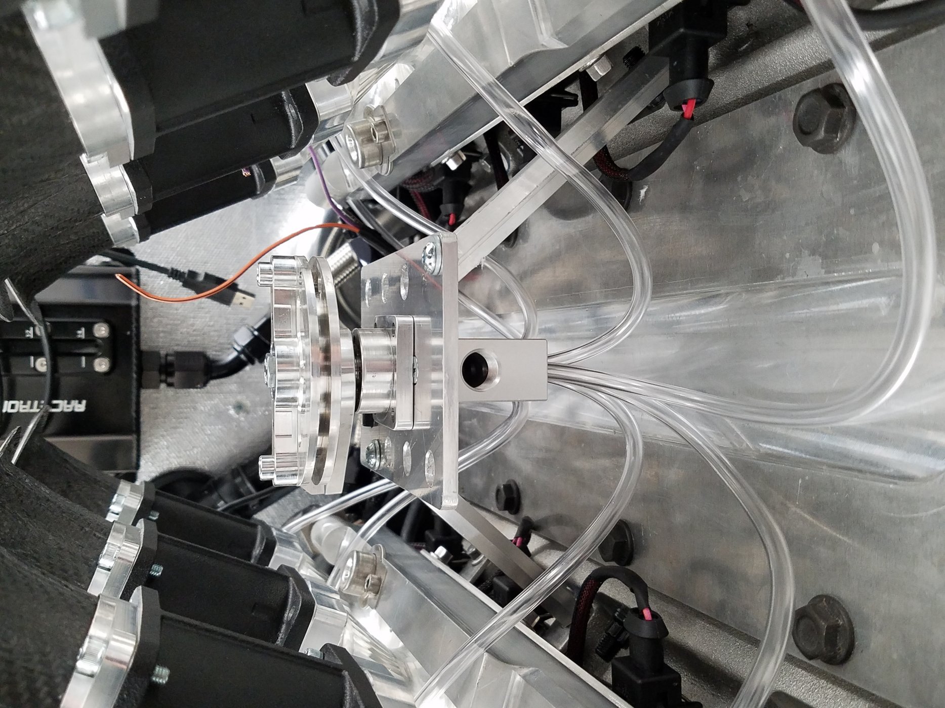

I started on the vacuum system driving the MAP sensor. Added the ports to the ITB manifolds. The swivel push in connectors for the ITB manifolds are underway. The collector manifold was chosen to be off the shelf and is sitting under the pedestal for the ITB linkage. A side entry was machined for the MAP sensor. Instead of using hardware to secure the sensor, a slot was used to hold it in place. I opted for eight equal length tubes vs. daisy chaining them. That way I can add check vales if needed and it's smoothing out the pulsing of the signal

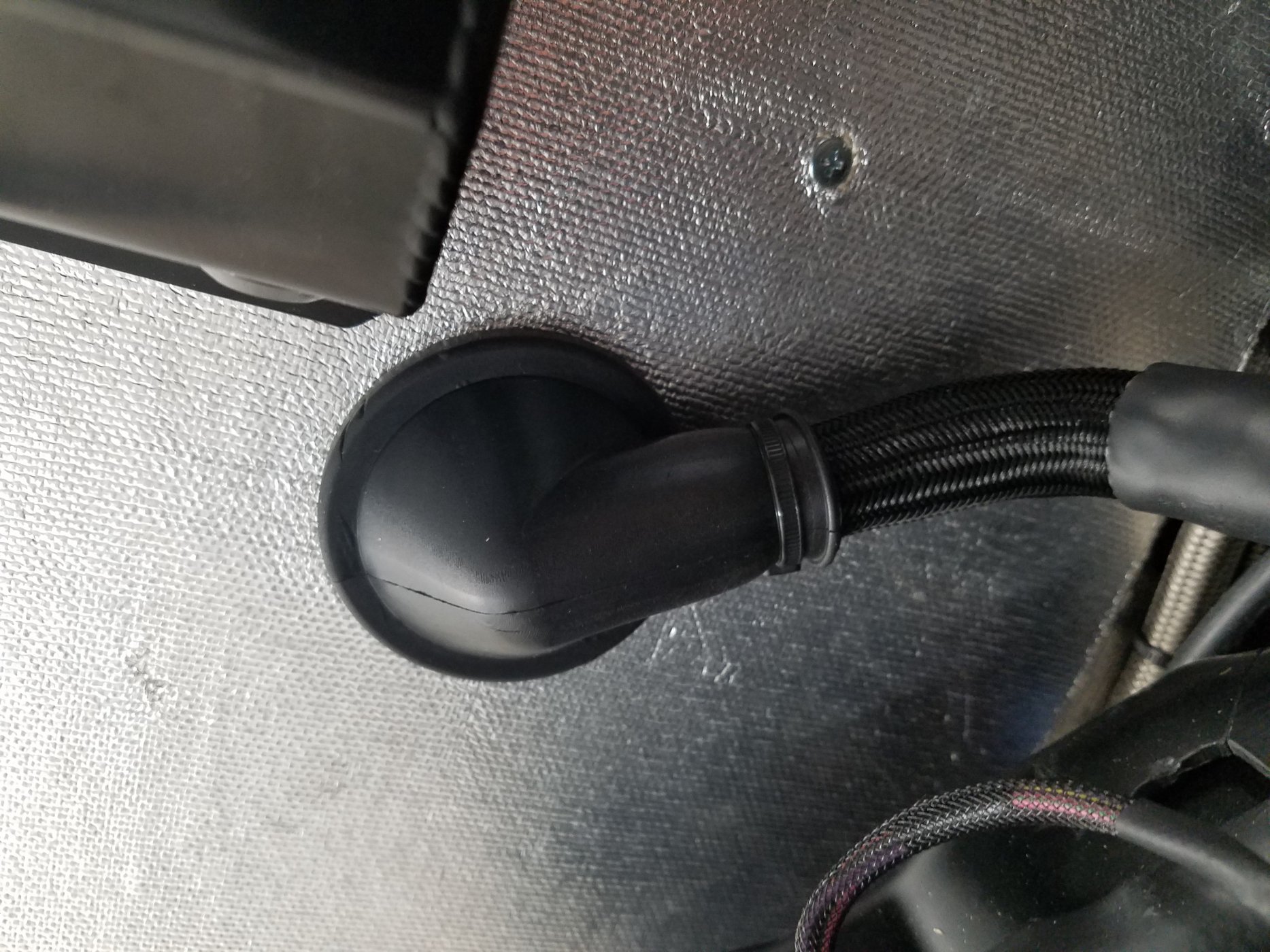

The engine harness is installed and routed through the bulkhead since the ECU is on the other side. I found this boot on a website for Nissan spare parts.

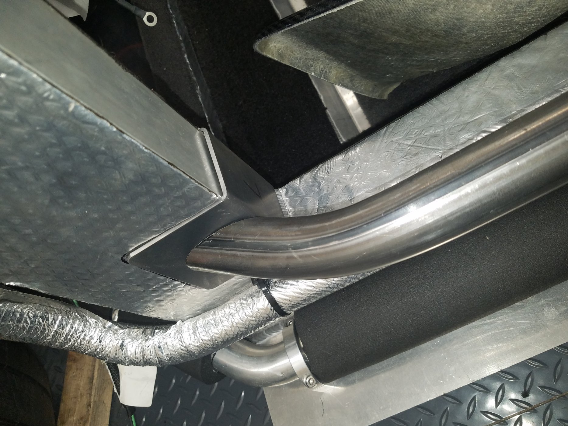

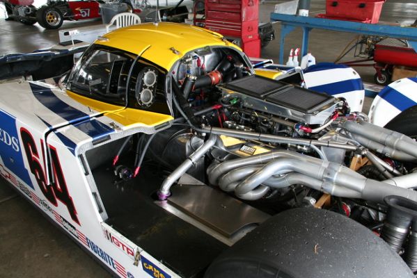

Looking at these headers is reminding me on what comes next. My new primaries are supposed to be pretty much of what is in the picture. 2" + and 32 " long, equal lenght to get max. scavenge from the exhaust system and to reduce back pressure below 38 KPa. I am glad I have nothing installed on the sides because I'll need that room now.

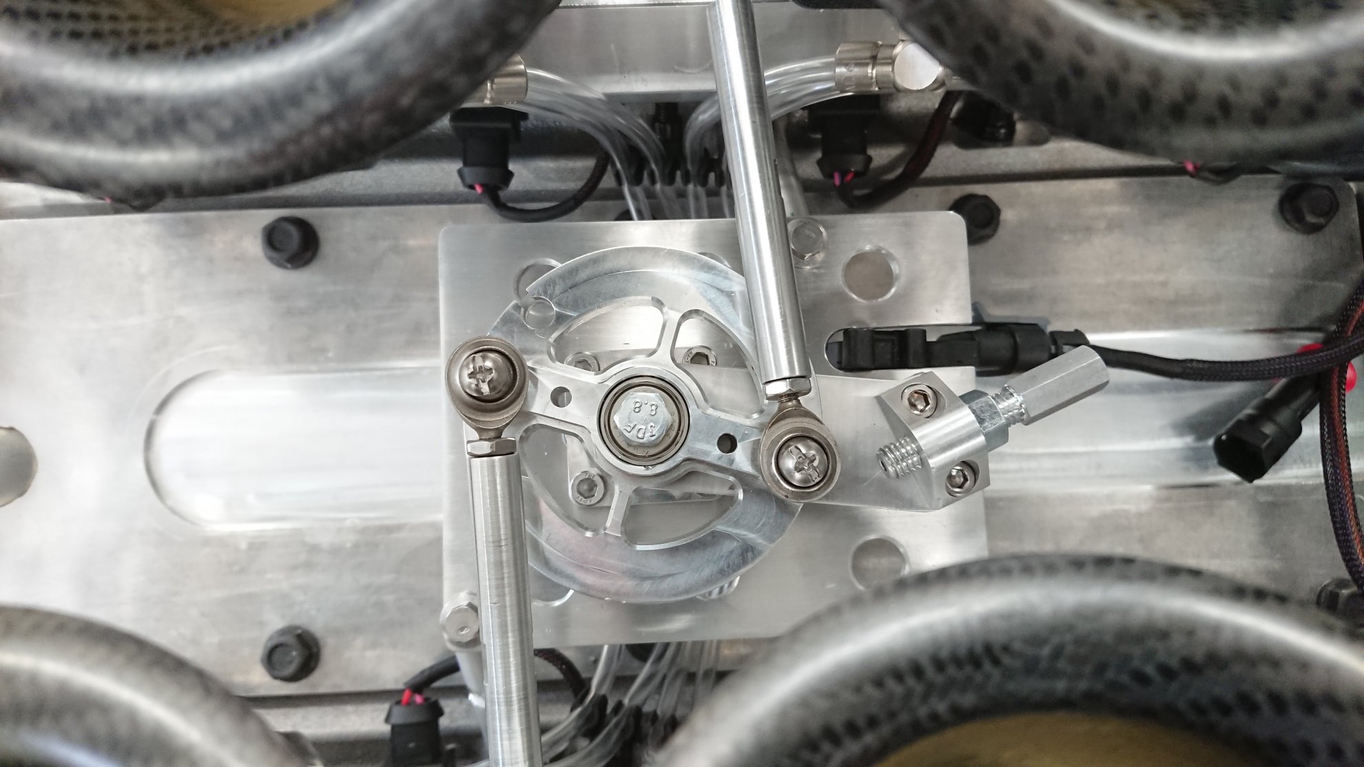

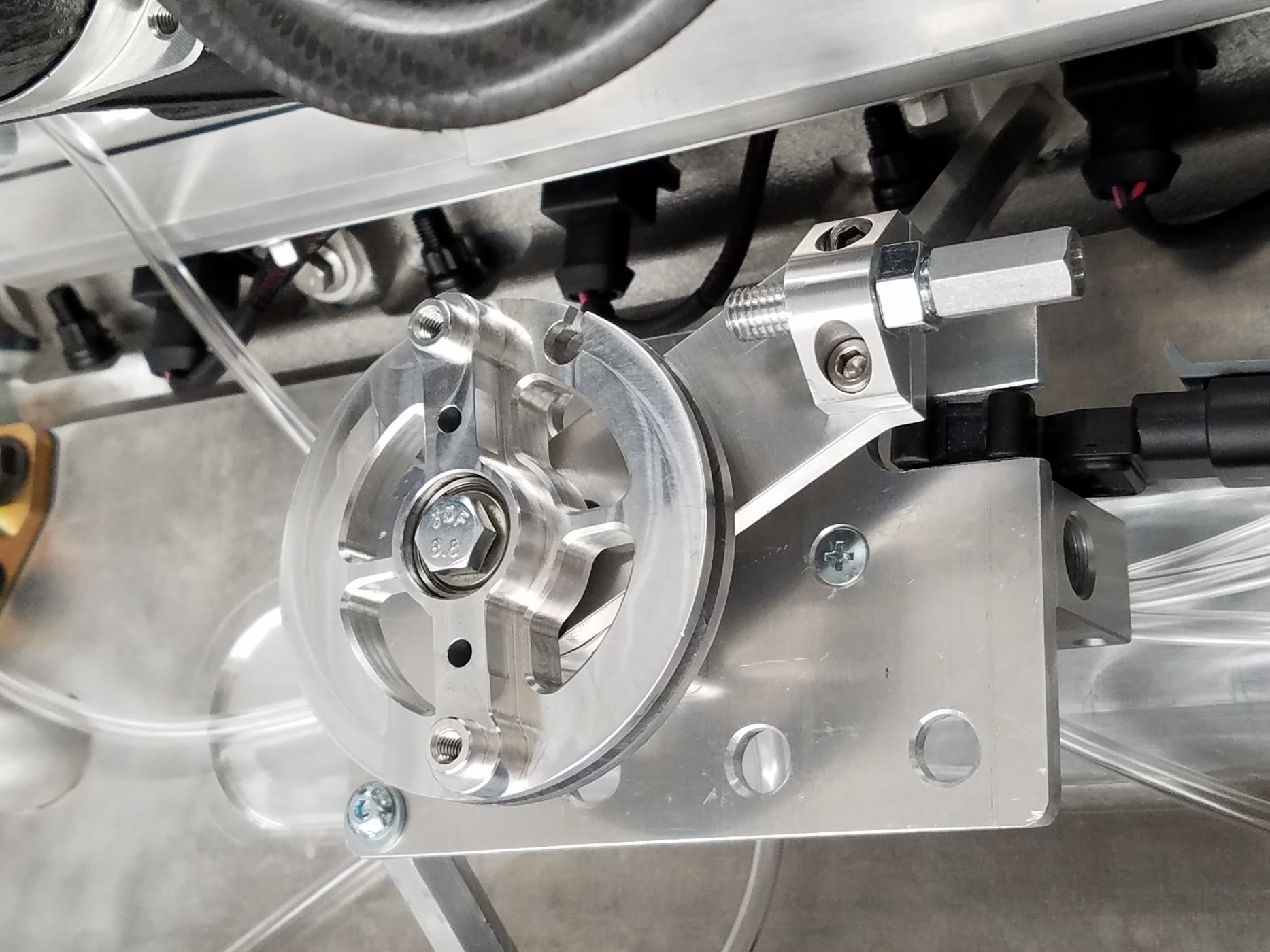

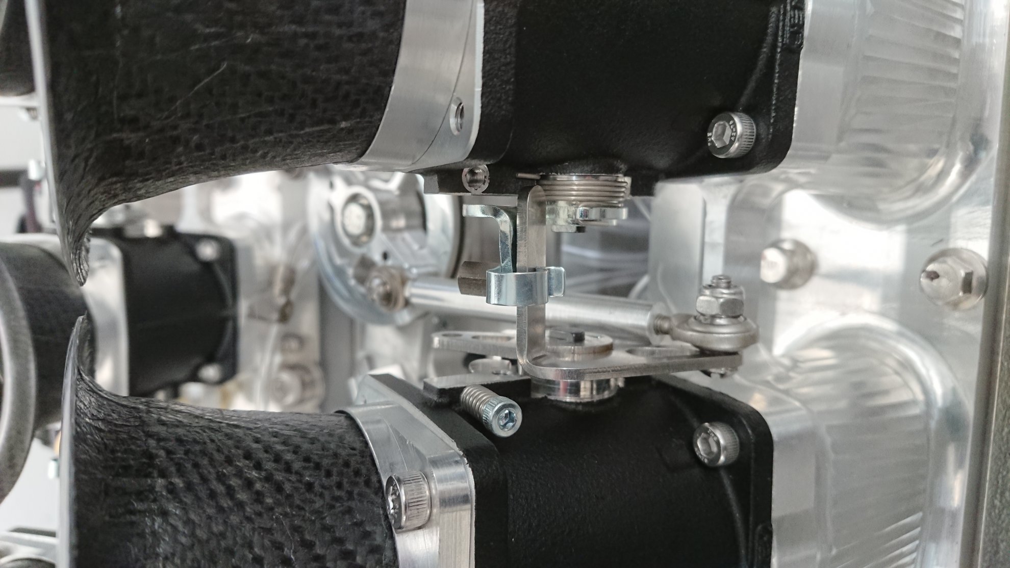

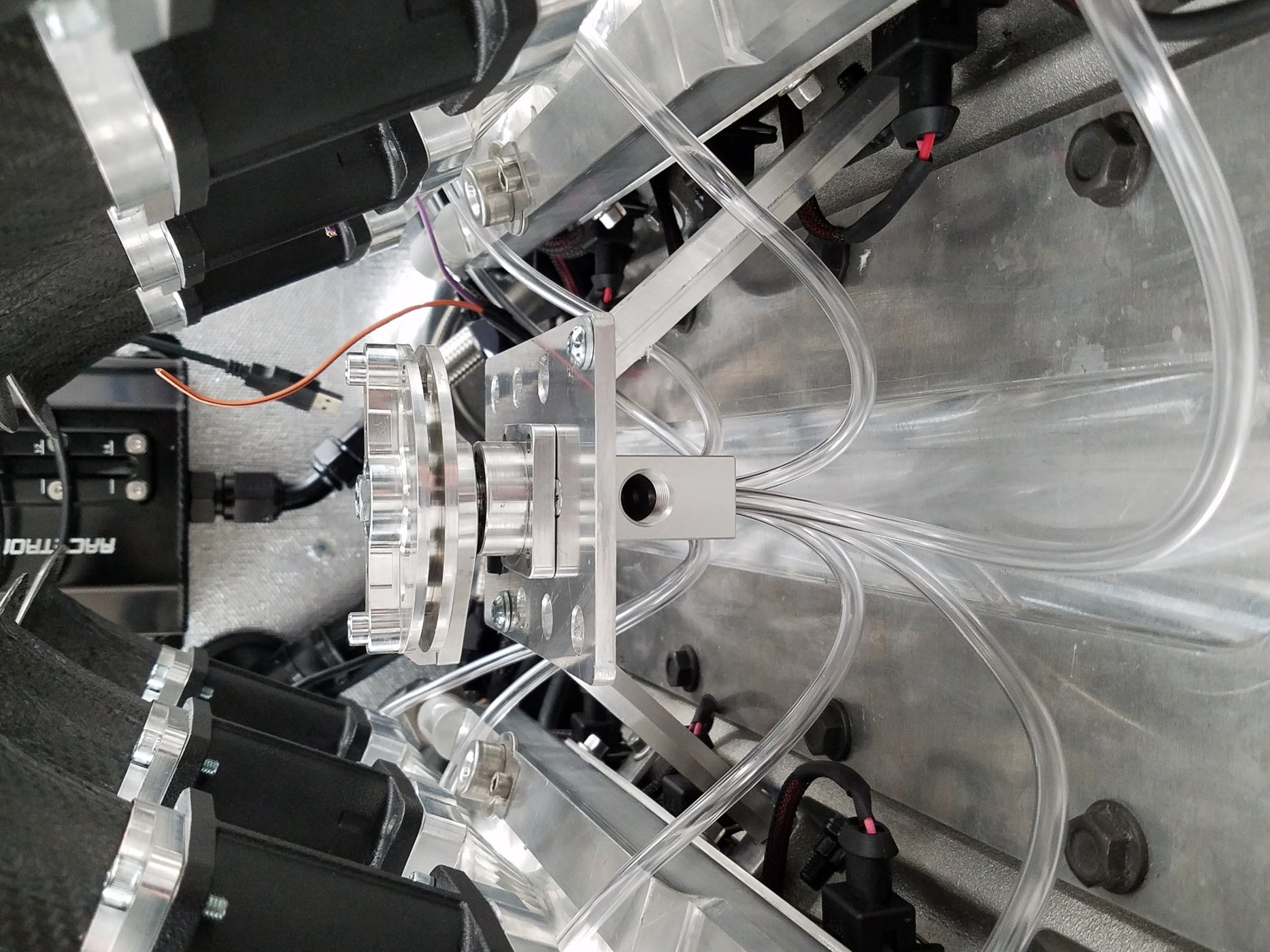

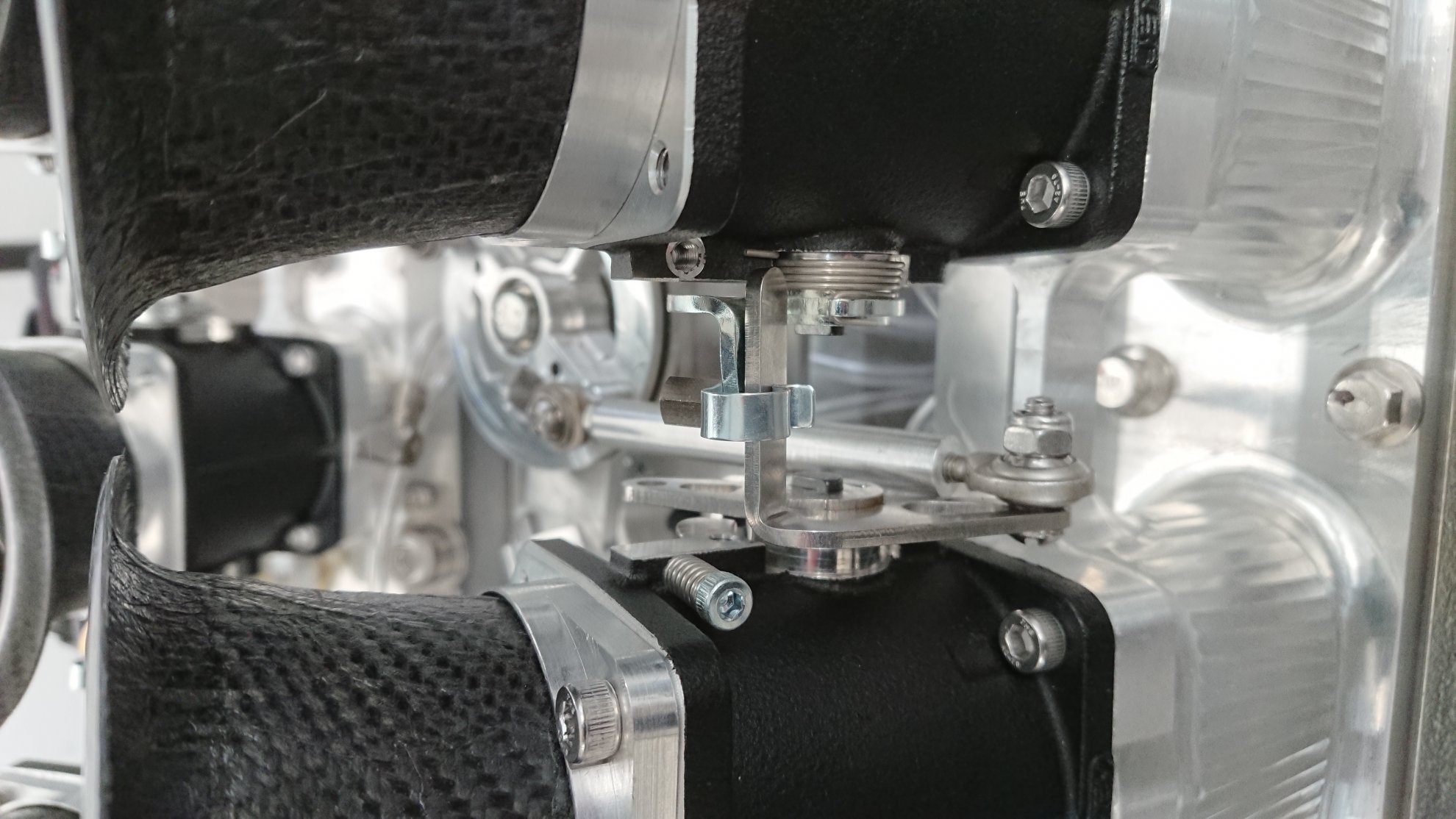

This last weekend I was able to finish the vacuum system and the linkage assembly. I made the throttle body linkage rods from 10mm billet and stainless rod ends. The pedestal standoffs were made from 12mm billet. All rod have flat areas to fit a wrench.

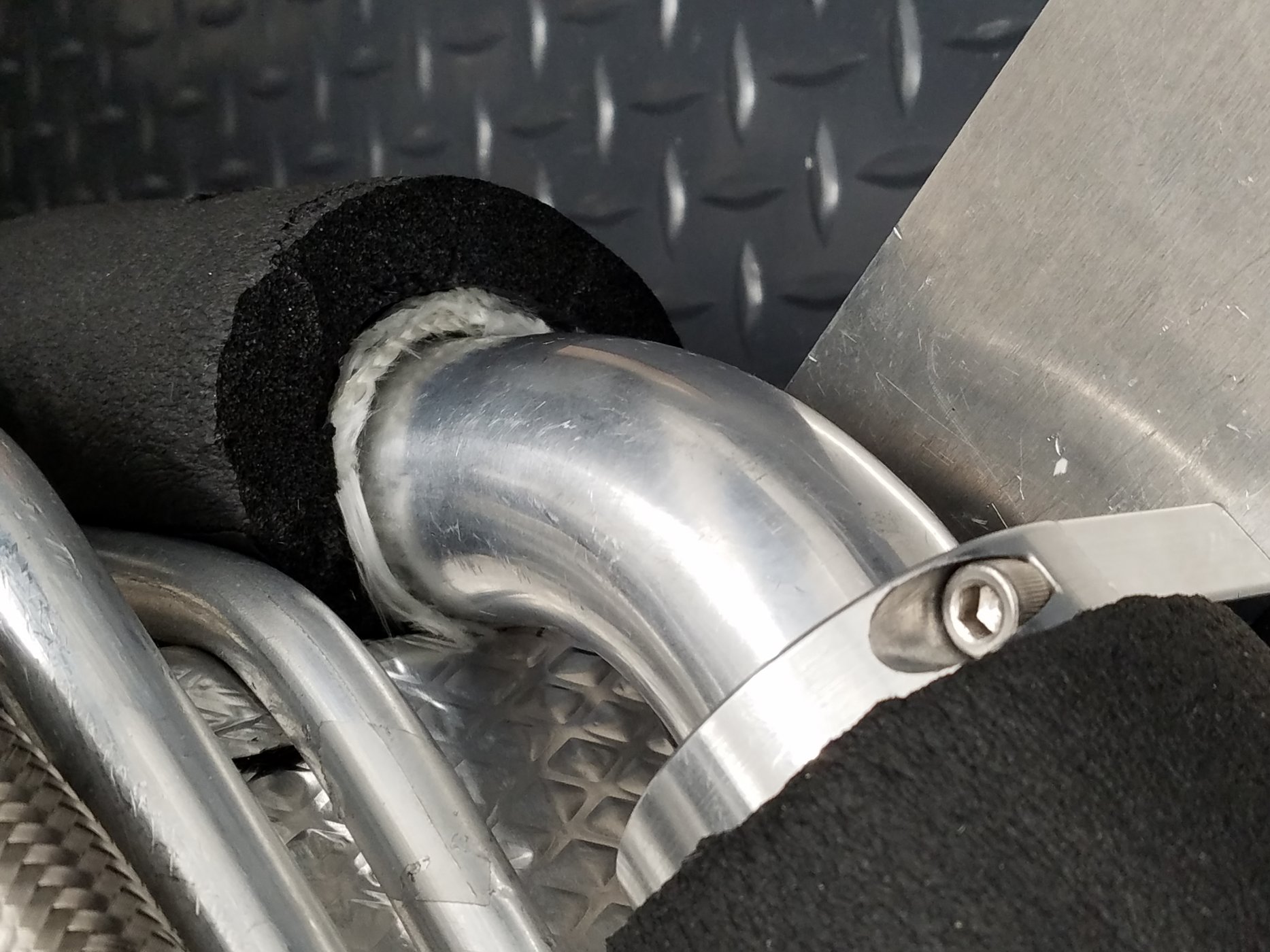

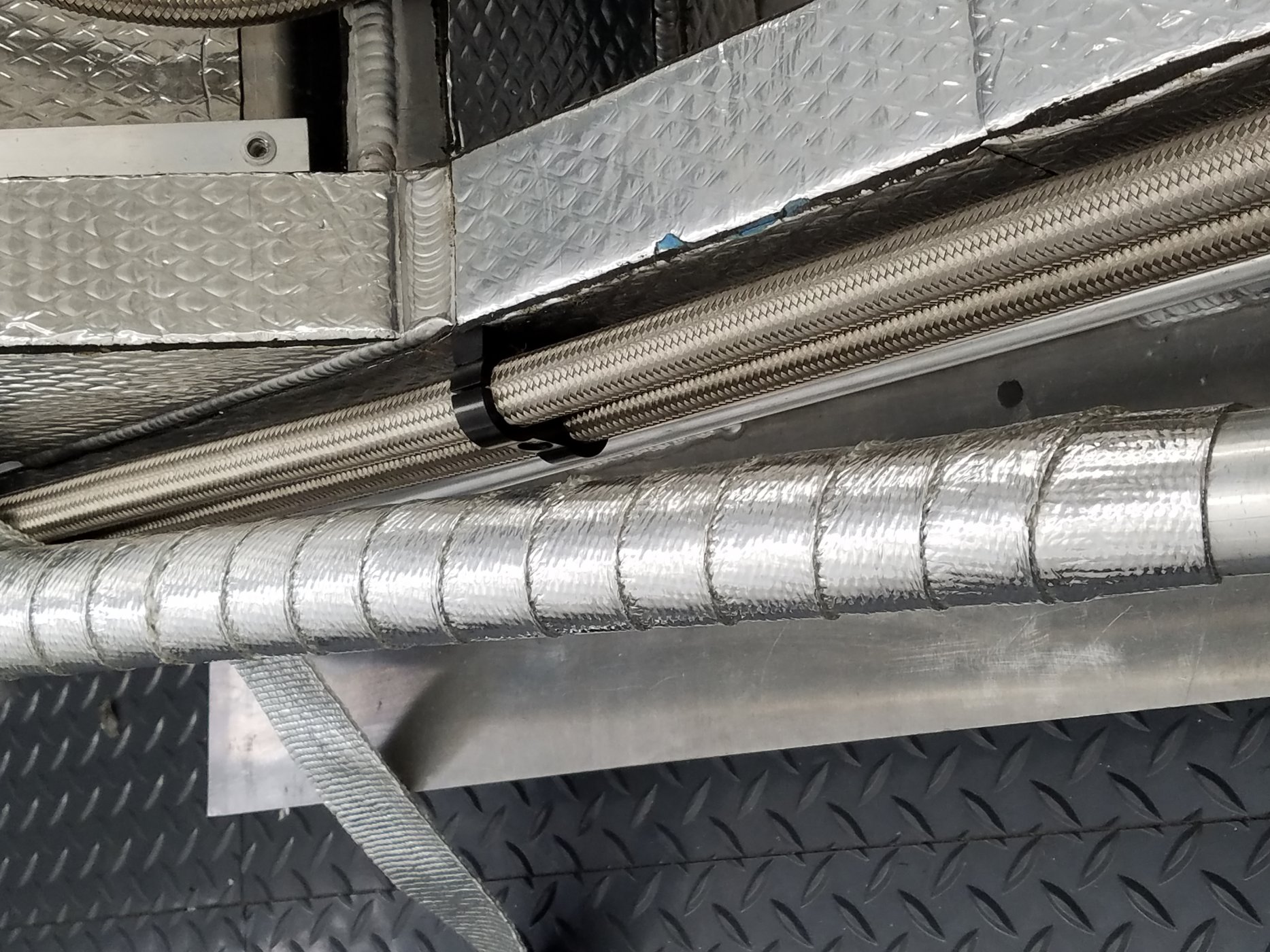

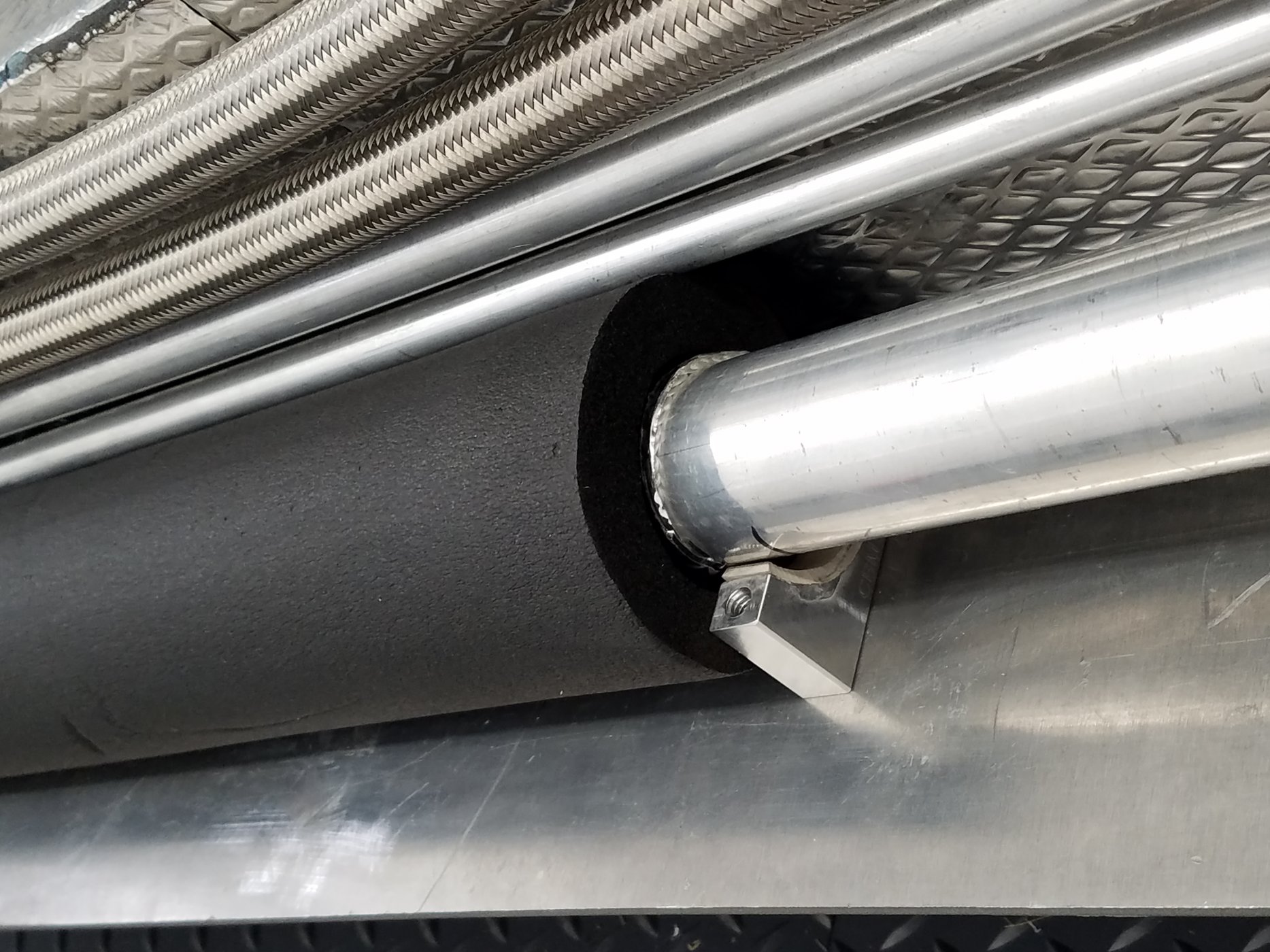

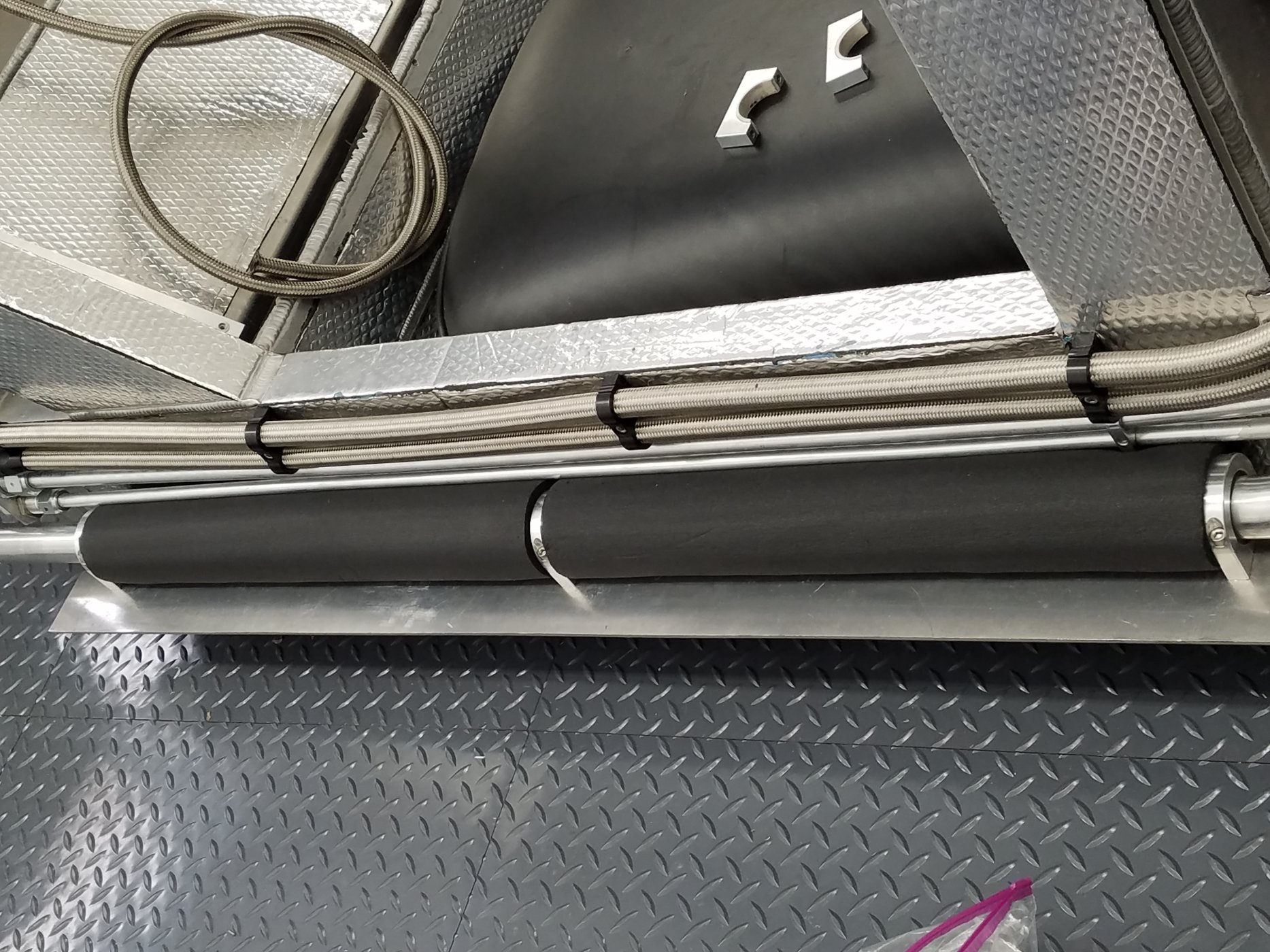

I finally decided on the insulation material for the coolant piping. Taking also into consideration weight savings, the idea of a surrounding enclosure from stainless or Aluminum was cancelled even if aesthetically more pleasing. A layered approach was chosen with reflective Aluminum coated fiberglass wrap as first heat reducing barrier, surrounded by a high R-Value closed cell foam to minimize heat radiation and to prevent condensation to be absorbed or to accumulate.

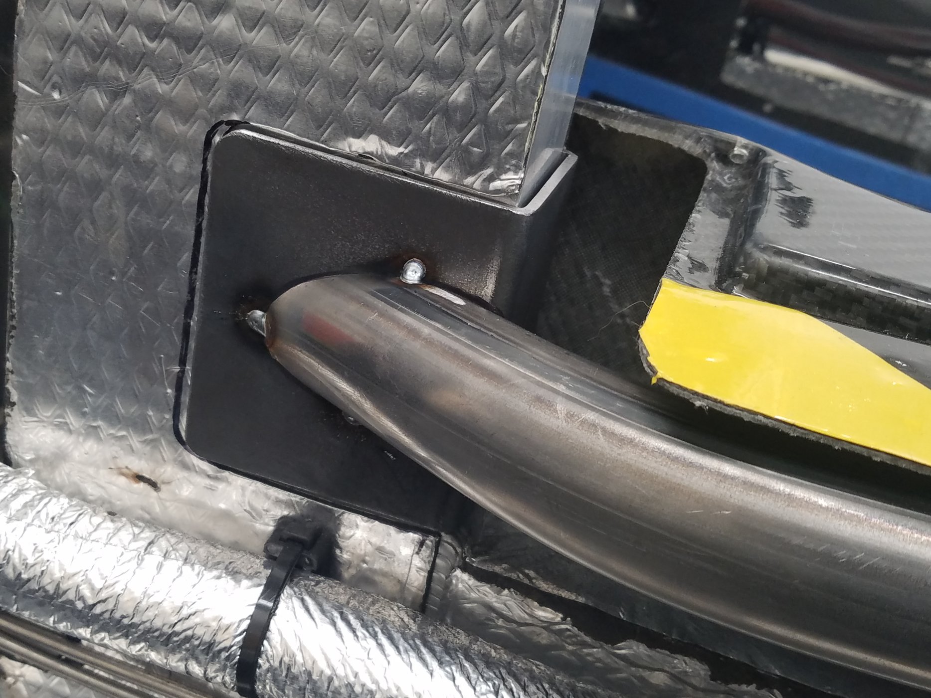

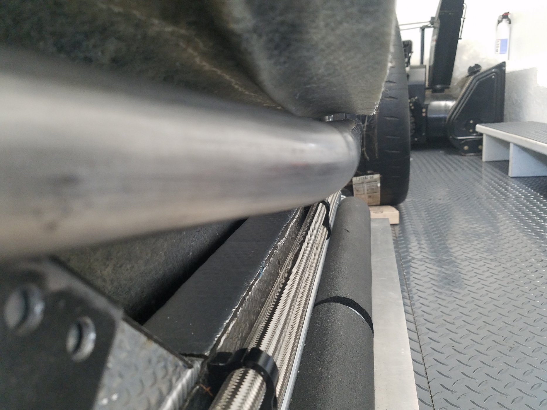

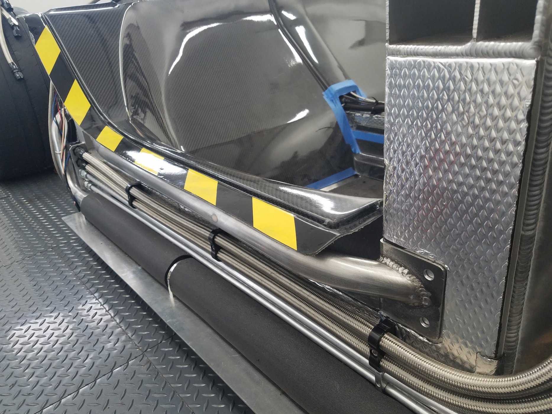

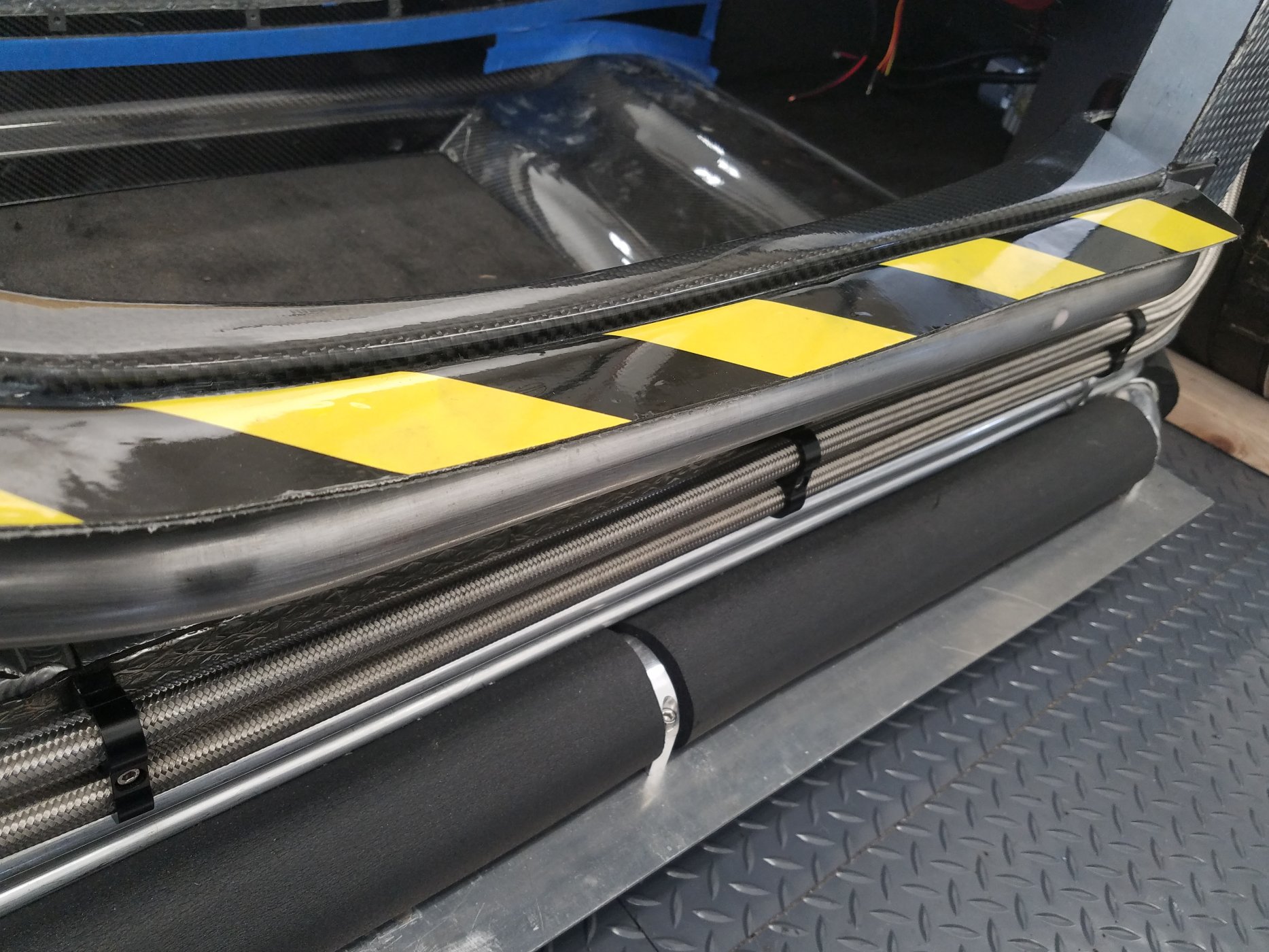

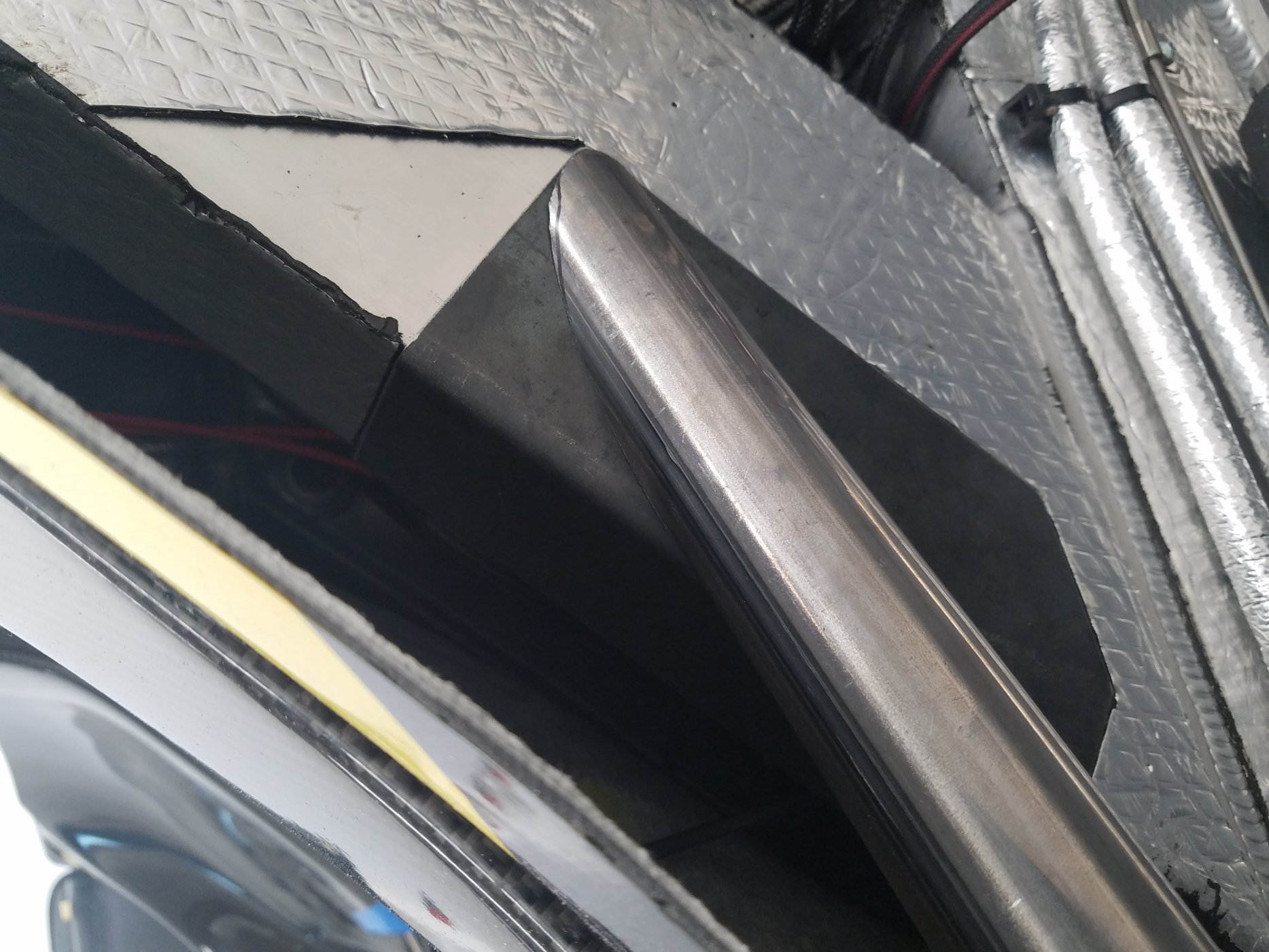

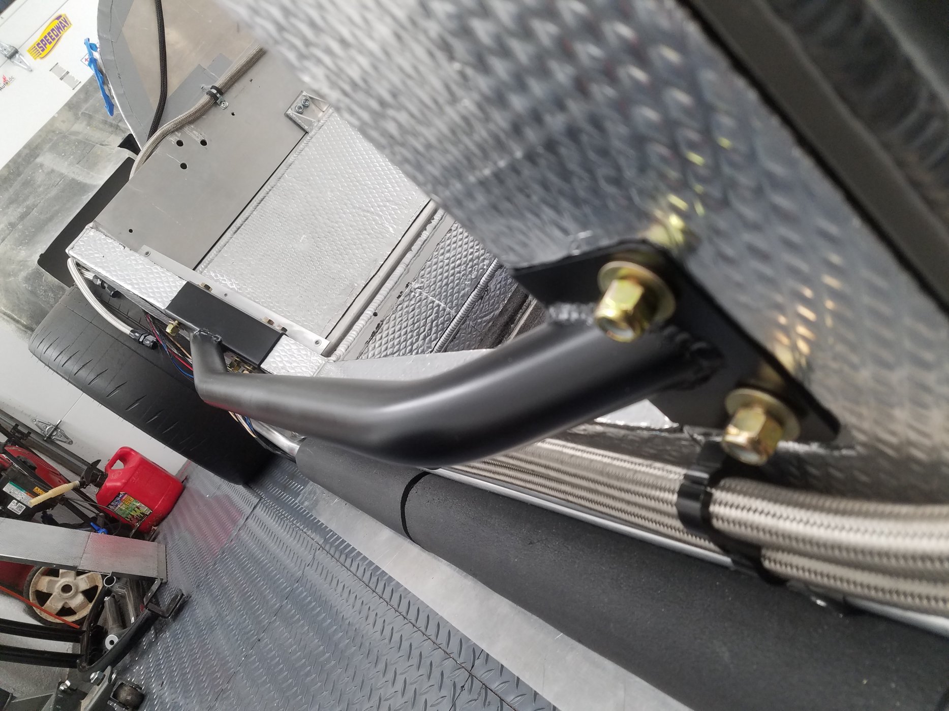

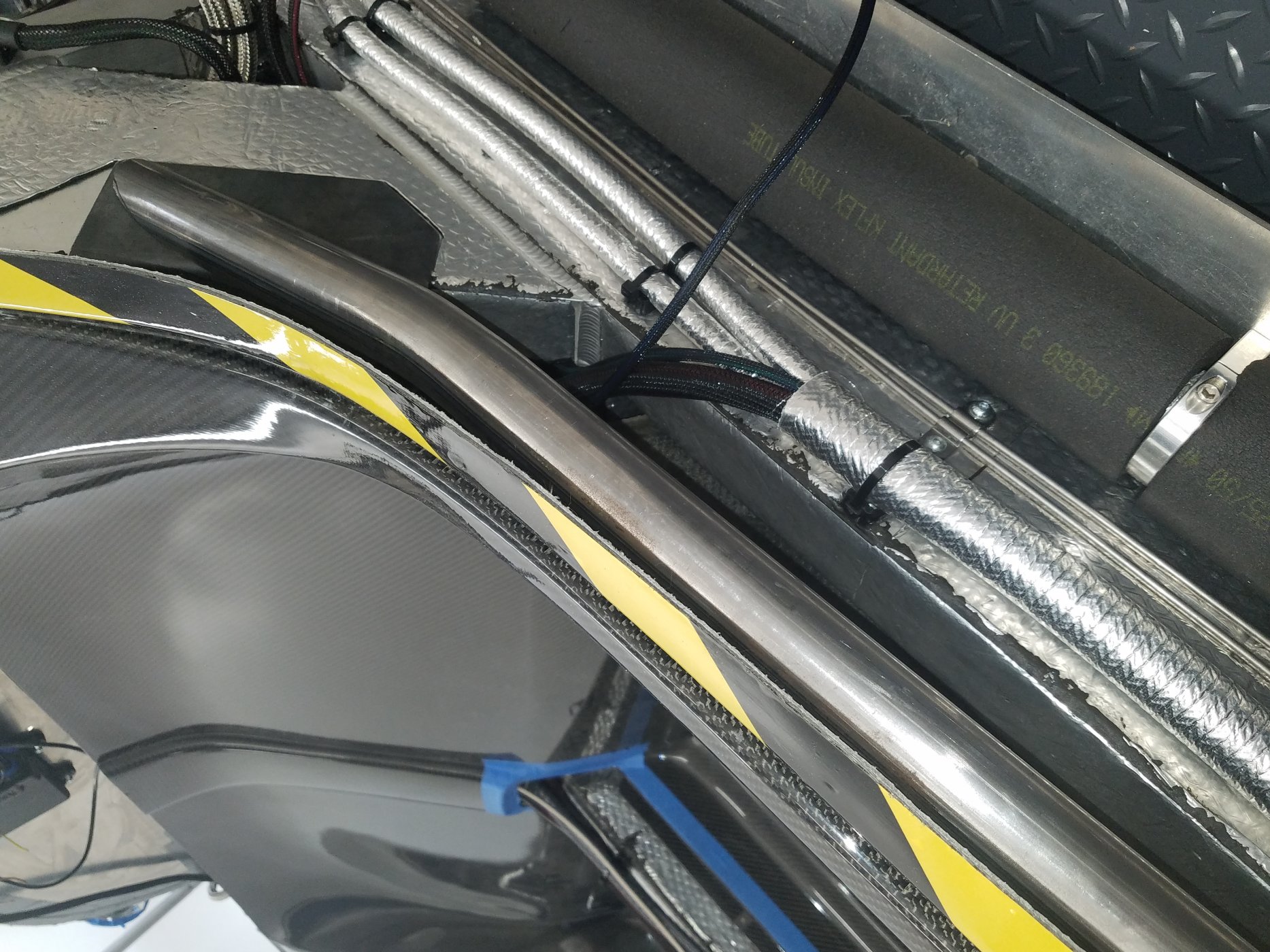

Was thinking on how to support the tub under the door section to prevent stress and noise from possible rubbing. Though that some added safety wouldn't be bad either. Here is my approach. Tub support side impact bars. When the tub is in final position, I'll make some matching spacers to bolt it down on the bars.

Joel K
Very nice Stephan, similar to what I have but they take up no room in the interior. I think I prefer your approach. The main difference being the ones I have are directly mounted/connected to the front and rear roll hoops.

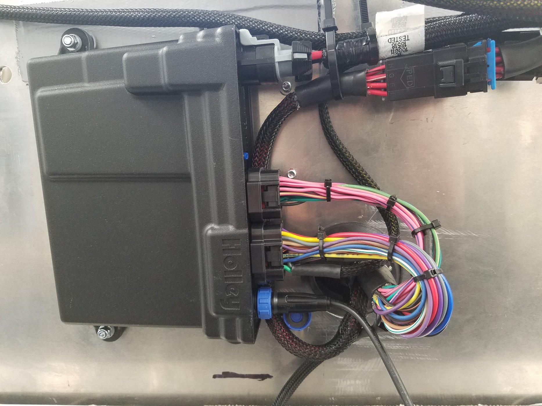

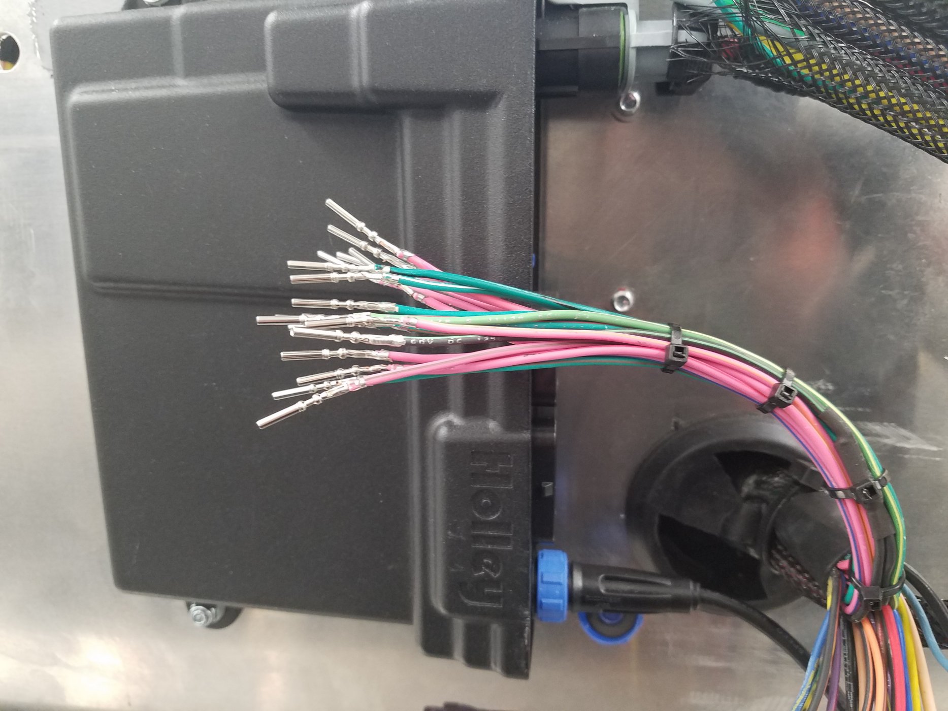

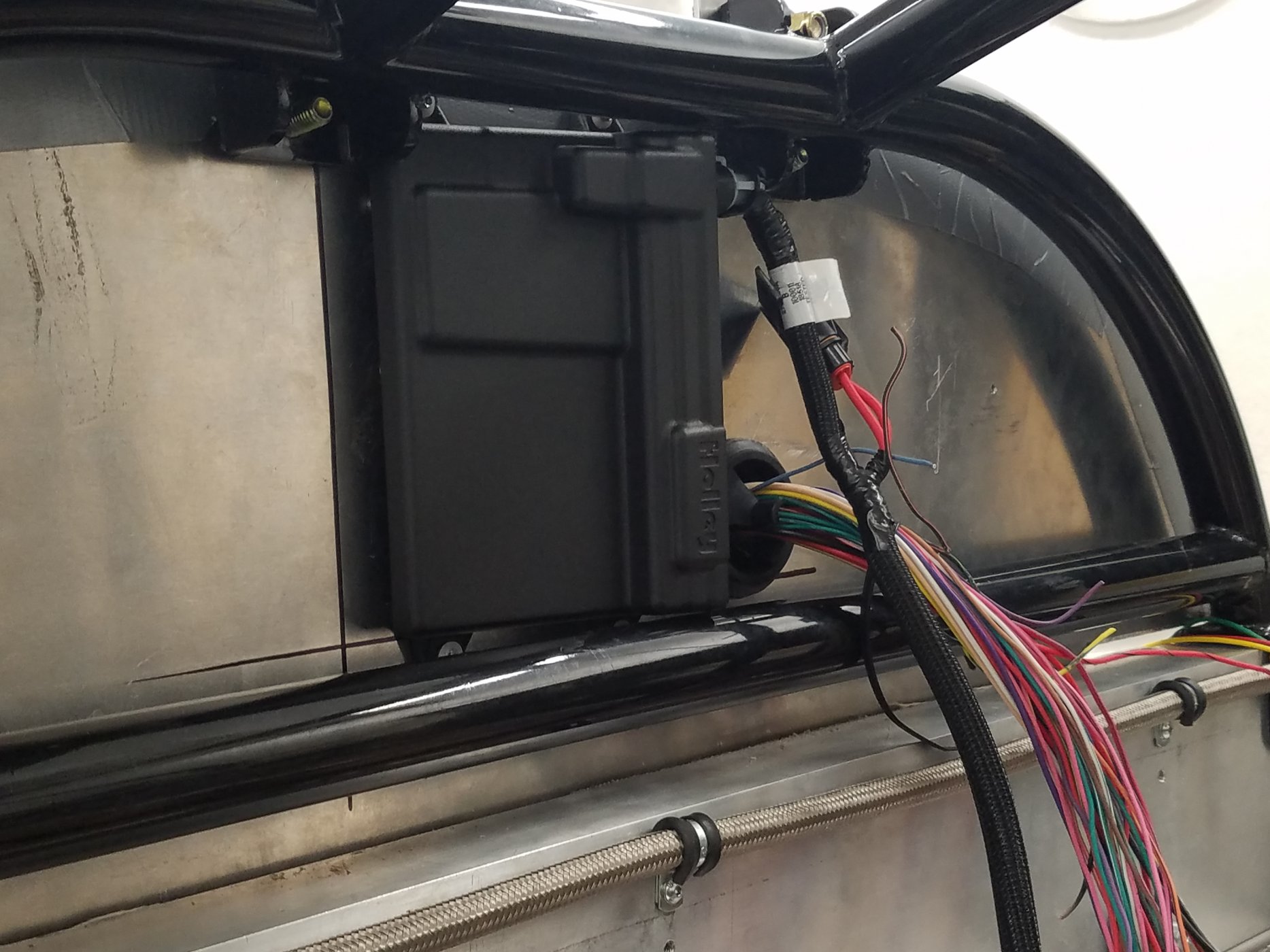

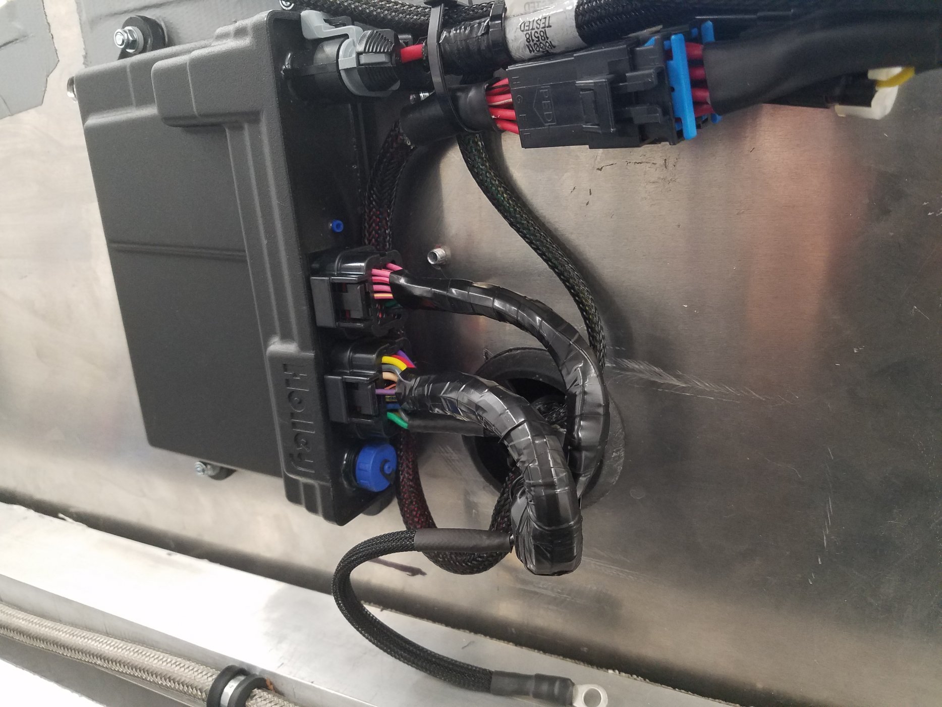

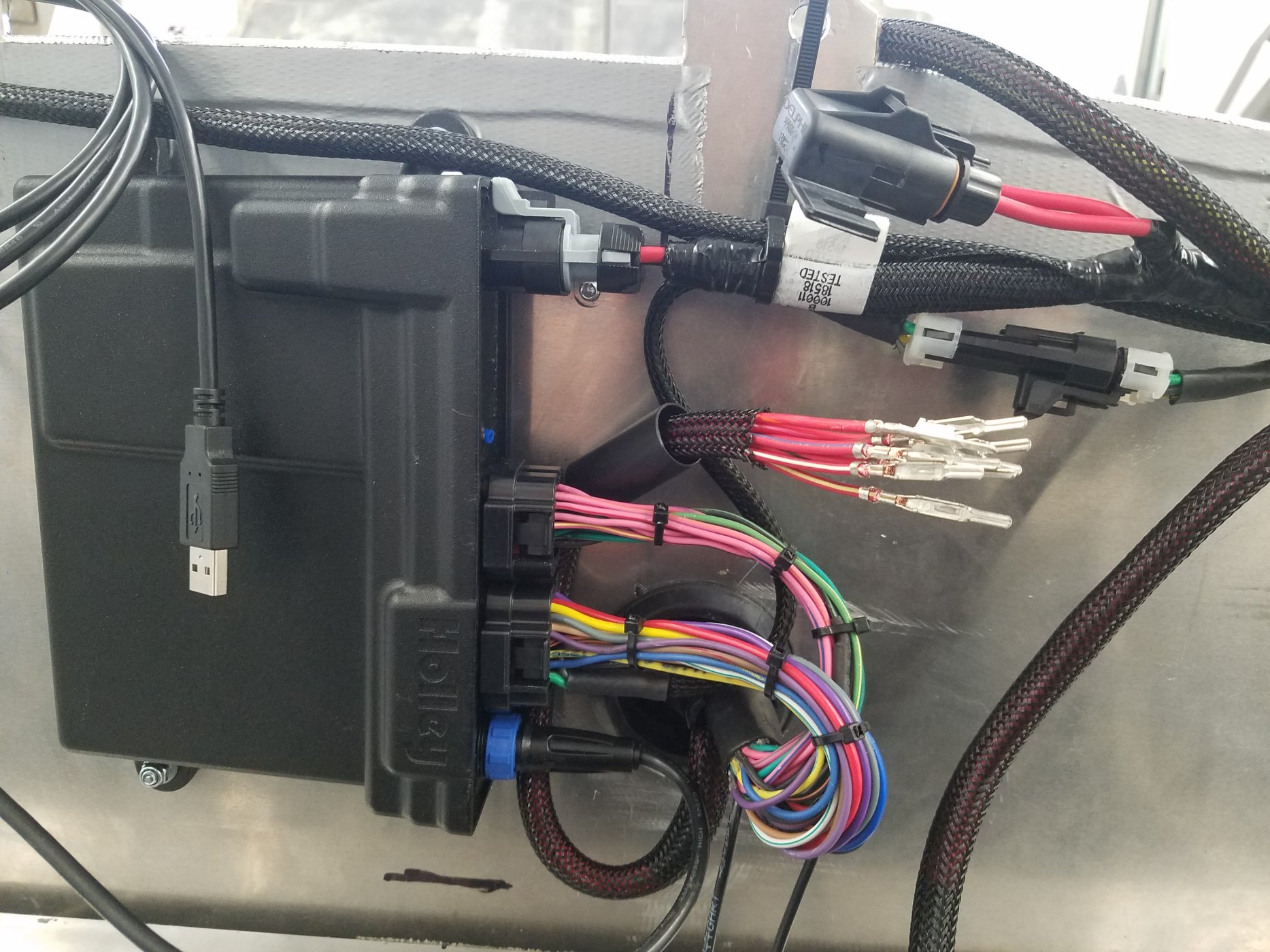

I was able to finish the ECU wiring today.
