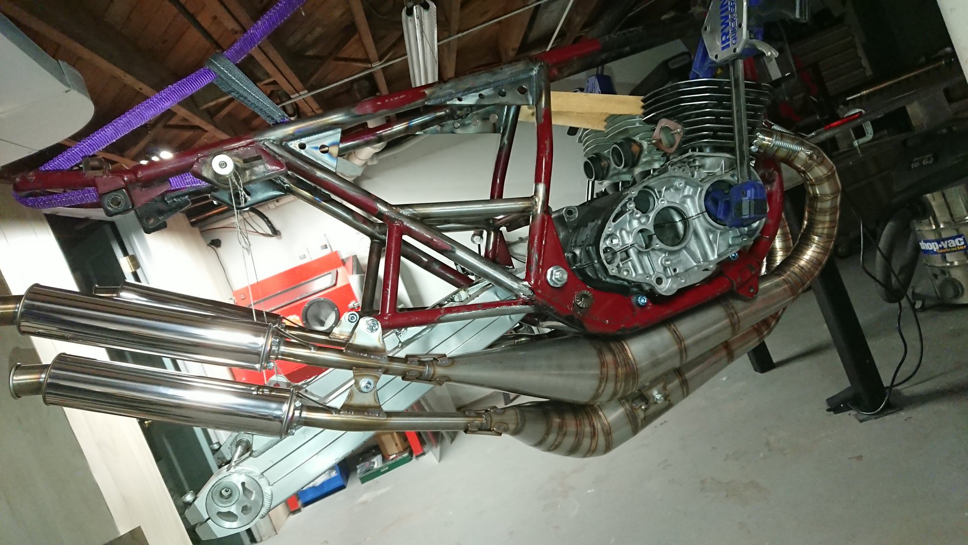

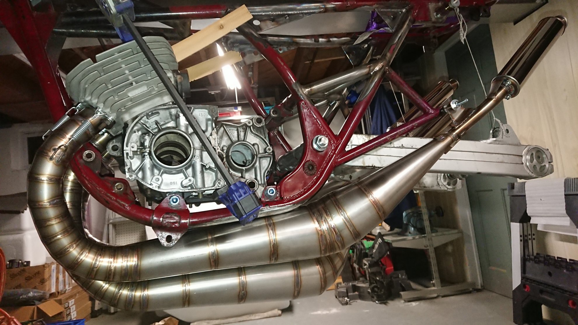

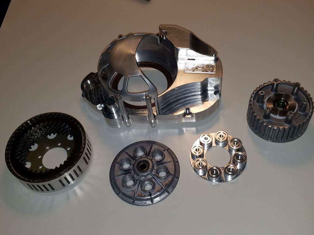

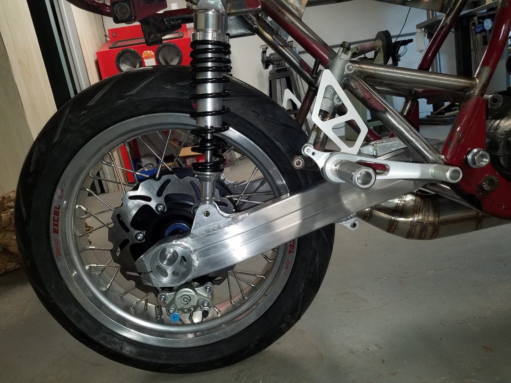

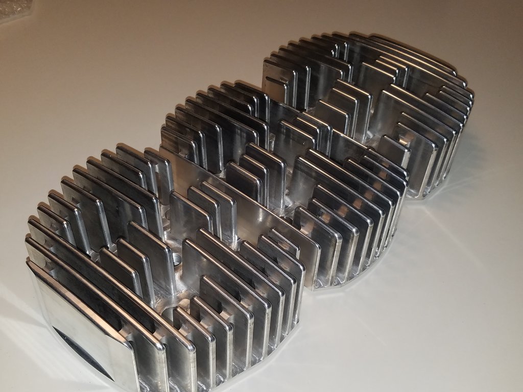

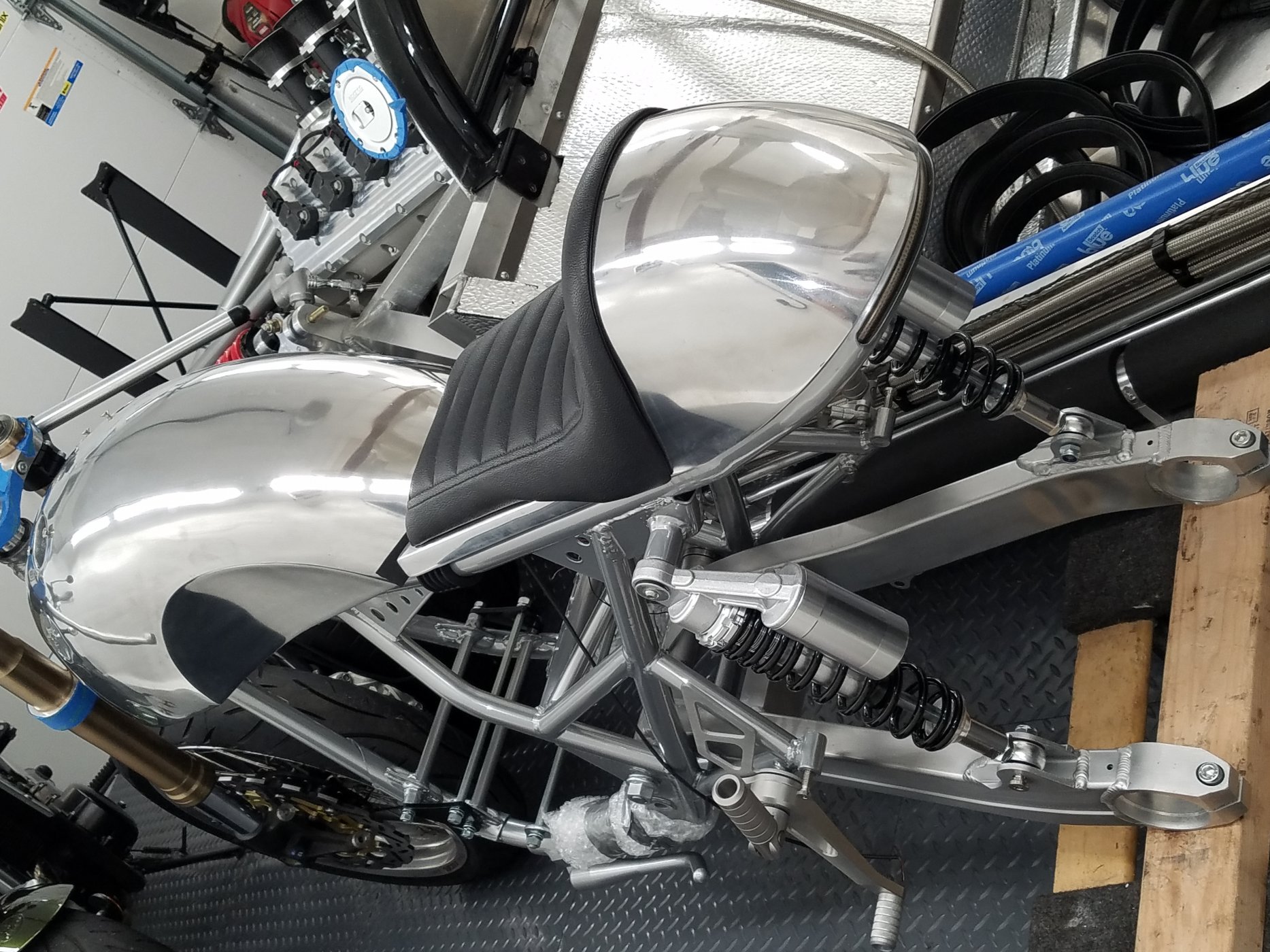

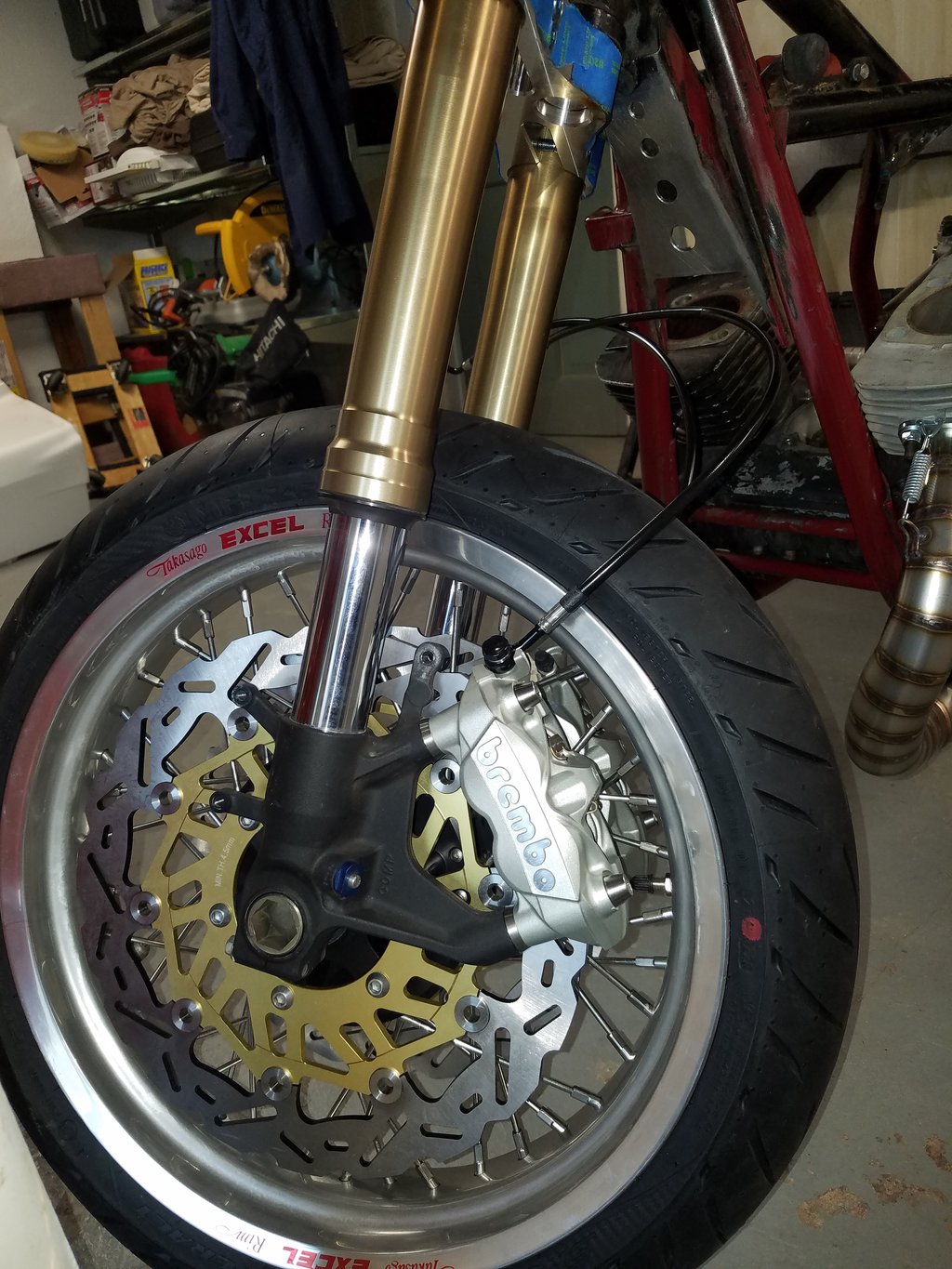

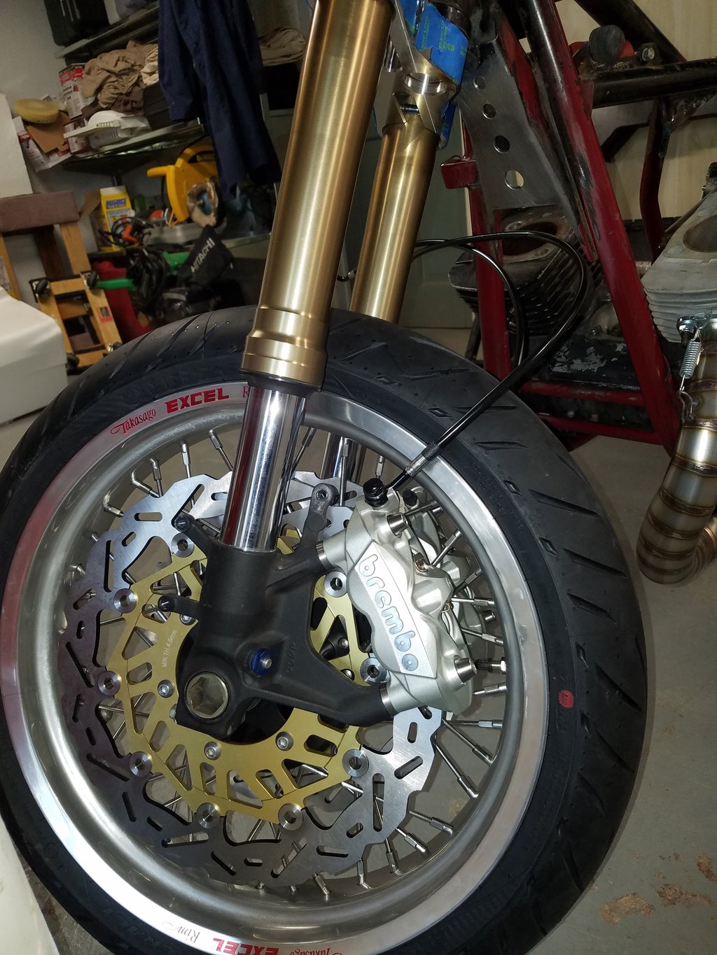

I have been SLC sober for 18 month know and not relapsed as of yet touching it. I have acquired some new parts and plan on getting back on it next week with some fresh ideas. I decided to take a long break to pursue a long lived dream on building a Bonneville speed record motorcycle. The project is reaching the final stages with the engine being build over the next few weeks and month by a famous builder. Frame, suspension, brakes, racing dry clutch, special chambered CNC billet heads, tuned exhaust, wheels, with hand hammered tank, seat and fairing from aluminum etc. all custom build and CNC machined to handle the required top speed, new doubled engine output and braking power. Base bike was 1972 Kawasaki H2 750CC 2 two stroke (AKA, the Widow Maker). For some fun, early pictures of the project mockup. It is painted, partially assembled and much further along now... Hoping that I am not stepping on anyone posting this.

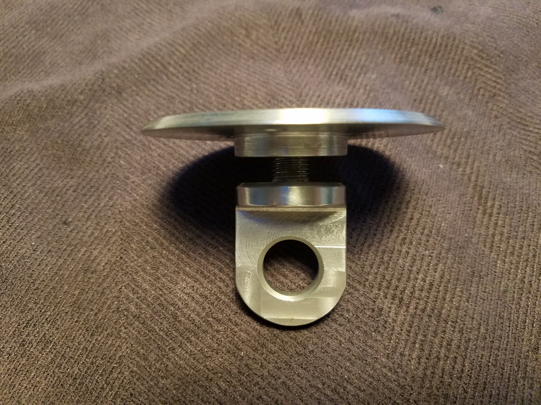

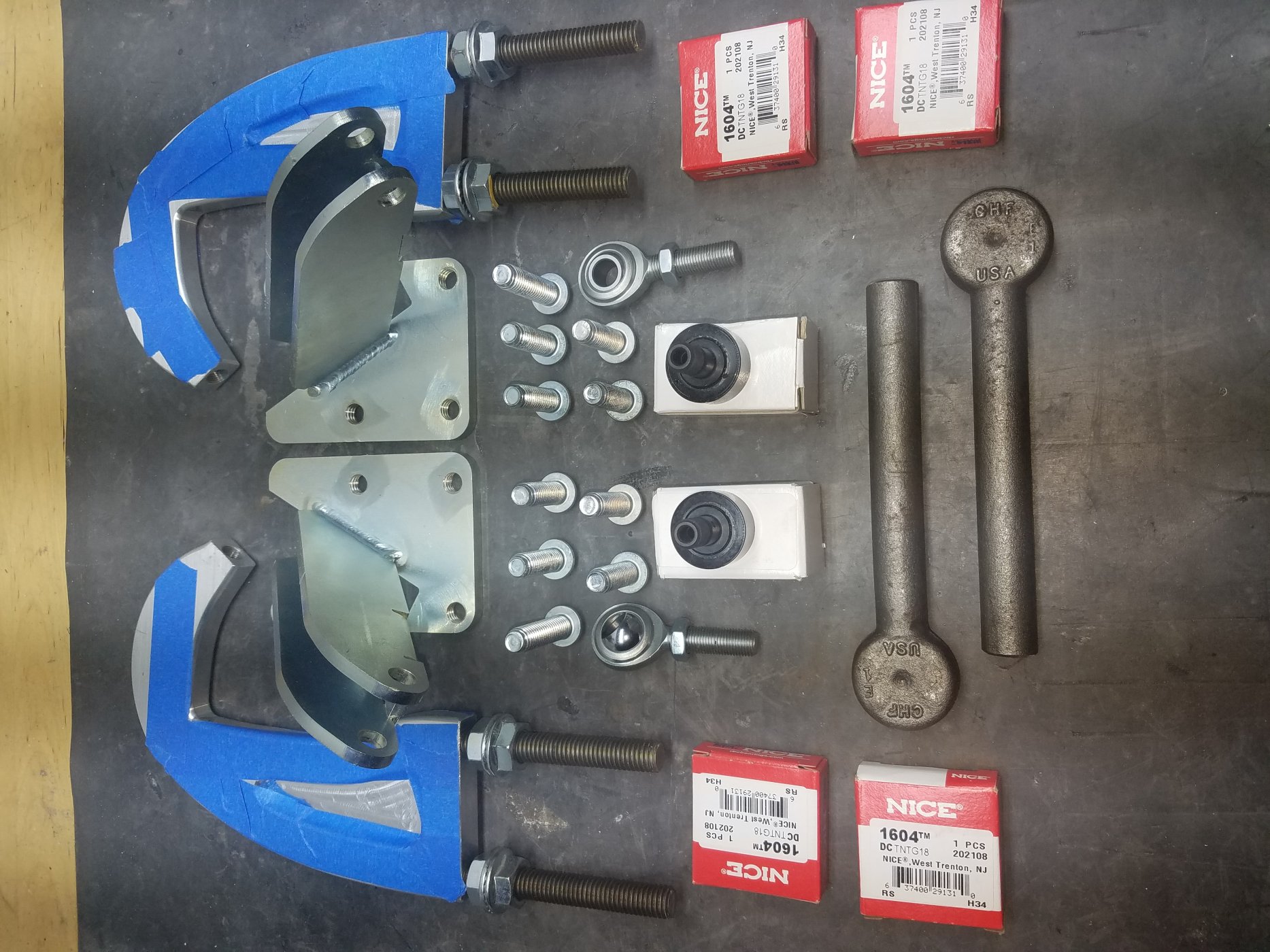

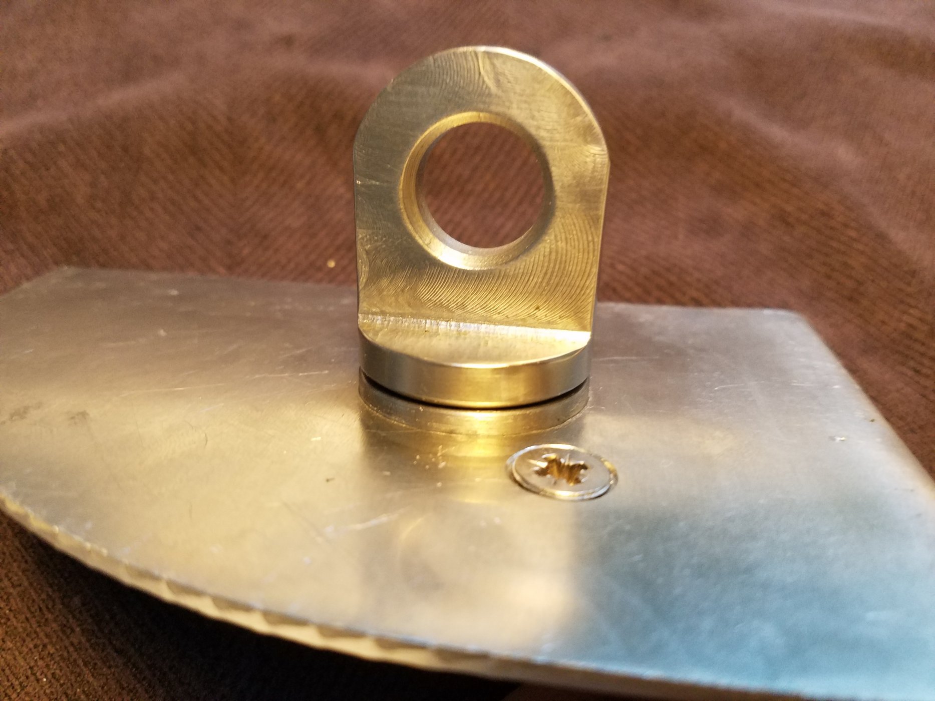

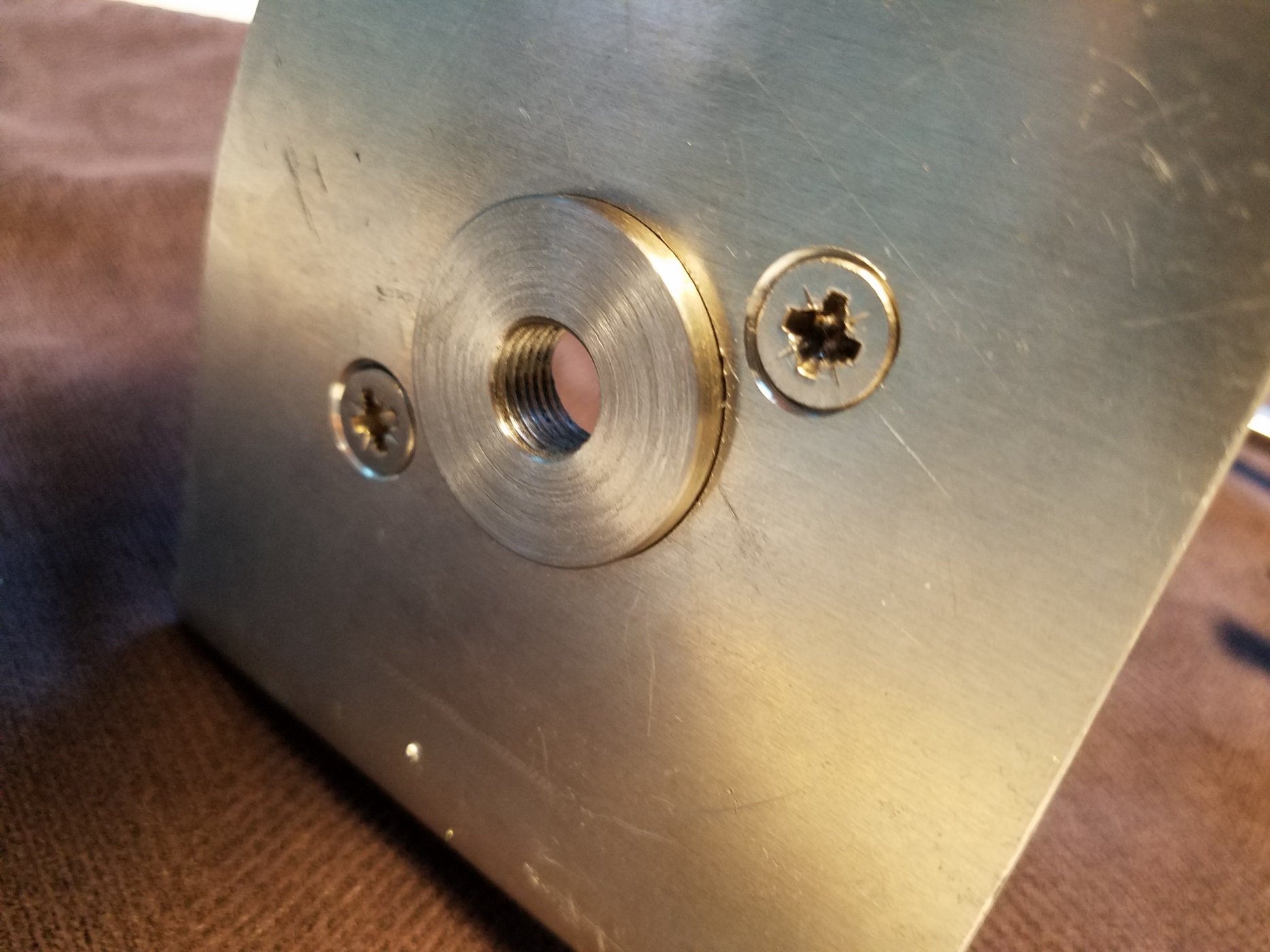

I am currently experimenting with my own racing harness floor anchors and backing plates. Could not find anything I liked on the market, so I make them myself. This is the prototype, should be close to final version. Special version for cars with low ground clearance. Fresh off the lathe and milling machine.

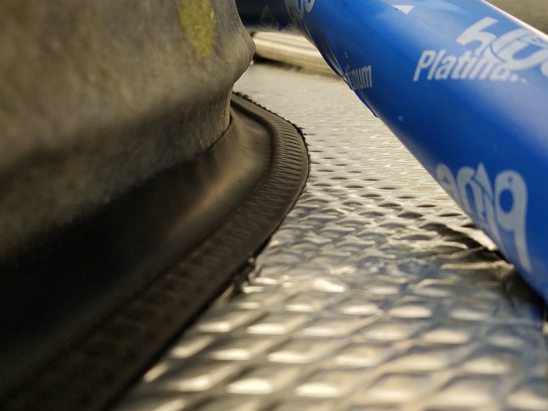

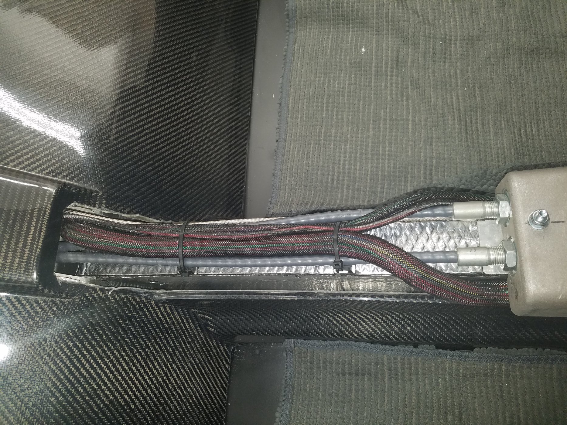

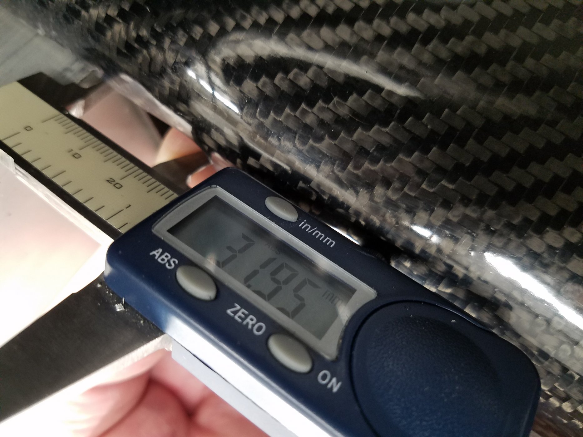

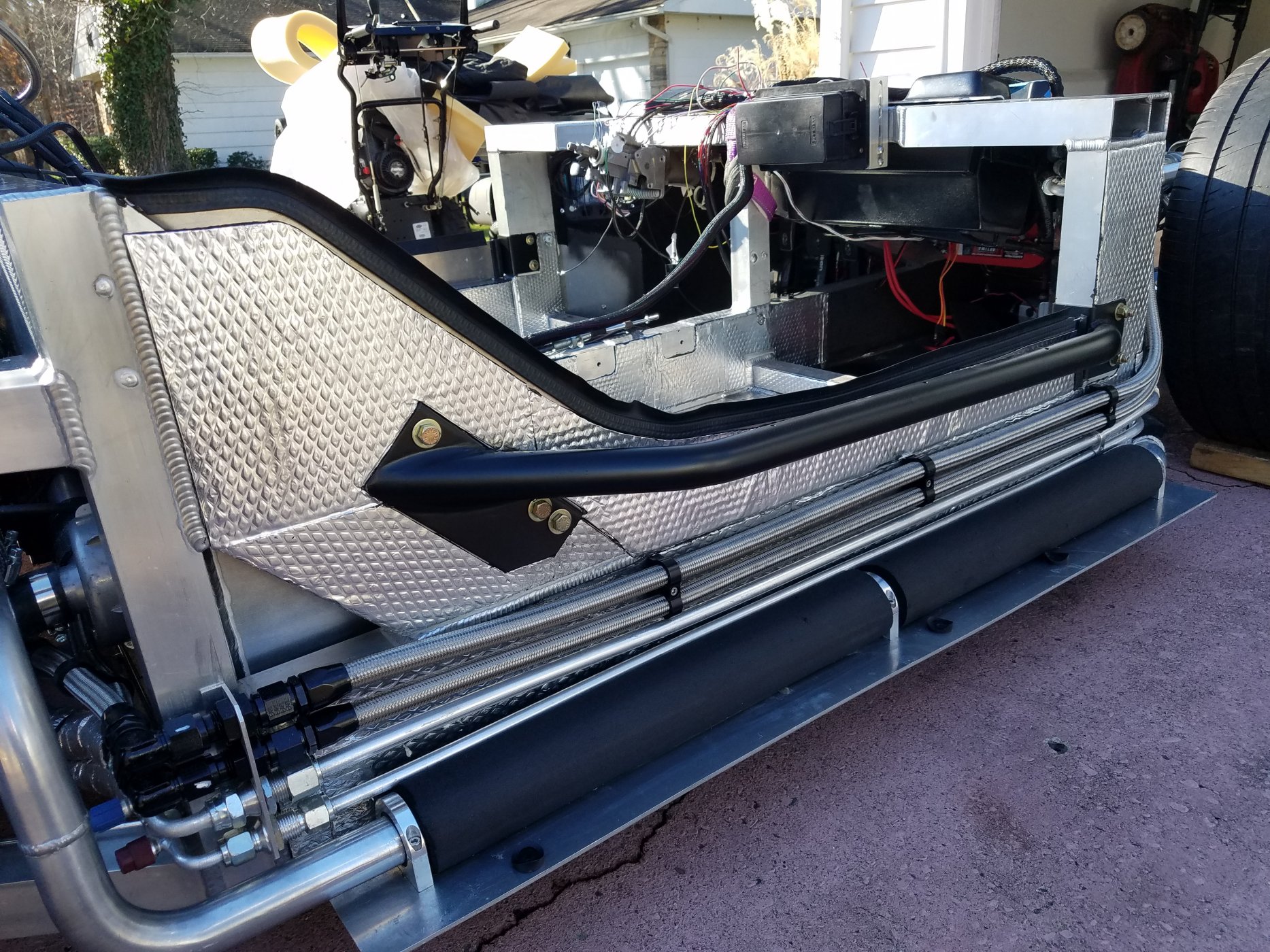

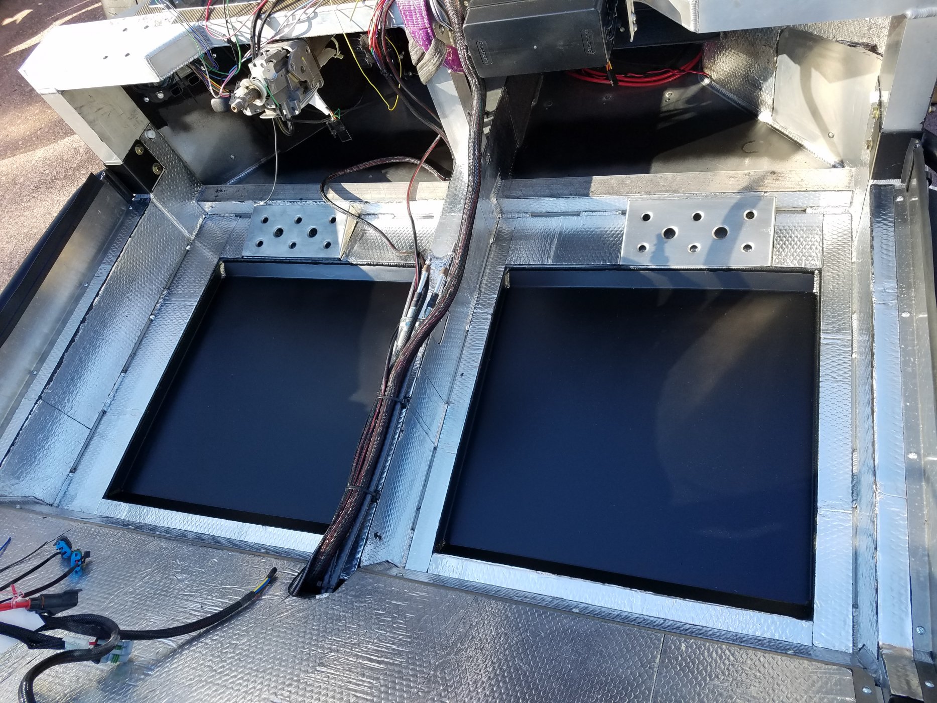

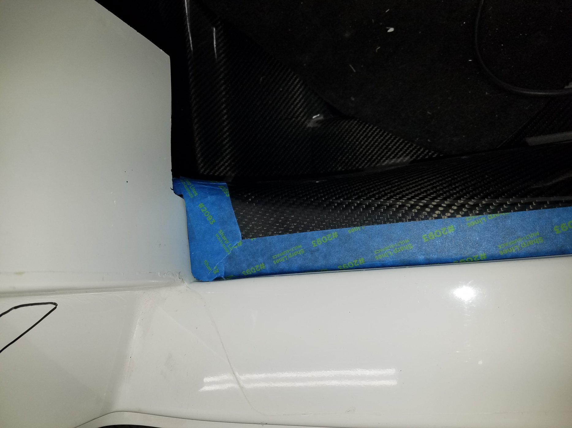

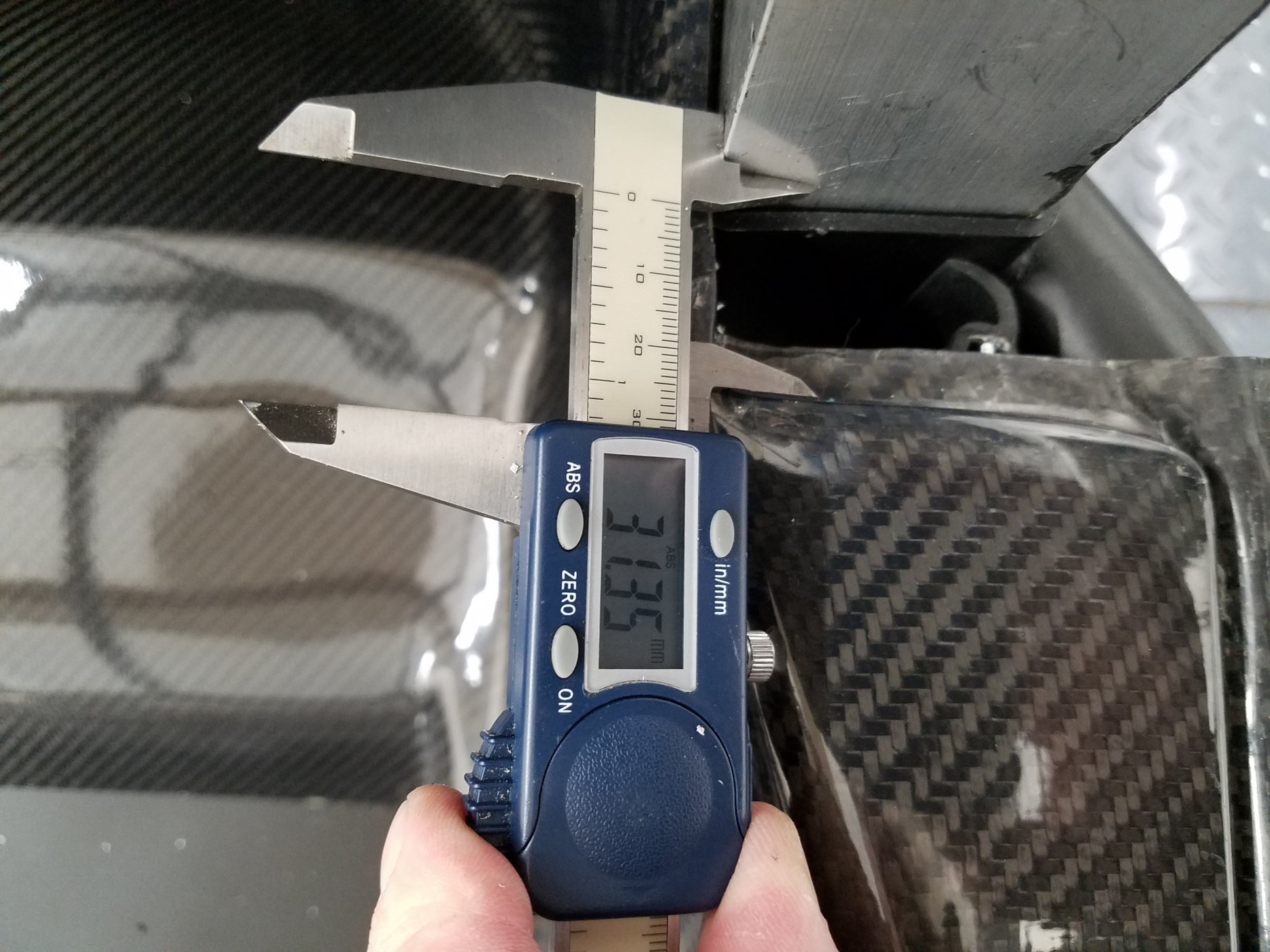

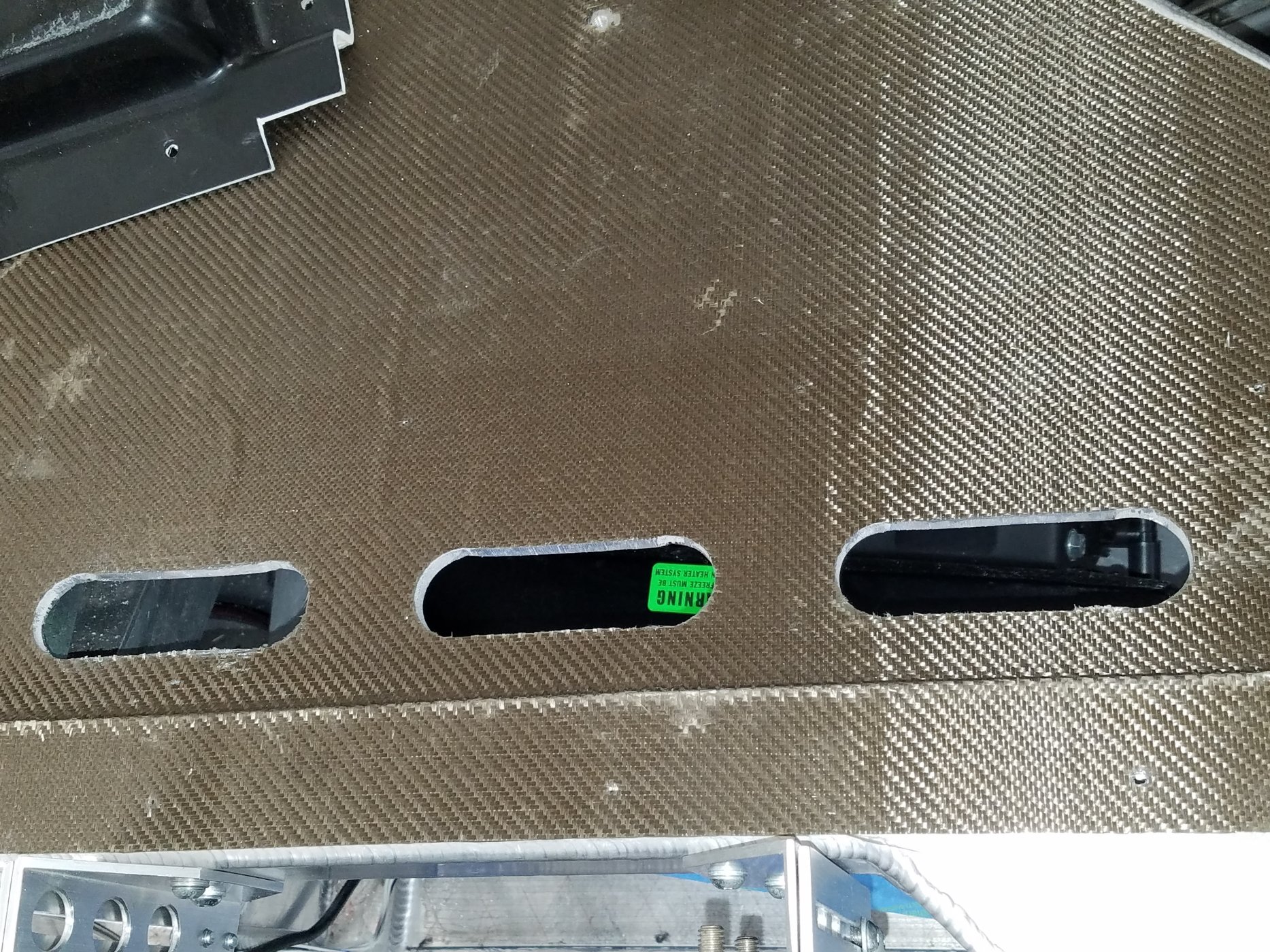

I was going back and forth between the race bike and the SLC. The bike is on hold now until the engine is done in February. Back on the SLC, I enlarged the holes for the air conditioning to increase flow and started to fit the tub to fabricate the close outs. The chose a lip seal instead of a bulb seal since my tub is mainly supported by the side impact bars and not the closeout panels. It beautifully follows the contour of the tub and is creating a good seal. The tub is within 0.6mm at the front pillars and requires only two screws in the footwell to sit in place.

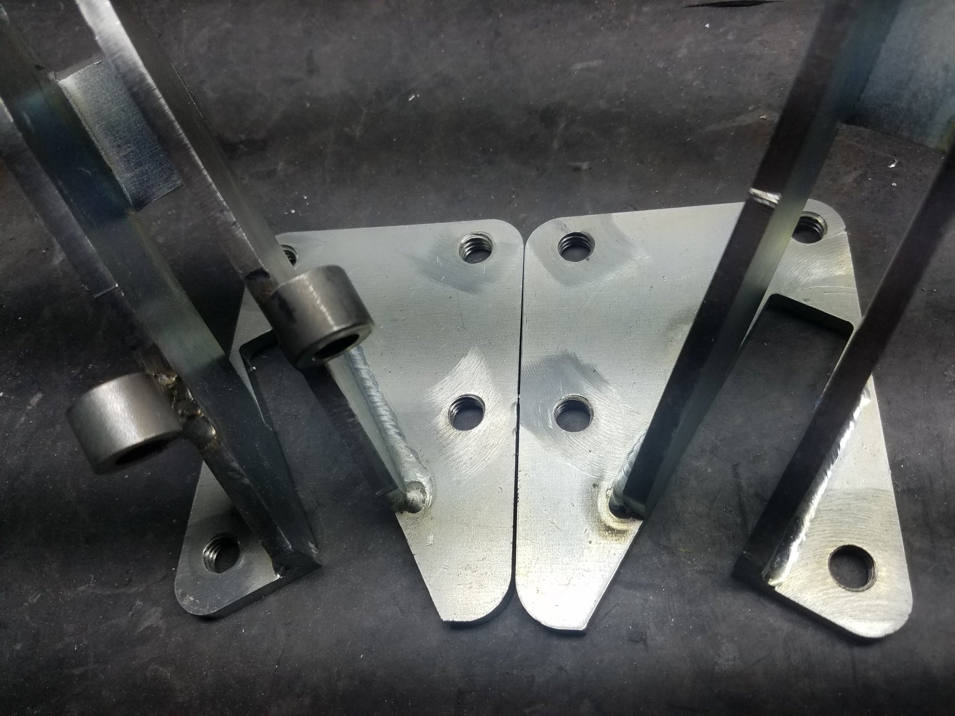

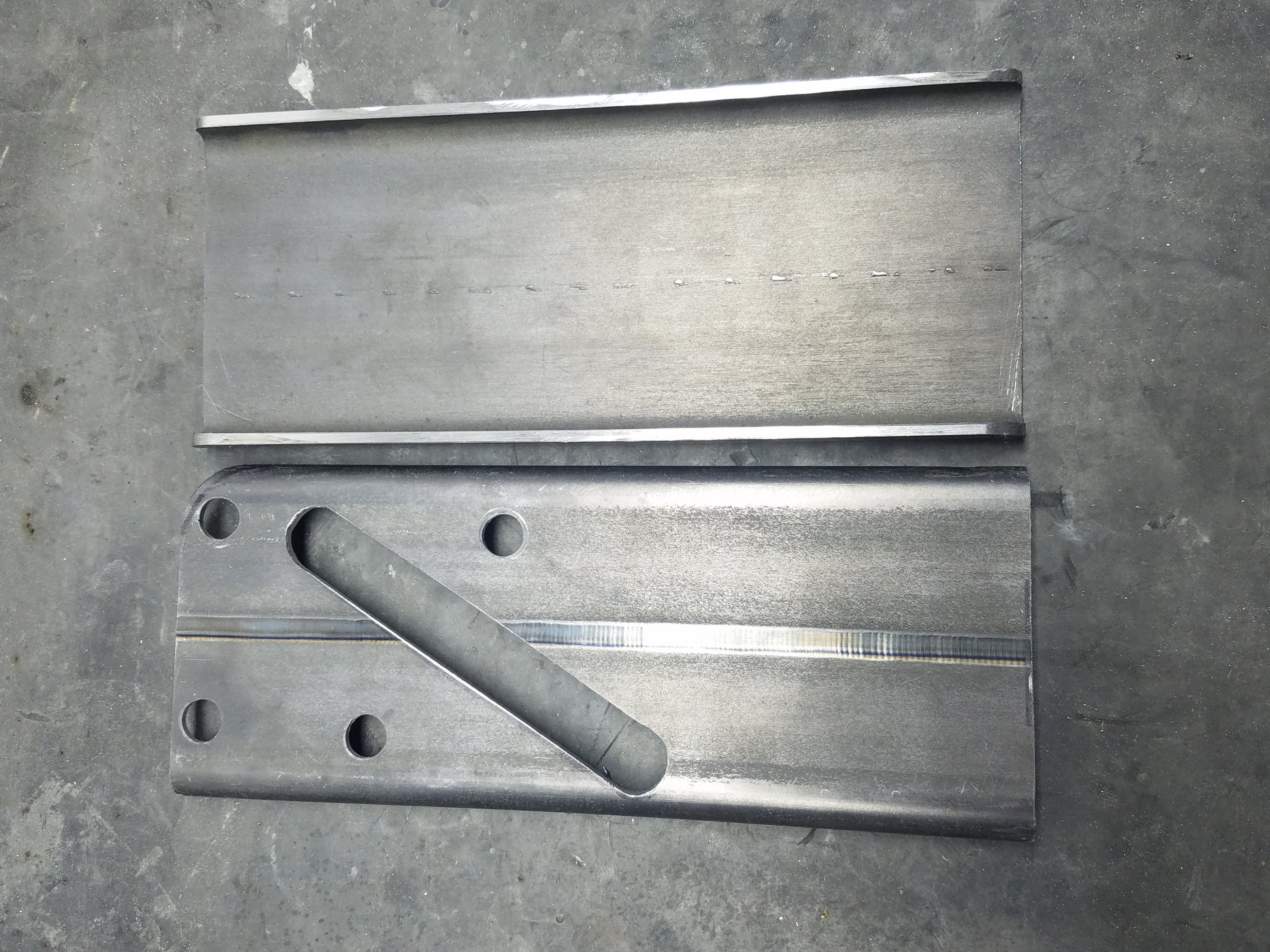

Getting ready to drop the tub in for good. During test fitment with seats I noticed a deflection in the tub area of the seat front depending on where you put your foot to get into the seat. To prevent the tub from cracking and fatigue from stress, I fabricated these dimpled light weight supports.

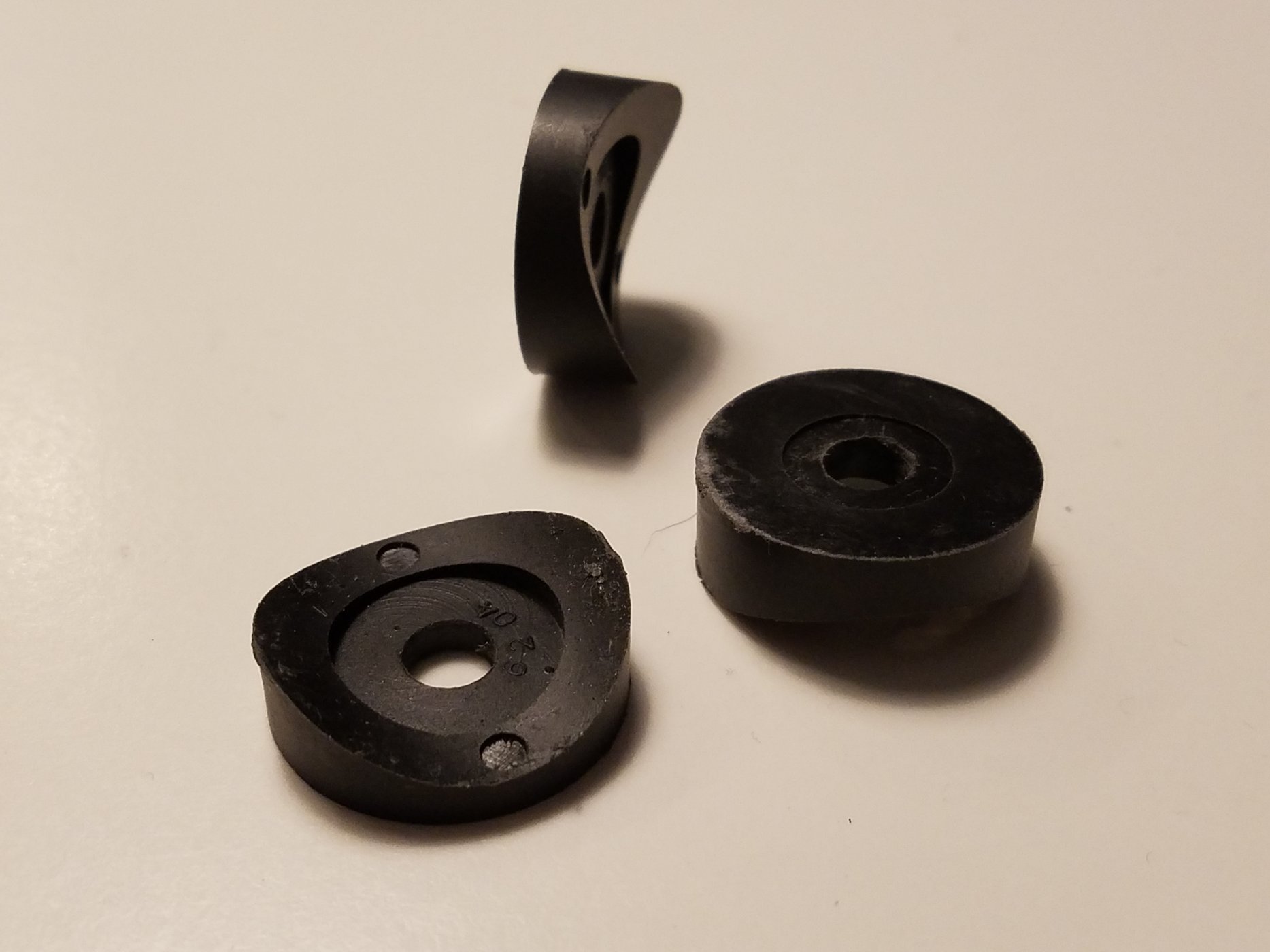

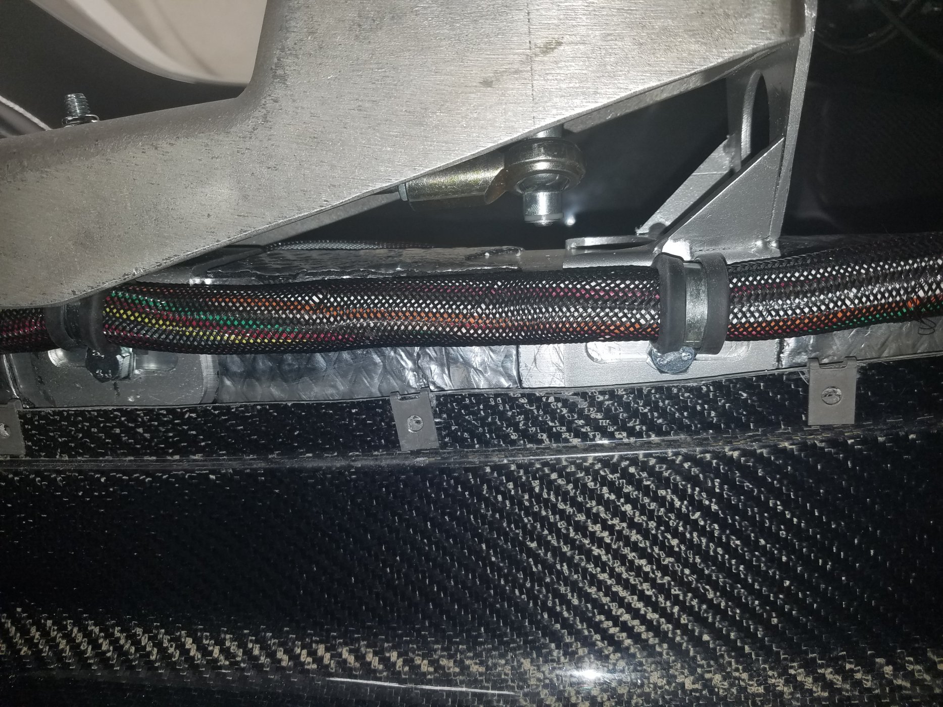

The tub and roll cage are in and the body lowered from its suspended Hypersleep from under the ceiling. Initial fitment and measurements are positive. Followed Alan's video to do the cutouts which turned out nicely I think (well my first ones). Still some work to do but so far the important spots I can get it within 2mm, measured from the frame. Let's see what goes down when the body is locked down to the floor. The tub is resting on the side impact bars which received these saddle washers with 1.5" ID radius to match the tubing used. With a large rubber washer, a squeal and squeak free installation.

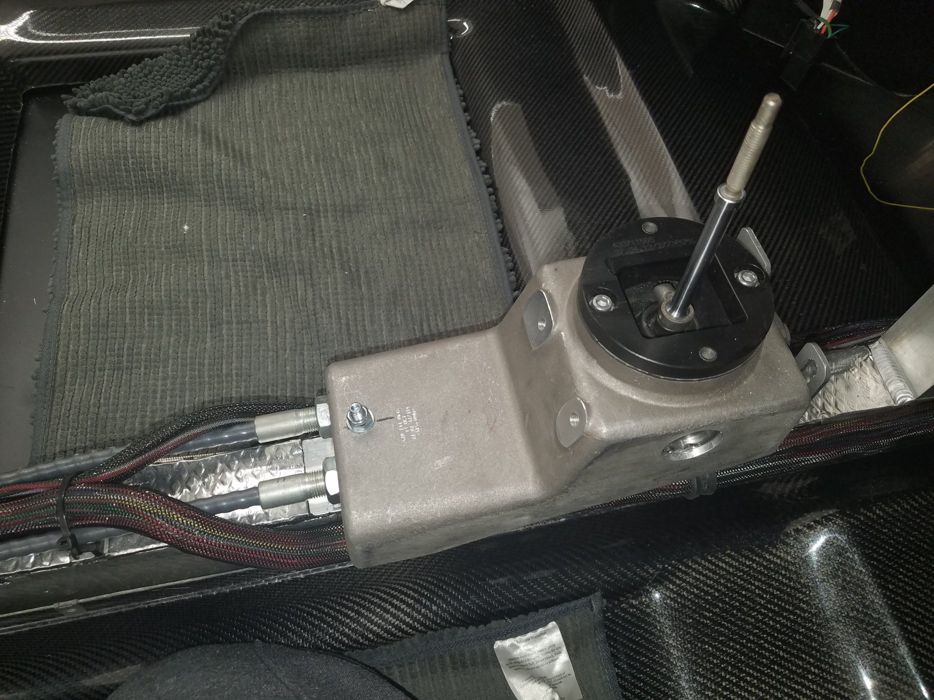

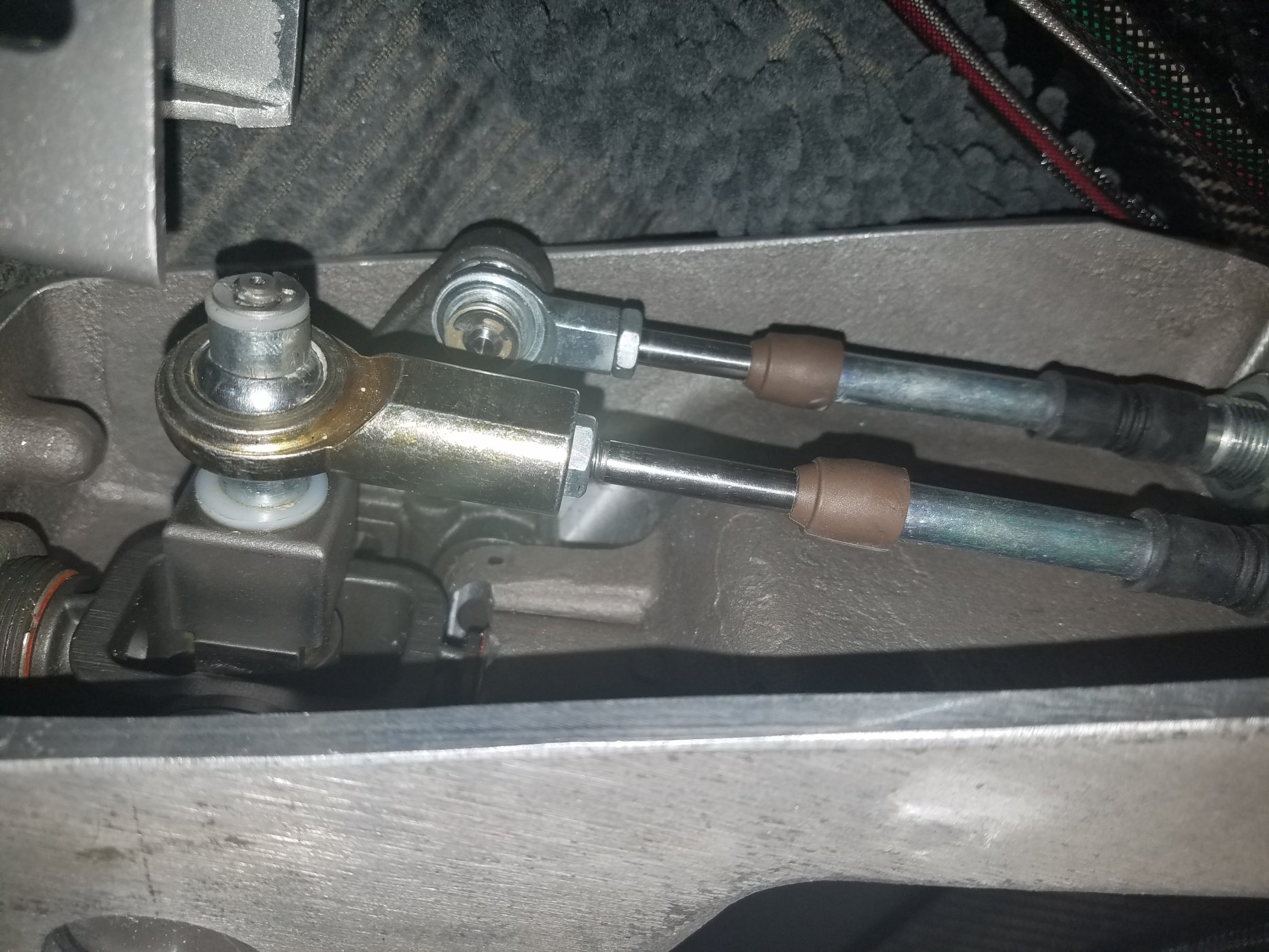

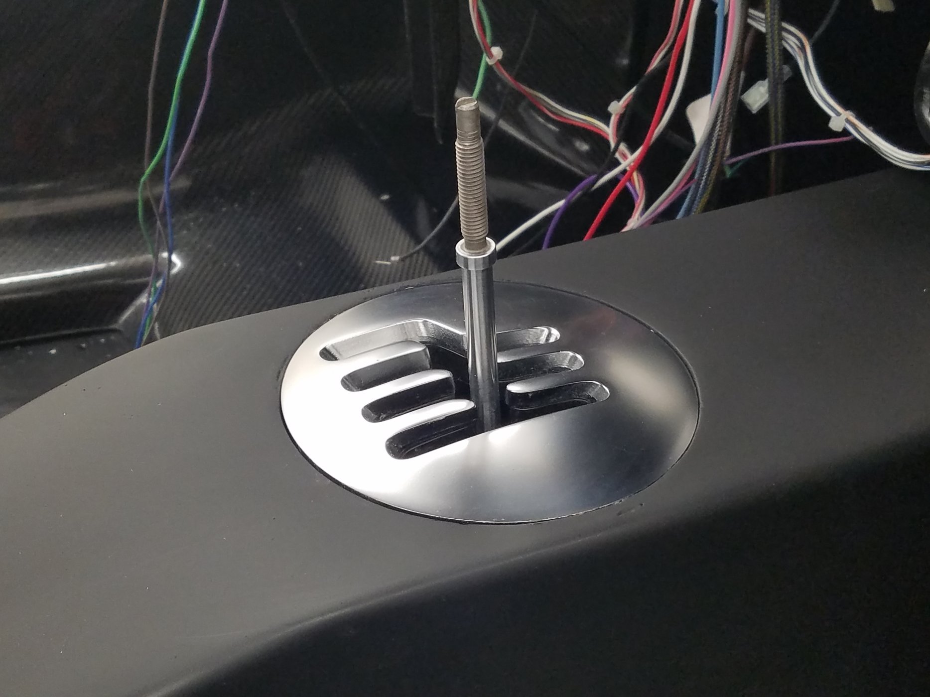

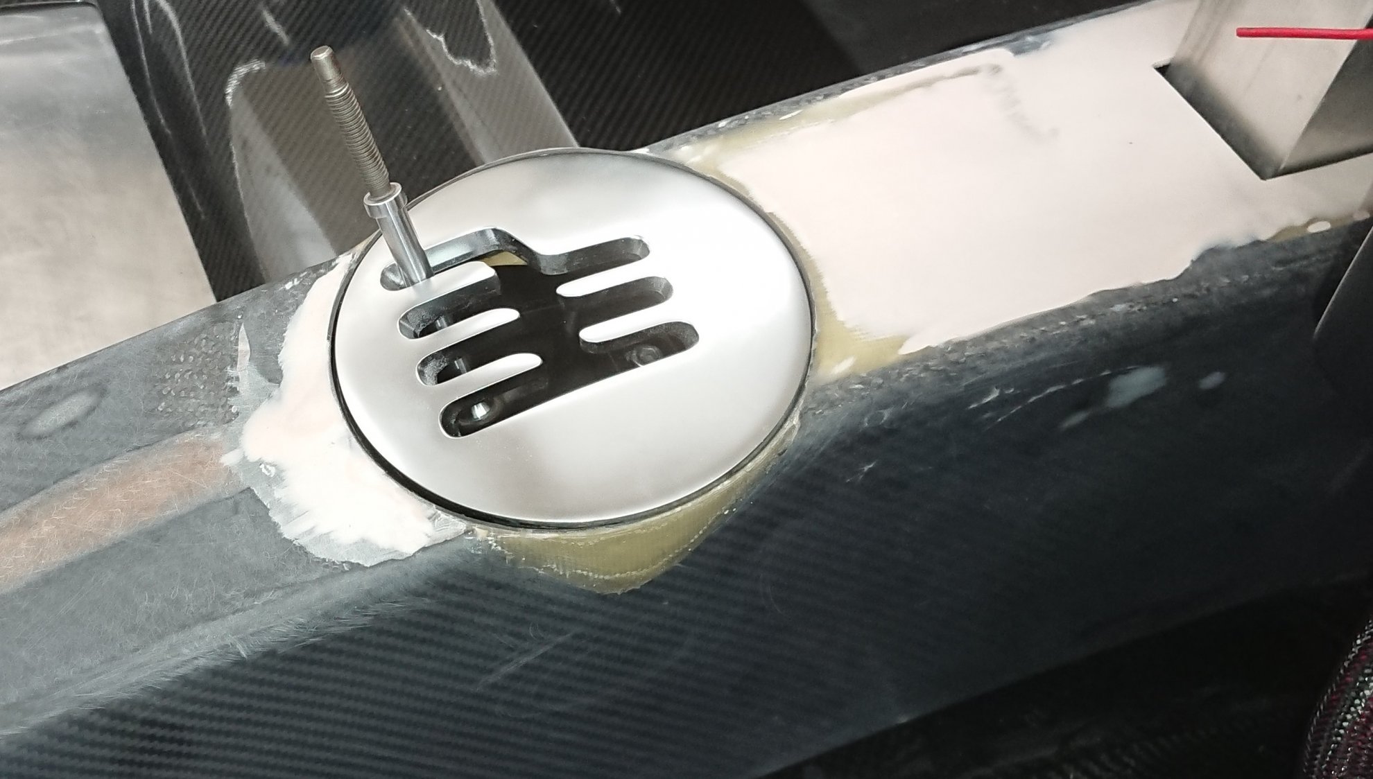

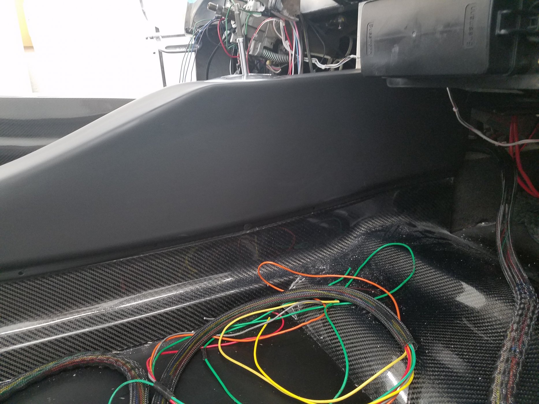

Installed the Audi R8 shifter in its final place and locked it in with the original center console which I am not certain will remain or be replaced with a completely different design. Time will tell..

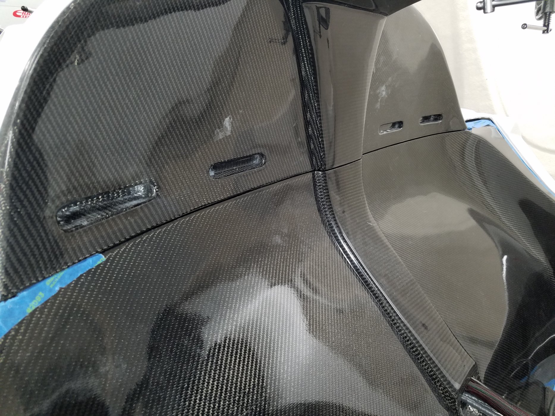

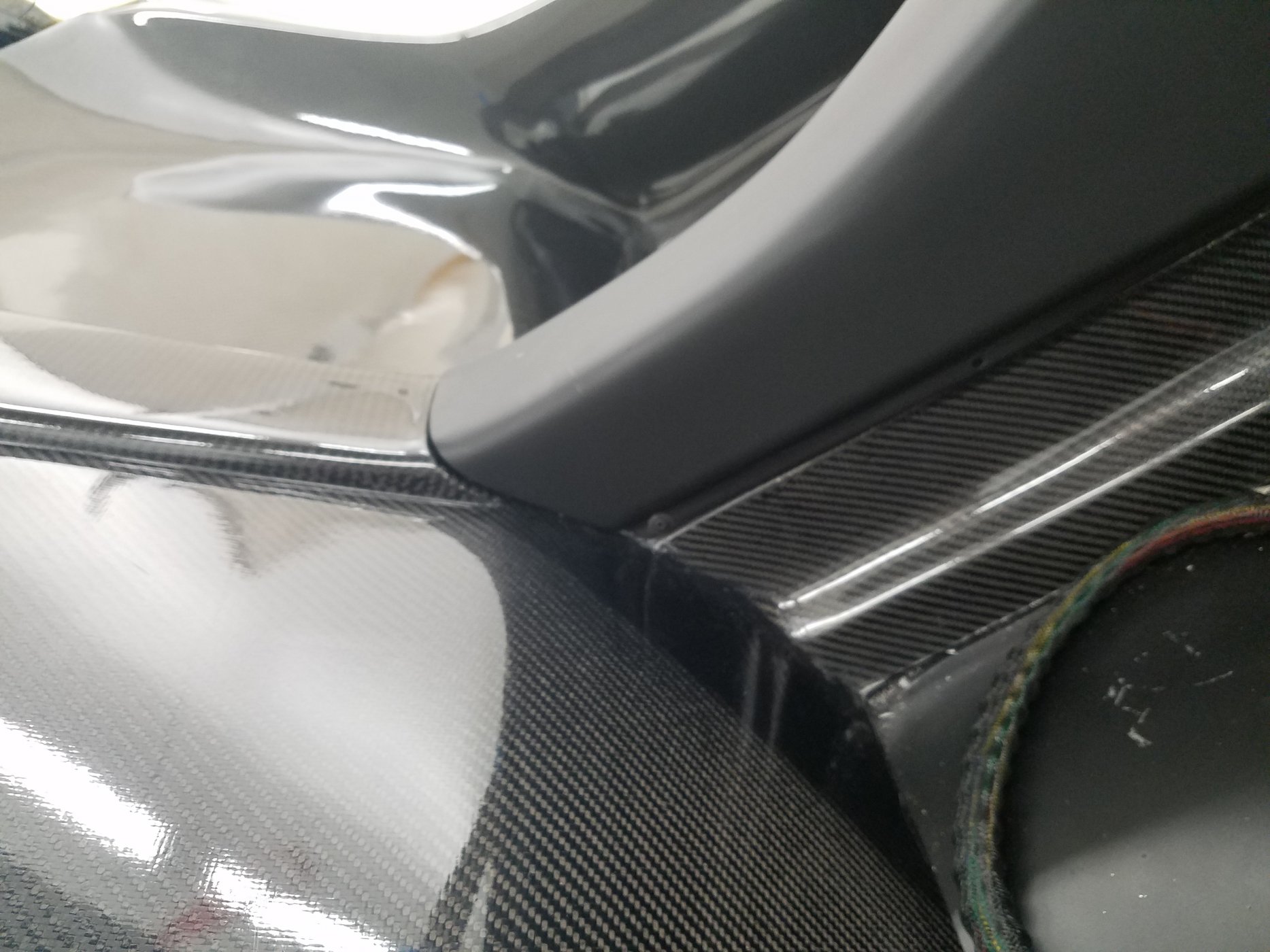

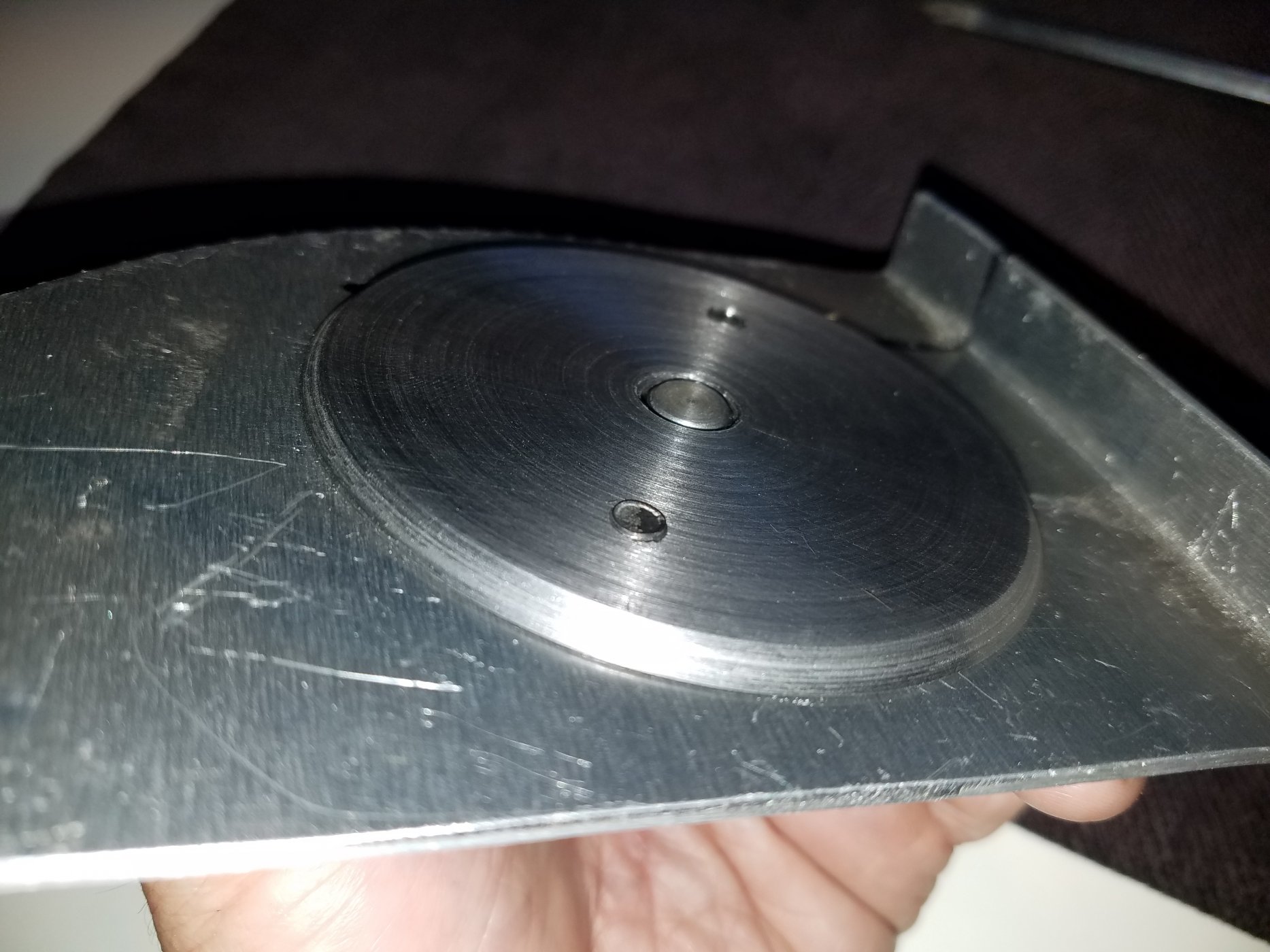

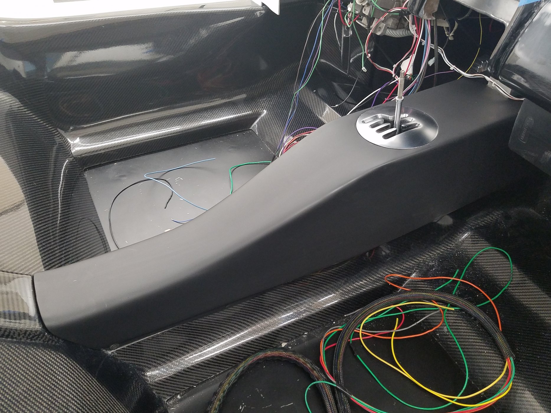

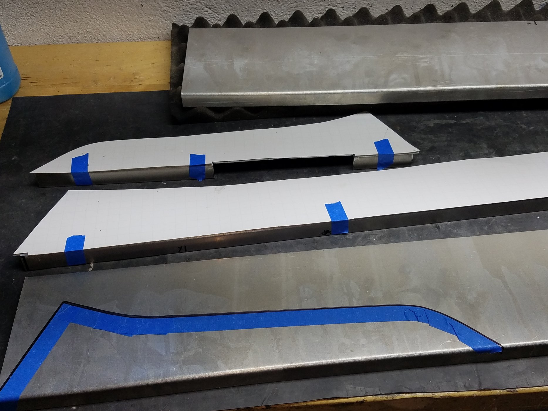

I have modified the center console to a little wider version. I feel that the new design is aesthetically more pleasing and will form later a nicer transition to the dash. It is still on the backbone of original narrow console to give me as much space as possible to keep the seats close to center.

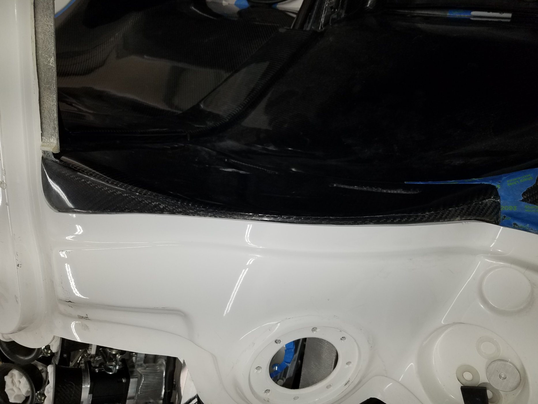

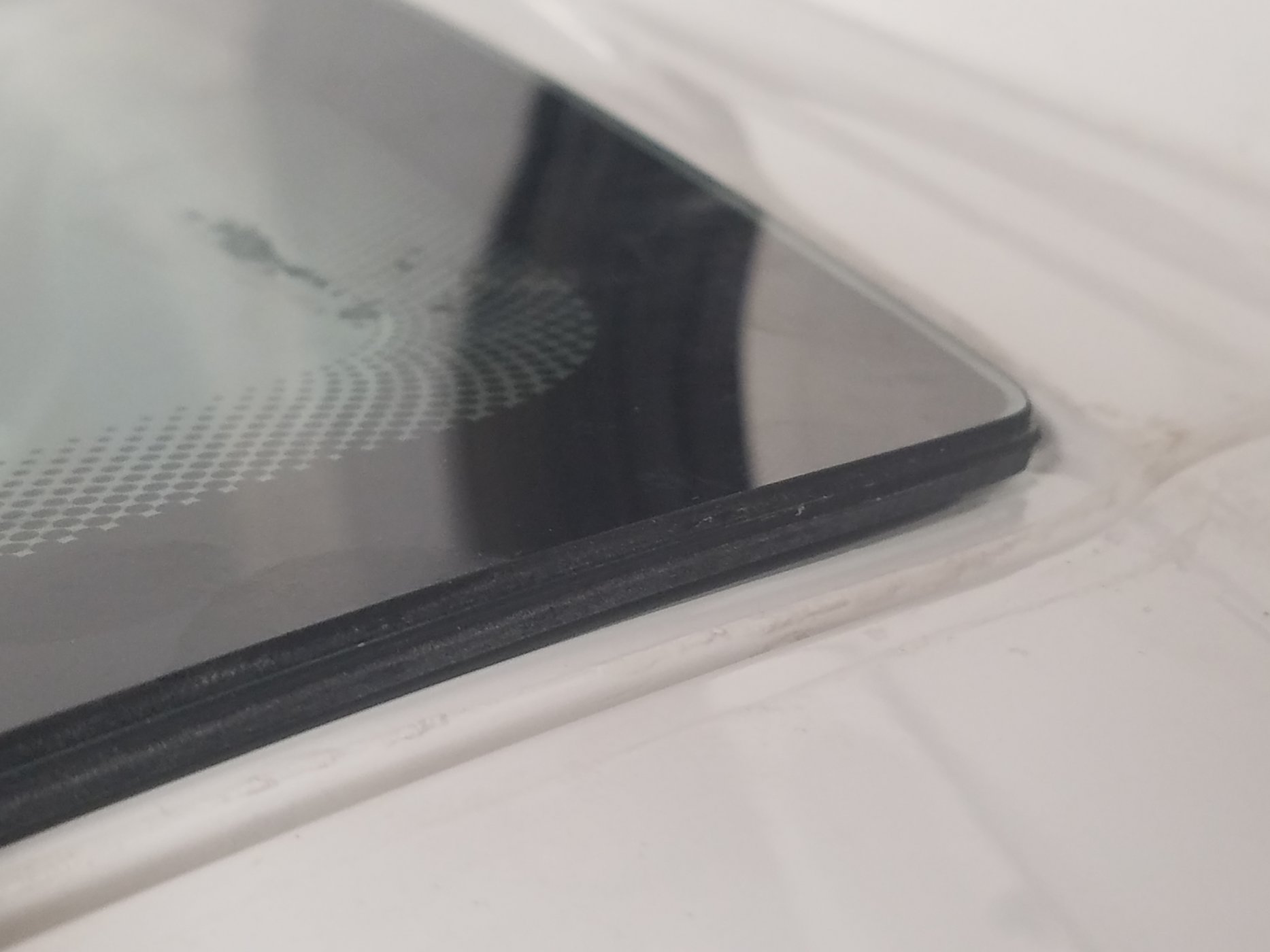

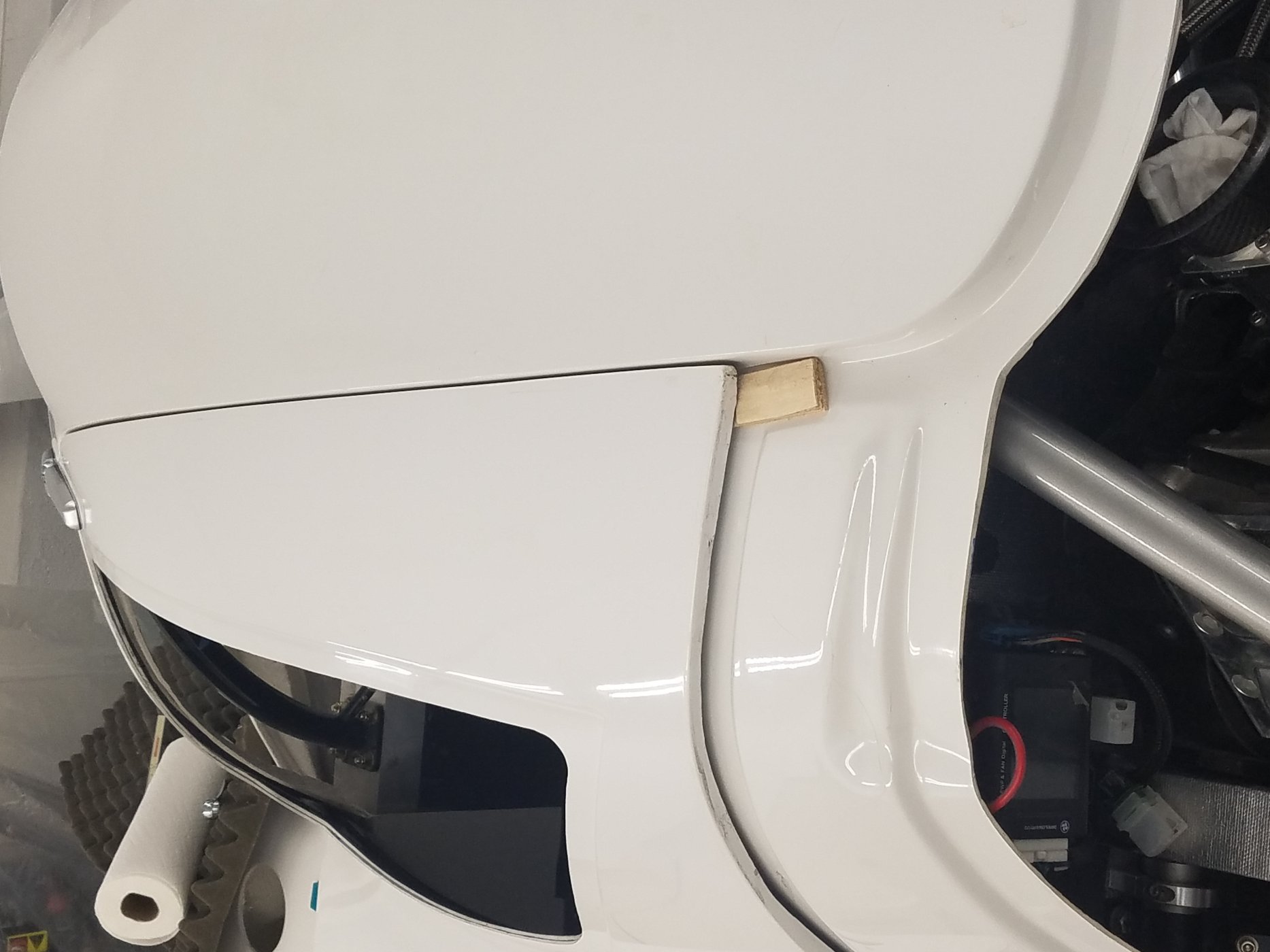

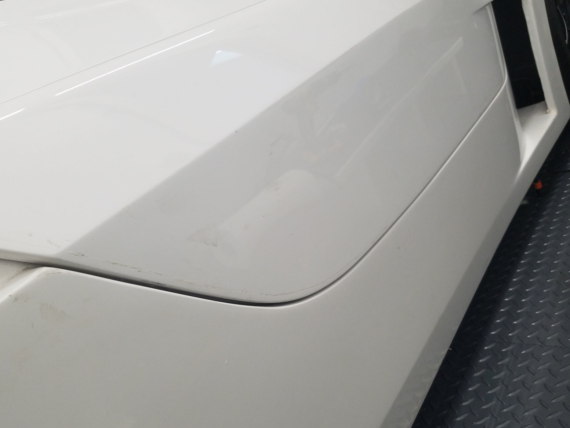

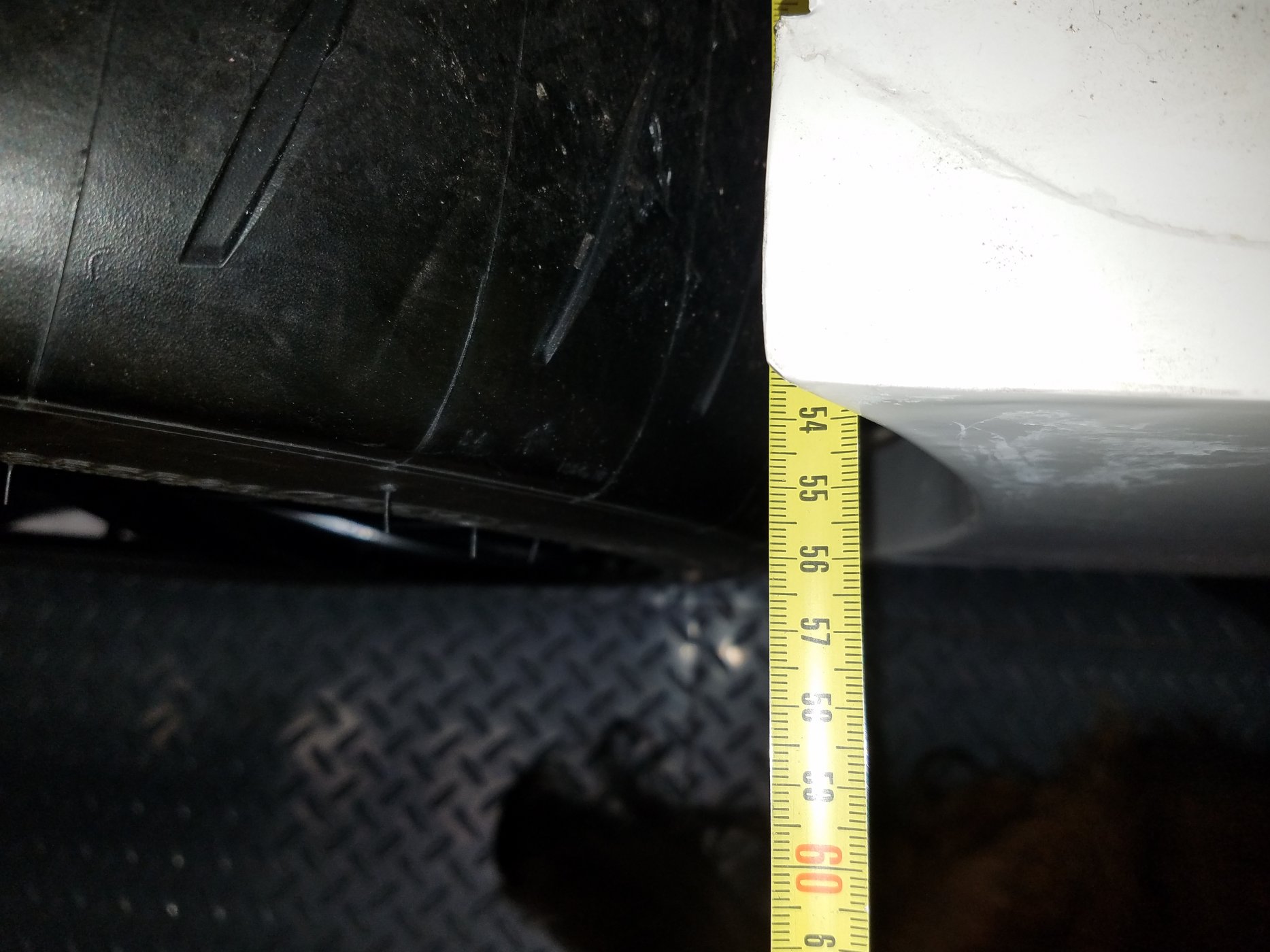

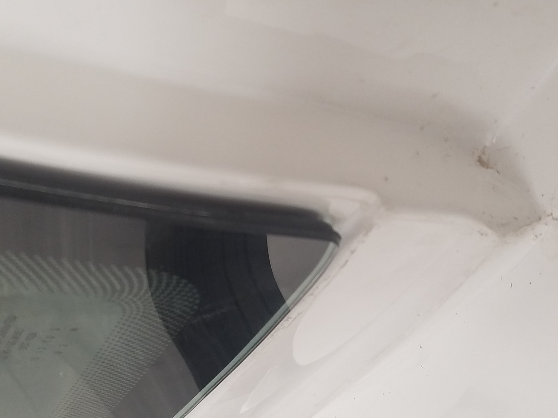

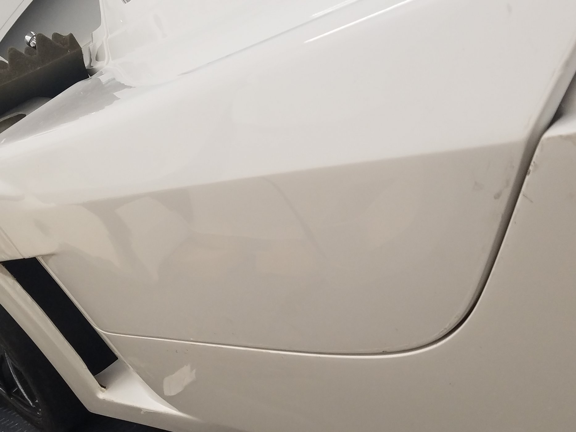

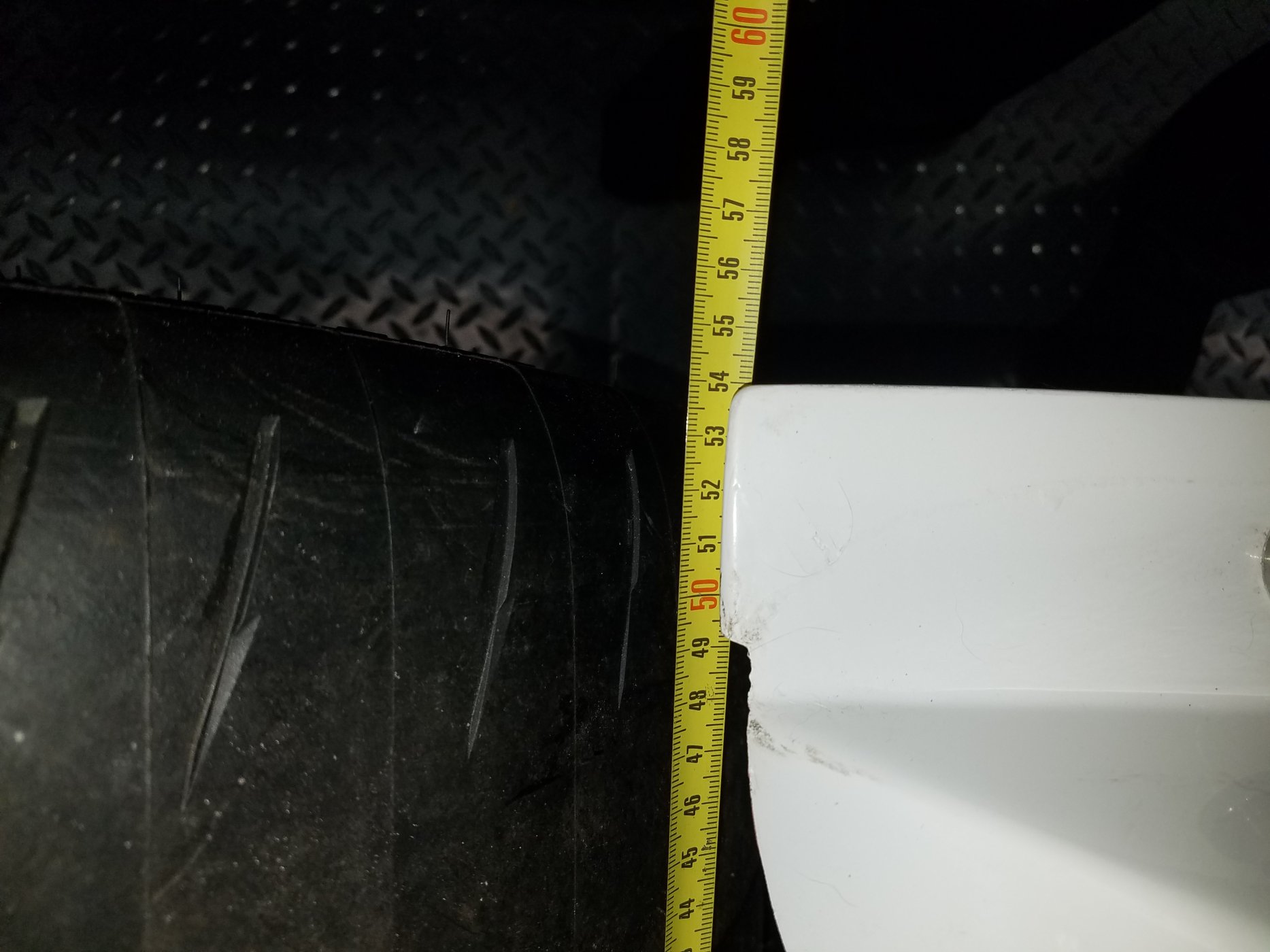

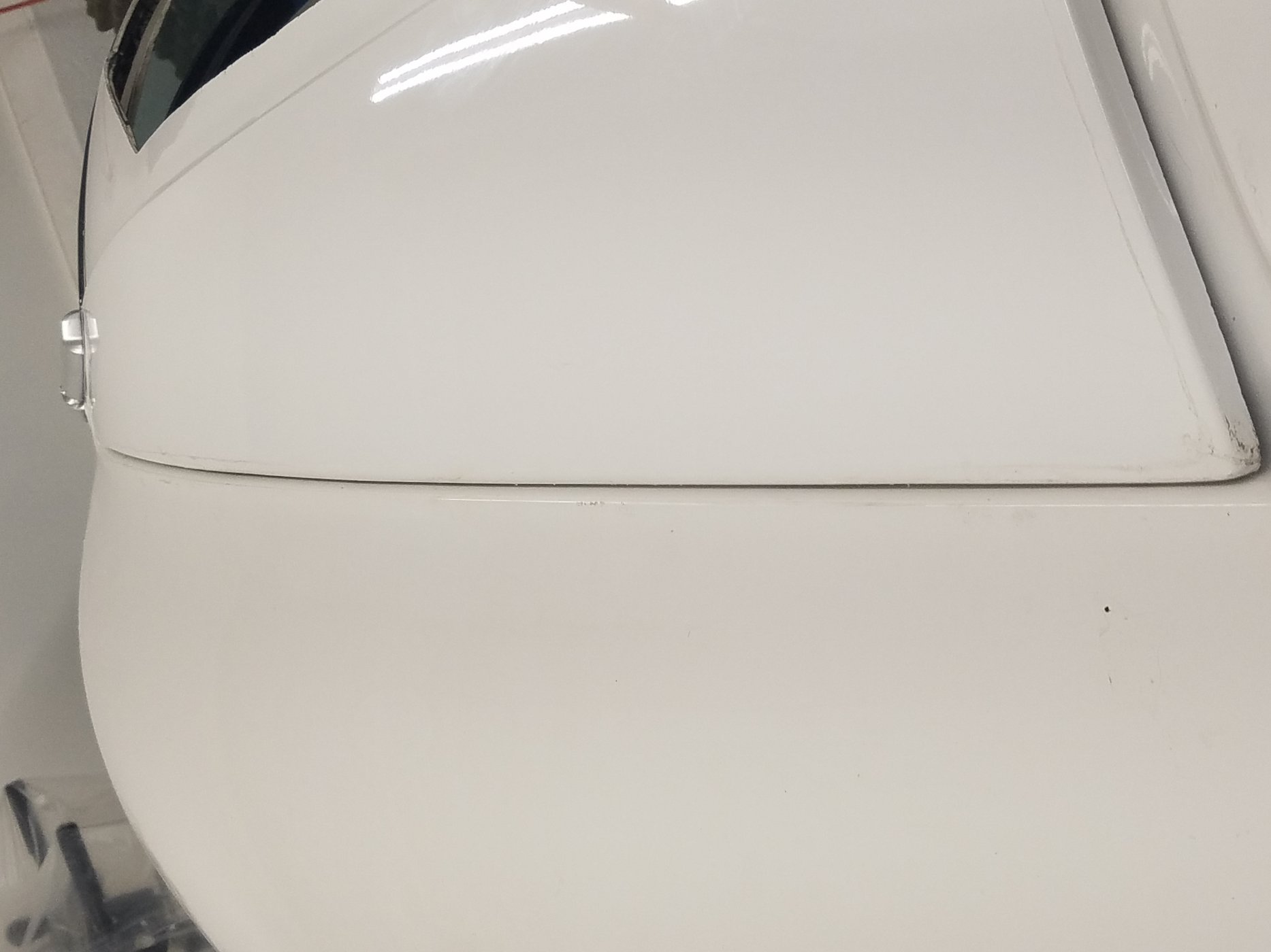

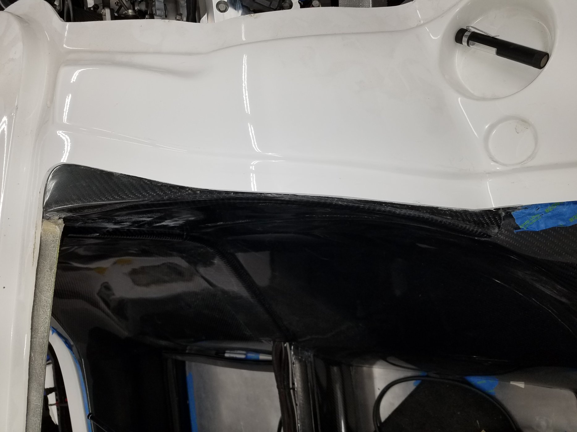

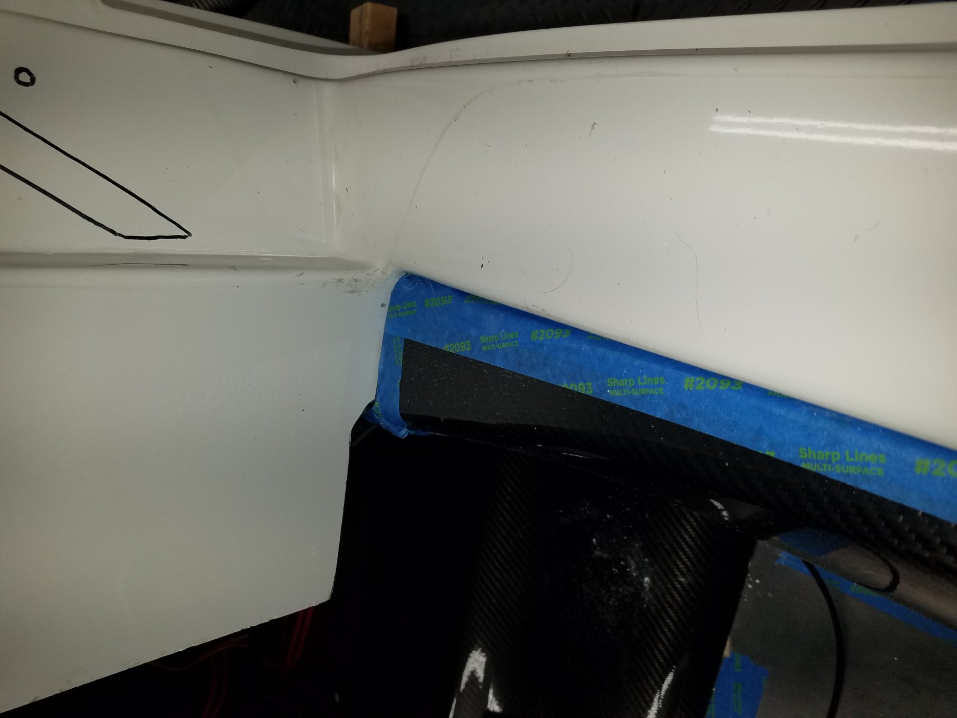

After the body was lowered onto the tub it was time to find all the fun spots to tweak the windshield, door gaps and a setup with nearly identical measurements front and back. I started roughing the body after I aligned it. Here are some impressions of my alignment results.
Windshield first

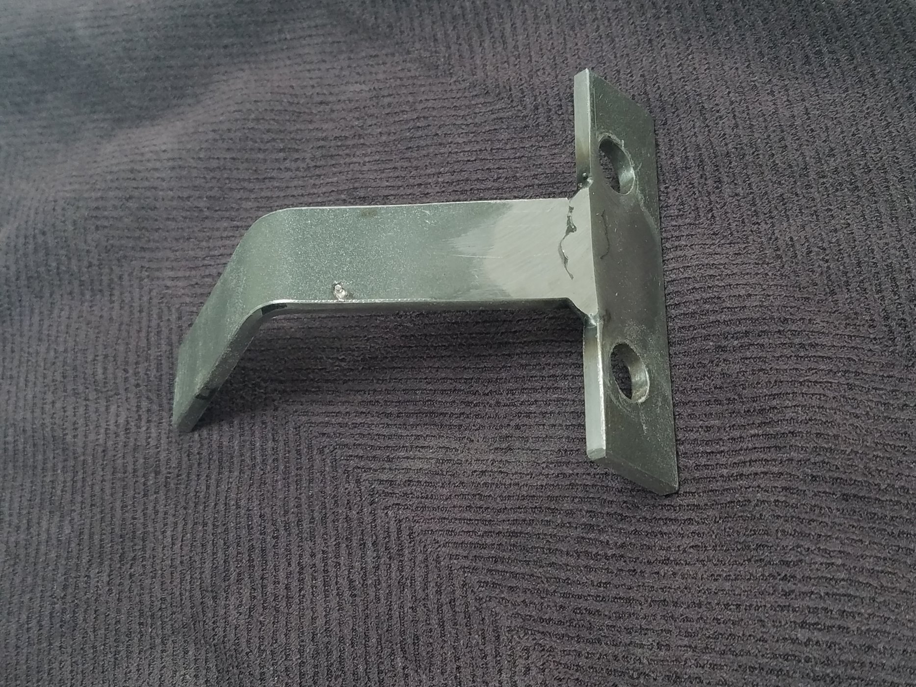

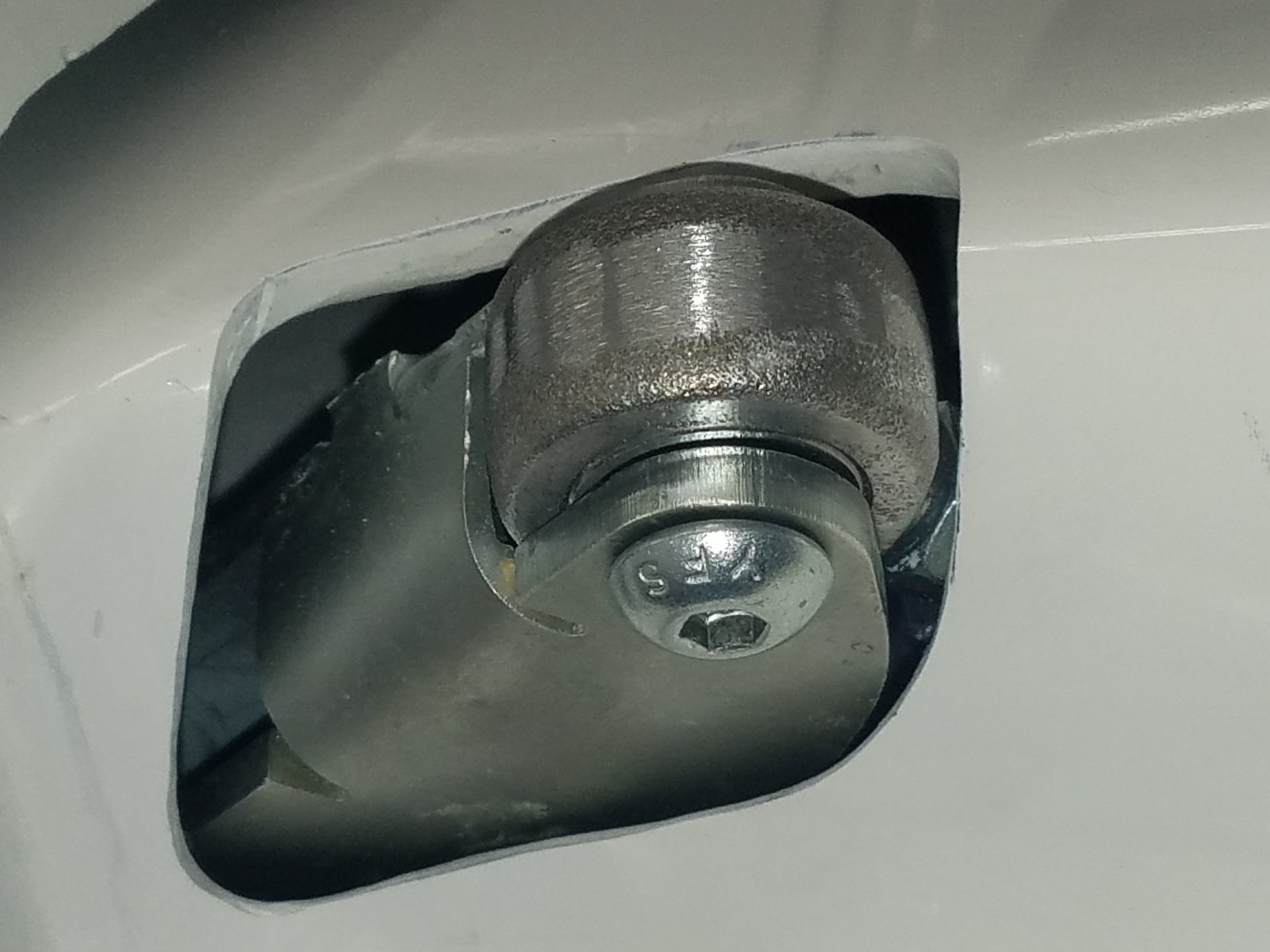

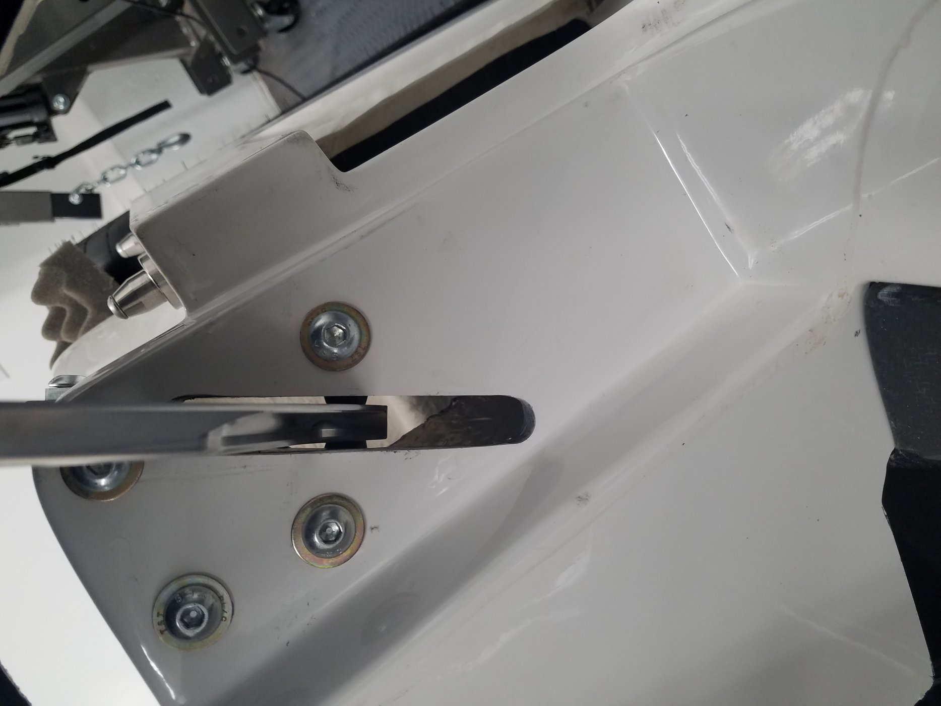

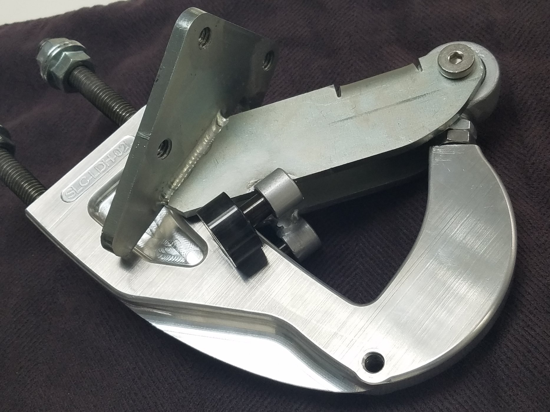

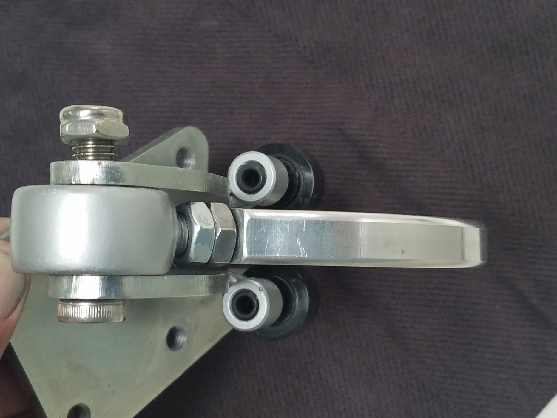

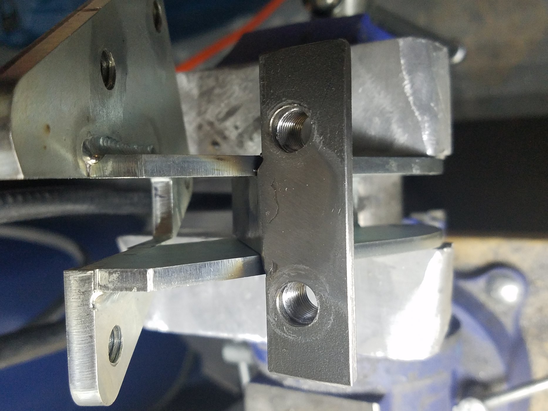

In order to hang the doors I wanted to prevent the shiny billet hinges to get beat up by scratching. I followed Ken's idea with the guide rollers and backing plates which I bonded to the body. You can hang a tank from those plates which will be a good thing since I'll be installing the actuators soon. All I can say is that IT WORKS ! Super smooth operation, strong guidance with no lateral play, no residue on the hinges from the rollers. I tweaked the design a little and eliminated some of the hardware. Designed an alignment tool to set weld on bushing to hold the rollers. Very clean and strong.

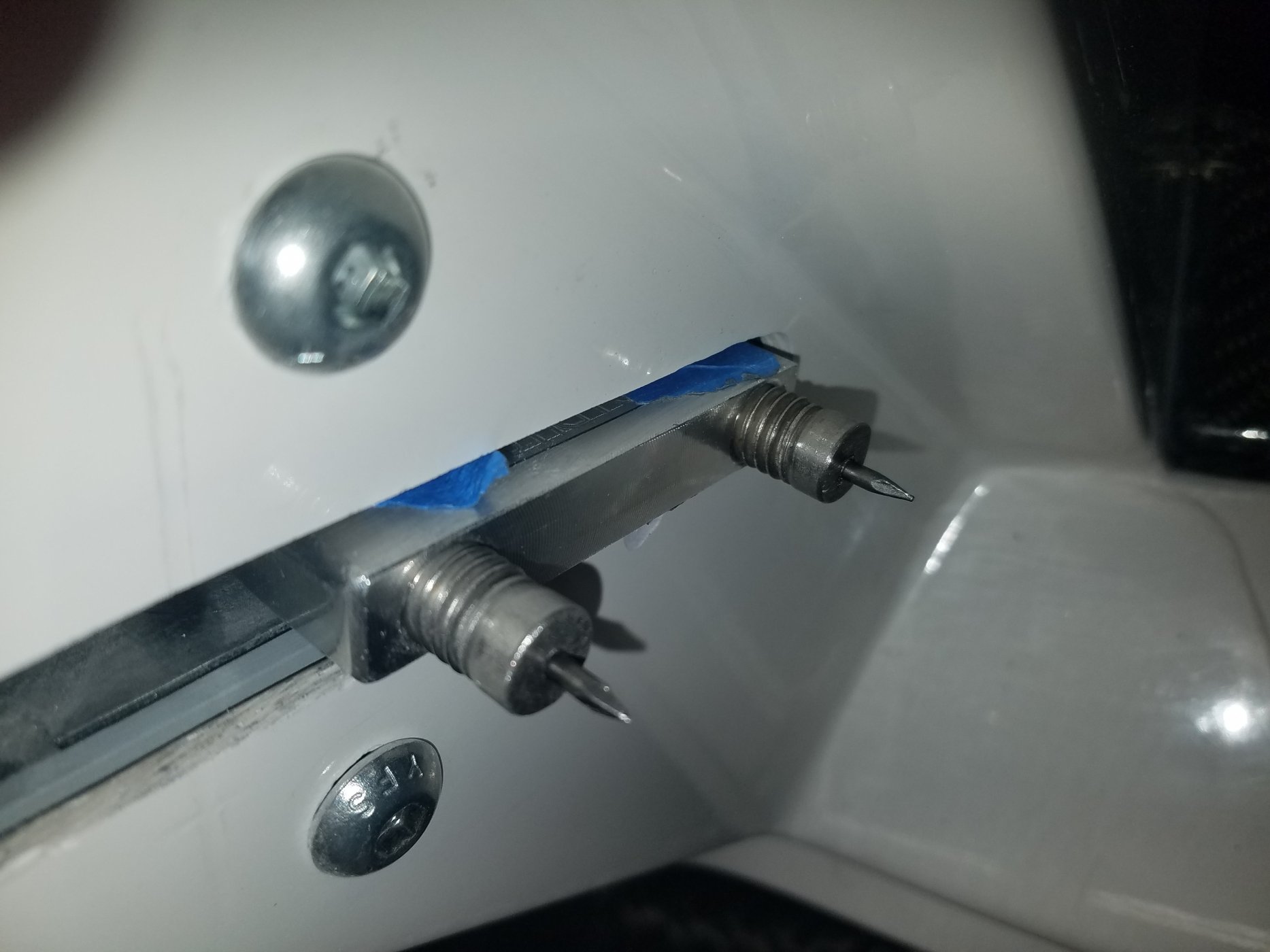

With the hinges in place I was able to set the doors. To find the correct spot for the holes to be drilled the first time so guessing was required I used some punches I made up similar to what Ken suggested. All that time spent finding the critical spots the body is responding to is paying off. So far the gaps on the car are lining up very well.
