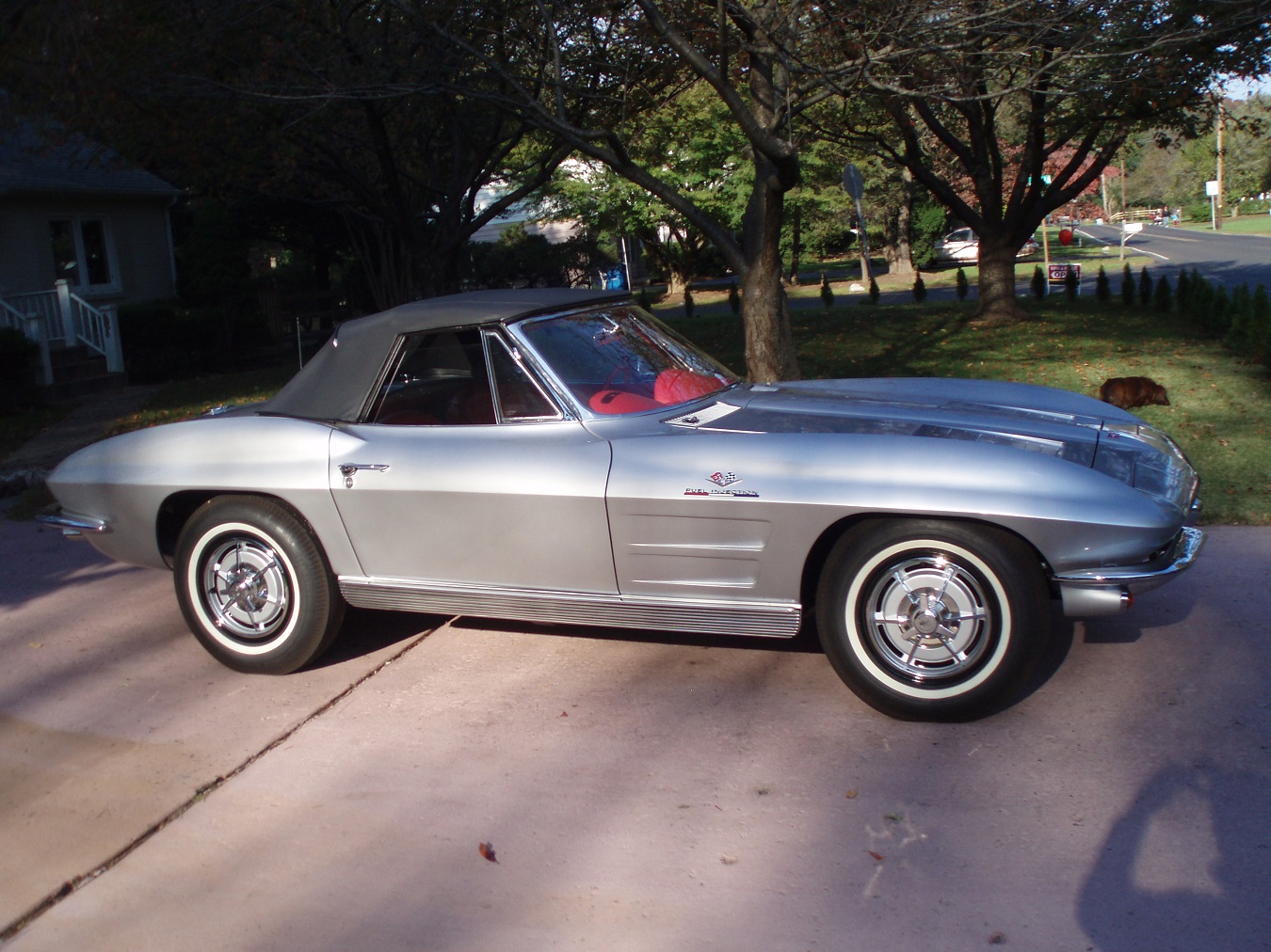

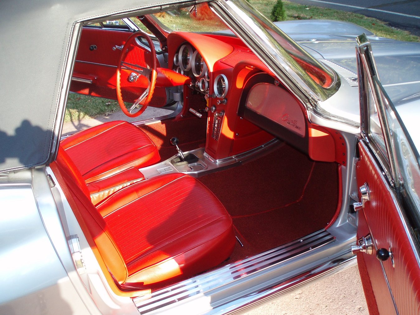

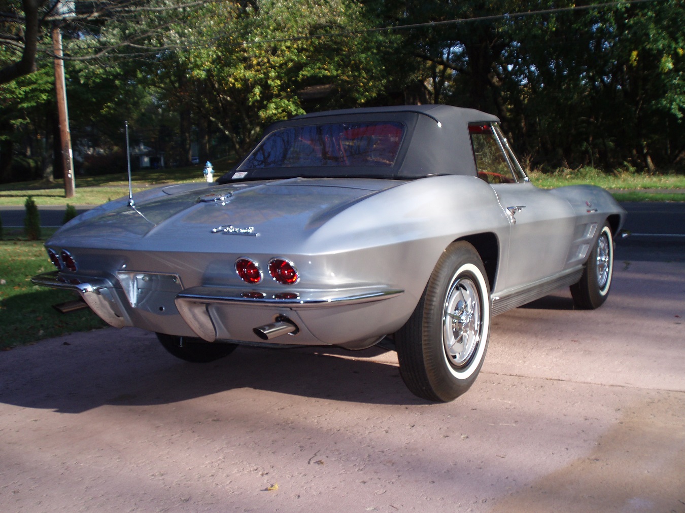

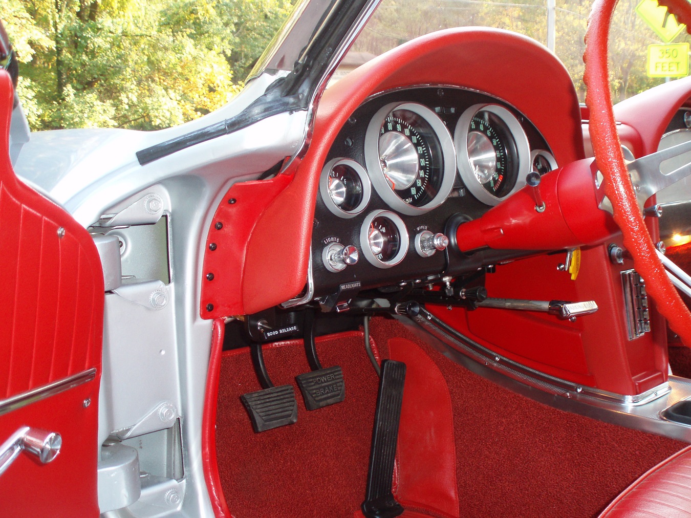

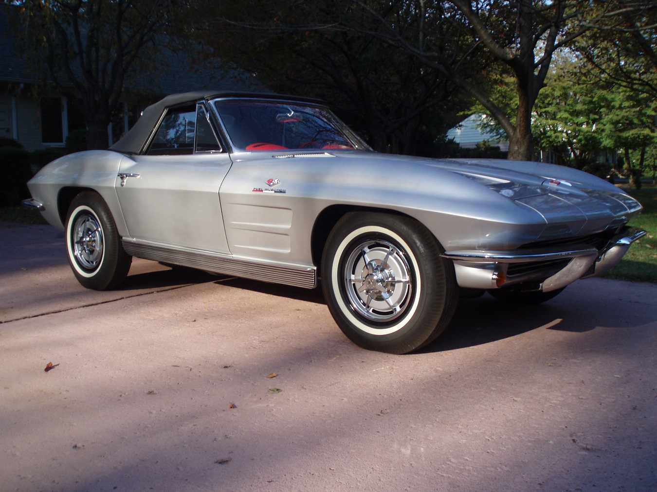

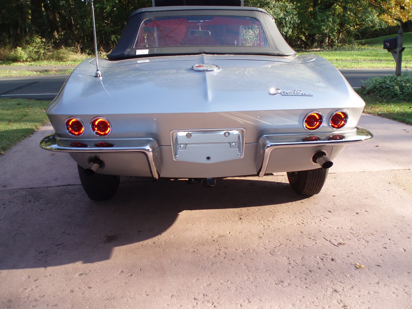

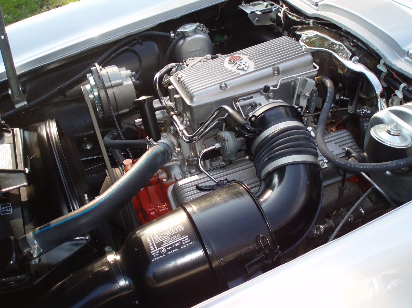

Thanks for the positive feedback. I am doing this for a while and the SLC is not my first rodeo. I grew up near the Nuerburgring in Germany. Motorsports is sort of a genetic component over there. For those who are interested. Here are a few pictures of my previous project before the SLC. Only took me 10 years to restore it. It is a very early model 1963 Corvette Fuel Injected (September 1962). Lacquer paint, all original, matching numbers, 360 horses high compression engine. She takes 103 octane "Leaded". A very demanding old lady! Bought it 18 years ago when I came into the country.

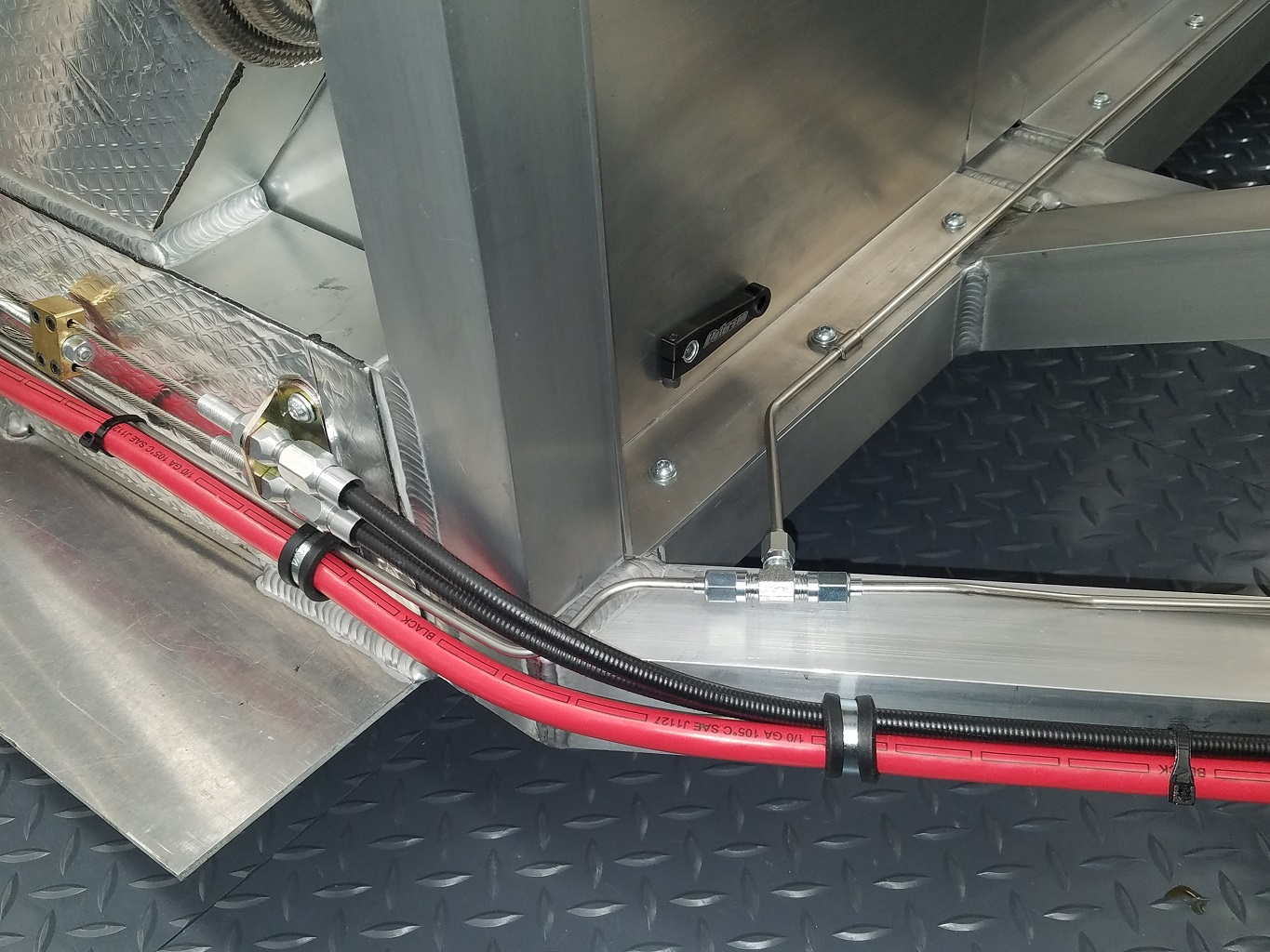

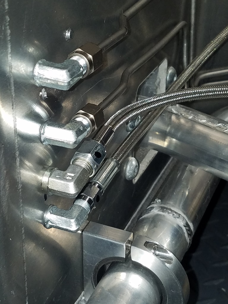

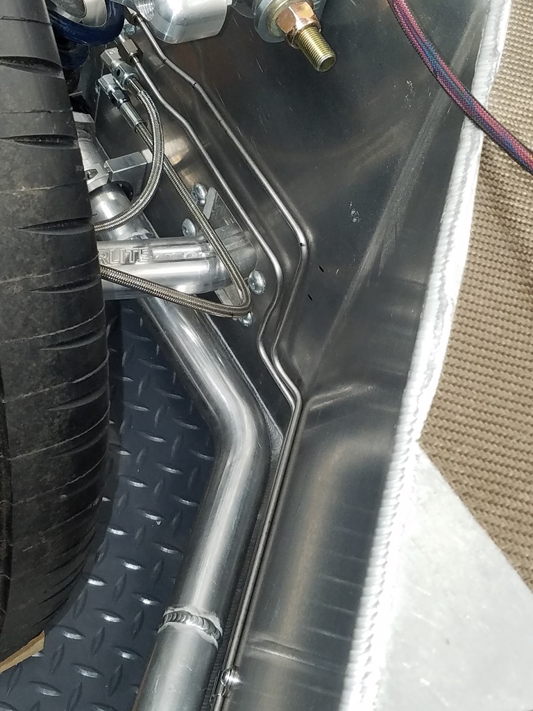

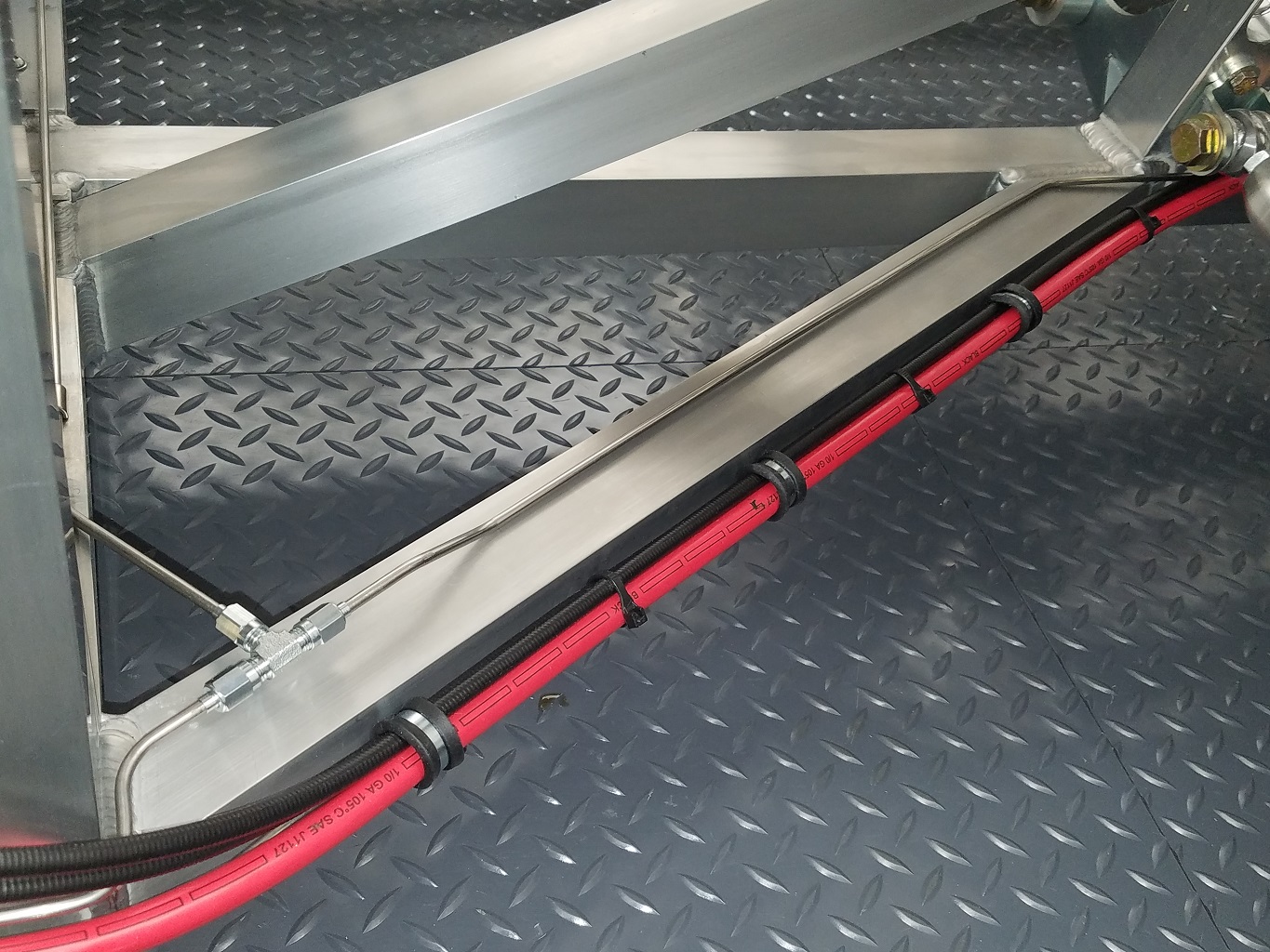

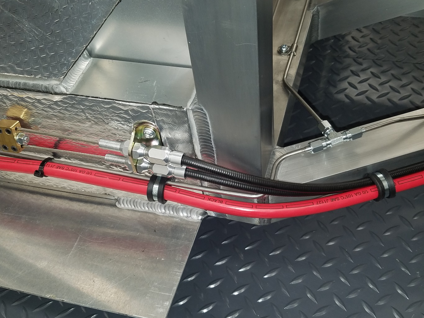

That is how I finished the weekend work. Front brake system entirely done. Moving aft... The factory brake lines didn't fit the new locations of the -3 AN bulkhead. All new lines lines for clutch and rear brakes have been installed. Those are now one piece lines without connection under the body.

Stephan. Your tube work on the brakes is incredible. Is all that stainless or NiCop tubing? How do you plan to leak check it?

Thank you so much for the nice comments on my work. I am happy to see that another C2 owner also ended up with an SLC. The best of both worlds I think. Would love to see your 67.
To answer your question on leak testing. The pedal assembly will be bench tested. I will make -3AN lines with caps and bleeder screw, still have a spare fluid reservoir to feed the master cylinder. All lines are stainless incl. the lift kit. Front and rear will be tested the good old fashioned way. One guy pushing the pedal and the other guy opening and closing the bleeder on the calipers and transmission. If successful and no leaks.
BEER TIME!

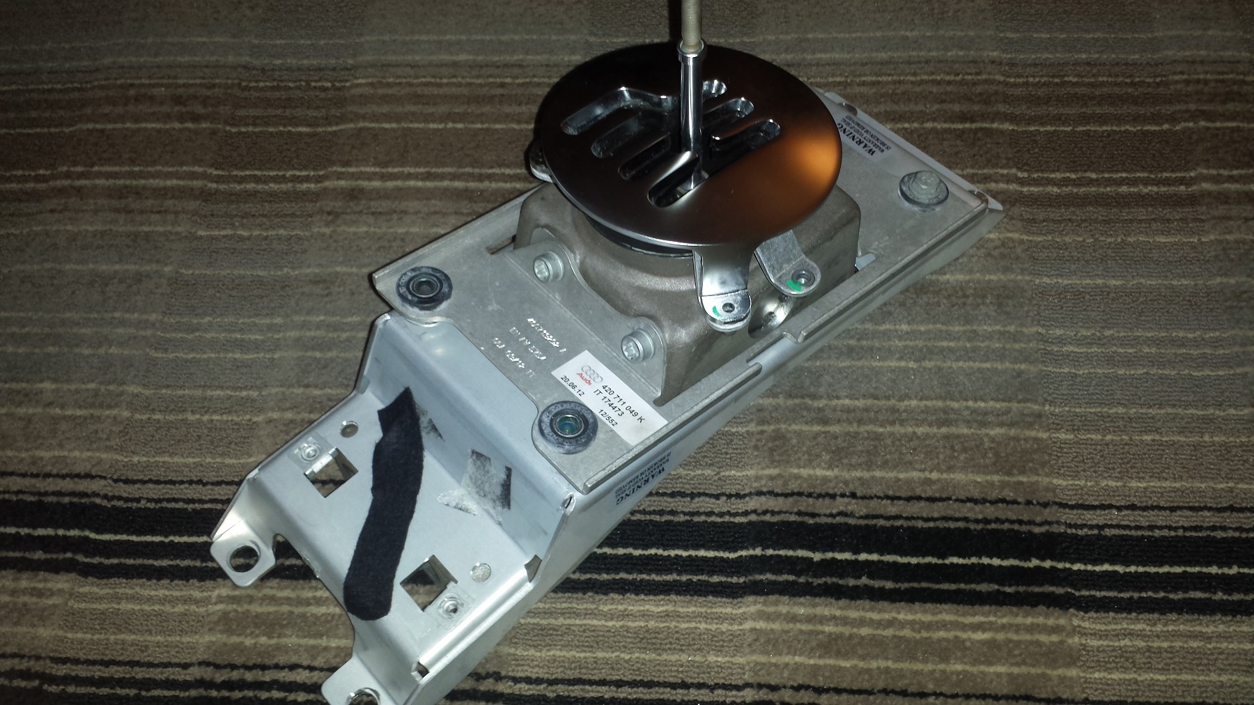

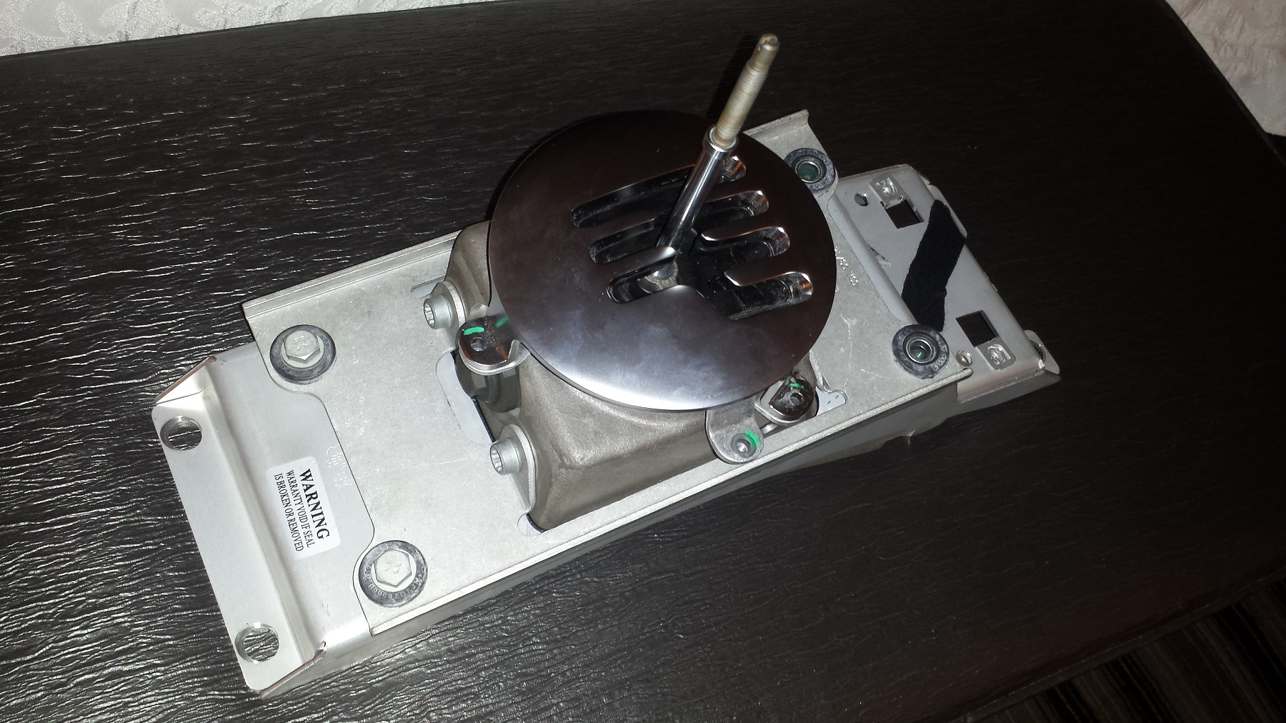

My Audi R8 Gated Shifter arrived from Europe. I got creative when I noticed that there are no used ones available on US soil. I searched all individual European Ebay sites such as France, Belgium, UK, Holland, Germany, Austria, Switzerland, Italy, Spain etc. since Gallardos and R8s where sold around the globe but only a fraction to the US. Not all used parts are being offered internationally so I contacted the vendors if they would make an exception and ship to the US. I got lucky a few weeks back. After some searching I was able to buy one for 450 Euros or $540.00 US all said and done. It's like new, shifts precise and crisp. Came off an 2012 R8
I hope this info will help a few builders to save some money if they prefer a Lambo or R8 shifter.
Good luck hunting.

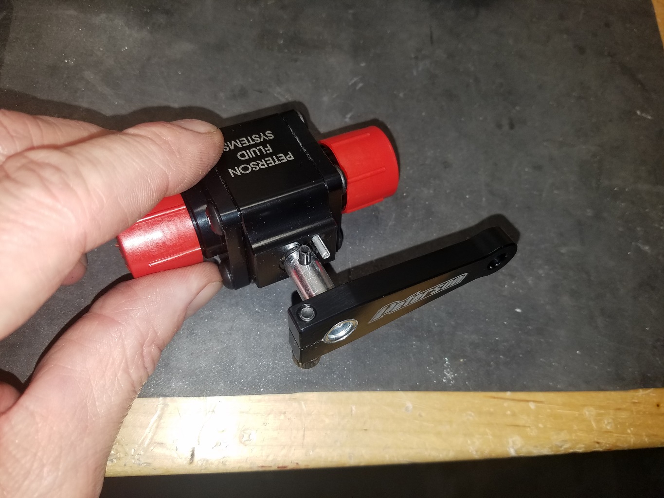

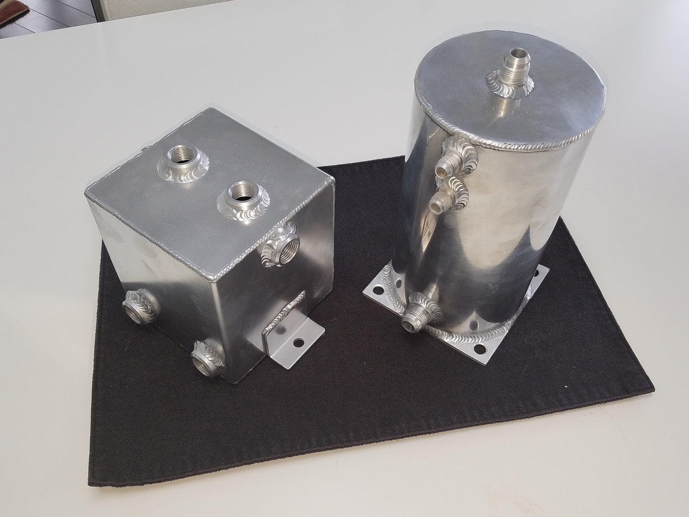

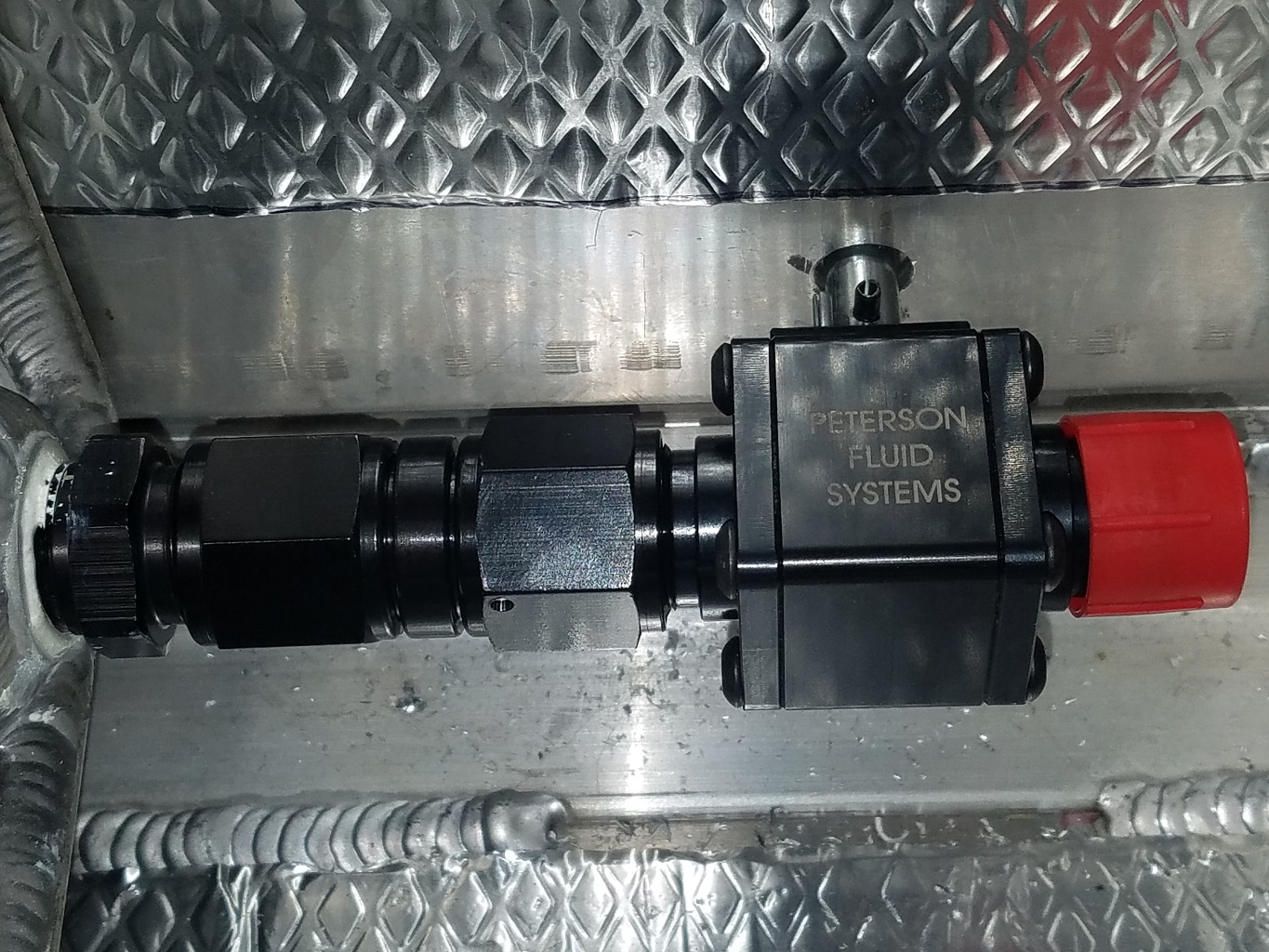

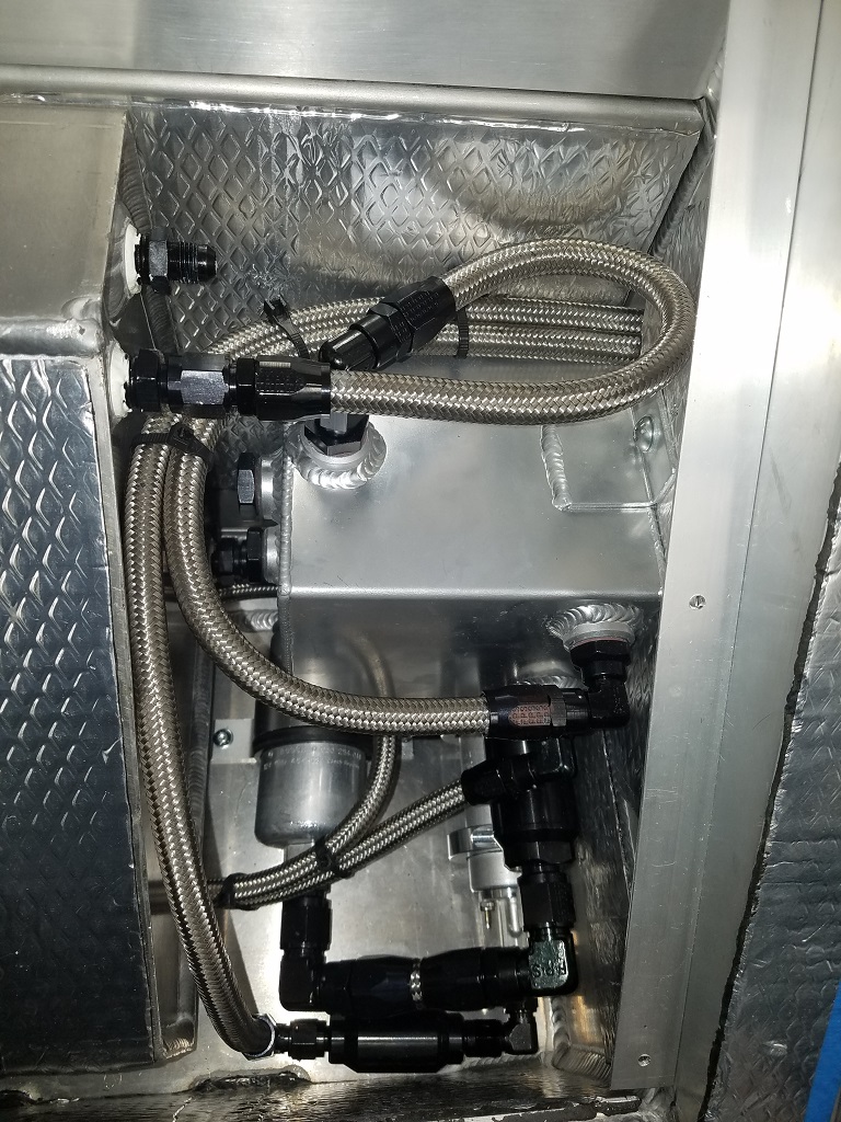

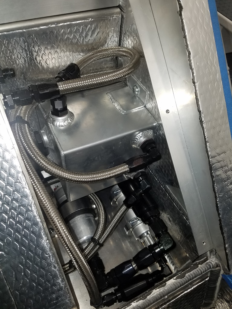

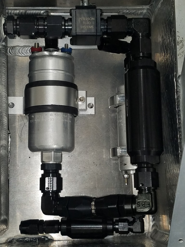

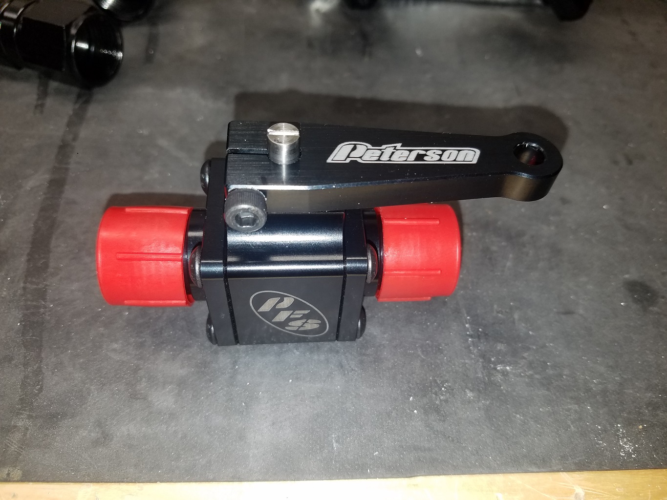

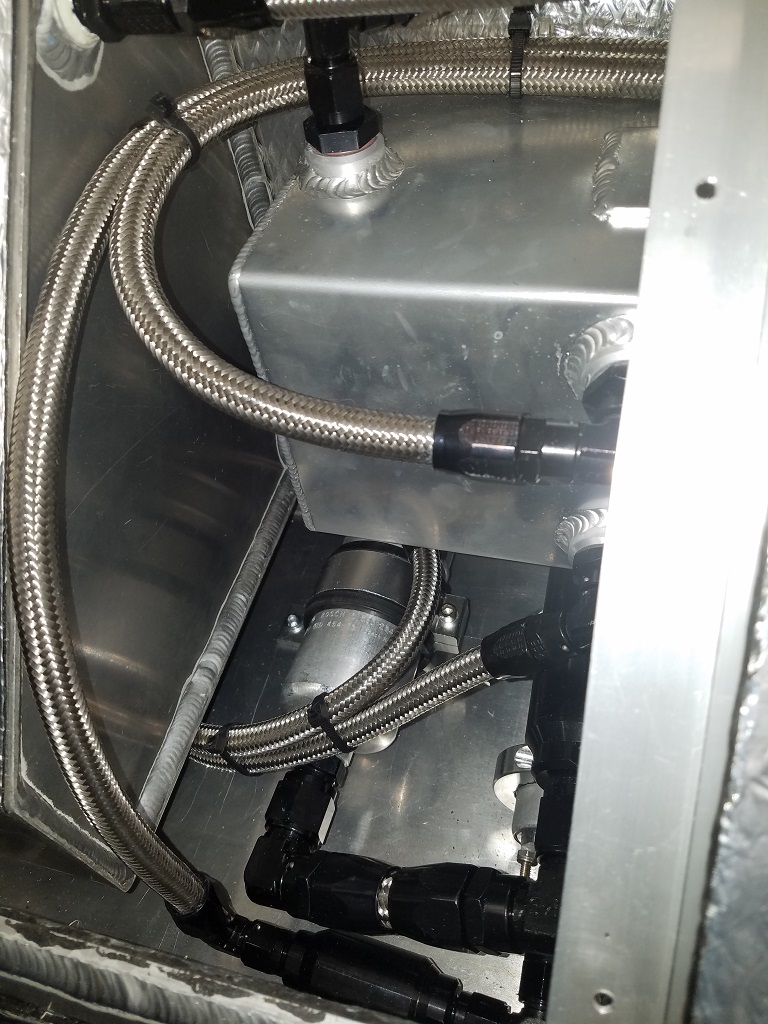

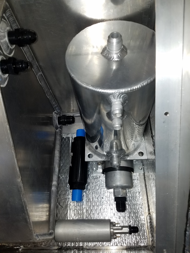

...moving along the driver side I stopped at the fuel system for some time. I tried to come up with a layout using the factory surge tank. I must have had at least five or six versions before I decided that that surge tank does not fit my idea of a clean installation and to keep everything out of the engine compartment. I sourced a tank with the same capacity but different foot print and a cube instead of a cylinder. I like that there is an opening in the bottom for the high pressure pump. Also the fuel shut-off valve required some modifications to fit the bill. I chose low profile AN fittings to give me the shortest connections and all components are now serviceable/replaceable through the removable section in the firewall. Here is the first part of this installation...
...and more fuel system components are finding a home. I'll complete the system when the roll-over and pressure relief valve have been delivered.

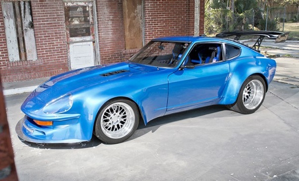

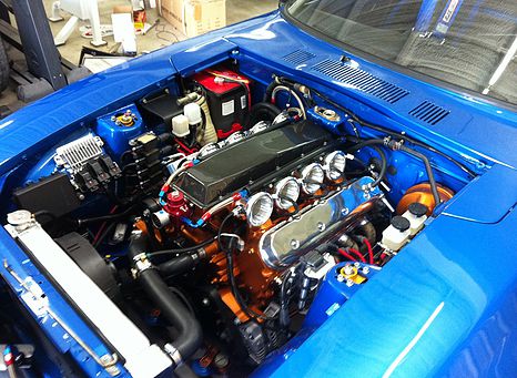

I just read your build log and wanted to comment on the reply above that was posted some time ago. I built a LS3 CT525 powered 1977 280Z with a Harrop Hurricane cross ram intake with 58mm throttle bodies and it worked flawlessly. LSX Performance Tuning ( The Guerra Group ) had my car for 1 full day and when I got it back it drove like a high performance car from the factory would drive. The engine idled correctly, cold start worked as it should, highway cruise was smooth without any surging and wide open throttle was great but the smile on my face was hard to remove. My current GT40 build has a Borla Induction intake with 58mm ITB's and puts out over 625hp at 7,500rpm's without any issues either. Just wanted to defend Harrop since they make a great product, maybe the tuners need to talk to the guys at LSX Performance tuning for some insight.

Very much appreciated. I have not put the ITB idea to bed yet. Actually, I spoke recently to Earl at Kinsler. I received a lot of input about the does and don'ts. Jenvey is still in the race as well as Harrop.
The car looks very impressive.

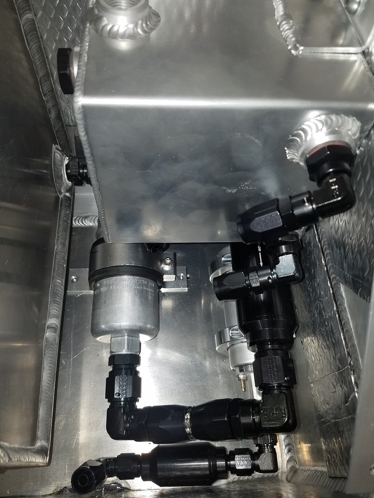

I was able to do the fuel lines and AN fittings around the pumps and surge tank today. Next step placing the fuel pressure regulator...

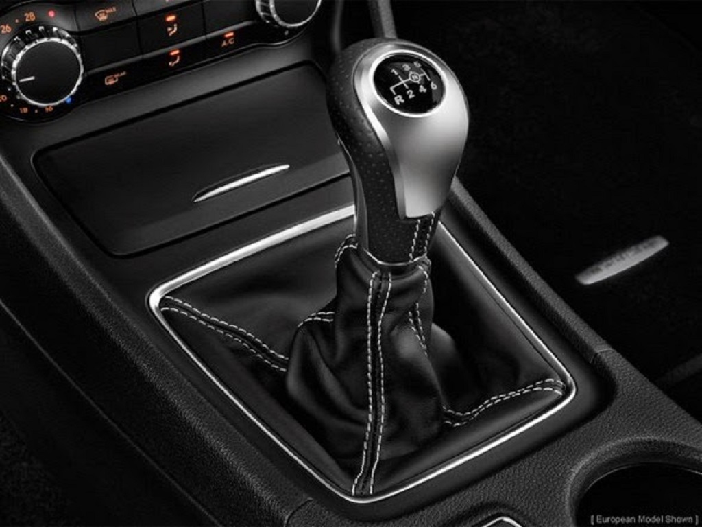

This post is for those builders who want to use the factory shifter for the Graziano. Before I purchased my R8 Gated Shifter I was looking for a solution to make the center console look nice. I figured out that Mercedes and Chrysler are using the same six speed shift pattern as the Graziano. Aftermarket parts are plentiful such as shifter knobs, shifter boots and shift gates. Here is a pictures of a solution coming from a Chrysler Crossfire (Mercedes SLK). An aluminum shift gate fitting the narrow tub console in the SLC. I read somewhere it is 7.5 cm wide. Funny enough, it has a large letter S (Superlite maybe) engraved into it. The other shifter is only to show that there are decent leather and aluminum versions are out there for small money.
