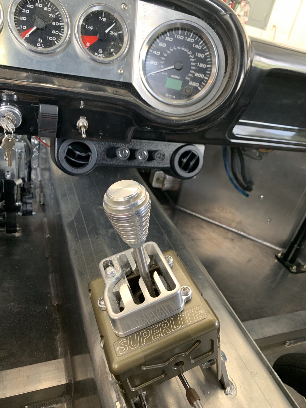

  • Install shifter gate- 1/4-20 thread, 3 bolts.

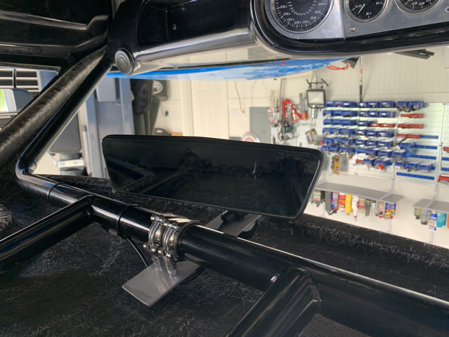

  • Install mirrors. Race Mirrors from Pegasus. https://www.pegasusautoracing.com/productdetails.asp?RecID=28686. Made backing plates out of 3/16 aluminum instead of washers.

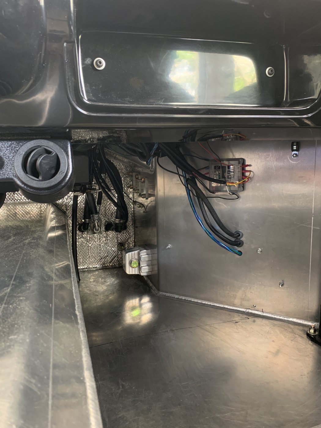

  • Hang wires under dash on passenger side Added some insulted clamps to firewall and zip tied everything up out of the way.
  • Label sub panel. Voltmeter, fuel pump, mirror. Stickers that came with subpanel were for a boat. Bilge pump is fused.

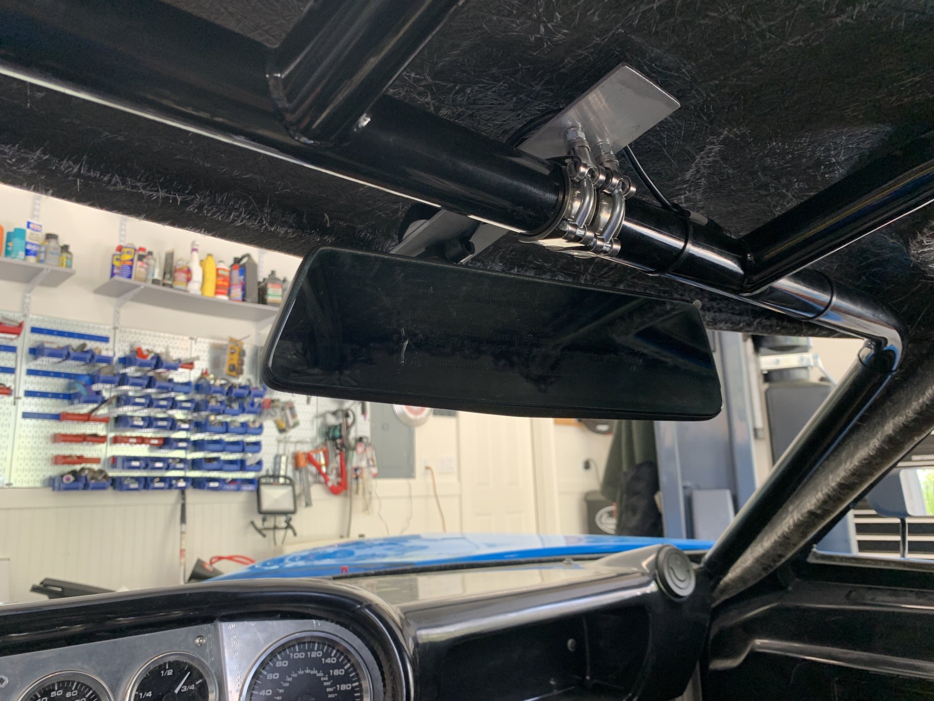

  • Rear view camera/mirror. Fab a plate, use rollbar clamps.

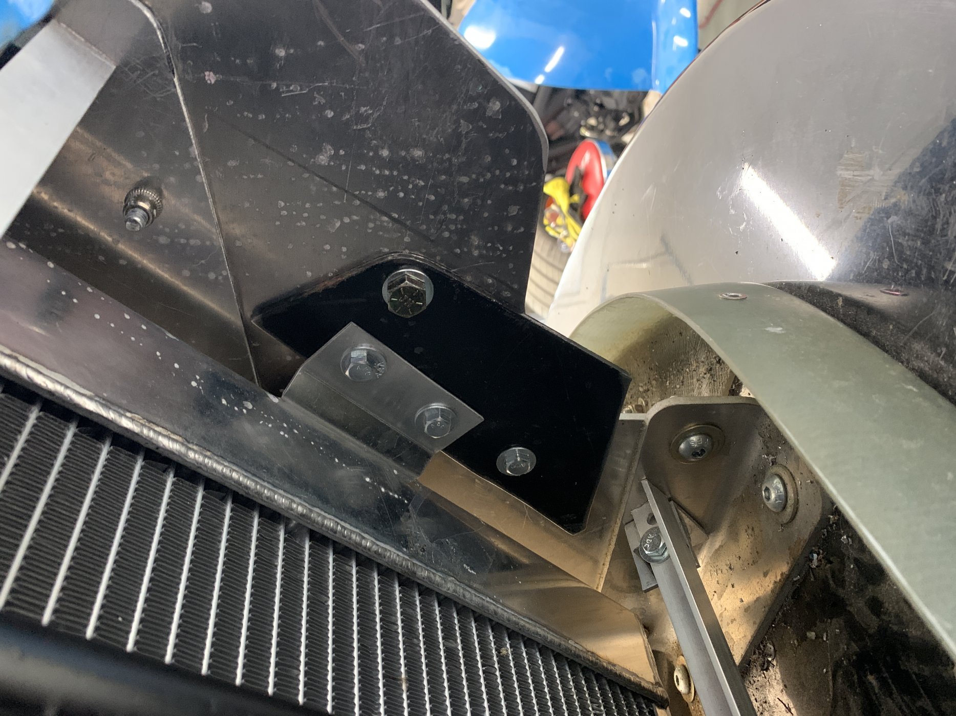

  • Front wells- Made by H, when I am done messing around and nothing leaking, they bolt in.
  • Front dam- again, just to button it up when I feel like it will not need to come off in the next hours worth of work.

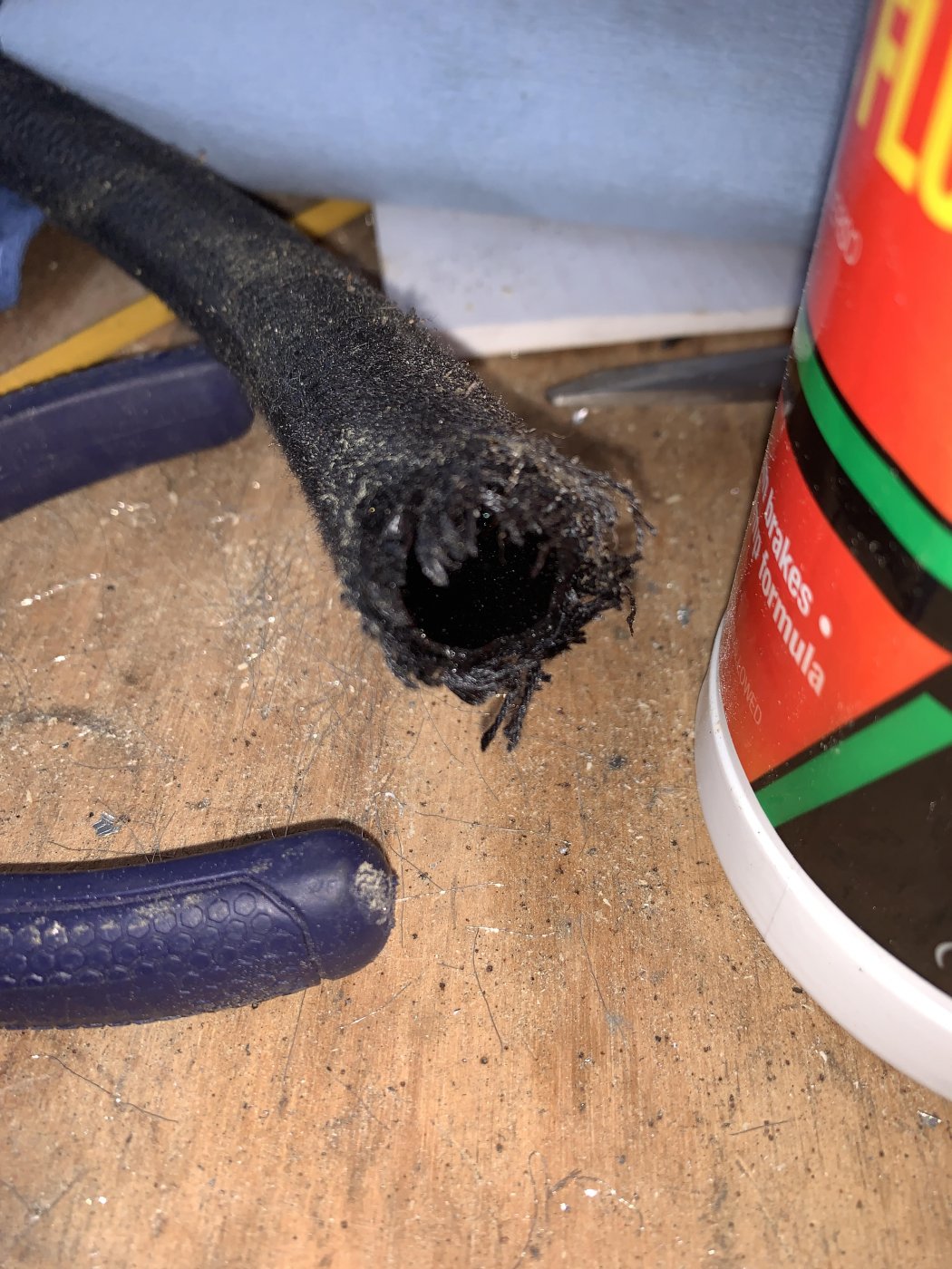

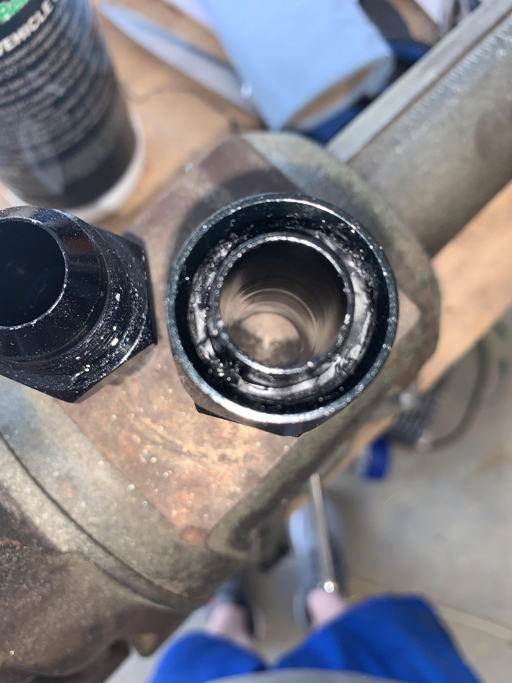

Engine: LS7 with Dailey dry sump. Outlet hose on rear driver's side of block has a -10AN male. I had a -10 to -12 adapter and a -12 line running to remote oil filter on rail right behind driver's seat in engine compartment. While test driving the line blew apart. I dumped 14 qts of oil. Shut it down when I saw smoke and the engine got a bit noisy. Pulled pan and drained remaining oil, had about 2-3 qts left. No metal or sparkle in pan. Bottom end looks great. Still nervous. Got a new gasket installed and ordered parts for a new line. The hose I was using was all nylon braided. I will show pics of the fitting but the line ripped in half inside the fitting. I think I may have twisted it while tightening to the engine. Pics to follow.

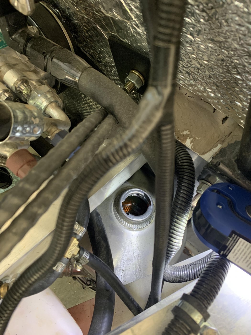

Got my replacement hose and fitting from bottom of block to filter. 18 fresh qts of oil, replaced pan gasket and inspected pan for junk (none). Angle grinder for front shaft off transaxle to get Dailey dry sump pan off easier. Recommend anyone doing this build to do this ahead of mating the engine to transaxle. Needs 1cm hacked off end. Can do with car assembled, but would be easier and faster with Graziano on a bench.
Added 5 qts through valve cover and filled the rest into the 3 gallon tank. Primed pump using air ratchet (only thing that fits on 7/16 bolt in the space). Would love to buy a spare HTD belt and then could use it on a pulley in a drill to spin the pump.
Here is the carnage:
I have not done AN assembly before this build, but in the fitting above, you can see rubber all the way around. I think I built it right, but when tightening, I was spinning the hose putting tension on the rubber inside the fitting. Thoughts?
Here is the hose:
The hose was still all inside the fitting, but this is where the 15qts came out while I was driving.
Got it all buttoned back up and went to start it, but I left it in Acc on the keyed ignition, so it is on the charger until tonight. Fingers crossed.
good luck with things! Regarding the failed hose, any reason you didn't use a steel reinforced one? I'm paranoid about any pressurized hose, especially one carrying flammable liquid. Secondarily, I know hose assembly is standard mechanical stuff, but I personally hate doing it. Especially when places like ANPlumbing.com will build crimp style hoses for free.
Steven Lobel
Thanks. The replacement is stainless braided over the rubber. All of the hoses are pressure rated for far more than an oil, fuel, or coolant system needs. But I did buy a pre-assembled 48" -10 hose from Summit as the replacement.

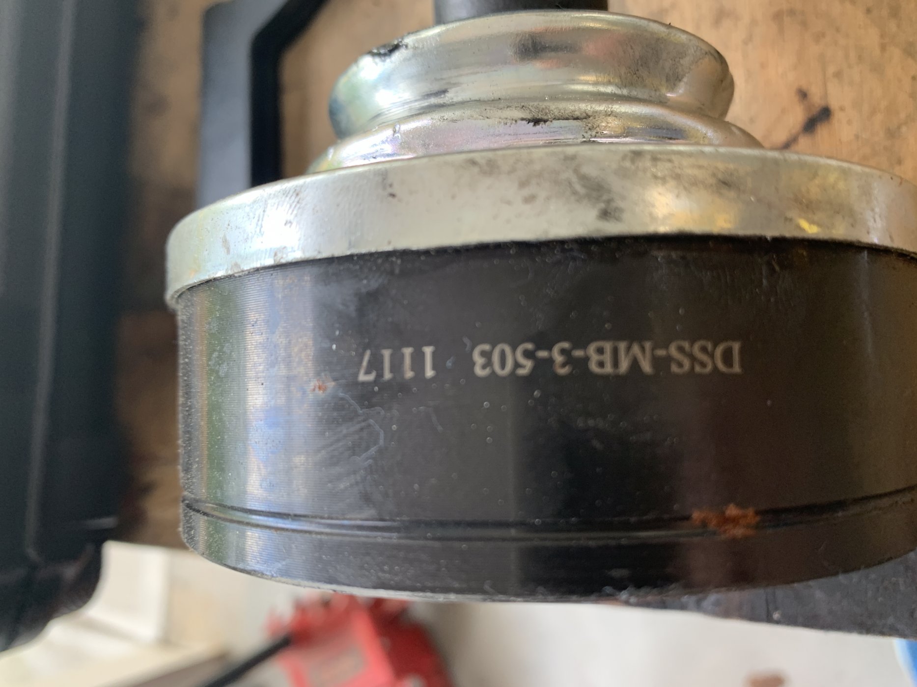

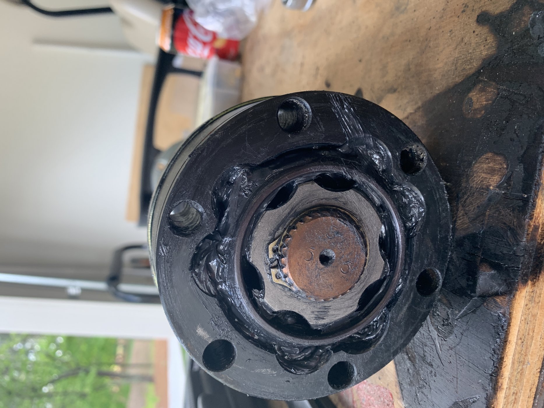

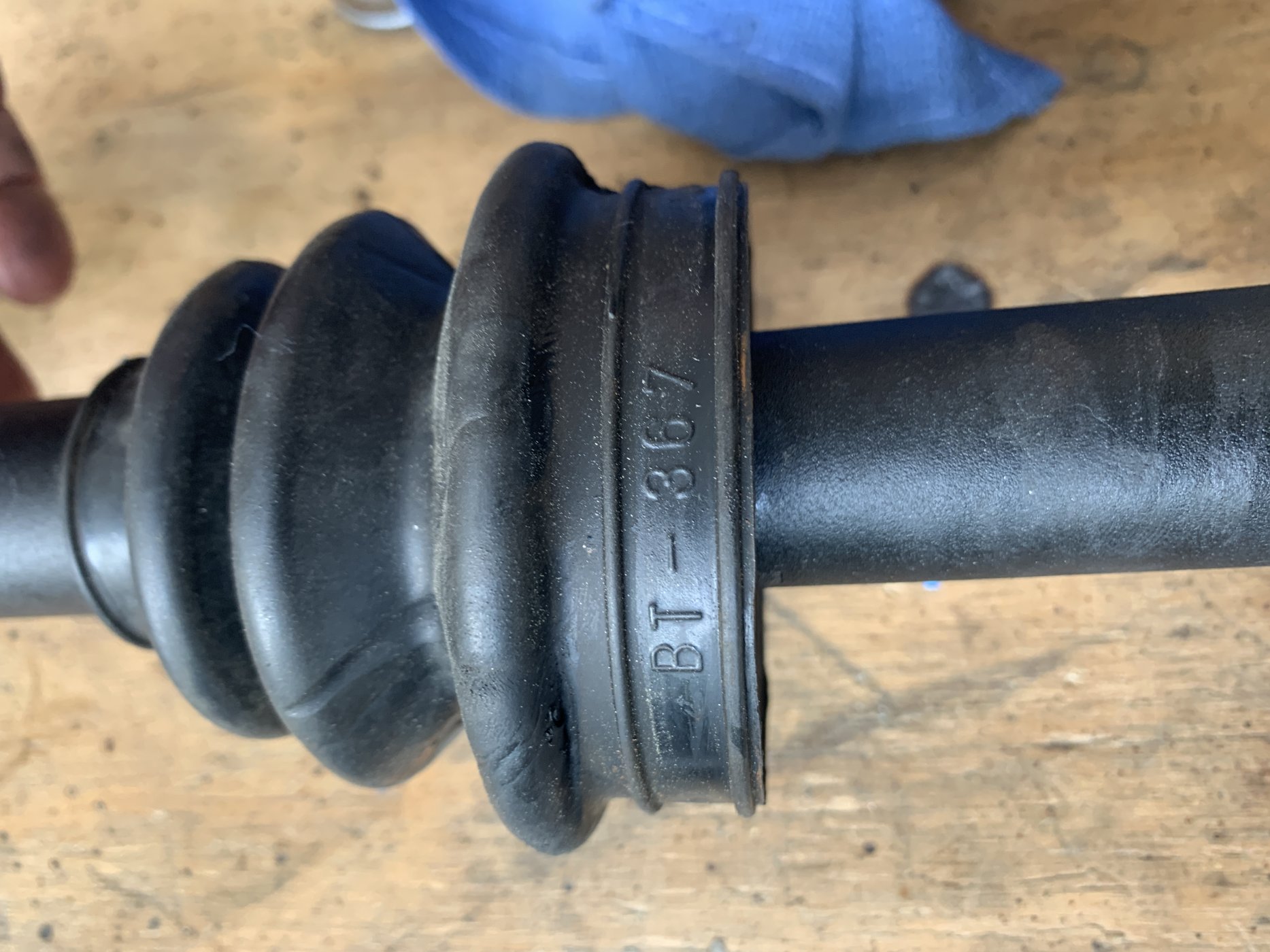

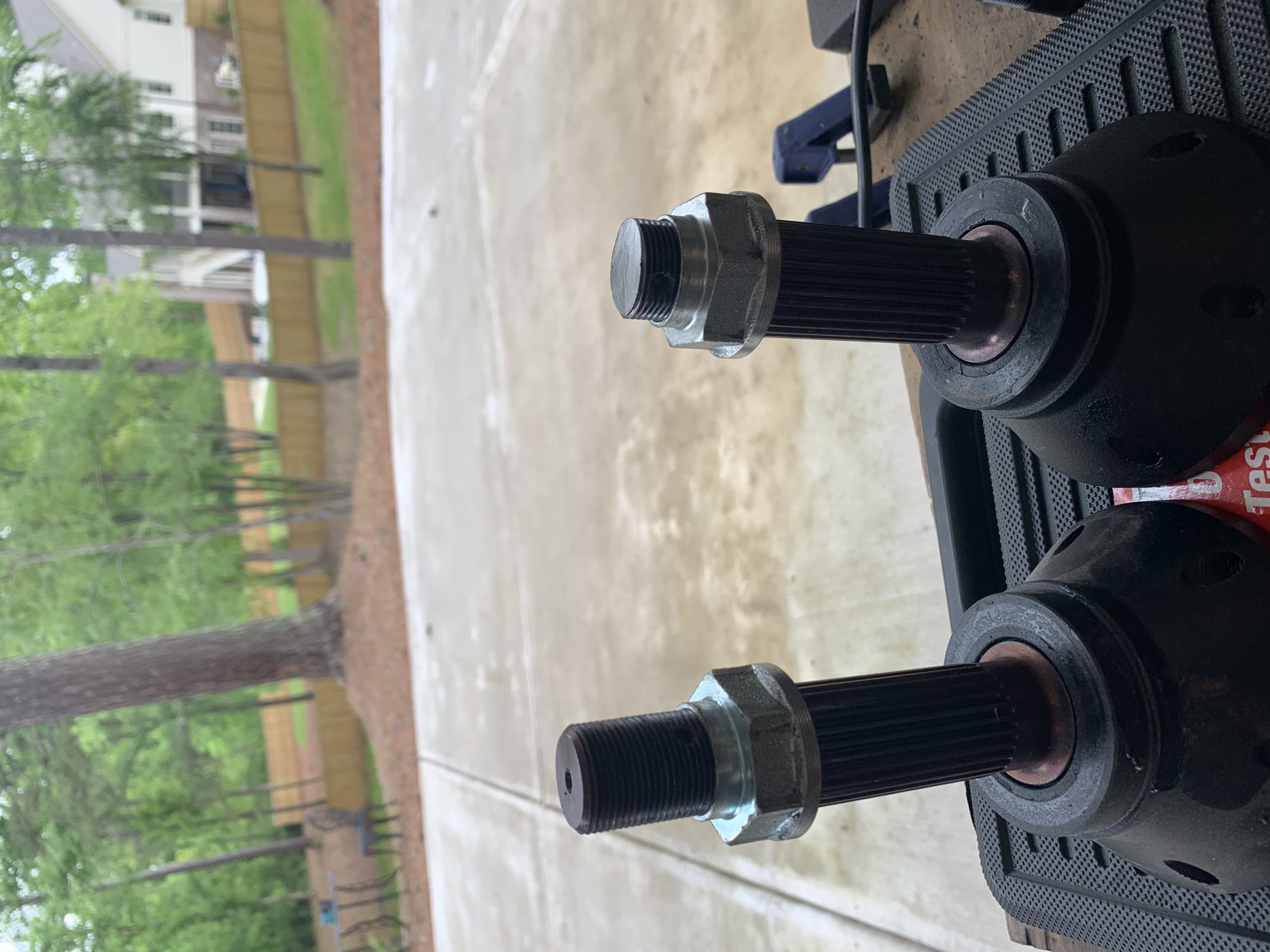

Graziano axle boots are same for inners and outers. BT -367
Replacements at driveshaft shop are $31.
So how did I rip the right side completely apart in 14mi? Ugh.

  • Half shaft boots. Remove axle bolt, remove hub. Hammer/press out wheel studs-change to ARP100-7708, Lisle 22800 install tool. Unsure why both of my half shaft boots got torn in 14 miles of test driving. $31 for full kit with grease from driveshaft shop. I bought 4 so I have spares. BT-367-10 Low Profile 108mm CV Black Inner/Outer Boot Kit. While the half shaft and hub are out for changing wheel studs, I am going to shorten the stub shafts so I can put on the Forgestar hubcaps. Stub shaft in vice, 4" angle grinder to hack them off. Did it with nut in place so I can make sure it threads off and on again. Dan Carter had this problem and went with longer hub caps. https://www.gt40s.com/threads/dans-build.47402/post-486015

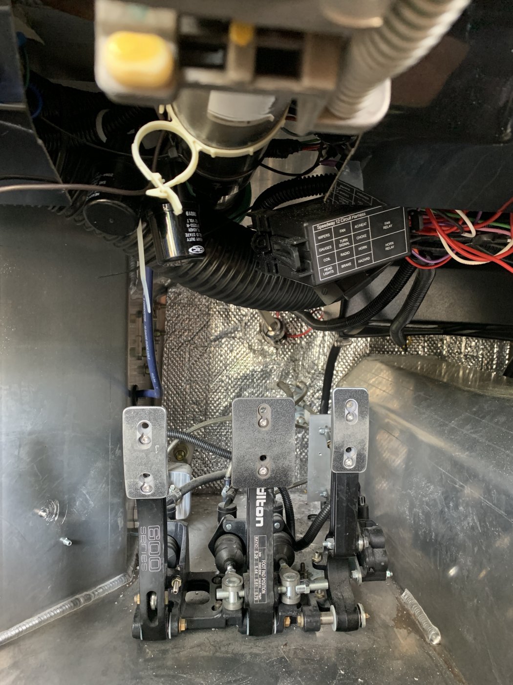

  • Speedway switch- got a replacement for defective hazard component. Mounting to roll bar in footwell. https://www.speedwaymotors.com/Speedway-Heavy-Duty-Turn-Signal-Switch,30566.html Works perfectly with my harness.
