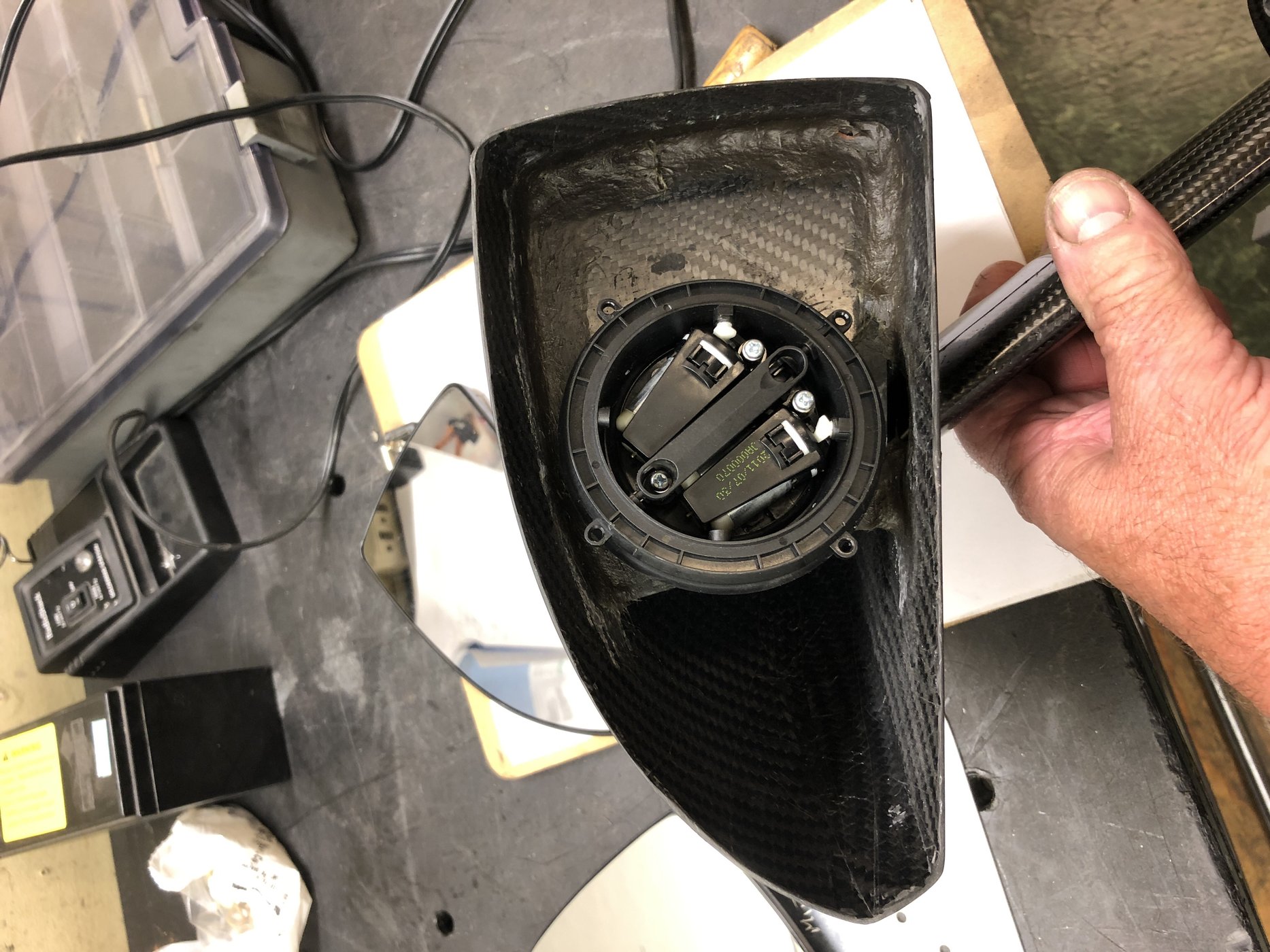

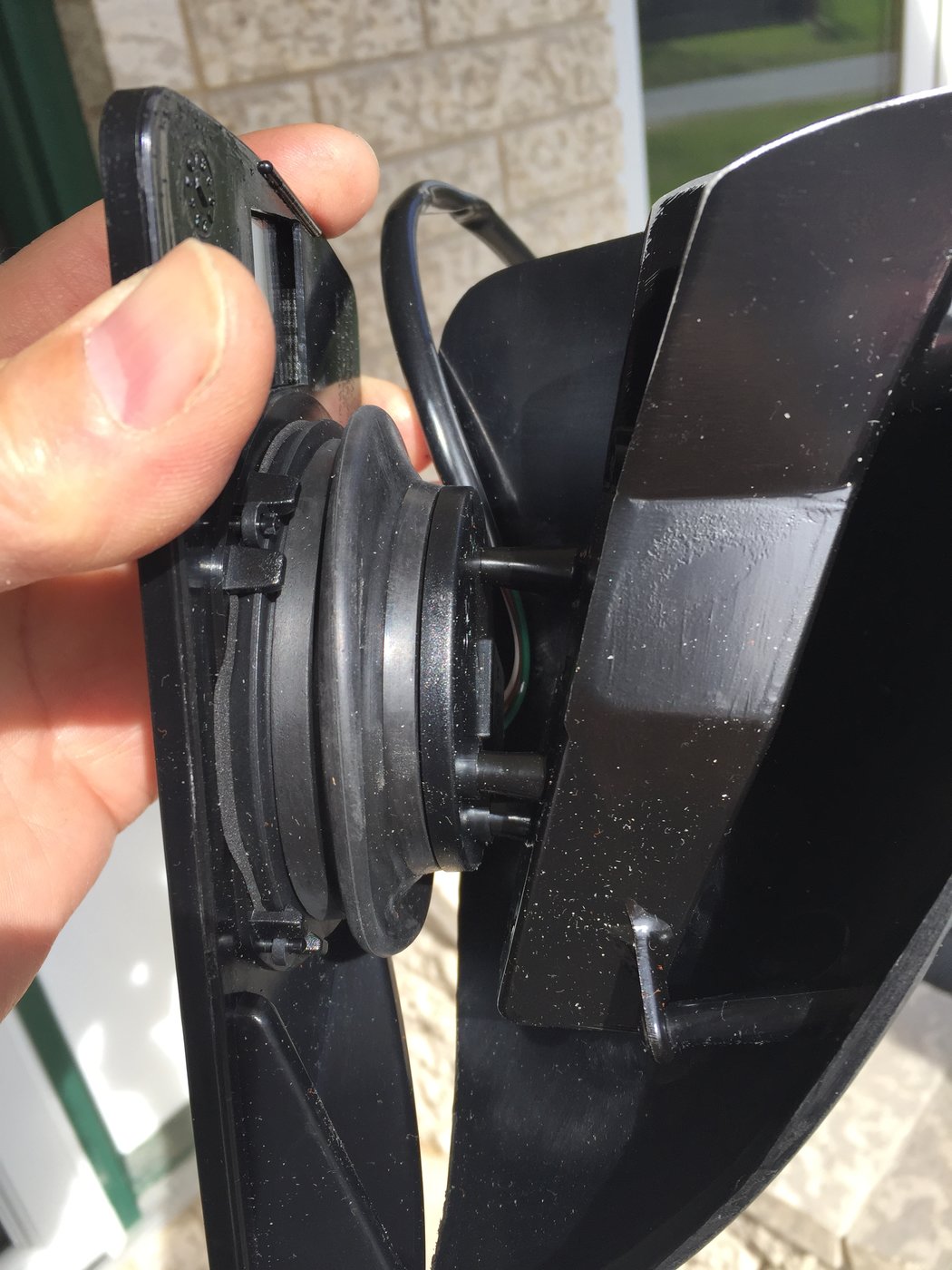

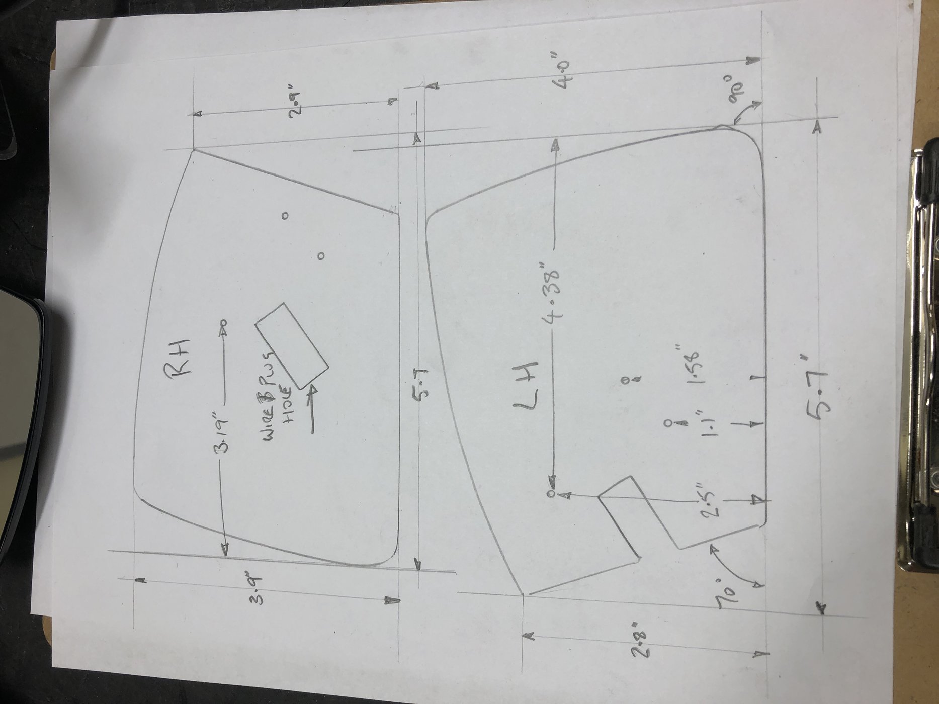

I need to show you all how the mirrors were supposed to be assembled, the only part of the impala assemblies used are the motor and mirror, the housing is to be thrown away completely, once you have the motor and mirror assembly out of the housing measure the height from the face of the mirror to the mounting face of the motor, I guess around 1 1/4"
A plate of GRP or aluminum should then be bonded into the housing that distance down from the front face the motor can then be screwed to this plate and you are done. this is how i designed them to work.
Ill try and find some photos to help.

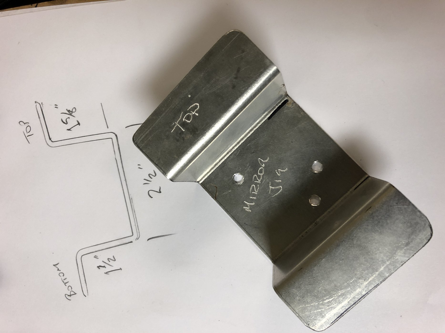

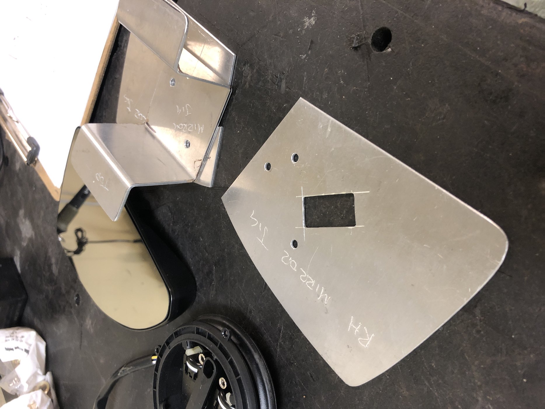

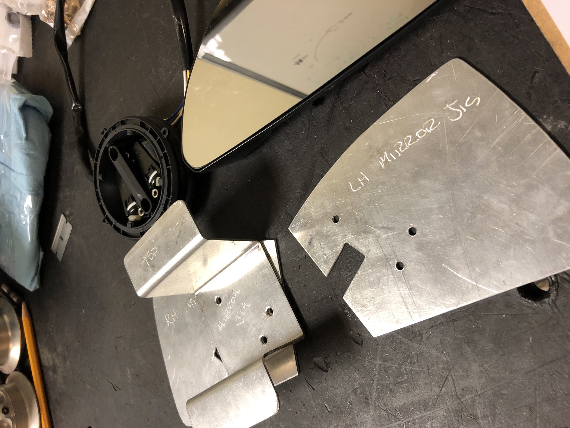

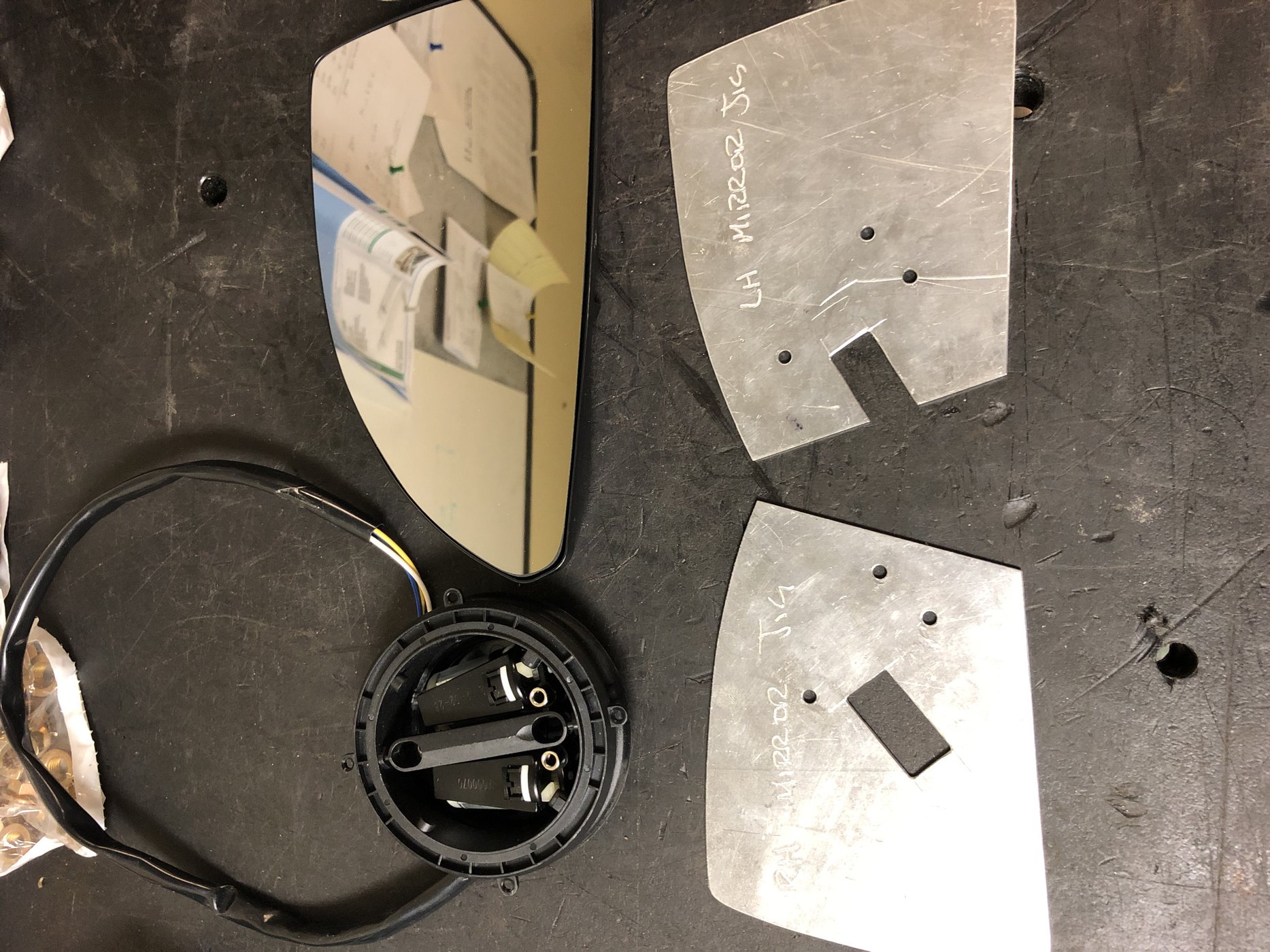

Here are some photos of the mirror set up

Ken Roberts
Andy can you place your right and left aluminum templates in a scanner and make a PDF that we can print out and copy on a sheet of aluminum or grp?
Compared to mine while apart it appears you placed the motor in a different orientation with the mirror (last picture with the mirror in your hand). I guess as long as we copy your pattern it's all the same in the end.
