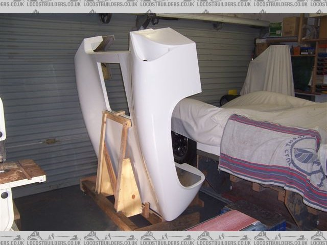

I made a stand on castors (with brakes) for the rear clip of my project as below. I made the lower part with a curve to fit the shape of the clip and padded it with sponge rubber. You unscrew the wood block in the center of the support to release the tail. It works well. Position the stand behind the car, with the clip open, lift the clip off the car in the vertical position and just move it straight to the stand. Takes 2 people to do however .

something like that would be great. I really need some way to store them out of the way. Do you have any pictures of it without the clip on it? Thanks!!

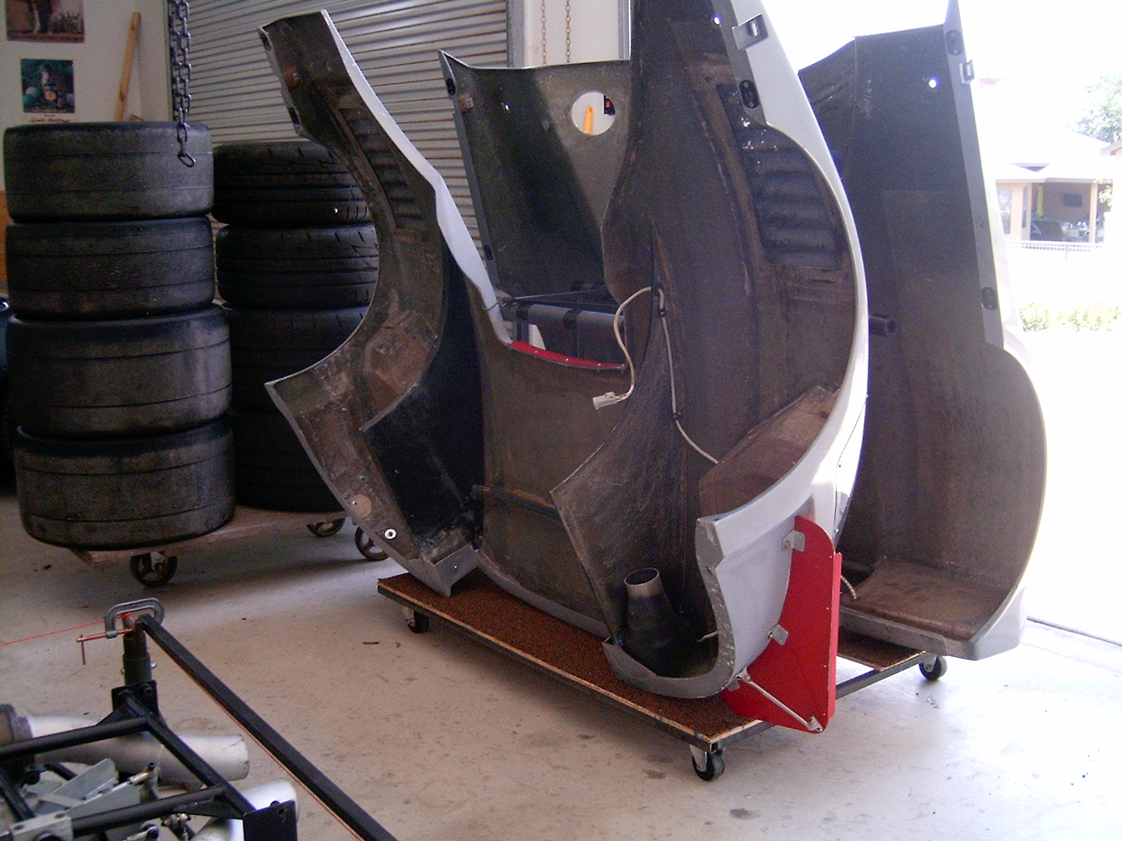

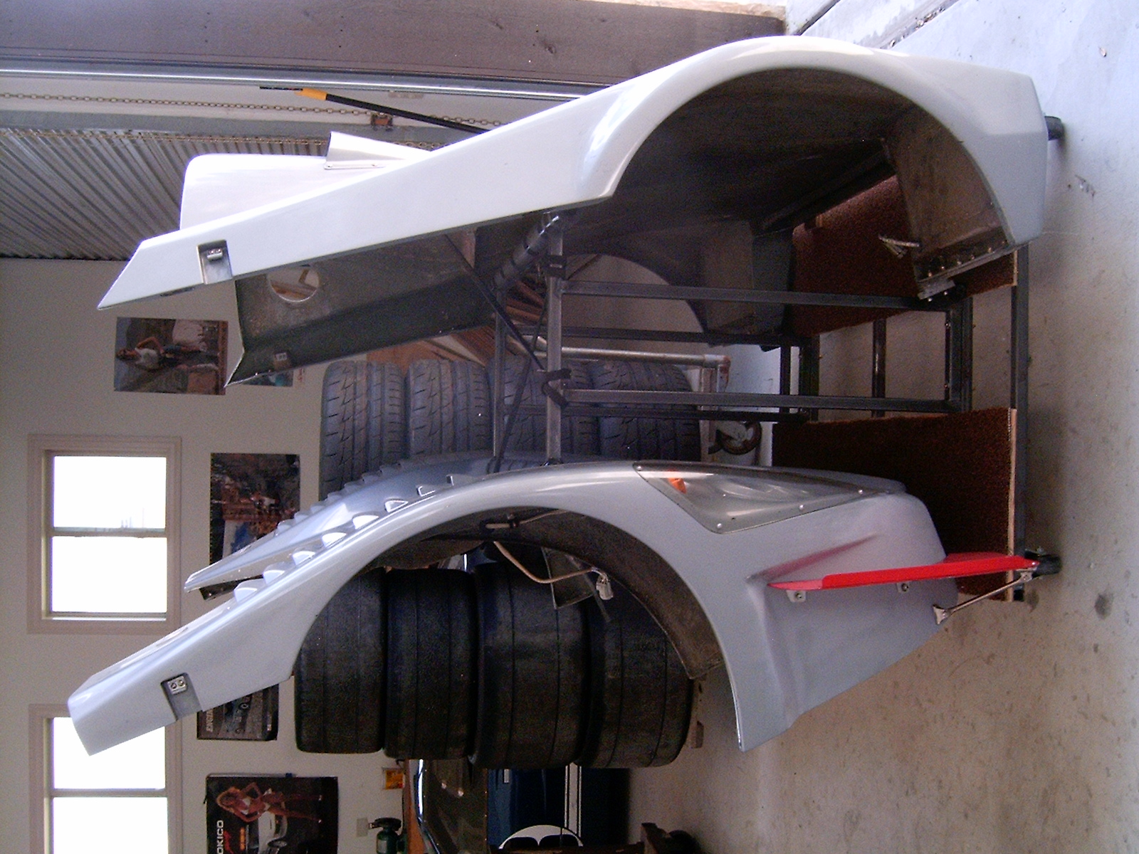

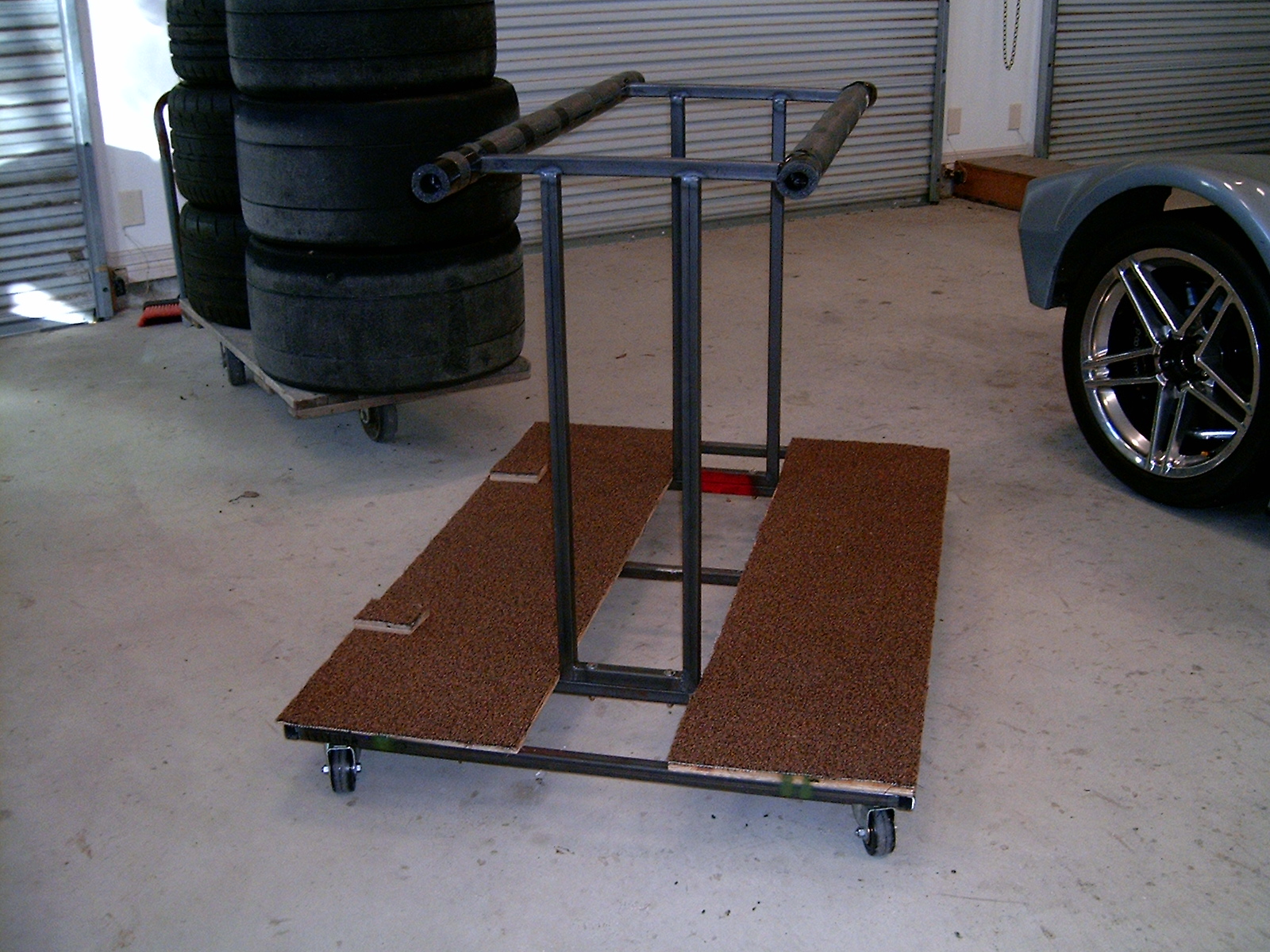

Here's what I use for my SLC clips. Being on a track car they spend a lot of time off the chassis.
