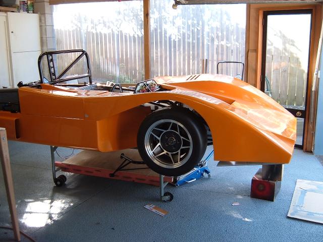

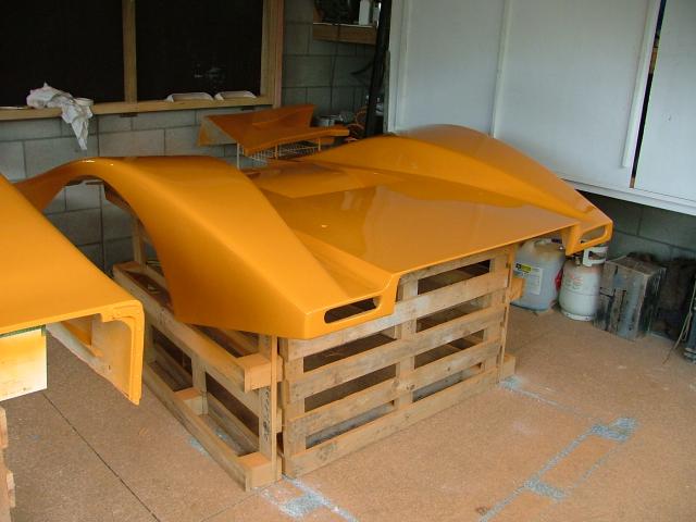

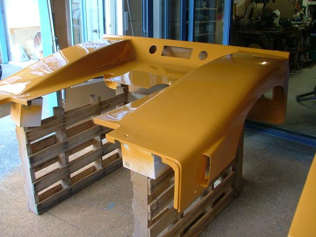

More ideas on the same theme, I work for Hirepool so big fans were no problem, went to a dress fabrics shop and bought some thin micro fibre not unlike a duvee liner about 10 mm thick and staple it in the door way with the fan sucking thru that. Air found its own way in and the over spray stuck to the fabric. I used a proper mask twin organic filter 3000 series and can still read rite and remeba 3 years later. The garage was lined with drop sheets that acted as great static attractants for any over spray and or dust whilst the floor underwent a few changes in color, grey,black,white and then orange top coat. Finnaly a nice new coat of grey floor paint hid it all. No over spray was found outside.
