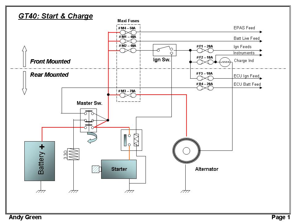

Tom,
On my circuit design, the alternator is loaded through a 3.3ohm ballast resistor, (via a separate set of contacts in the switch) when the FIA approved master switch is opened.
Attached is one of the diagrams I prepared so hopefully it will all work
Regards
Andy
Andy
I´have wired the resistor in the same way as you additionaly.
On another note i think your breaker will not work and is wired risky if you following your diagramm.
First
It will not break. The only two things your are breaking is the "ecu battery feed" and the "battery feed" itself. If the engine is running the alternator will continue to feed everything, thus everything will keep on running( assumed your ecu is running on ign feed only as well).
But there is an easy fix.
run your charge line from M3-70A directly to the battery not running it via the breaker switch and feed everything via the strong contacts of your breaker switch.
If your ecu is running on ignition feed only as well ( as assumed above), use the small contacts for breaking the "ecu ignition feed " ( don´t use the ecu battery feed at all if possible, or feed it via the "ecu ignition feed" as well) . If you do so you could avoid any current peaks, which still could be created by the breaker routine, entering and destroying your ecu.
Second: ( and thats the real risky thing)
Do not run your starter feed line via the breaker switch, they are not made for that high currents. Run it directly fron the battery to the starter. There is no need to break the starter line. It will not feedback any power into the system because it is broken by the starter solenoid (only in starting mode there will be a feedback into the system) anyway.
TOM
