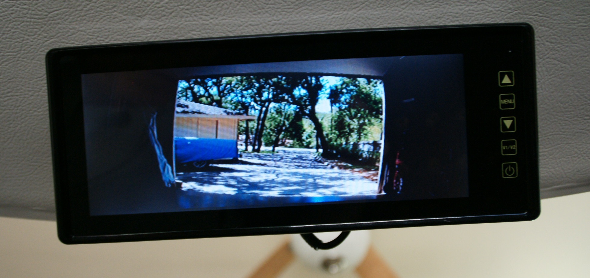

I have re-investigated 25:8 video monitors for cars. There are several new offerings, but they all seem to be based on the Hitachi monitor that is in the Tview and thus don't have a very good resolution (800 x 240 RGB). I still don't want a 16:9 monitor, but that might be better to have true HD (if you could find a HD rear view camera!).

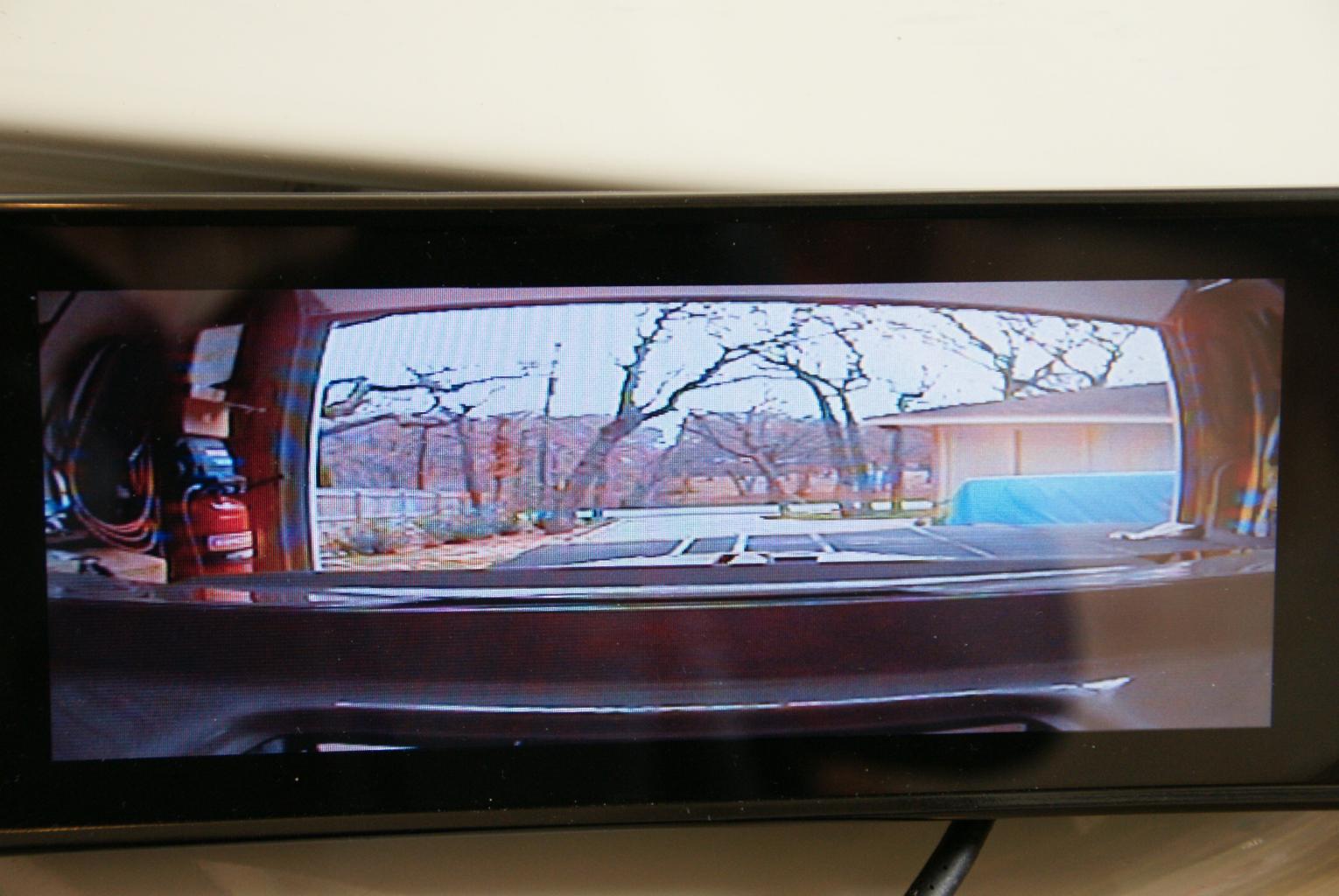

Where I stopped in my last post #192 on page 10 was the Boyo 420 on the Tview RV808 as shown in the first photo below. The second photo is the Mobius on the Tview. Notice that the colors are much better on the Mobius and it has a better resolution; however the automatic exposure control almost blacked out the inside of the garage. The weak link is again the Tview. The third photo is the Mobius recording played back through the computer monitor, much better resolution and contrast.
Now the bad news, the lens on the standard Mobius is slightly wider than some of the others; however, you can evidently get different lenses so that is not a factor. The really bad news is that you cannot mirror the image on the screen. I think to work well as a rear view camera, you need to have the screen mirrored as you are accustomed to in an actual rear view mirror. This is the deal killer for me.
I fail to understand why I can't buy a HD rear view camera and a HD 25:8 monitor for automotive use. They say that 640 x 480 is standard for a backup camera. I know that several of the new cars are coming out with rear view cameras and monitors, so It is just a matter of time before we can get improved rear view cameras and monitors.

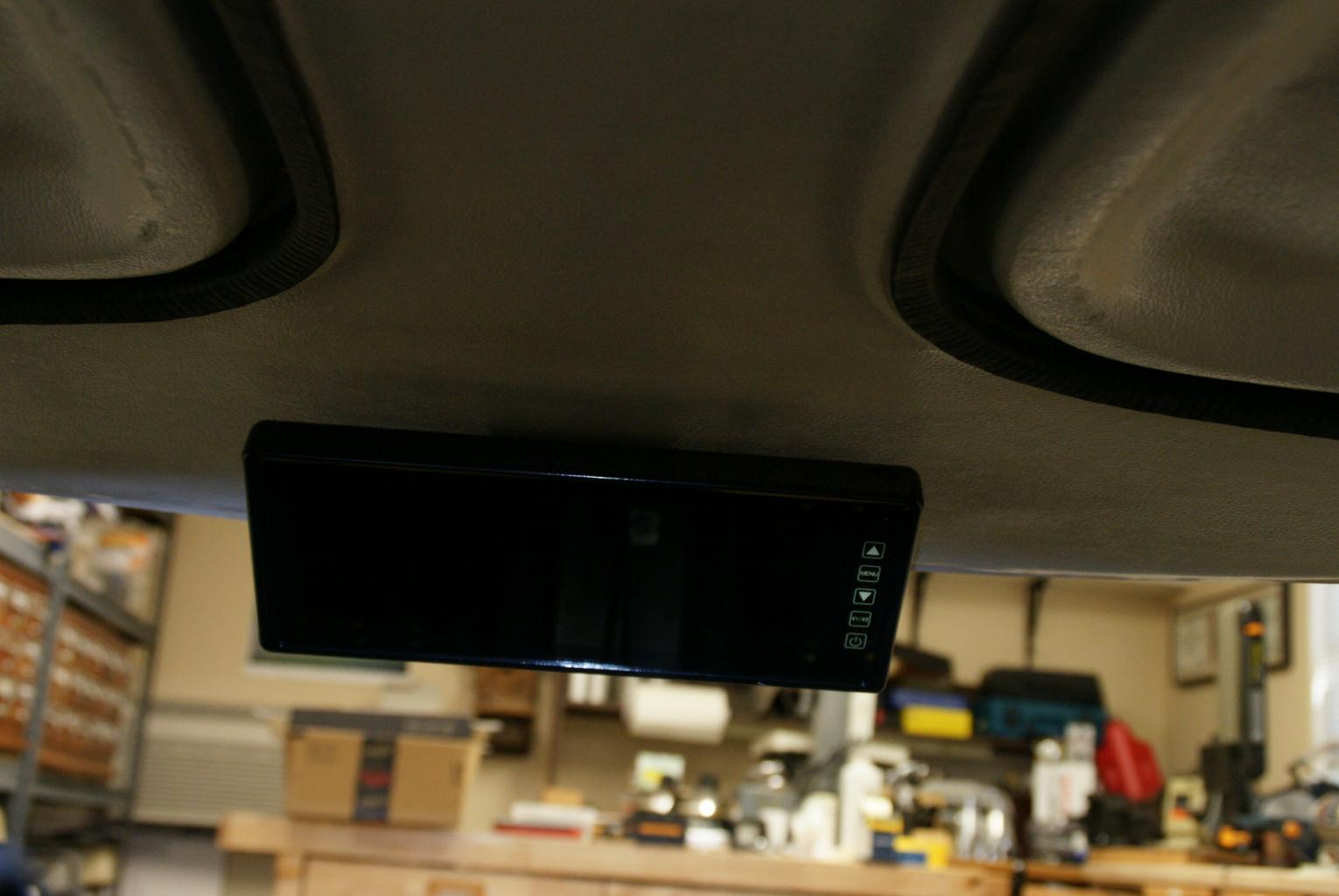

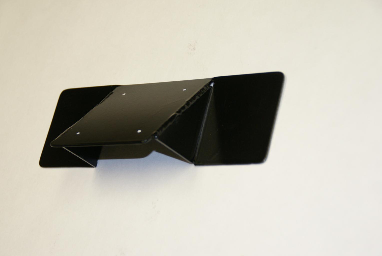

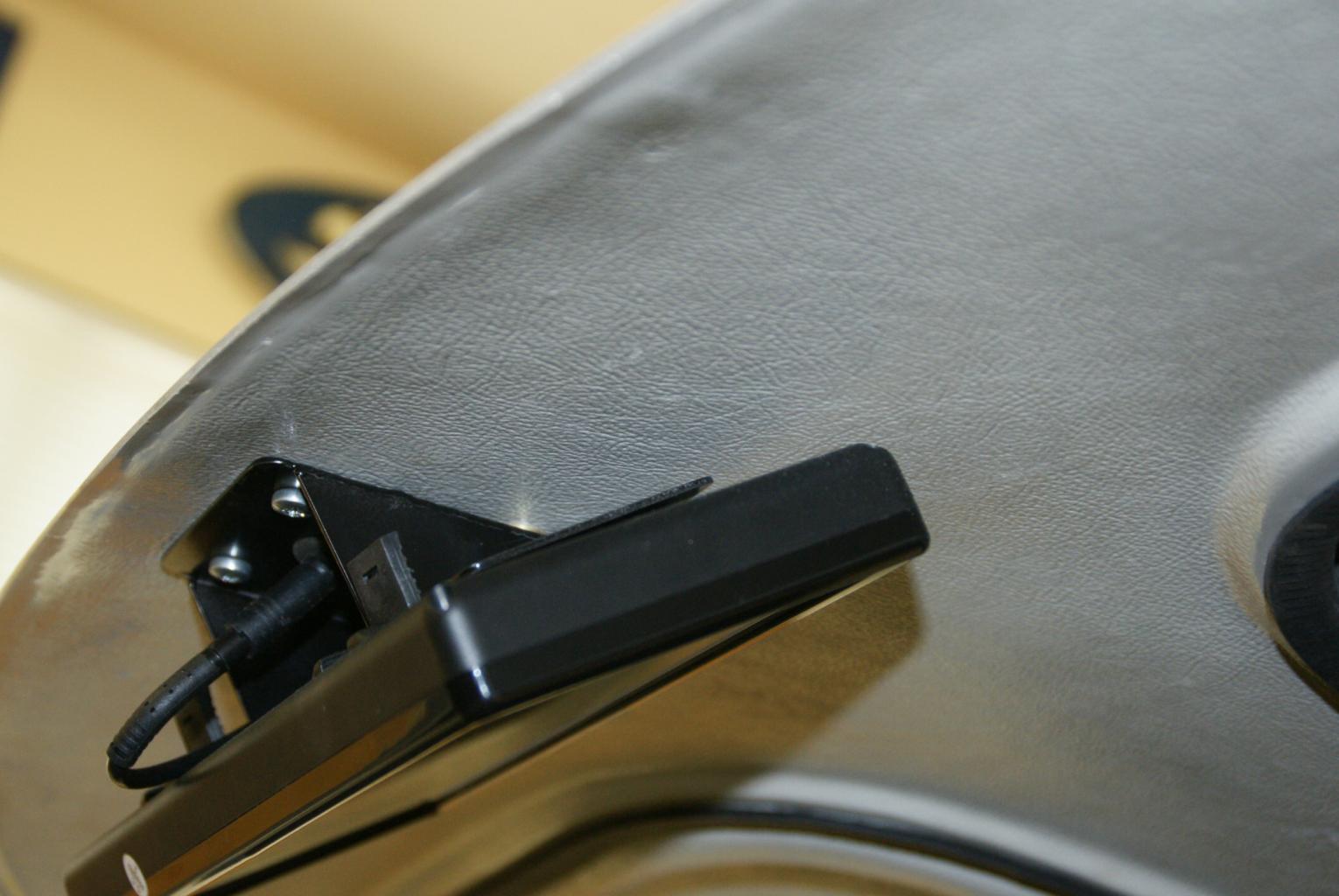

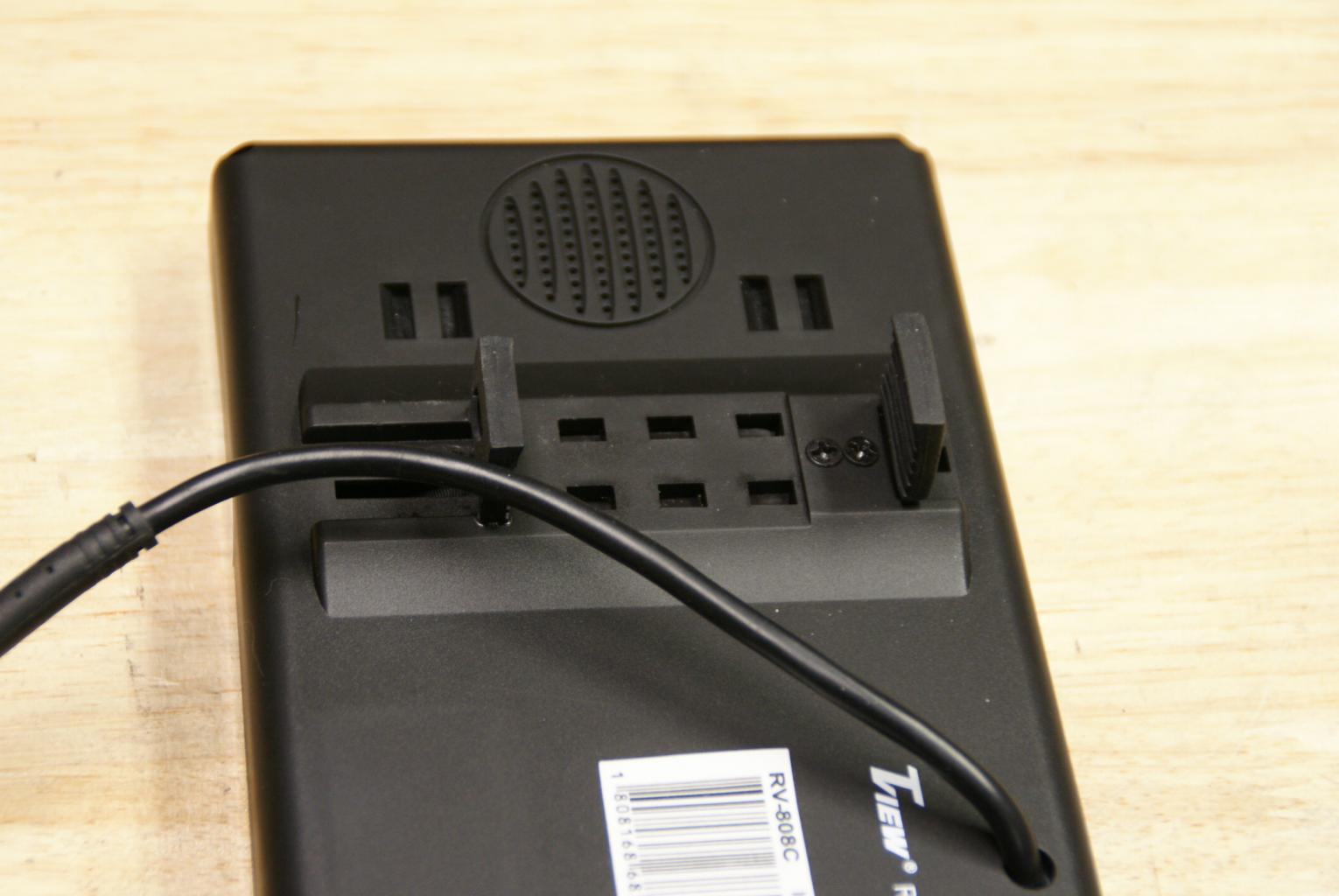

Ok, so I'm stuck with the Boyo 420 and the Tview RV808. So I built a bracket to hold the monitor. The bracket is mounted with rivet nuts in the roof. In this position, it is less intrusive on the forward view than an actual rear view mirror would be. These automotive monitors are designed to clip onto an existing mirror, so they have a spring-loaded clamp on the back side. I had to trim one of the tabs down so the monitor could fit against the ceiling of the roof. The next photo is the monitor mounted on the roof. Since the roof is composed of two layers of fiberglass, I was able to run the video cable between the two sections of the ceiling to the back of the cockpit so it cannot be seen.
Sorry for the bad photo quality. Let me know if you find any better equipment...

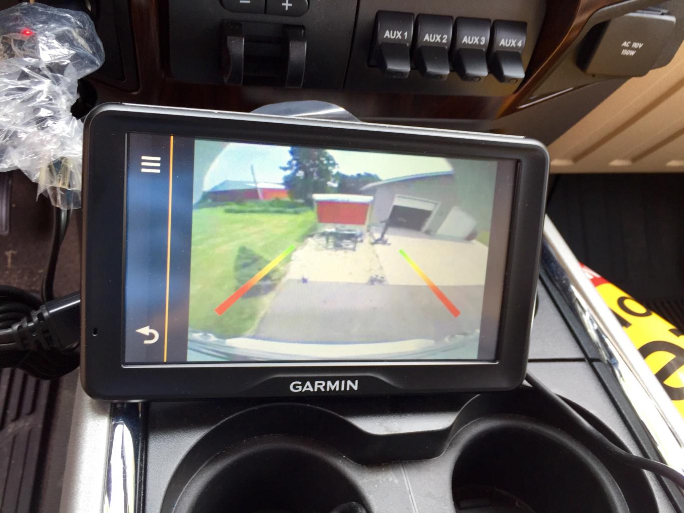

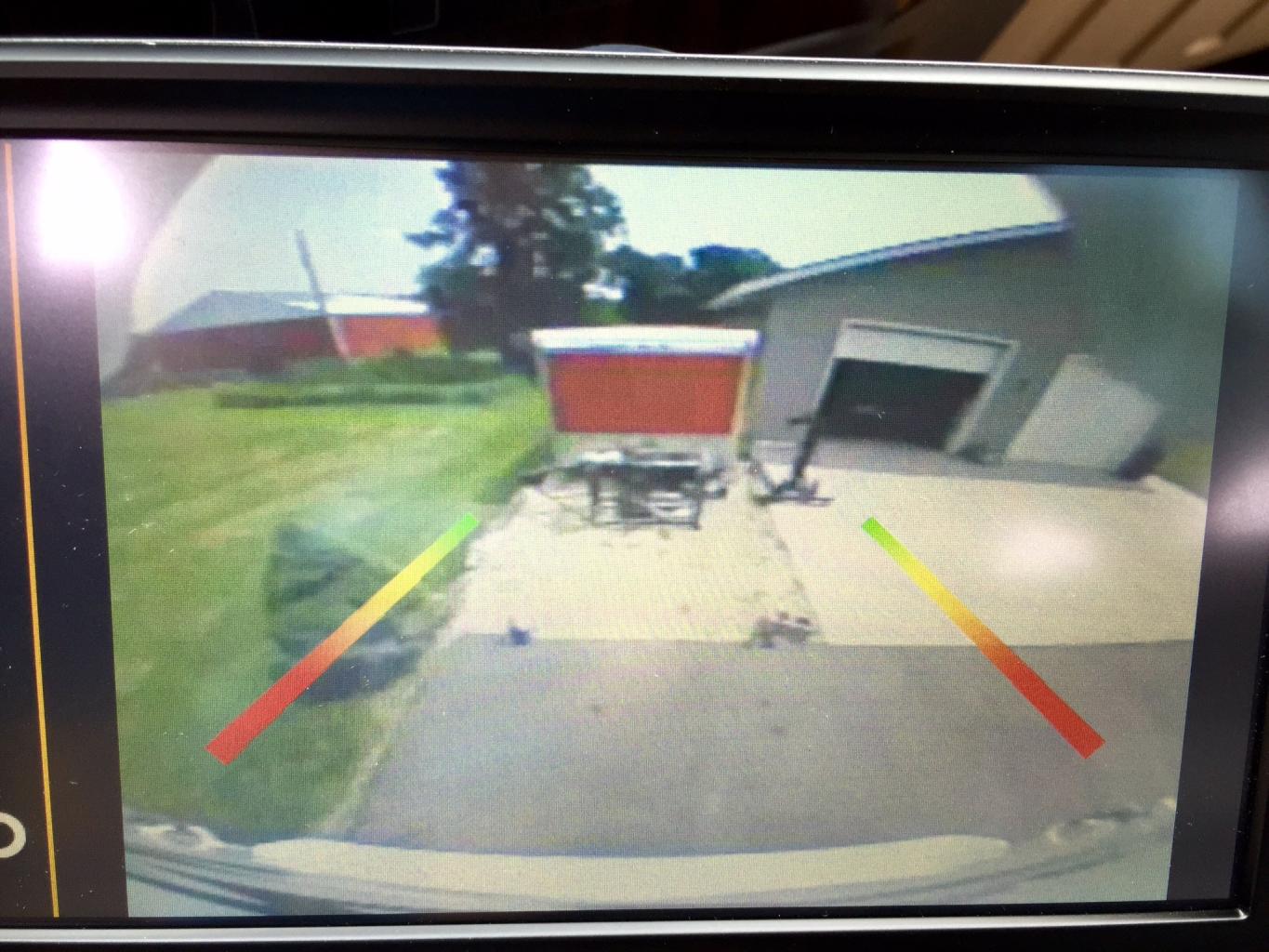

Hmmmm... I just installed a combined wireless backup camera / GPS Nav unit from Garmin in my truck with 40' fifth wheel camper.
Not real high resolution, but works great. Since the transmitter is a separate unit from the camera, it may be able to take a higher resolution camera input if needed. The 7" Garmin screen has graphics that well exceed the 640x480 resolution of the camera - so maybe....
The model is Garmin 760LMT with backup camera. I purchased from GPSCity.com via their eBay store for $409 including a 50' extenstion cable to get the transmitter closer to the front of the trailer.
Here is a sample pic (poor as this was a very bright and sunny day)...
Here's a screen shot of my jpg that my iPad would not allow me to upload earlier..

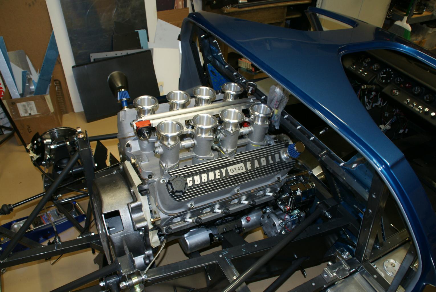

Ok Pete, I've been silent for too long... I do have my progress documented and will post full updates soon; however, I am in a big push to finish a few things so I can start final assembly. And yes, your photo is inspirational.
I have test fitted the engine for the plumbing and throttle. I have all of the body parts back from paint except for the rear deck. I have completed the plumbing for the radiator, heater, vacuum for boosters, and A/C. I am almost through with the brake and clutch plumbing as well as the fuel plumbing.
As soon as I finish the plumbing I will finish the wiring. I have the wiring harness provided by Tornado, but some circuits I don't need and I will have to add several circuits that are not in the harness. I haven't started on the wiring for the ECU yet.
I have had the entire car together with doors slamming before I disassembled it for paint. Now with it naked I want to finish the plumbing, wiring, and other things before I put the body back on. Once I finish these things, most of the other parts have been pre-fitted so final assembly will hopefully go fast.

Looking good Bob!
You may want to consider installing a breather tank and running a pair of -8 or -10 hoses to it. The breathers you show on the valve covers don't look sufficient and if they start wheezing oil, you stand the risk of fire.
