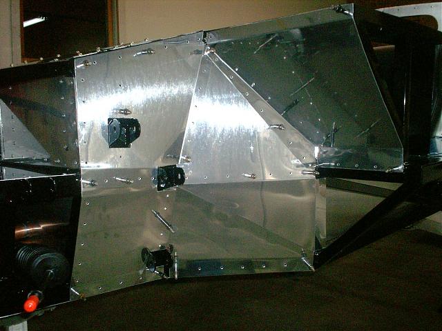

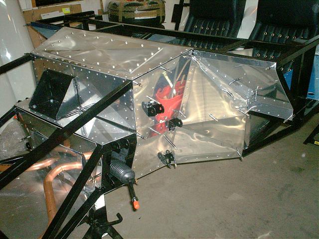

Not much this evening, just drilled the left front wheel arch.
S

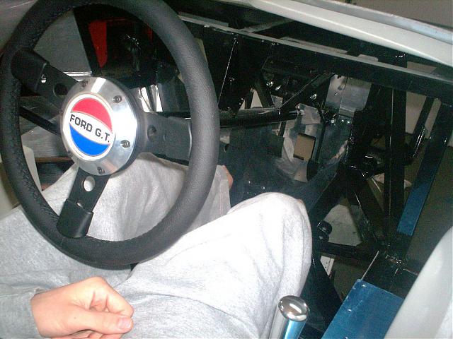

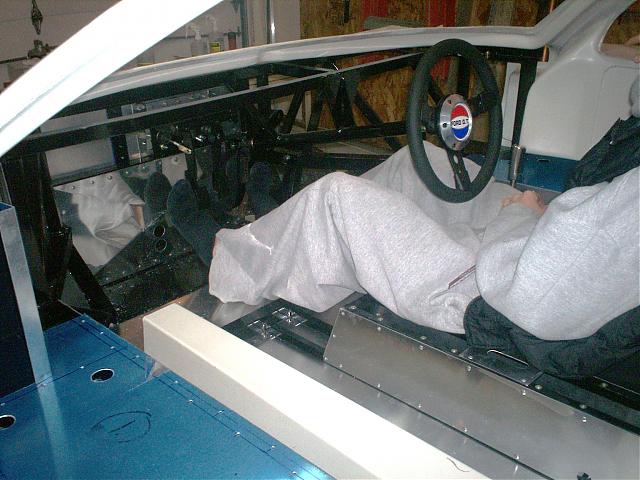

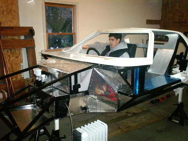

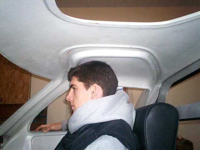

Not much this weekend I kind of took it easy.
Installed the rod type shift linkage.
Installed the pedals and cylinders, gas pedal and mocked up the cable.
Installed the steering shaft and quick disconnect wheel boss.
Put a buddy of mine who is 6'4" in the car, he fits quite well.
Tomorrow is another day.....
Scott

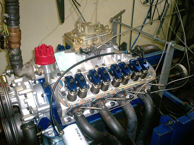

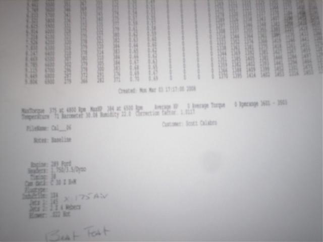

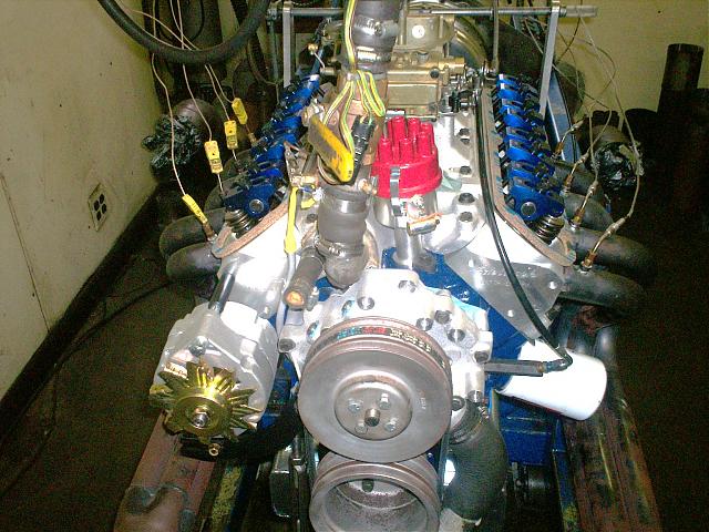

Today the engine runs went very well.
My 289 developed 395hp & 355tq !
All from the "little" Holman Moody C30Z cam & 11-1 C/R, & Eddie heads.
This was with the 180 deg high rise and 600cfm holley.
The pictures show this setup on the inertia dyno.
We went on later to install the 44IDF's, and made a best of 384hp @ 6500 rpm & 375tq @ 4800 rpm.
The Webers really ran best overall, as the time from 3500 rpm to 6900 rpm was just over 1 sec faster with the Webers.
The engine shop is in Simsbury CT, THEY ARE A FANTASTIC SHOP!
Thanks to Norm, Dave & Chris!

Nice goin Scott, would have been interesting to "see'' a run with the 180° headers installed but dyno setup would probably prevent easy fitment. Well done!
Jac Mac
Thank you Jac!
I would have liked to run the 180 exh. setup also just to see if the tune up would be significantly changed.
Yes fitment on the dyno would have been a small but not insurmountable problem... time was the biggest setback.
I hogged the dyno all day! ;)
S
