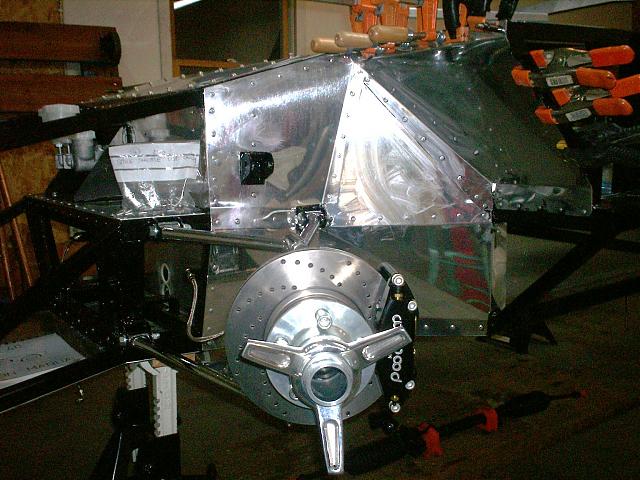

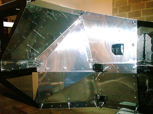

Right front wheel arch almost complete.

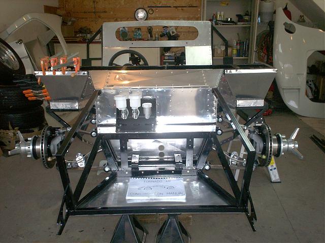

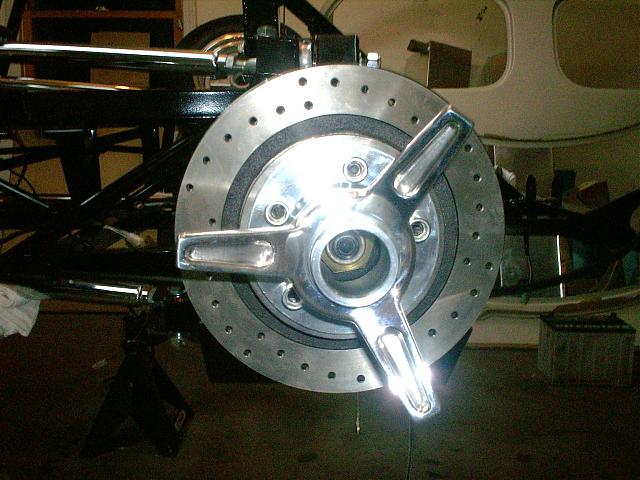

Tonights work,
Rear suspension ready for brake installation and initial wheel alignment.
Installed parking brake cables and lever.
Began initial install of the production type pre-terminated wiring harness.

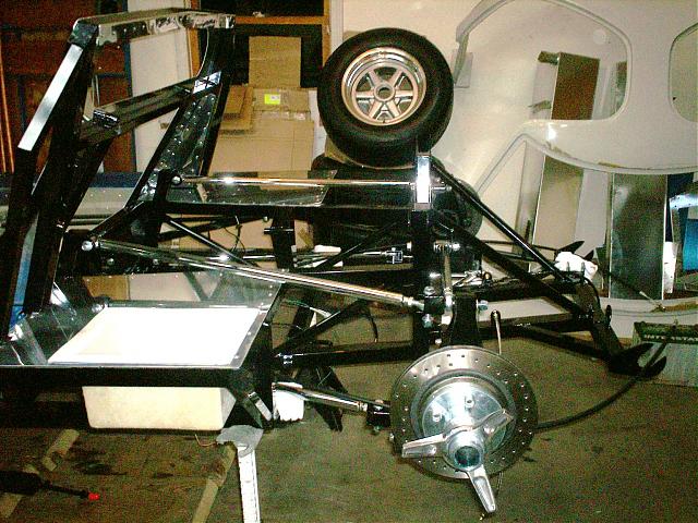

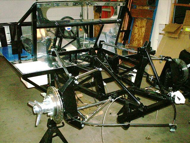

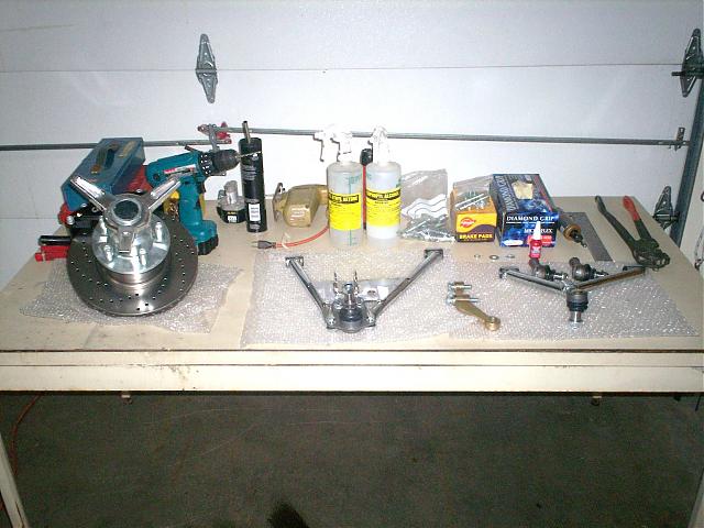

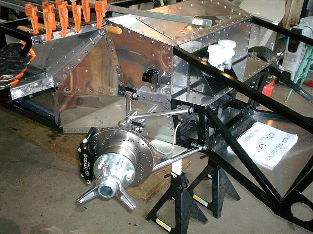

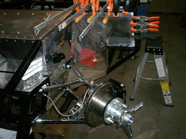

The work continues;
Finished left fwd. wheel arch.
Built up both front spindles & wishbones and installed rotors/brakes/pads and K.O. adapters.
Installed left suspension.
Tomorrow the right side......

Thanks guy's...
Bill,
I enjoy your comments, thanks :D.
Tpflyer,
A new ZR1 would certainly get the job done :eek:!
But how about coming over to the Blue Oval instead?
As far as if you can build it or not, why not stop over sometime and check out the build in person? (you too Gregsterv!) To get here from anywhere in Massachusetts is less than 2&1/2 hrs.
This will give you a chance to see exactly what is involved, its pretty simple just follow the 95 page fully illustrated build manual.
Gregsterv,
No organized racing, just some open track days and autocross events in New England.

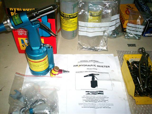

No special tools except maybe some clecos and a hyd/air powered rivet gun like the one pictured below. I got it cheap at a Harbor Frieght tent sale last Saturday for $29.

He has still not lost his sense of humour Bill, just tucked the 'raw edge' away for later:)
* Note* the -for space shuttle use only- comment on the plastic bag,- now Scott that really is a bit over the 'top'-even for you!

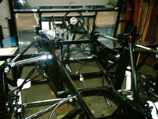

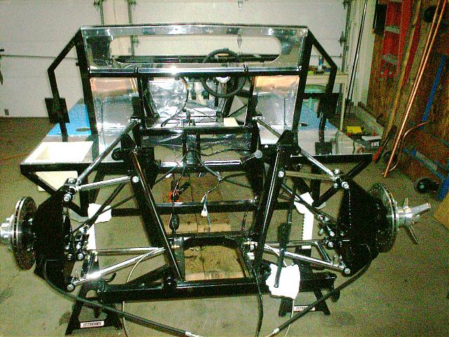

This weekends work;
Installed the throttle cable.
Installed the steering rack.
Installed the front Anti-Roll Bar.
Installed the coolant pipes.
Installed the front lower bulkhead panel.
Installed the main and front wiring harness.
