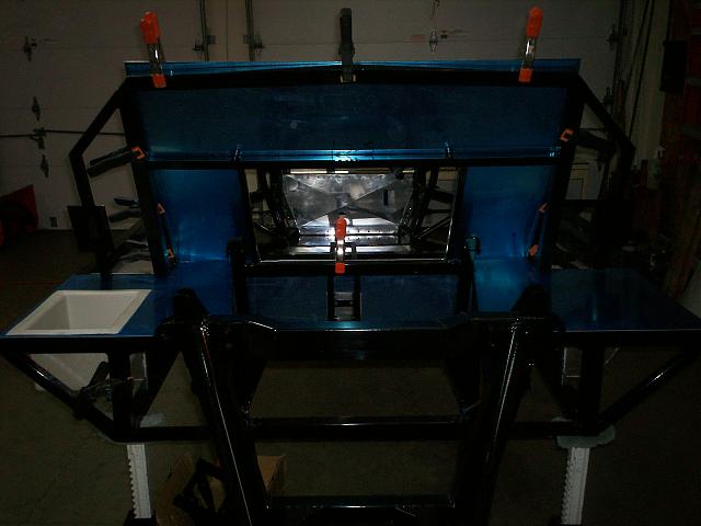

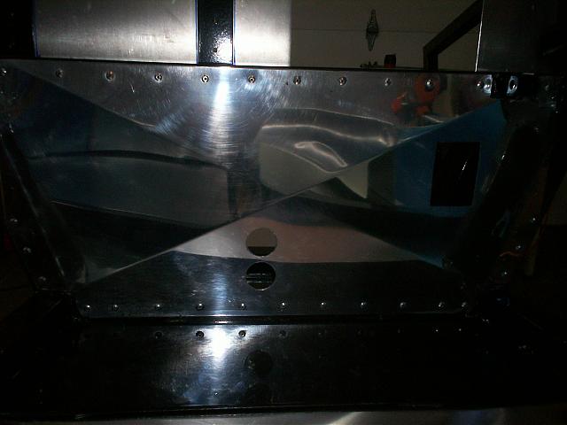

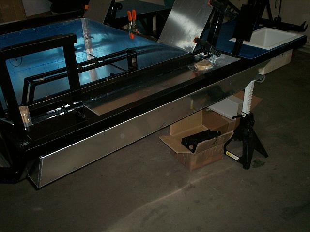

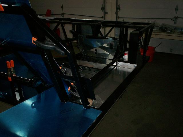

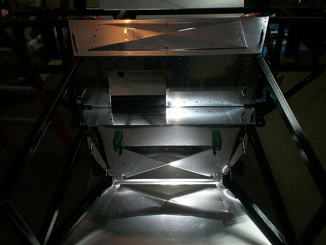

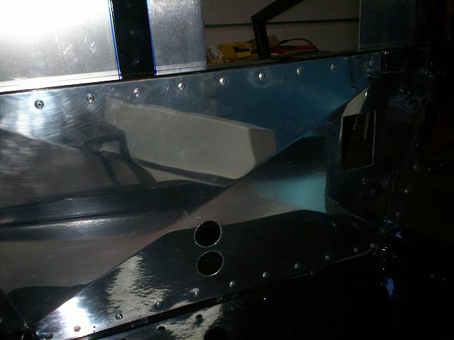

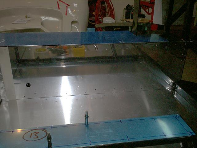

This Saturdays work;
Layed out interior rivets and drilled pilots.
Started rear bulkhead.
Finished up steering rack front cover and access panel (just have to cut cooling pipe holes).
Cut battery box hole.
Installed fuel tanks for mock up of fuel quantity sender covers in the sill top panels.

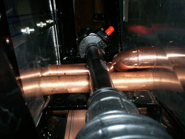

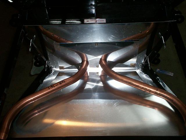

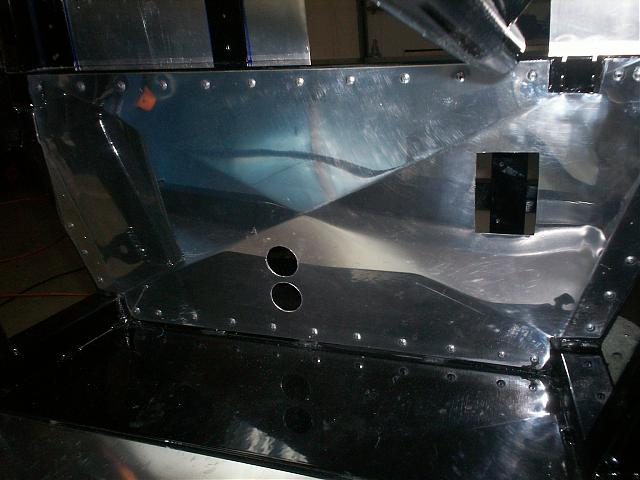

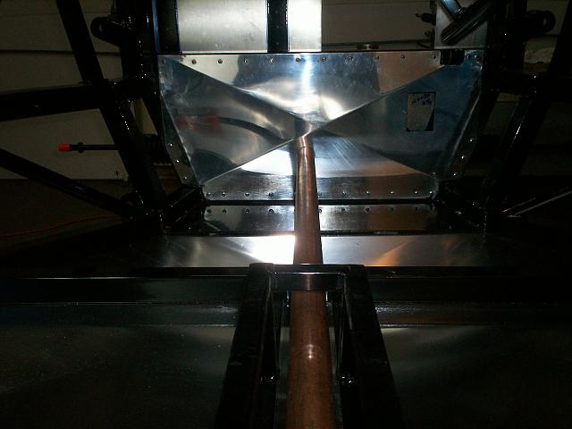

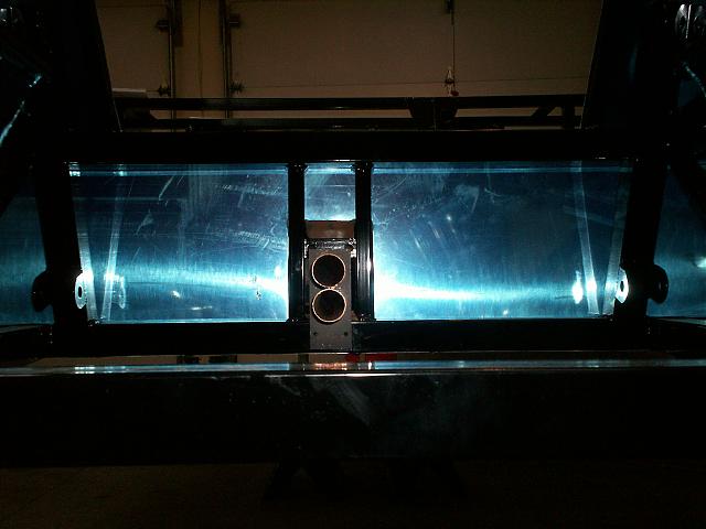

Finished steering rack front cover with water pipes mocked up.
Not too shabby for an old A&P, if I do say so myself ;)
S

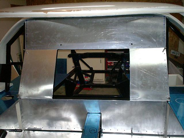

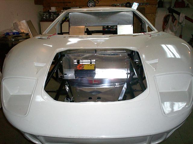

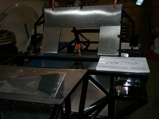

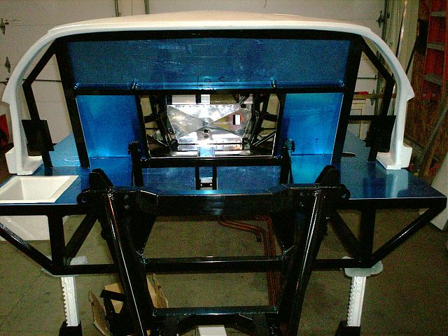

Tonights work;
Rear bulkhead almost done. Just need to cut window hole and install riv- nuts for the GRP engine access panel.
Finished vertical sills.

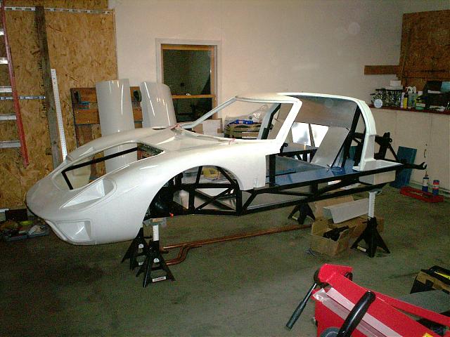

Could not help myself and had to slap on the spider and front clip to have a look!
S

A quick question - are the radiator pipes copper? If so are you running an Ali radiator or heads?
If so you will lose ali through electrolisis. It can be eased back with inhibitors but will still happen. So it may be easier to change to Ali pipes now rather than later with the added expense of an new radiator.
Randy,
Yes the spider is located first.
Ian,
Thank you.
Yes I have both alloy radiator and heads.
I'm not worried about "electrolisis" though.
TSC has been continually developing the car for 19 years now. If it was a significant issue it would be set up differently.
I do understand your concern, however by using distilled water and high quality ethlyene glycol, it is a non issue.
American "Muscle Cars" have run alloy heads with copper/brass radiators for decades with no problems.
