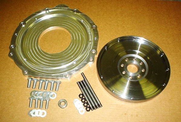

The Ford Mod.(4.6-5.4)to G50 porsche trans axle adapter kit, thats billet aluminium adapter plate, (anodising extra /ubbthreads/images/graemlins/banghead.gif)billet steel flywheel,spigot bearing and bolts/studs etc
Other kits avail for Ford Windsor,Chev,Ls1 and Lexus--V8 muscle your G50 /ubbthreads/images/graemlins/cool.gif

Note; the flywheel and clutch needs to be balanced with the motor or at least match balanced with the original fly/clutch assy --- windsor motors in particular /ubbthreads/images/graemlins/beerchug.gif

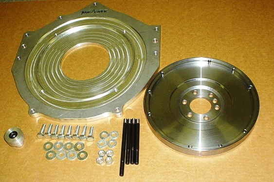

-----And for the Lola a LS1-2,G50 adapter kit /ubbthreads/images/graemlins/laugh.gif

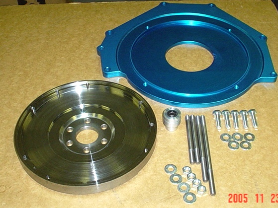

Last but not least, low budget, tough, reliable straight forward and simple Lexus V8 /G50 "adapter kit"

The adapter you sent me is sweet mate, it fits like a glove and the quality is fantastic. (not bad for a cane toad lol) I ordered the Ls1 to G50 kit for my GT40 /ubbthreads/images/graemlins/shocked.gif
