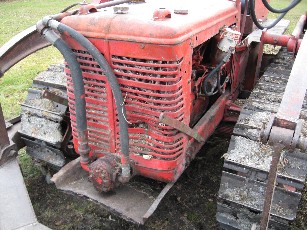

By the way ignore the pic I just threw that in to see if I could so I could show you some drawings later.This is my other toy that I use on the toys that dont work. Kind of like monster garage.
No, I had you right the first time:) Going by the size of your dozer you have not made any 'Big' mistakes --yet!:)
