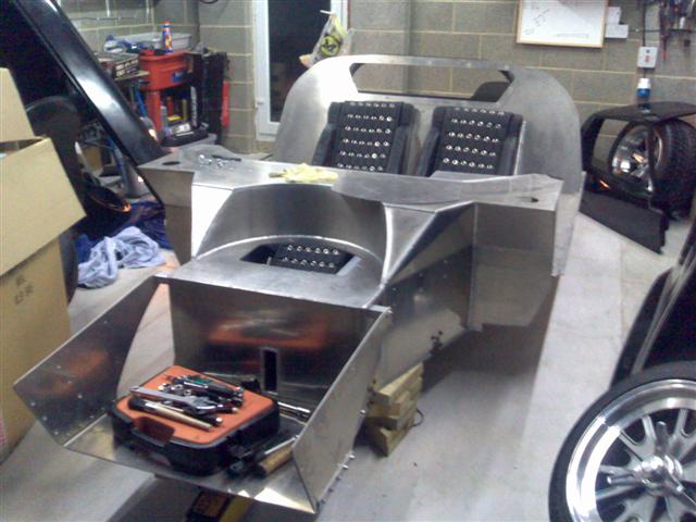

Thought now I have it I'd better start a build thread. Progress seems to have taken a step backwards already, started off with a rolling chassis, now I'm left with this.
Hopefully I can sort out powdercoating asap so I can start putting it back together again.

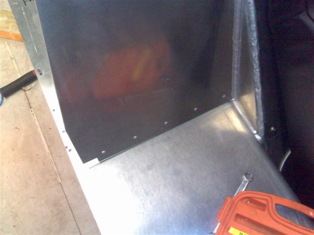

Not even 7pm now & I have nothing to do, may have to start cutting up some fibreglass.
How are we attatching these? Angle bracket would work fine if it wasn't over the fuel tank...

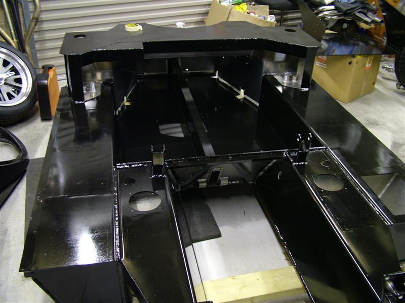

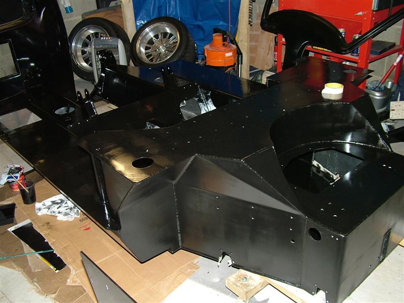

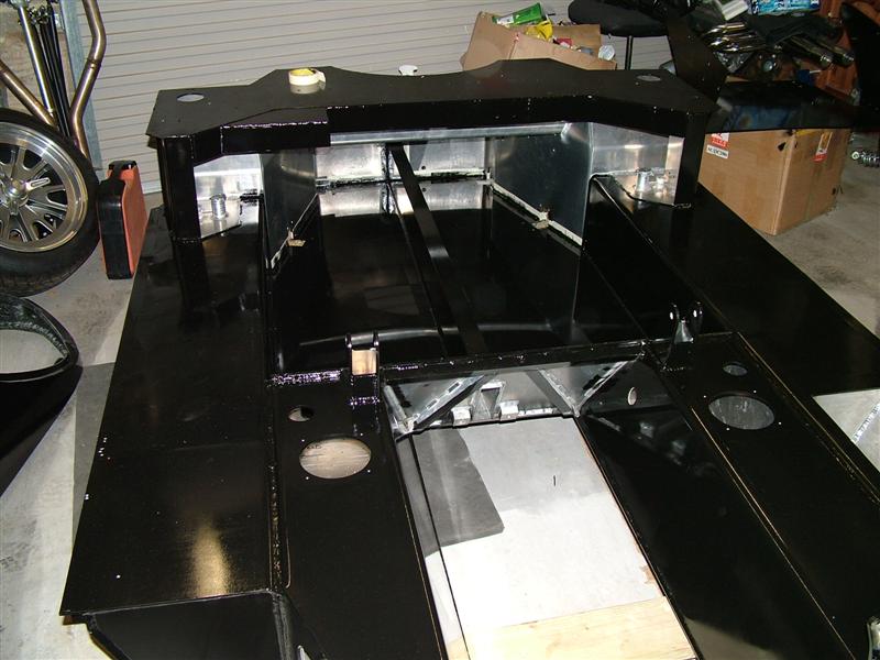

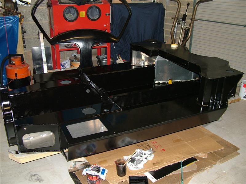

Right some actual progress, been very busy painting the chassis, horrible job.
Used the POR15 which went on ok, I used a roller on the top half for the preventative coat & I'm going to spray the final UV chassis coat on.

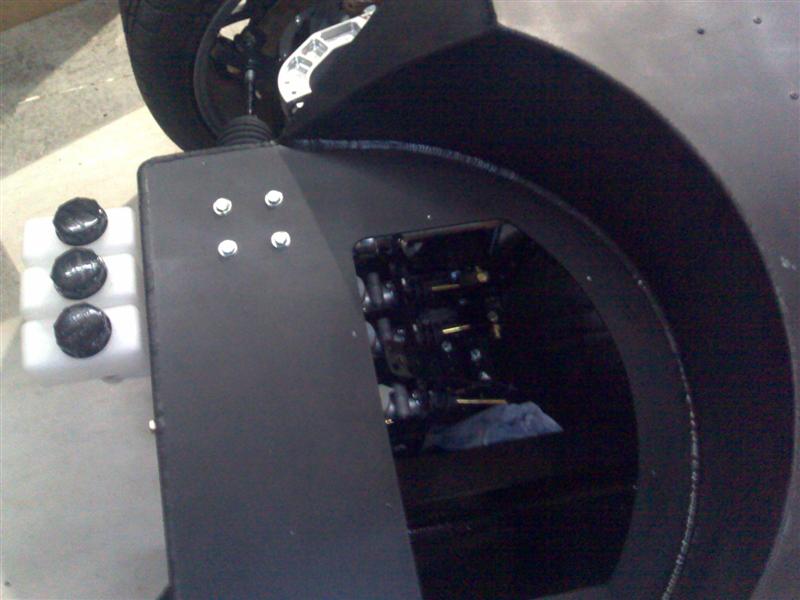

Been busy, pedals assembled & mounted, holes drilled to mount seats, master cylinder reservoirs mounted & got the front suspension back on.
